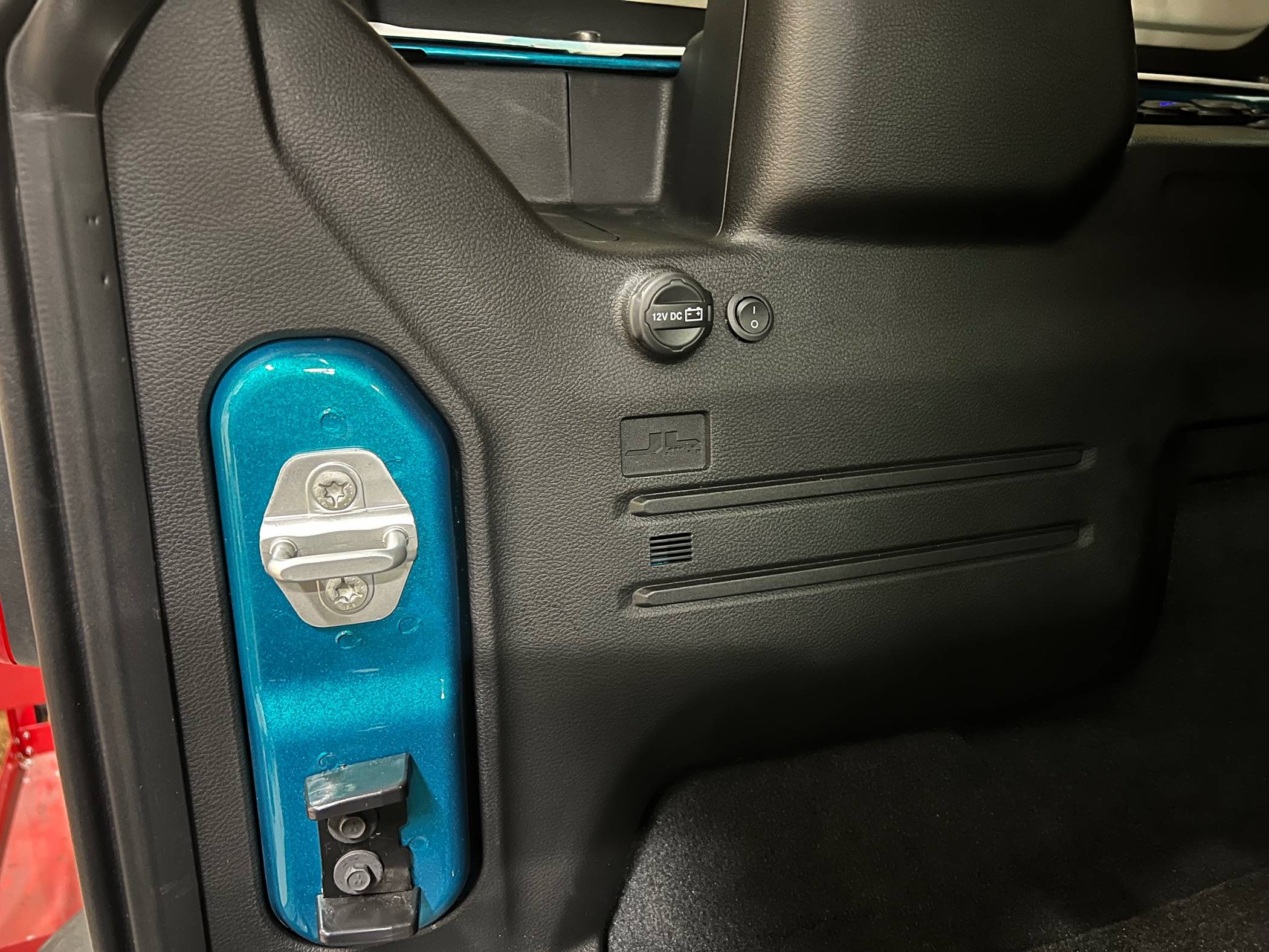

I don't know if you need a solution for power, but I tapped the wire for the power receptacle and added a switch next to it. That way when I open the back I can turn it on to load groceries. ;)

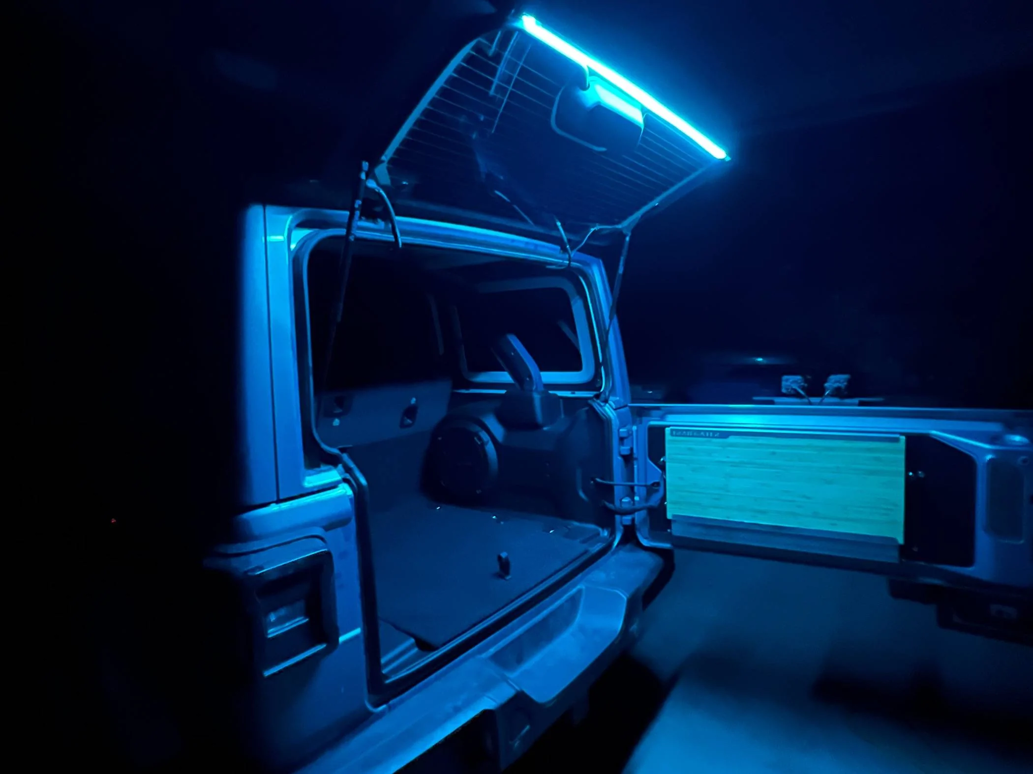

A couple of pictures, one showing the light (I switched it to teal to match the Jeep) and the switch.
Jeep Wrangler JL Tailgate Brawlee LED light IMG_8605
Jeep Wrangler JL Tailgate Brawlee LED light IMG_8598
