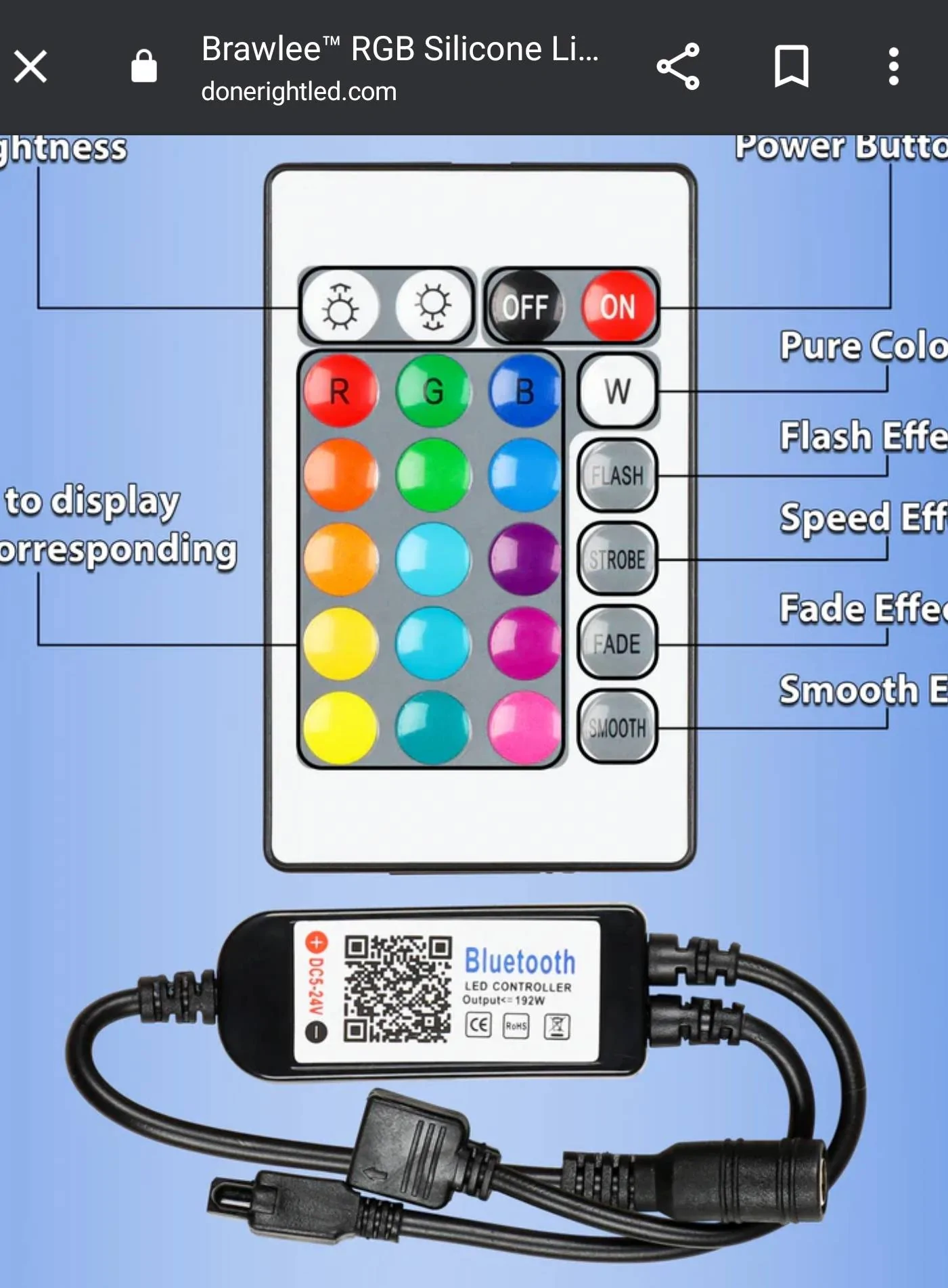

I recently installed the new design Brawlee RGB light bar in my 2021 Jeep Wrangler 4xe. I tied it's wiring into the dome light circuit and also connected it to a constant 12V source via a 2 position switch so that I can select it to be automatic, manual or completely off. Right around the time of installing it I noticed I started having a lot of issues with my key fob not being detected to start the Jeep and even my proximity handles were very hit or miss, especially when trying to lock the Jeep by pressing their button after getting out. My remote lock/unlock worked perfectly, and I even put a new battery in the fob just in case, but at least 75-80% of the time I would have to press the start button with the fob. I was thinking this was unrelated, but today I got to thinking about the Bluetooth controller that is included with the lightbar and wondering if it could be causing any interference, so I flipped the switch into the "off" position and my fob has been back to working 100% of the time since I did that.
Has anyone else heard of or had any interference issues, or know if is there a way to disable or bypass the Bluetooth transmitter that the light bar plugs into? I'm going to flip it back on tomorrow and see if the problem comes back again, but I think it's extremely likely to at this point. I have a feeling that the times that my fob did work while the bar was enabled was at times when the interior lights had already turned off and the interference had gone away, but I hadn't made that connection yet and am just guessing but I will definitely pay attention tomorrow.
I've send DoneRightLED (the maker of the Brawlee bar) a message to see if they've heard of anything but I'm not sure how fast they'll get back to me.

I think that's probably the old version. The new one has this module that plugs into the cable from the lightbar and then the power cable goes out from there. There's also an infrared eye that comes off the module.

The remote you're referring to isn't Bluetooth, it's infrared. The Bluetooth is just to link your phone to it via their app. Do you ever try to start your Jeep with it powered on? It sounds like you just use it manually when at the back of the Jeep if you're just using an on/off switch.
