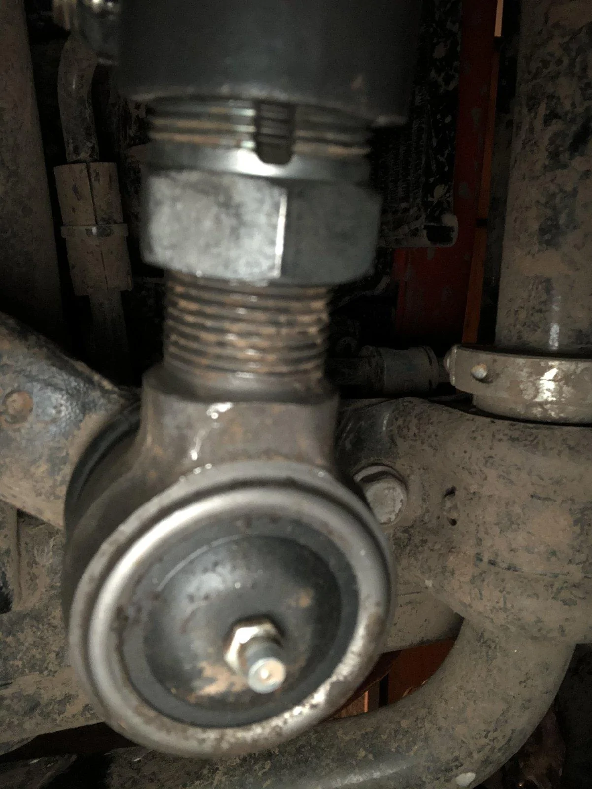

For what its worth, I could not get the pinch bolt on my Synergy drag link to clamp, even up to 120 ft./lbs with a spec of 90. Synergy sent me a new collar, but it didn't work either, so I just had the shop pull it off and put on a drag link with a pinch bolt. The pinch bolt stays tight. I'm not sure what the deal was, my Synergy tie-rod will clamp, but the pinch bolts needed 125 ft/lbs (above what Synergy recommends, so I'm actually a bit concerned about it) to keep it fixed. Not trying to trash Synergy in the least, they were willing to work with me, I just got tired of it not working and found an easier fix.
Something ain't right Slim... There HAS to be an issue with how the double adjuster is orientated. Shoot me an email ([email protected]) with your set up pics and I can try to help you out. I've seen some VERY reputable shops fuck up on how these things are supposed to be set up so that could be the case here. Its crazy how many people WON'T read the instructions.

Strange, do you line up the slits in the adjuster and the pinch clamp?
photo of the alignment. Like I said, I’ve moved on. I accept that my case is odd and have nothing negative to say about the company, I just lost patience and went a different direction that is working.
Yeah, a few red flags right out of the gate. The double adjuster should be showing about the same thread lengths on both the adjuster and the TRE. As you can see the adjuster is threaded in a bit further than the TRE. Next thing I would do is adjust the other TRE at the other end of the bar in a bit. The double adjuster assembly will clamp tighter as the assembly is adjusted out. Looks like a easy fix to me... Too bad you threw the towel in so easily and early on this. Did you reach out to us for assistance before you jumped ship?
