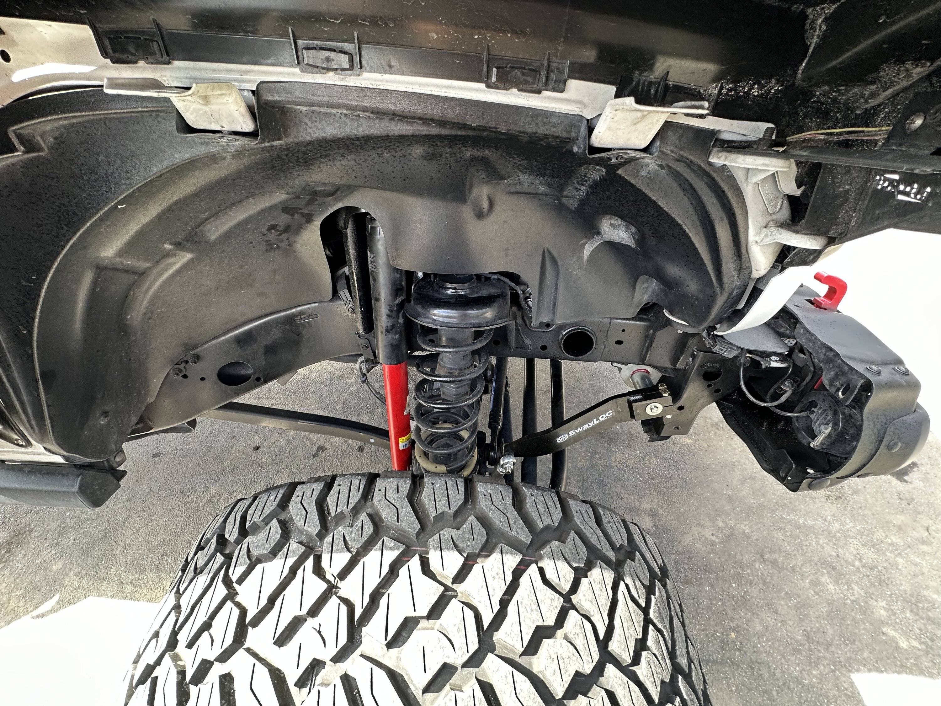

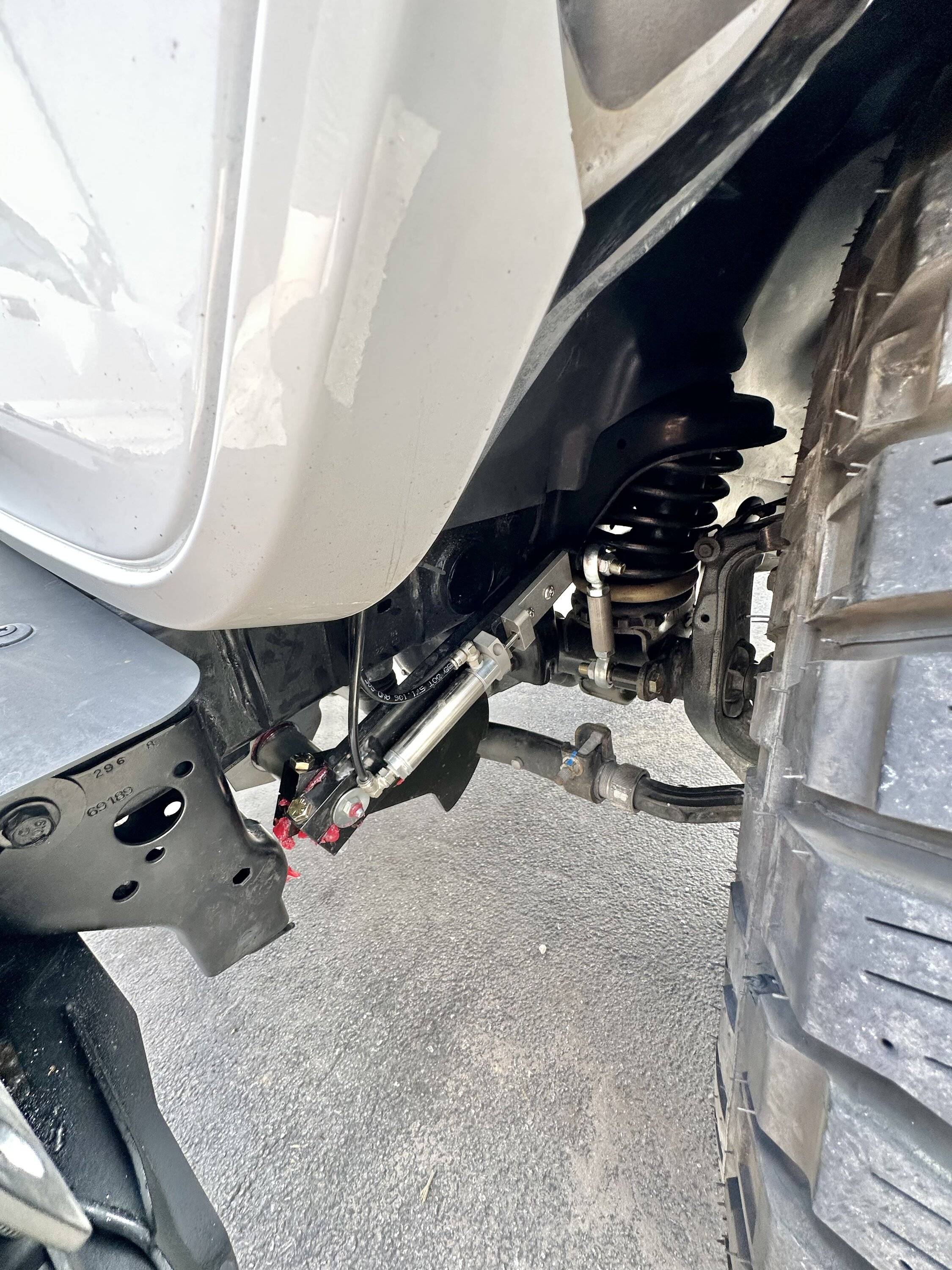

The install:
Jeep Wrangler JL Swayloc initial Impressions 8B7B88BE-175F-4B6F-9D27-0A8374B5B63E
To be honest, it’s easy but kind of a pain too. Installing the brackets first, and globs of grease made it easy to mount it while in the jeep. ORO provided a install tool, a stud and piece of tubing to install the arms, I used it at first to press it on, but about half way through my dad and I hammered it the rest of the way.
Small note, my tire rubs ever so slightly in reverse and full lock on the air piston, Im not sure if offroad and flexed i’ll rub on it, but from testing it with a jack, it doesn’t seem like it. Just have to slide it around to where it’s sorta perfect on either end. Note, im running 17x8.5 4.75in BS 0 offset wheels. On sport axles -12 offset would be better.

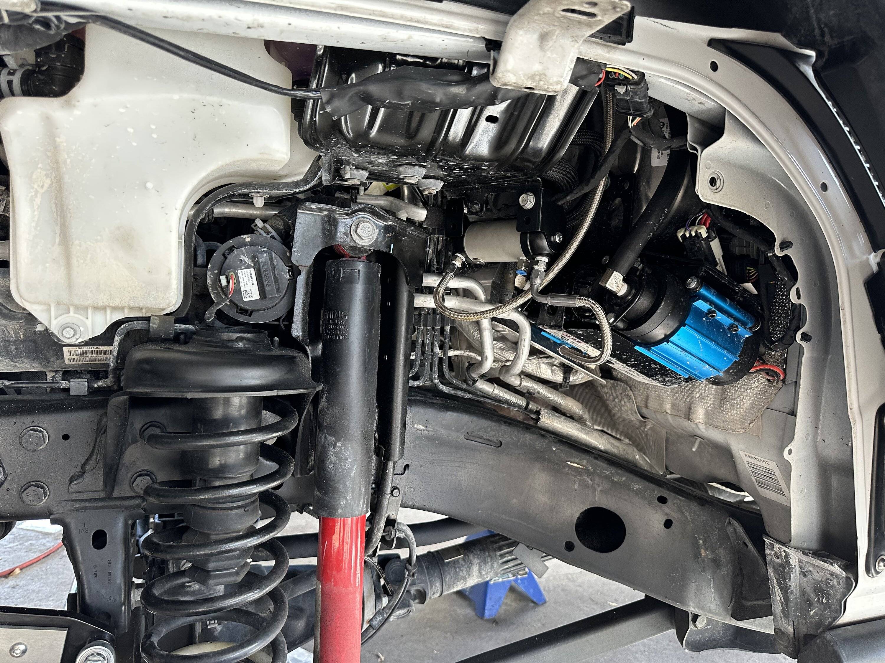

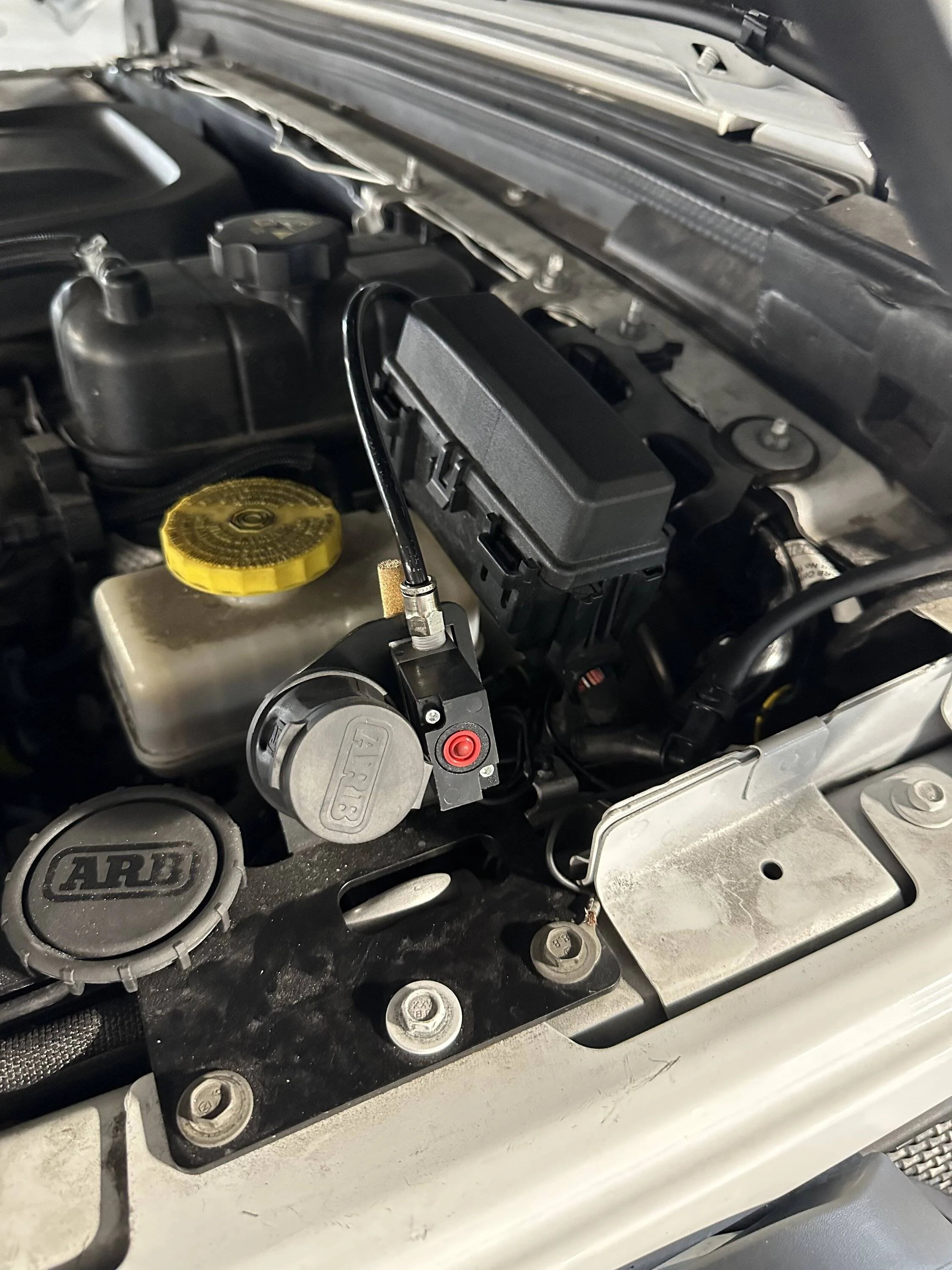

For the air set up, I didn’t want to make the manifold
too inaccessible, so I found a hole to mount it to, and I may have to go back in and rearrange the steel lines so it’s a little more optimal.
Jeep Wrangler JL Swayloc initial Impressions 1E5ACDAD-46E2-4820-A669-09EF43C6760E
Jeep Wrangler JL Swayloc initial Impressions 8FD2021B-F02E-478E-B2C6-E0506C13F634
Sorta mounted the solenoid on my grimm arb mount, bottom fitting is hard to reach this way but not impossible.

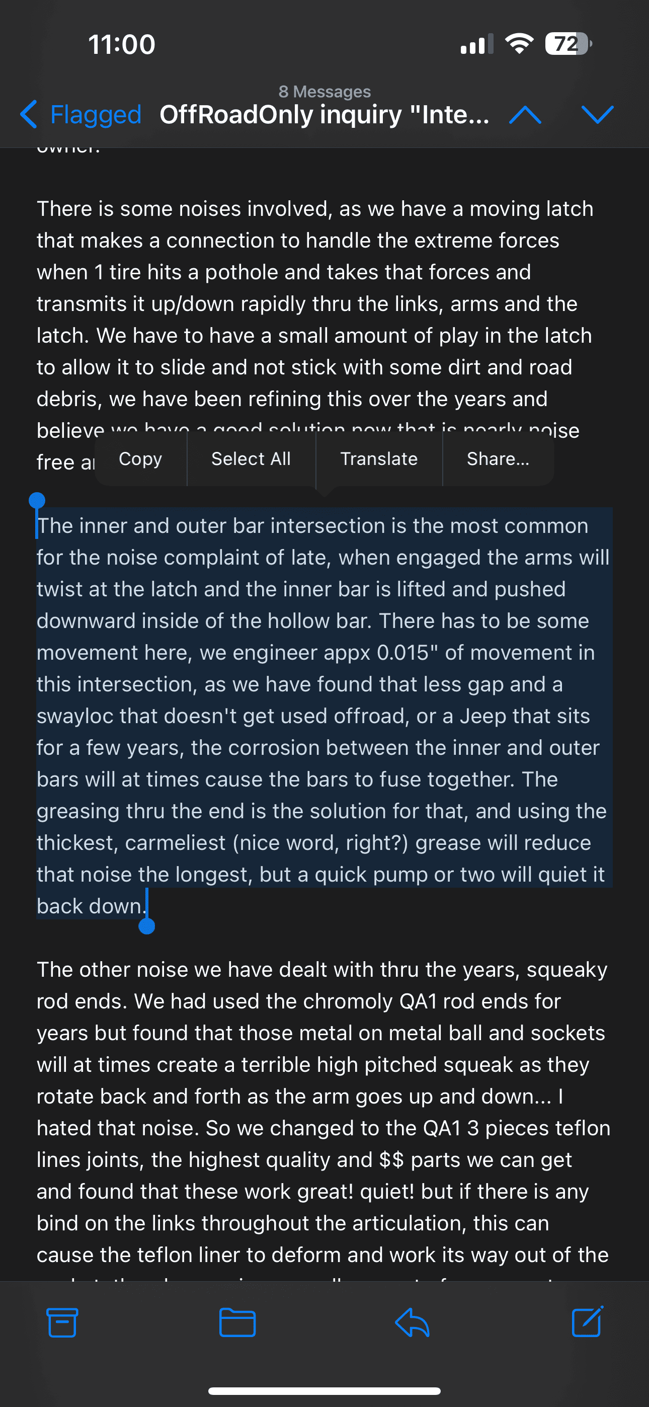

I will say though that when I was looking around between antirock and swayloc, Steve’s response to my email and his responsiveness is what got me to be even more interested as i’ve always been interested. Below is a response to my questions about noise etc.

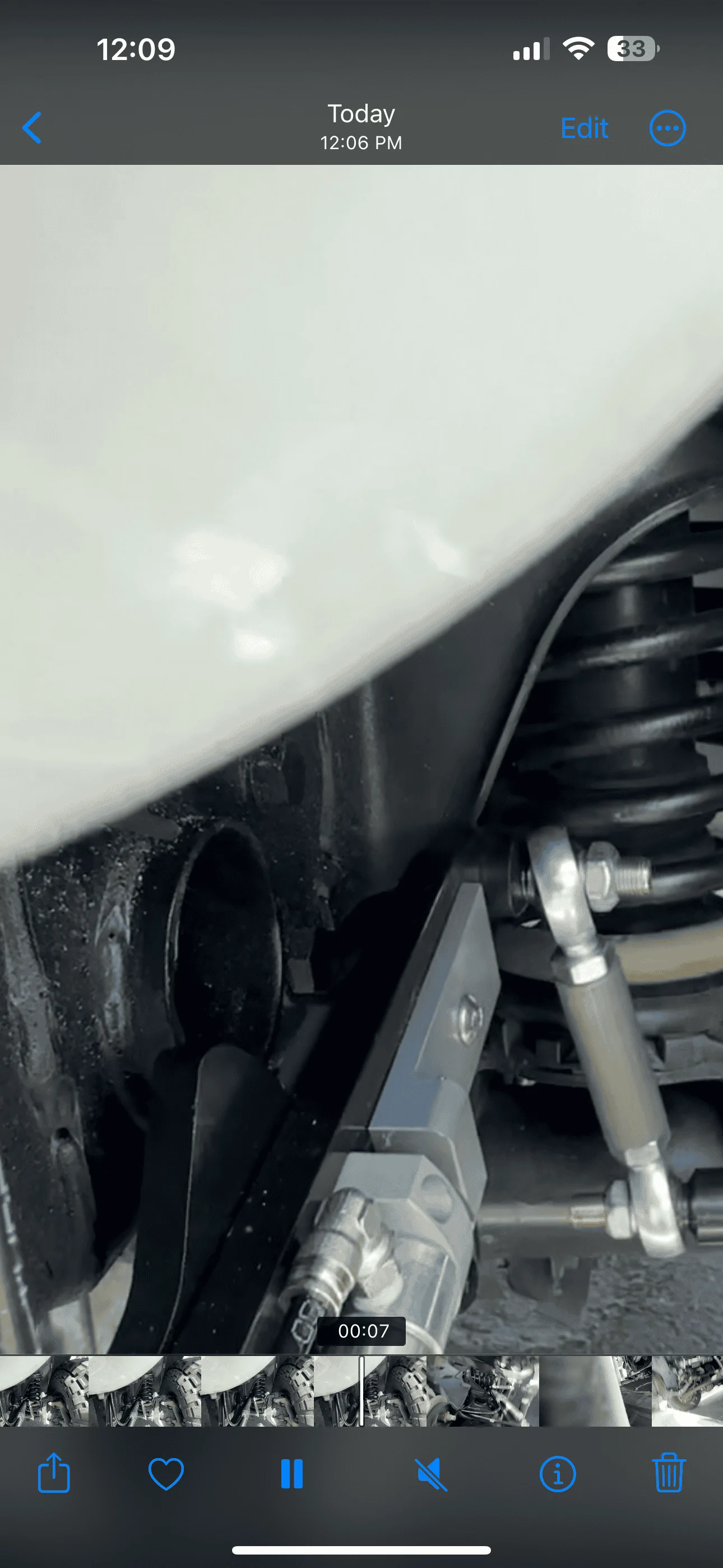

Found a spot im rubbing on, on the spring perch when compressing a couple of inches. Cant really move it back over to driver side since my tire rubs on the cylinder by I also can’t move it to the passenger side any more because i’d run into the frame hole or the spring perch.

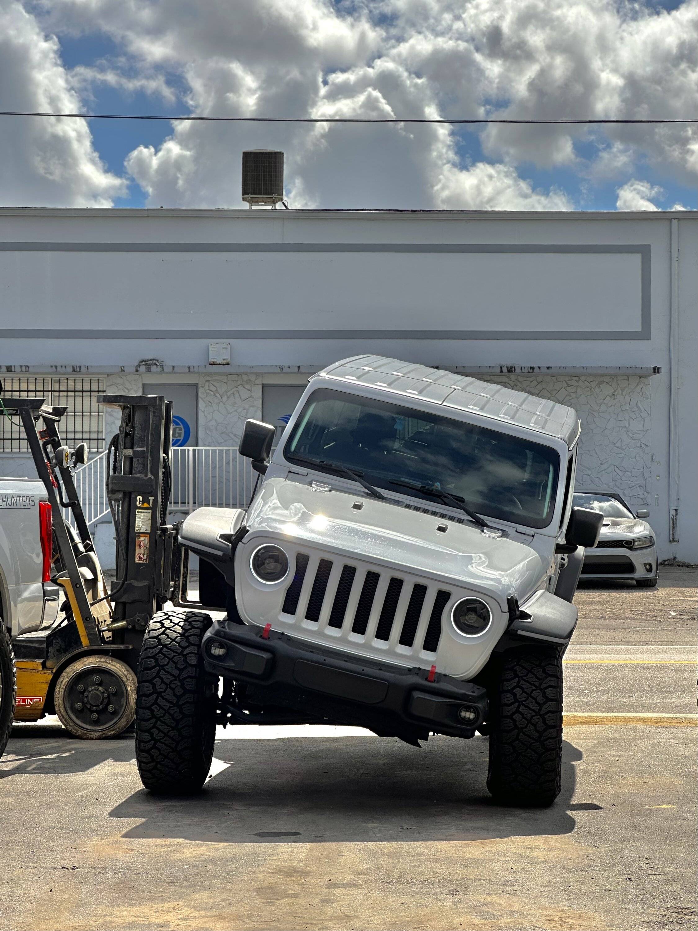

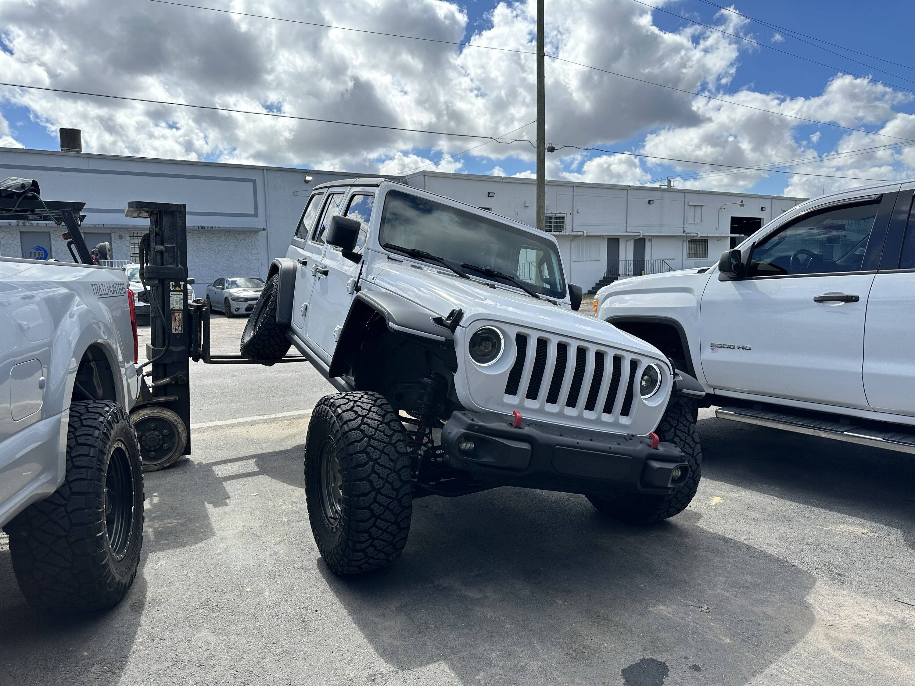

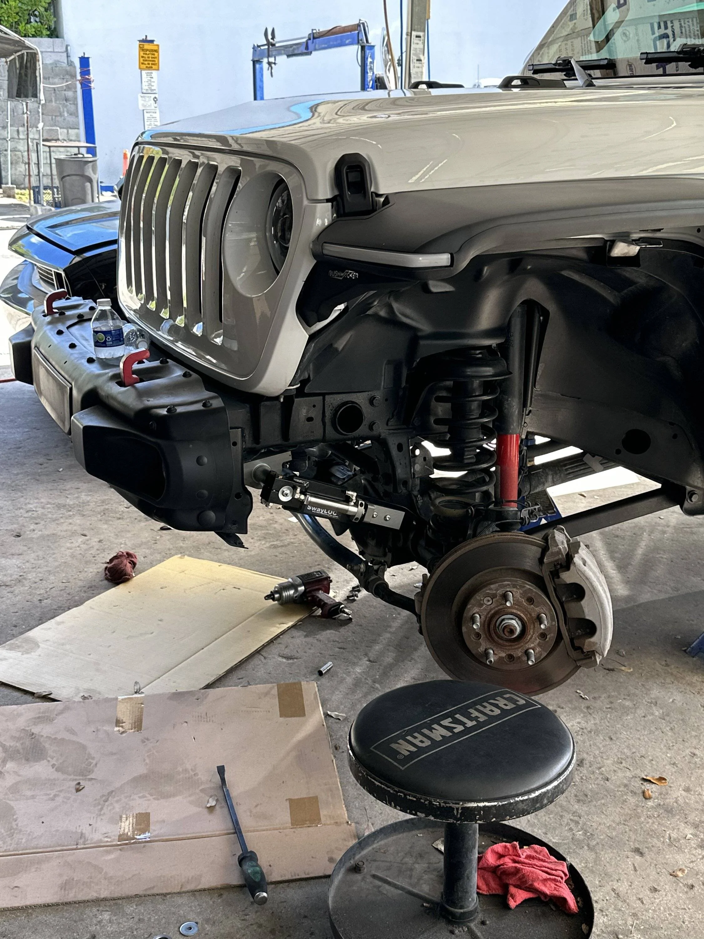

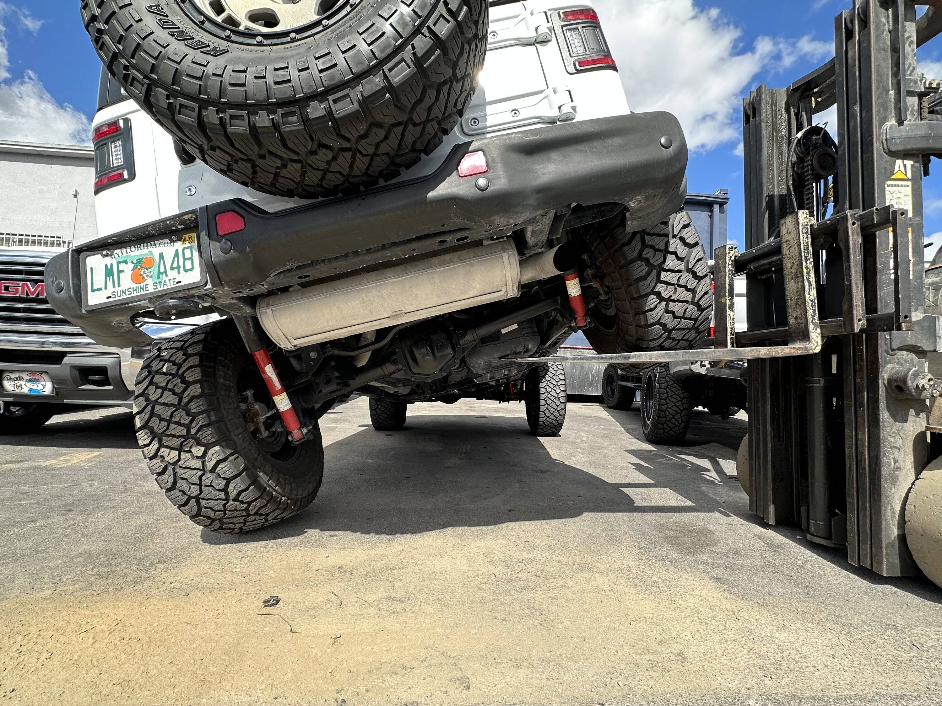

Bumping to add more photos, added rear rubi shocks to the front and re-aligned the sway bar. No longer rubs at full lock at ride height.
