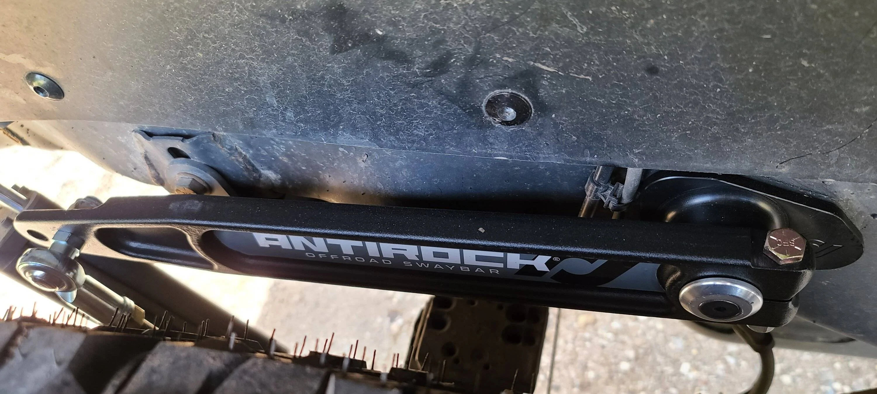

I love the antirocks. . For me it is a very slight difference right at first slight turn in but that's it. Does not change how I drive at all. I still take corners the same. It really is so nice to never have to deal with them on or offroad. You give up very little and gain a lot. I have had the same basic set up ( Carli) on my 2500 dodge for over ten years now and I tow a 5th wheel with it. Same thing. Feel it at first turn in but that's it. Its just the initial body movement after that it feels the same to me. That same effect helps with bumpy roads though. With a stiff sway bar a bump from one side effects the other more. Not as much with the Antirock. If you do buy them I would get the bigger front bar and do front and rear.

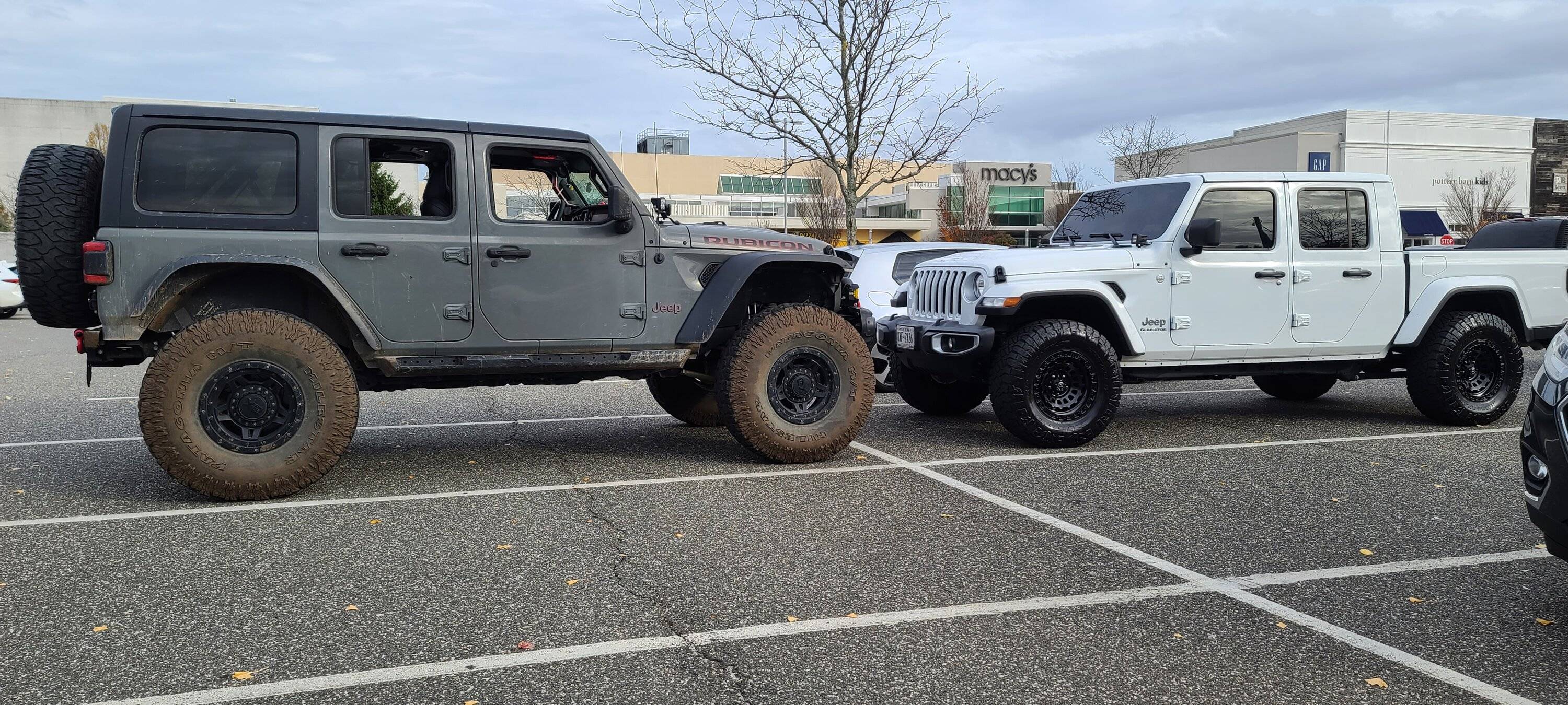

My JLUR is also my daily that doesn't spend as much time offroad as I would like. It's lifted about 6" over factory height and on 40's. I ditched the factory sway bars for front and rear Antirocks about a year ago. My experience has been the same as others above, that the difference in handling disappears very quickly into the first drive with them. Even at my higher ride height, about 81.5" to the highest point of my hardtop, I haven't had to slow down through curves and corners.
I always recommend doing both the front and rear whenever someone's interested in using them. They are specifically designed to function as a tuned system, equally sharing the articulation front and rear and resulting in a far more balanced handling both on and offroad compared to just doing the front alone.
I have the eTorque 2.0, which is supposedly heavier than the 3.6 with standard ESS. I opted for the "JL specific" .770" diameter sway bars front and rear, and have the rear links on the inner mounting hole of the arms which is the slightly firmer position. I did that because I do have a 125ish lb spare on a hinged reinforcement.

And a size reference of my Jeep compared to a Gladiator with the mopar lift and 37's...

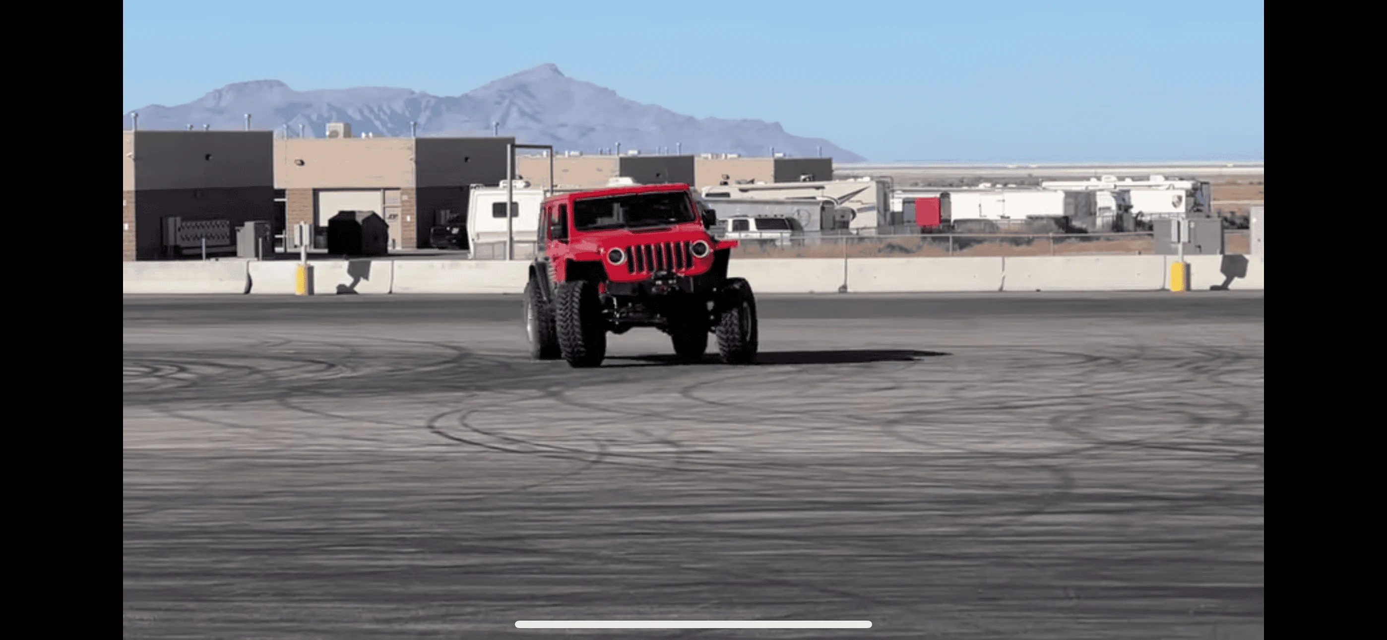

Based on litebrights video, of their demon swapped jeep, the body roll honestly doesn’t look unmanageable.
Jeep Wrangler JL Swayloc or antirock experience? EE4A60E7-2351-4AC0-9311-9104470D0890
this video too at the 4:55 mark.

Warning. This will probably be a bit long. You're looking to make an informed decision so my thoughts are that the more I can share, the better.
I have the Metalcloak Gamechanger with 6-packs. The shocks are awesome, yet have no adjustability. Therefore, I couldn't make any changes to account for the different sway bars. I didn't then, and still don't a year+ after adding the Antirocks, believe that there's any real need for it. The most important thing about shocks is that they are tuned to the springs that they're matched with, the weight of a specific Jeep, and it's intended use. Adjustability is most beneficial to someone that enjoys a softer ride during daily driving, but wants to firm them up to resist bottoming out offroad.
As for the bar thicknesses, it depends on what engine you have and how heavy your Jeep is. The .850's are recommended for the diesel, 392, and 4xe models or for 2.0's and 3.6's that are built heavier for overlanding and whatnot. If used on a 2.0 or 3.6 that isn't heavy, the thicker bars will limit total articulation.
I've added a decent amount of beef, and the weight that comes with it, for the sake of armoring up for rock crawling. On top of a full lift including all 8 control arms and both track bars, I've added 2.5 ton steering linkages, iron knuckles, chromoly axle shafts, winch and mounting plate, rock rails, aftermarket rear bumper and hinged tailgate reinforcement, onboard air, a bunch of lighting, and a wheel/tire combo that weighs at least 125lbs x5. My Jeep is also sitting 10" higher than stock, so it's center of gravity has also risen as a byproduct. The .770 bars have performed just right for my setup. If anything, I may try the outer sway link mounting position (softer of the 2) on the rear arms, because the rear may be a bit too stiff and is not allowing full flex.
My thoughts and findings with the stock front and rear sway bars. The front is tuned for the priority of on road control ability, but can be fully disconnected for enhanced offroad capability. Pretty much the best of both worlds. The rear, on the other hand, is tuned to be a bit stiffer than what's needed on road because it also has to serve extra duty to offset the disconnected front.
Having the Antirocks connected all the time allows for a happy middle ground. Stiff enough on road for everything shy of fast and aggressive driving, but not enough to limit offroad flex. I've found there to be less head toss when one side of the Jeep hits a dip or a high spot in the road, because each axle is being allowed to move a bit more freely. And no more uncontrolled flopping forward when cresting obstacles and the weight of the Jeep transitions from climbing to descending.
Again, just letting myself get wordy for the sake of information sharing both now and in the future when the next person finds this thread during their research phase.
They added the rear Antirock about 2 years ago, because the factory sway bar was hitting the bottom of the frame rails. It gained them another inch or so of uptravel. I had the same issue with my setup. Fast forward to 1 year ago, they finally added the matching front. Here's the video of the front install and their thoughts...
