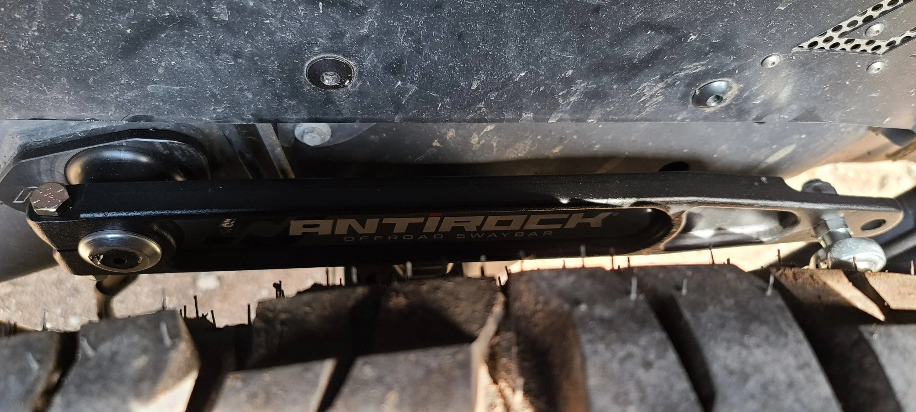

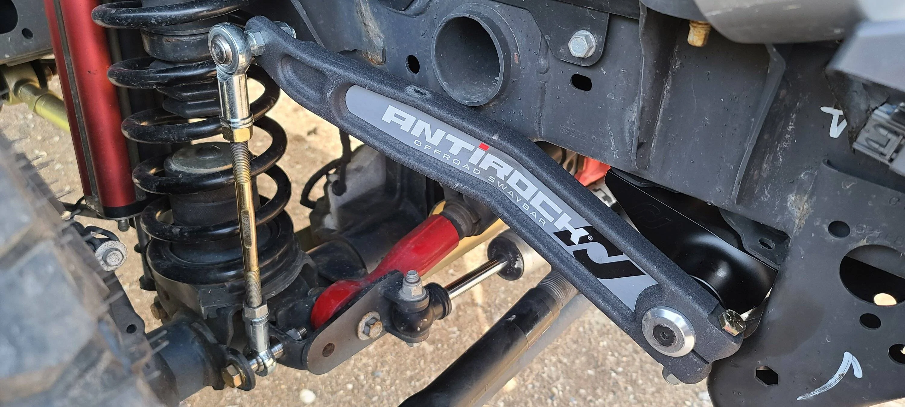

I've had the front and rear
.770" Antirocks on my JLUR for about a year and a half now. Like Moto_21 said, the difference in body roll is immediately noticeable, but not enough that it disappears after a short ride or two.
For reference, my JLUR is on 40x13.5's and sitting about 6" over stock suspension height, courtesy of the 4.5" Metalcloak Gamechanger. My wheels are 17x9 with 4.53" of backspace, so my track width has increased by over 7".

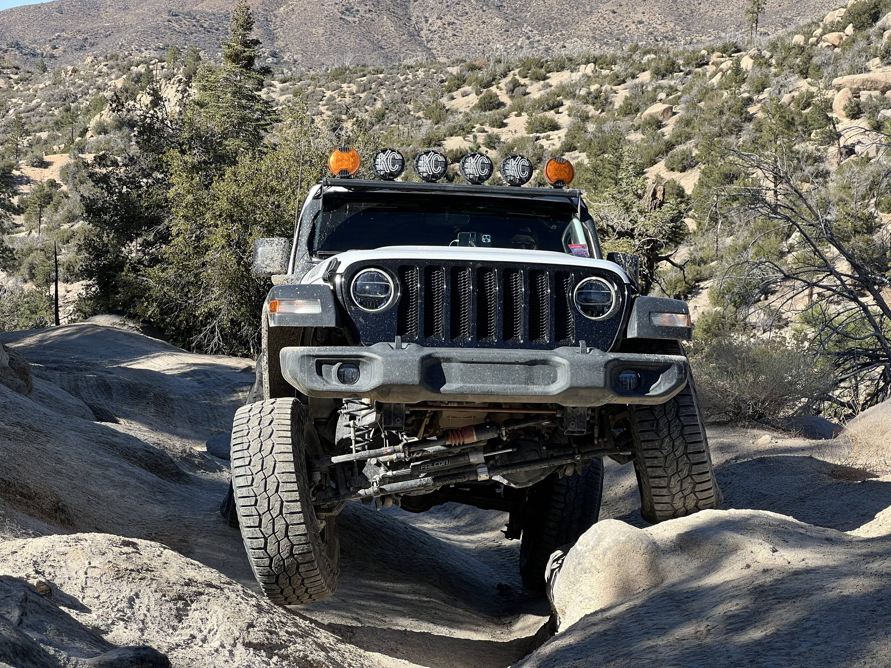

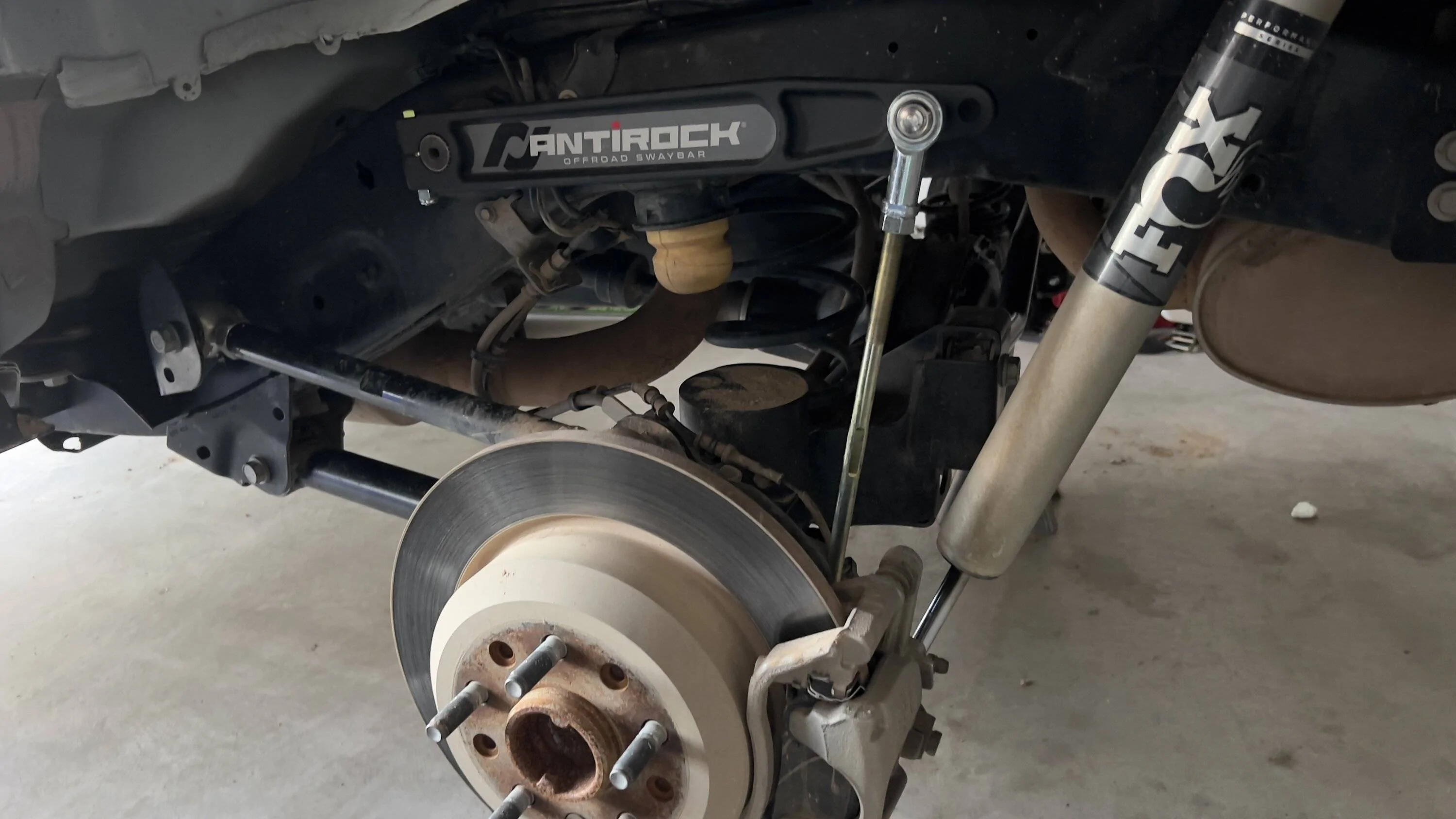

I ran just the front and no sway bar in the rear for about a year and a half, which was a trip to get used to but had no issues once I did. However, about a month ago I finally got the rear one in and it’s a tremendous difference in on pavement manners and off-road capabilities. On pavement is smoothed out a ton of road noise, and off pavement it made body roll nearly non existent. I ran Holcomb Creek the following day and going through the rutted hills was a trip because I couldn’t feel them and the hood stayed completely level the whole time. Crawling was also a cool experience because I could actually feel the crossbody tension happening which increased the stability overall, but I did have to adapt some to this new movement/response from the jeep because it pushed the body quite differently than having no rear (which shouldn’t be an issue for your son).
So TLDR: I could not suggest this setup more highly! But for the JL it is almost a necessity to run both front and rear unlike almost any other rig that typically runs just the front.
a picture showing the hood leveling. I have video on TikTok and IG if that would help: @res68rockin4lo
