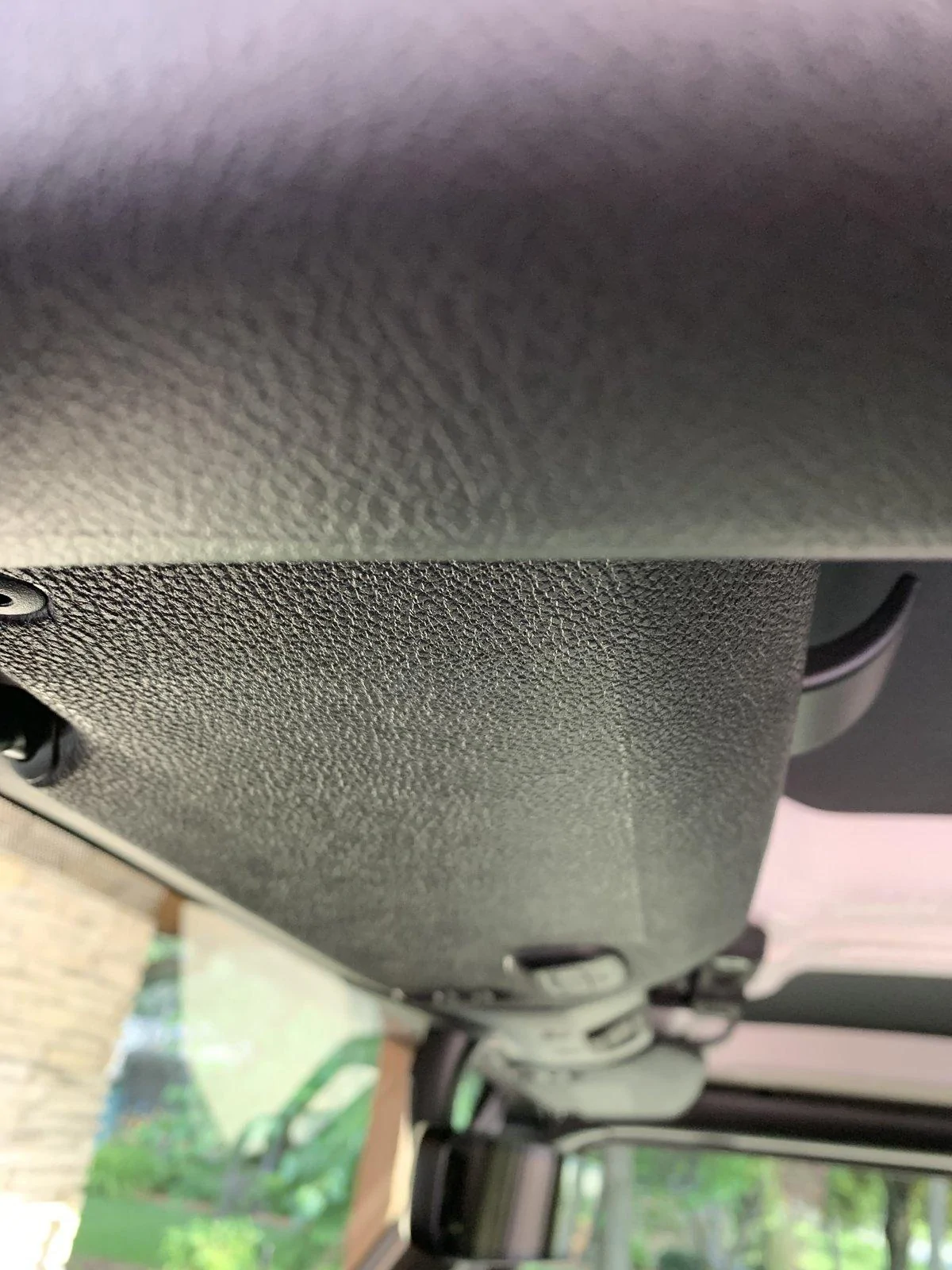

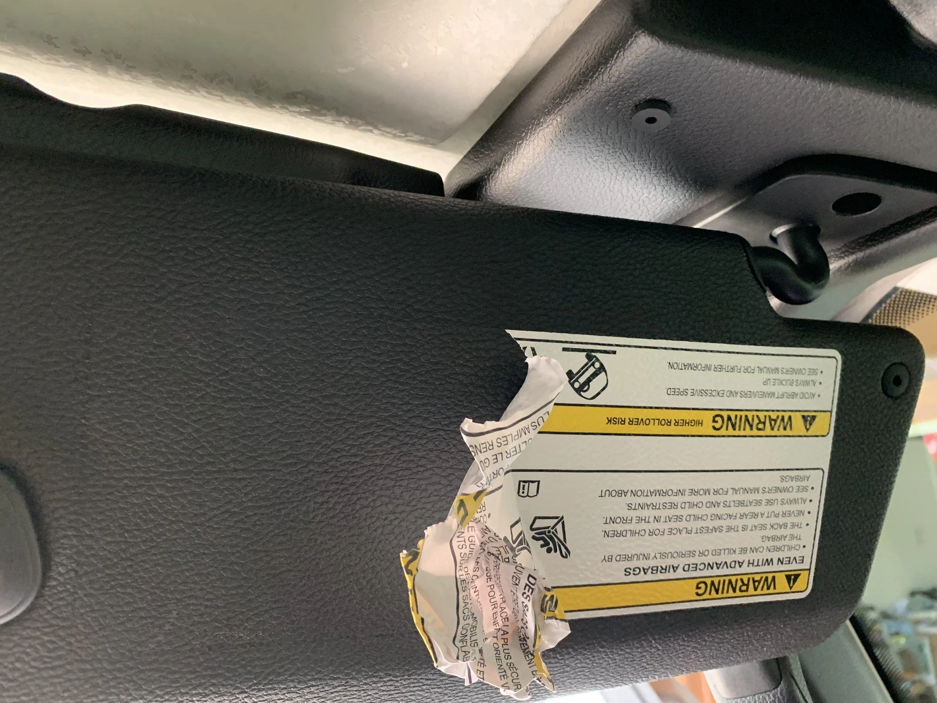

Heat gun or blow dryer to play it safe. Takes a little time to warm it up and go slow. Pull some off, warm again, etc ... all came off one piece. Can see a small shadow, but not too noticeable and that fades over time.

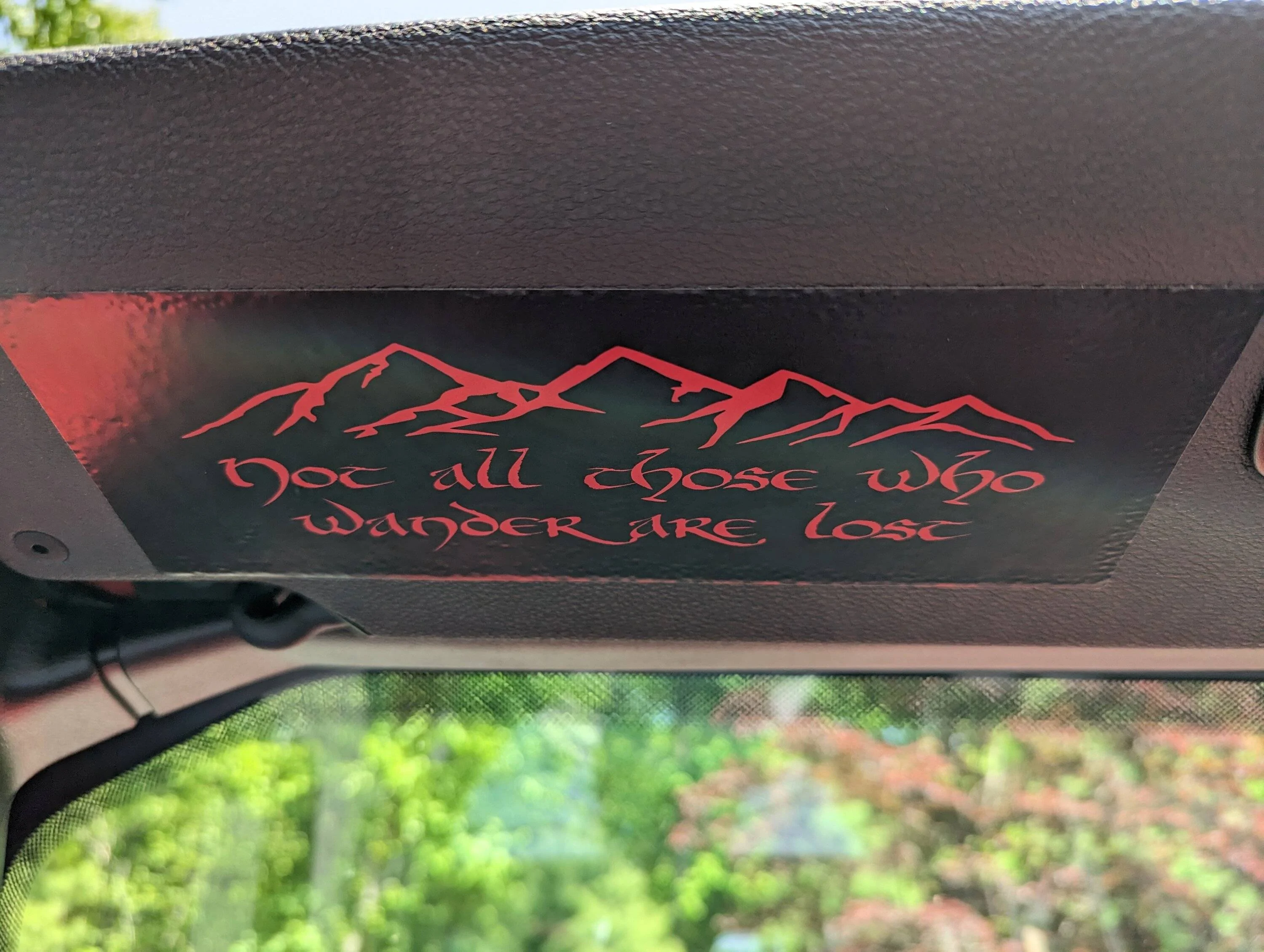

I bought a decal that is the exact same size in black for both sides that says Rubicon and it fits over perfect
Thanks that's one way to fix it, but I wanted them gone as in nothing to see there or peel later. :)

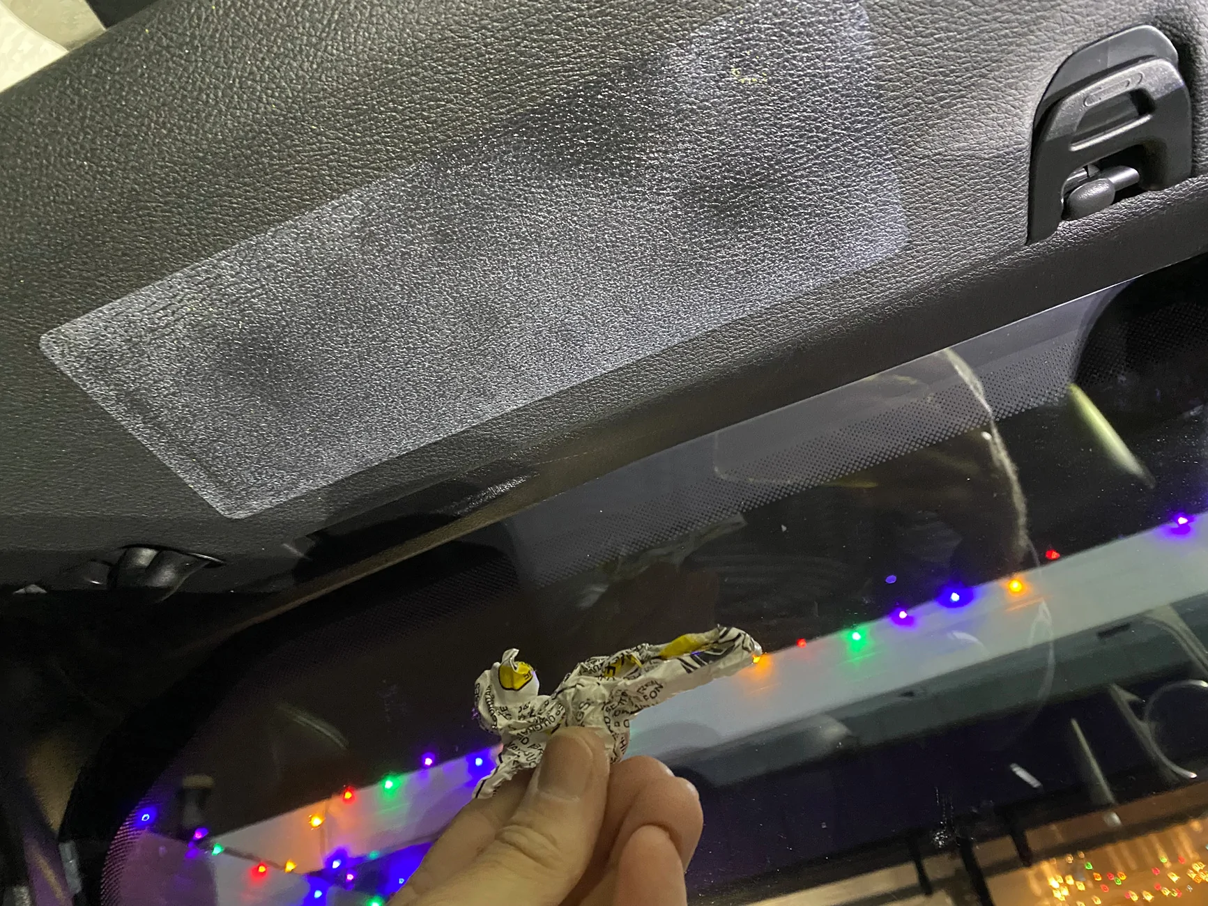

This morning after sitting overnight with GooGone wiped onto them, almost no longer visible.
Jeep Wrangler JL Sun visor warning decal removal mod IMG_7685
Last night right after removal, that's the shrunken leftover from driver's side. Merry Christmas!
