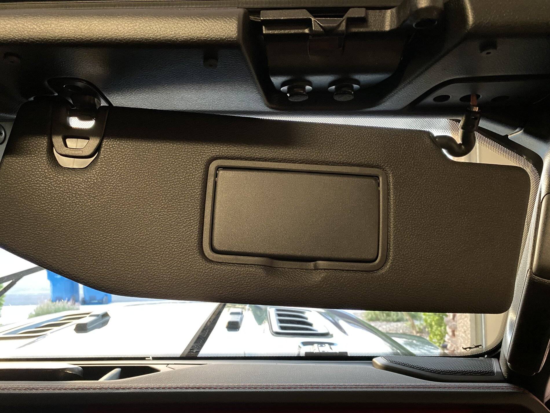

Freaking incredible…bought this vehicle a little over a year ago and my passenger-side sun visor just falls right out. FCA quality at it’s finest.
How long (mileage) until the dealerships manage to weasel out of fixing it under warranty?

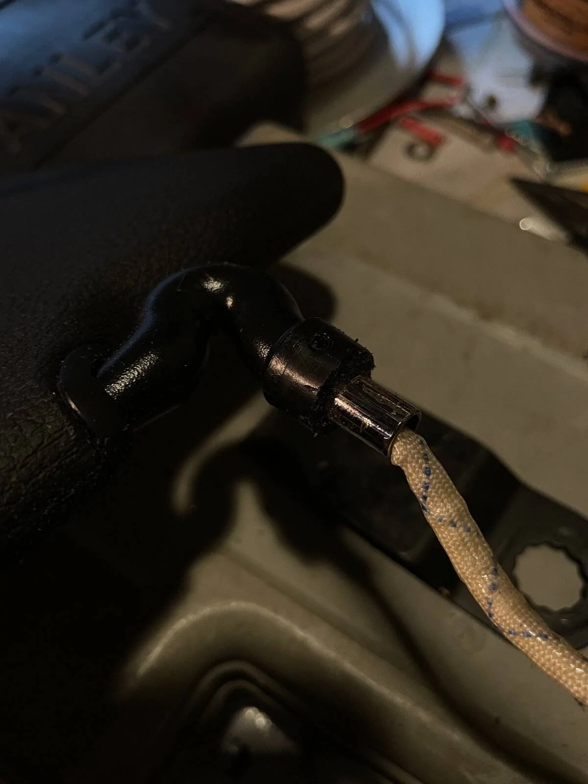

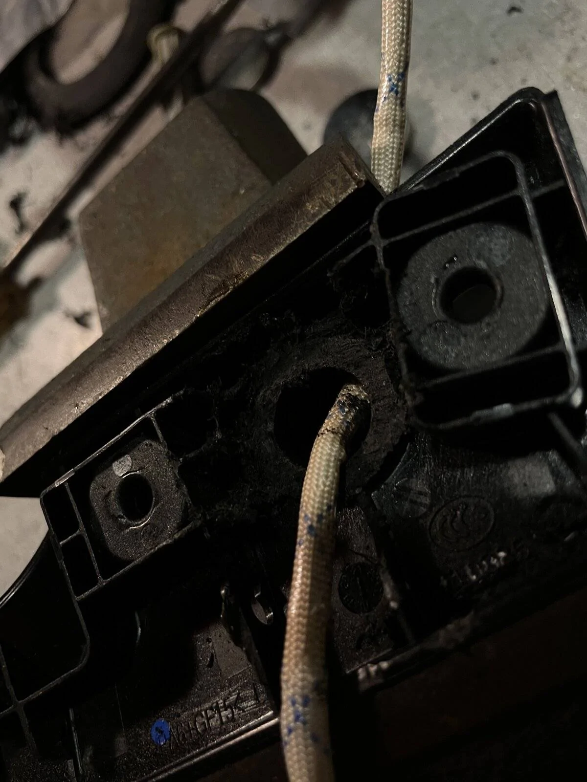

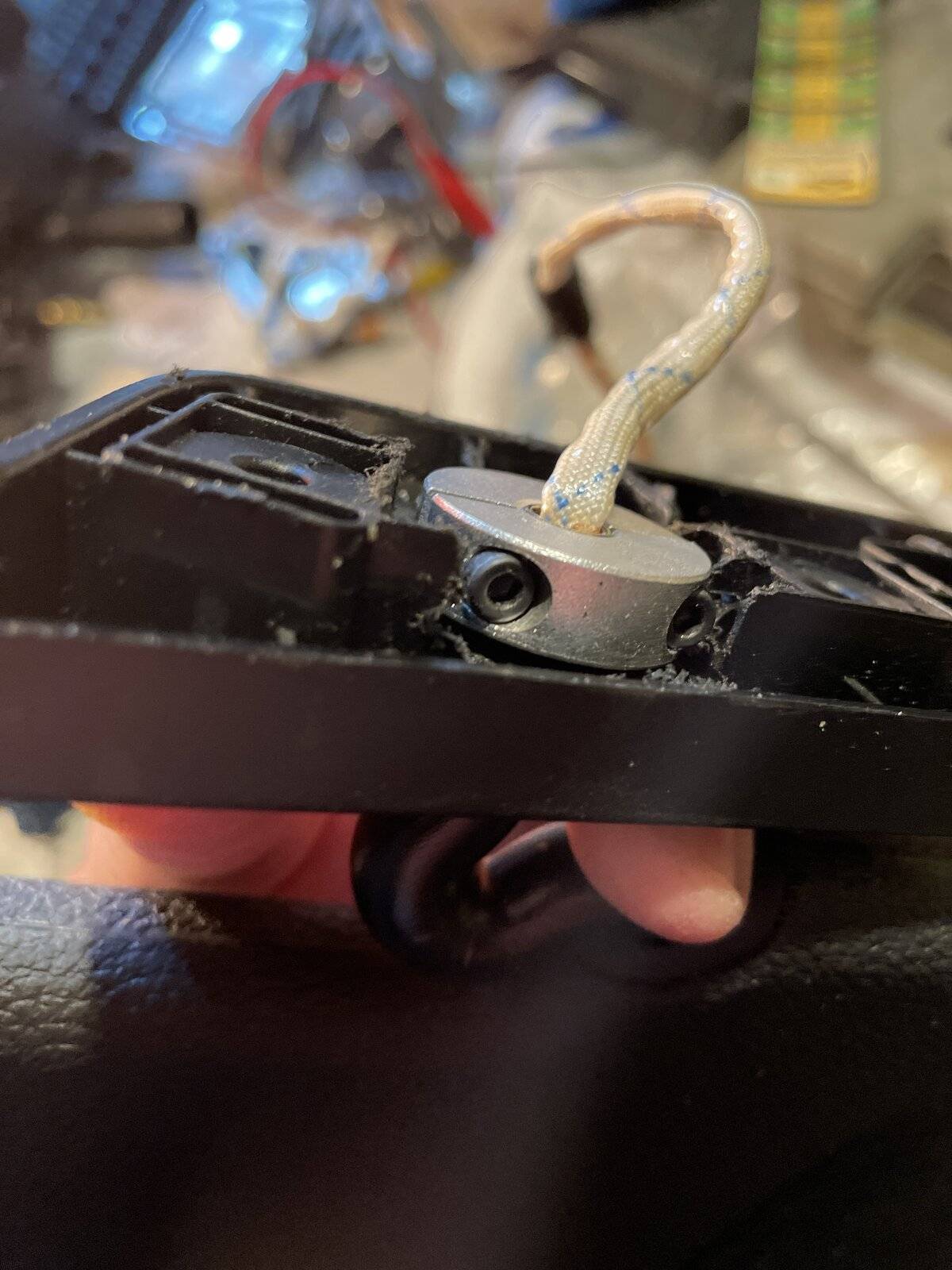

What a horrible design by Jeep. Here is my fix. Seems to be holding up.

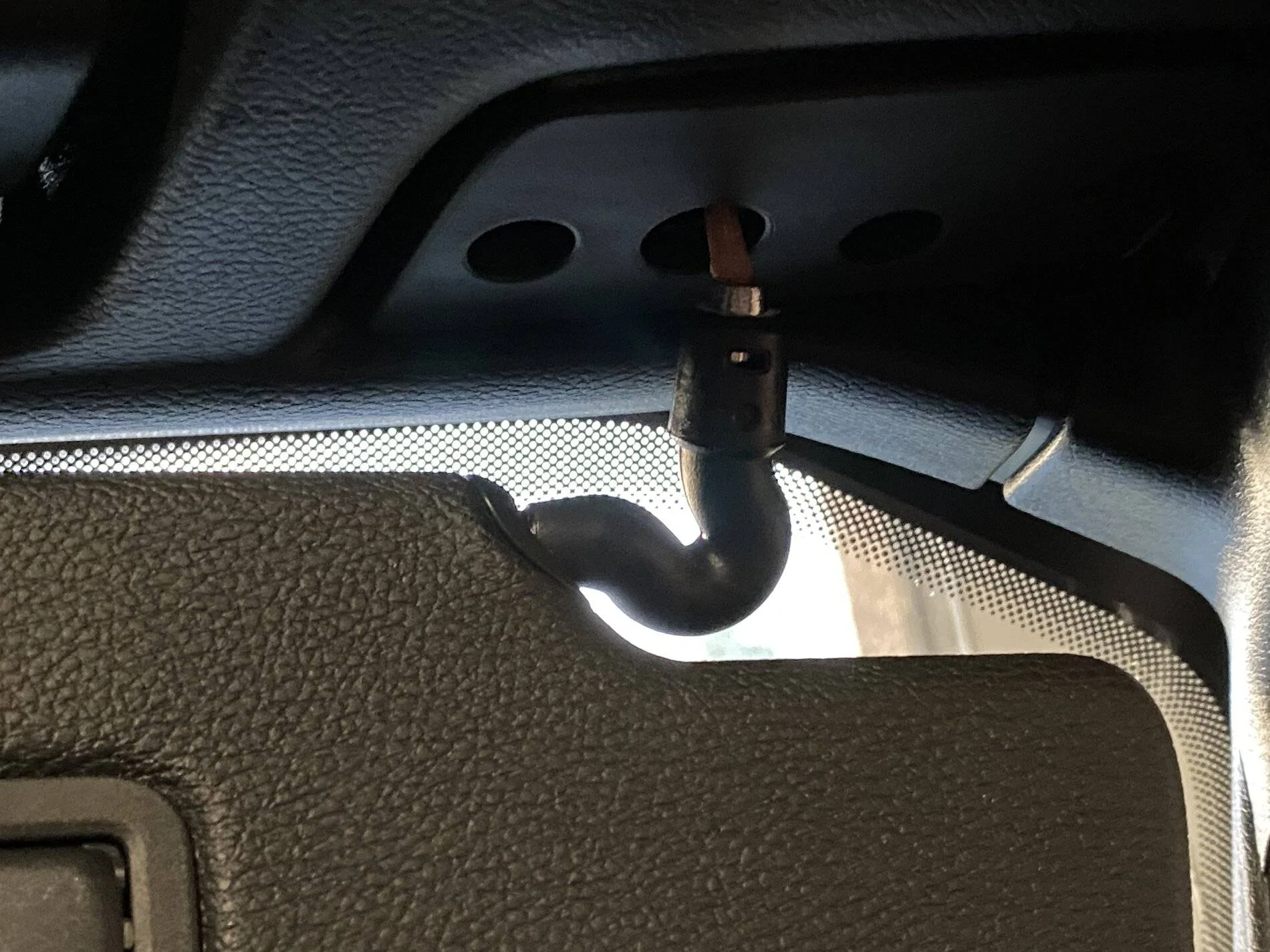

My wife was driving the Jeep the other day and the sun visor broke while she was driving. Since she drives South in the morning and North in the afternoon, she usually has it out across the side window. While she was driving the visor suddenly fell and would not stay up. I took off the screws that hold it and found that the plastic piece that goes around the metal had broken right at the mount, so now it will not stay in the mount. The visor is currently hanging by the wire on that side if the other side is not clipped and you can't use it at all.
Have an appointment at the dealer this weekend for them to fix/replace under warranty. Currently just under 1 year of ownership and about 17K miles. Will update with resolution from dealer. Just wanted to share if any one else has this issue.
I know this image is not great, but I had enough light to see the issue and did not want to move the Jeep outside for a picture.
