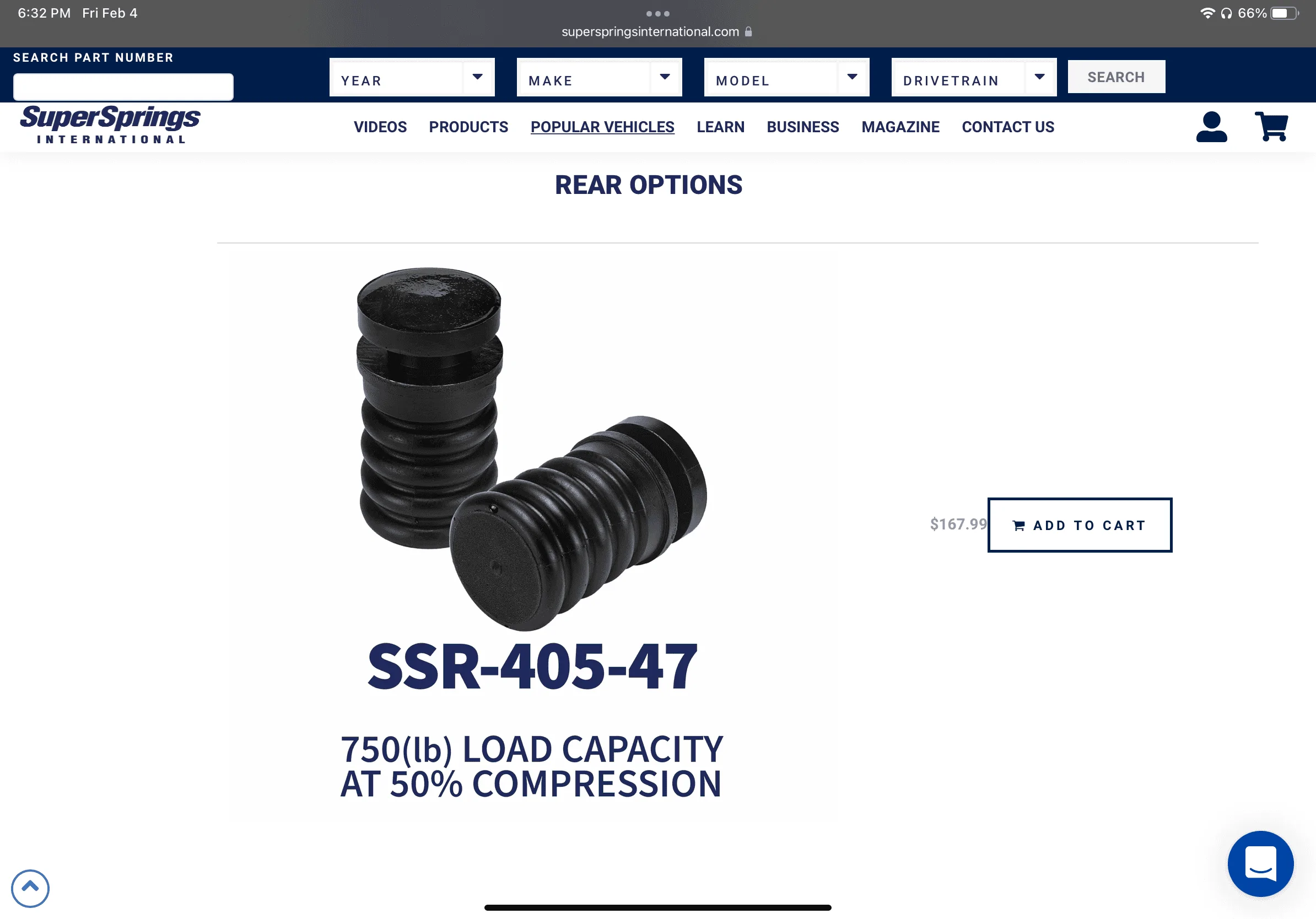

@robynE I have both the Supersprings Sumo Springs in the rear, and the AirLift 1000 airbags for the rear. To echo what @Terminex said, you will likely want the AirLift Airbag 1000 if you are concerned about towing. Do some searching on the forum. I’ve done a detailed write-up on the correct Airlift kit, and even some installation tips.
It’s important to note that supersprings makes all different kinds of these products. Some of them are in contact on top and bottom, and working at all times, and others (like the sumo springs for the Wrangler JL) are only attached at the top, and are only “working” under very heavy loads or bottom-outs. They are just replacement bump stops that are longer, and made of a stiffer material, with a higher load rating. See pic below:
Jeep Wrangler JL SumoSprings for 4xe? 2C9F2DF8-4E2B-4DE5-91A1-3FBF1100C6F9
It would require the spring to push through much of its travel before the sumo springs would make contact, and have any effect.
The airbags, on the other hand, sit inside the rear coil springs, and are in constant contact with the top and bottom of the spring mount, as well as with the interior of the coil spring as it spirals all the way from top to bottom. I can dial in the pressure on the airbags with a bicycle pump and instantly stiffen the rear suspension. A real game-changer if you are camping with heavy loads, have a roof-top tent, and/or are towing.
I only have the sumo springs because I bought them second-hand, but unused for a price I couldn’t resist. But they don’t really help with squat or body roll. So I got the Airlift airbags shortly thereafter, and honestly, I doubt the sumo springs have ever “bumped” even once! But I suppose if I had an Airlift airbag failure the sumo spring bump stop would be a good backup

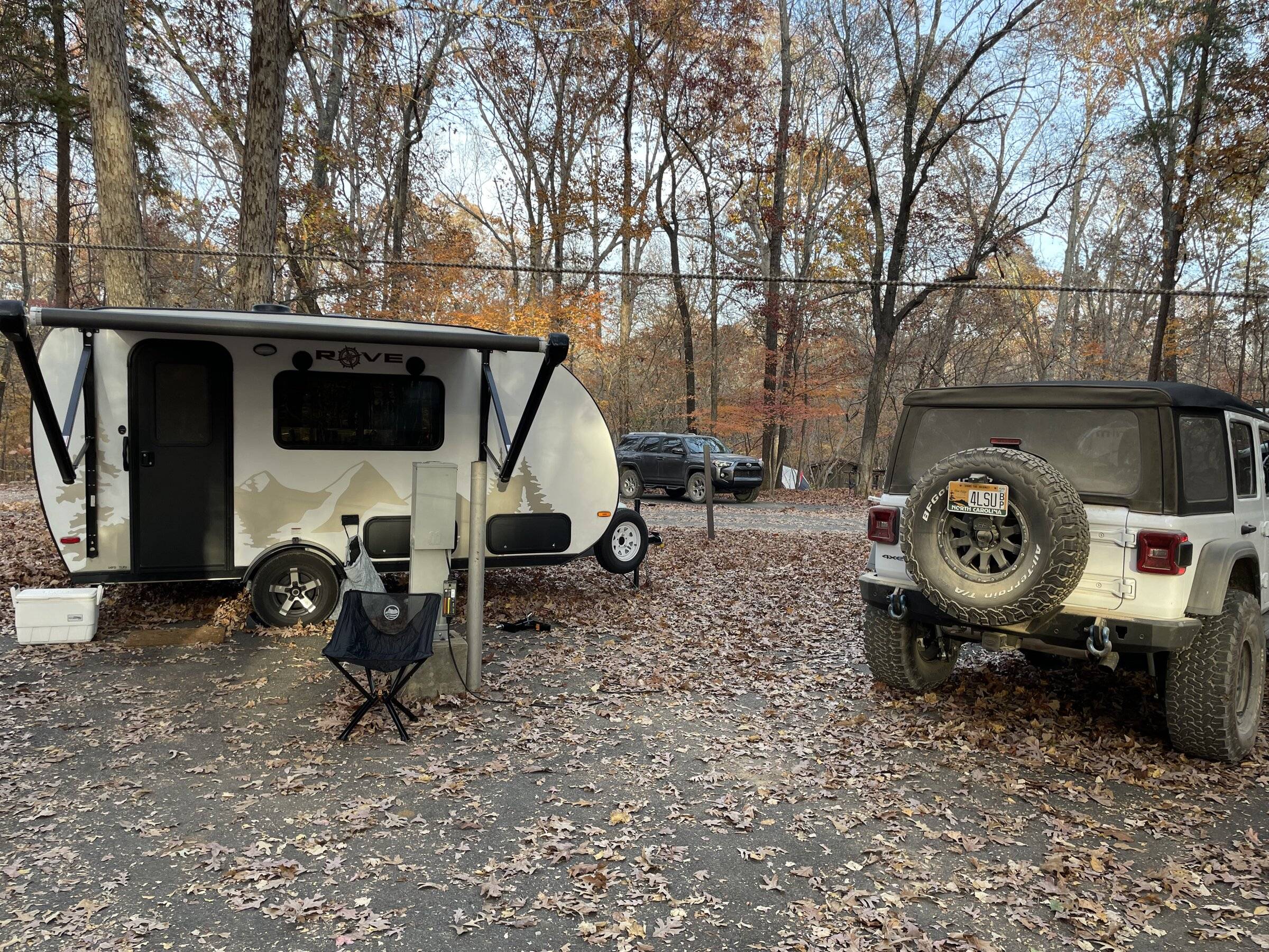

We’ve only towed a Rove Lite ~1800 LB camper (outdoorsy rental), but couple notes.
Headlight adjustment is super easy with a long screwdriver. Be worth a quick check so you don’t get flashed anytime you’re towing at night.
I ended up with an adjustible hitch to get a nice level trailer, the pump out was pretty low, so it helped clearance to get the tongue down level.
The Rove Lite has a pretty short tongue and a spare mounted on it, had to be cautious on turns backing in.
