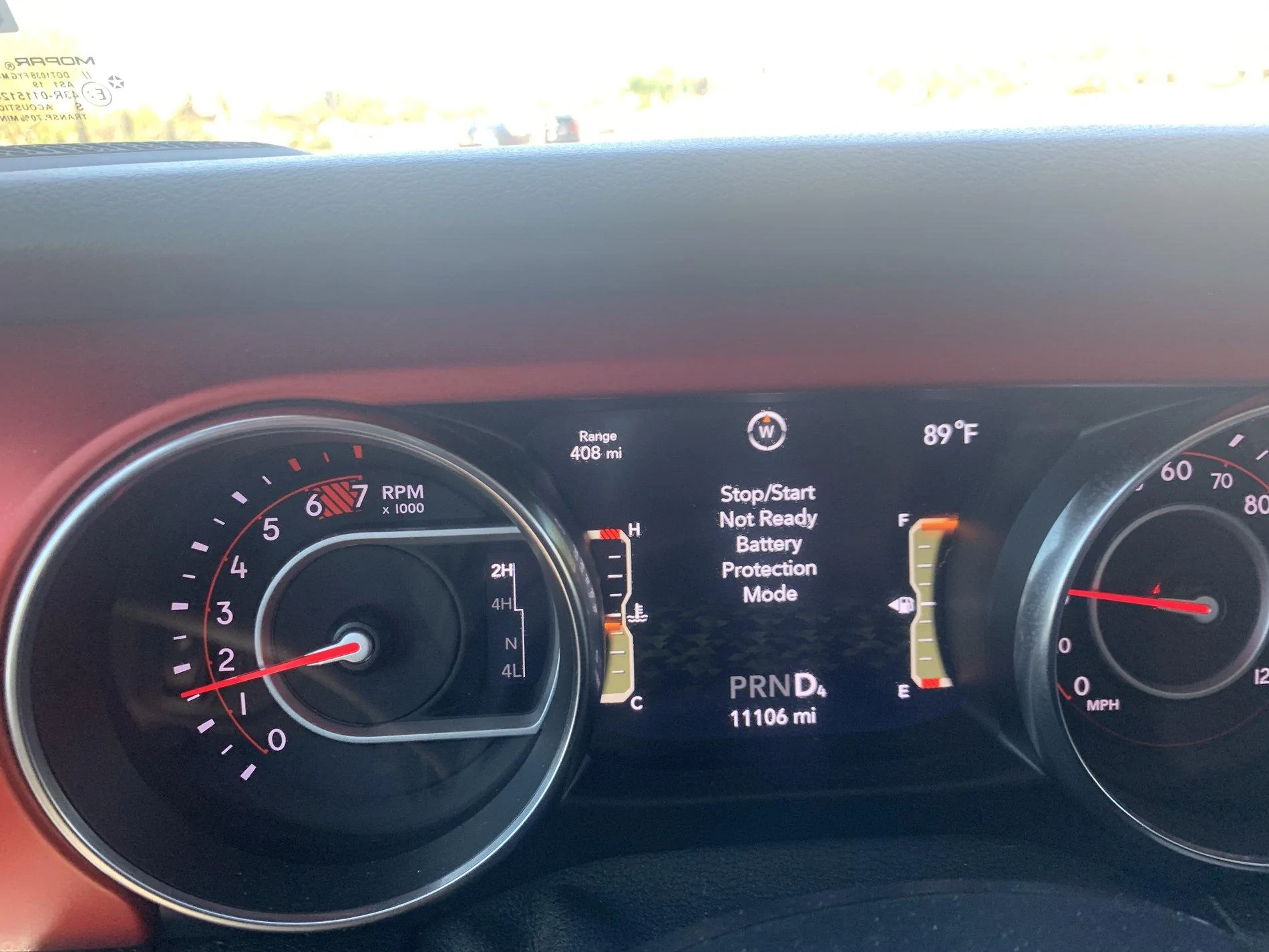

I gave us a good try this week. The issue did not fix itself just as I was told after a new battery, software update, and new sensor.
I am hoping to not get the same message the next time I pick the car up.
Planning to drop the car off Sunday night for the 6th time in 6 weeks. Hoping to get some resolution this time as the $25 Uber trips are adding up!
