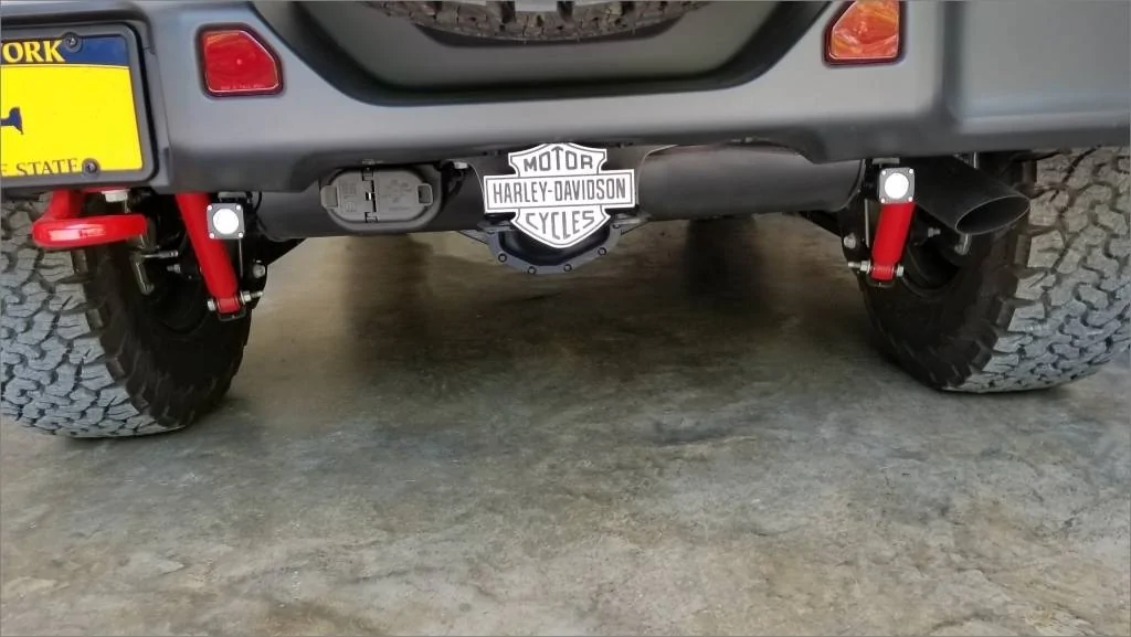

I ended up doing the muffler delete like these folks mentioned doing. Just less crap to drag on something. Just make sure the state you live doesn’t require an annual vehicle inspection unless you want to swap the pipe back and forth

Muffler Elimination Pipe is a way to go... but, if you do a lot of high speed interstate driving the noise/the drone you have with the muffler elimination pipe will drive you/most bonkers.
Around town aok but on the open road at speed.... not so at all.
Yes, I'm 73 yo and am a Harley Fatboy rider.... and am used to noise.. ;) Felt same same about muffler elimination pipe drone at higher speeds even when I was much younger.
and then there is the State Inspection issues associated with the muffler elimination pipe. And most Wives/Gal Pals wouldn't deal well with the drone..
