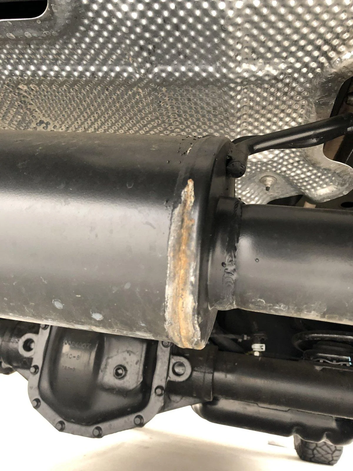

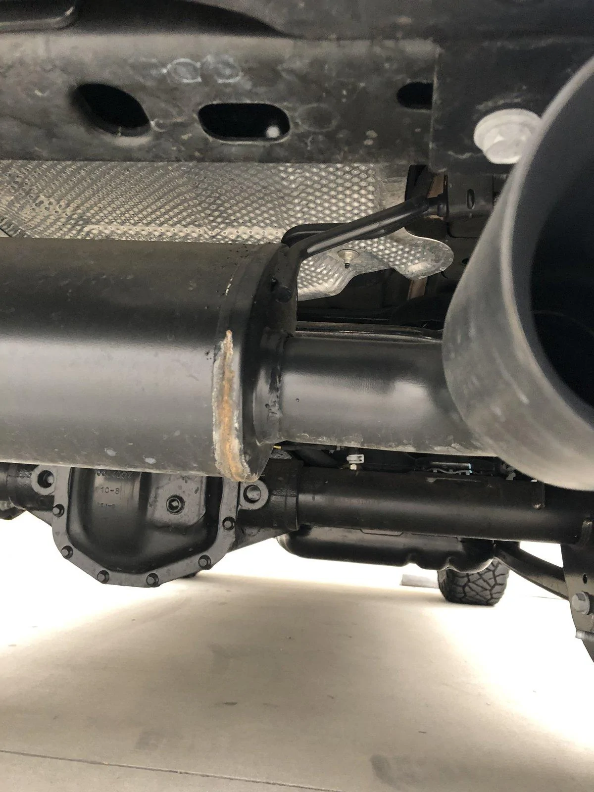

Got it like 4 months ago from northridge4x4. Its rusting. Northridge helped me alot to take care of this matter. But magnaflow wants this back before make decision. I do not have stock to replace it. Specially when i had to pay for the install because pipe was too tight for my self to install. Anyways. Is this normal to have rust? Im just gonna use it for now see how it will hold up. Not a big deal.
Jeep Wrangler JL Magnaflow black axleback rusting 08EDB713-CFBD-496A-8912-2C4AB4F021A8
Jeep Wrangler JL Magnaflow black axleback rusting 6446EF28-AA84-4FB2-8F48-ECE9C23407DC

Looking at the photos, it looks as though you scraped the edge of the muffler on something and rubbed the finish off, which would allow for the rust.

That stinks, but if you hit it with sand paper and break cleaner then spray it with som high temp paint I think you will be happy with how it holds up. May need to do it once a year to keep it up though.

Hi Timkim, as Jimmysmith mentioned, it appears you are getting some light surface rusting after the ceramic coating was scraped. This should not affect the structure or performance of your muffler, but we would be happy to take a look at it under our warranty. Your system comes with a lifetime warranty against any defects and 1-year warranty on the black coating if you change your mind and decide to proceed with the claim. If you ever have questions about what is covered by your warranty, please do not hesitate to call our customer support line at 1-800-990-0905 or shoot us a PM!
