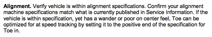

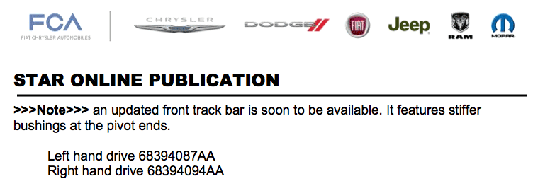

Star Case Updated - The original star case about loose steering S1819000003 is here - https://www.jlwranglerforums.com/fo...has-play-and-drifts.3691/page-142#post-426243
Below are screen captures of the updates to it that occurred on Feb 26 2019 are here. And of course, it says to CHECK TORQUE - torque specs here - https://www.jlwranglerforums.com/fo...rangler-jl-steering-related-components.18510/
And here is the toe spec -
Interesting. Anybody know why it says for 4-door only?
