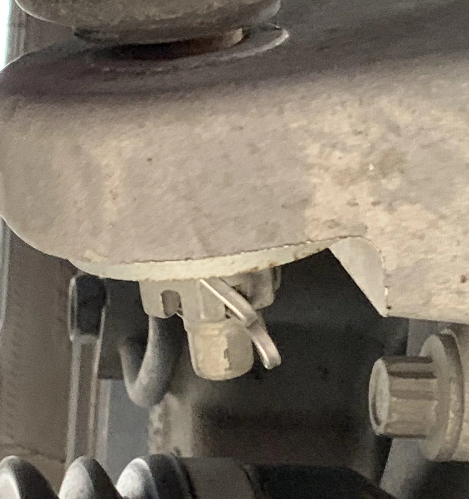

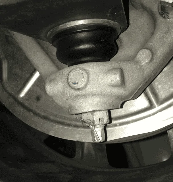

Poolman and Xpsruler - did your dealerships check torque? Look at the front ball joint nut cotter pins (two upper and two lower). Are they factory perfect or looks like a human bent them in place? If perfectly bent like a factory machine, they didn't check the ball joints torque. If they look kinda mangled or messy like a human used a pair of pliers, then they most likely checked.
Jeep Wrangler JL Steering wheel wobble? Screen Shot 2019-03-06 at 5.41.22 PM
Jeep Wrangler JL Steering wheel wobble? Screen Shot 2019-03-06 at 5.40.31 PM

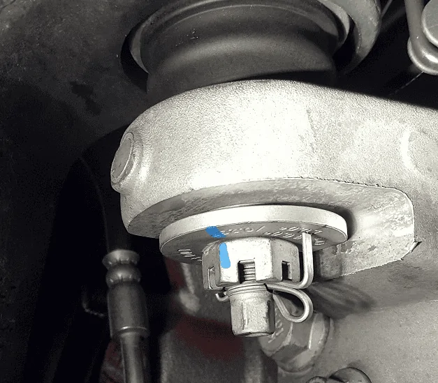

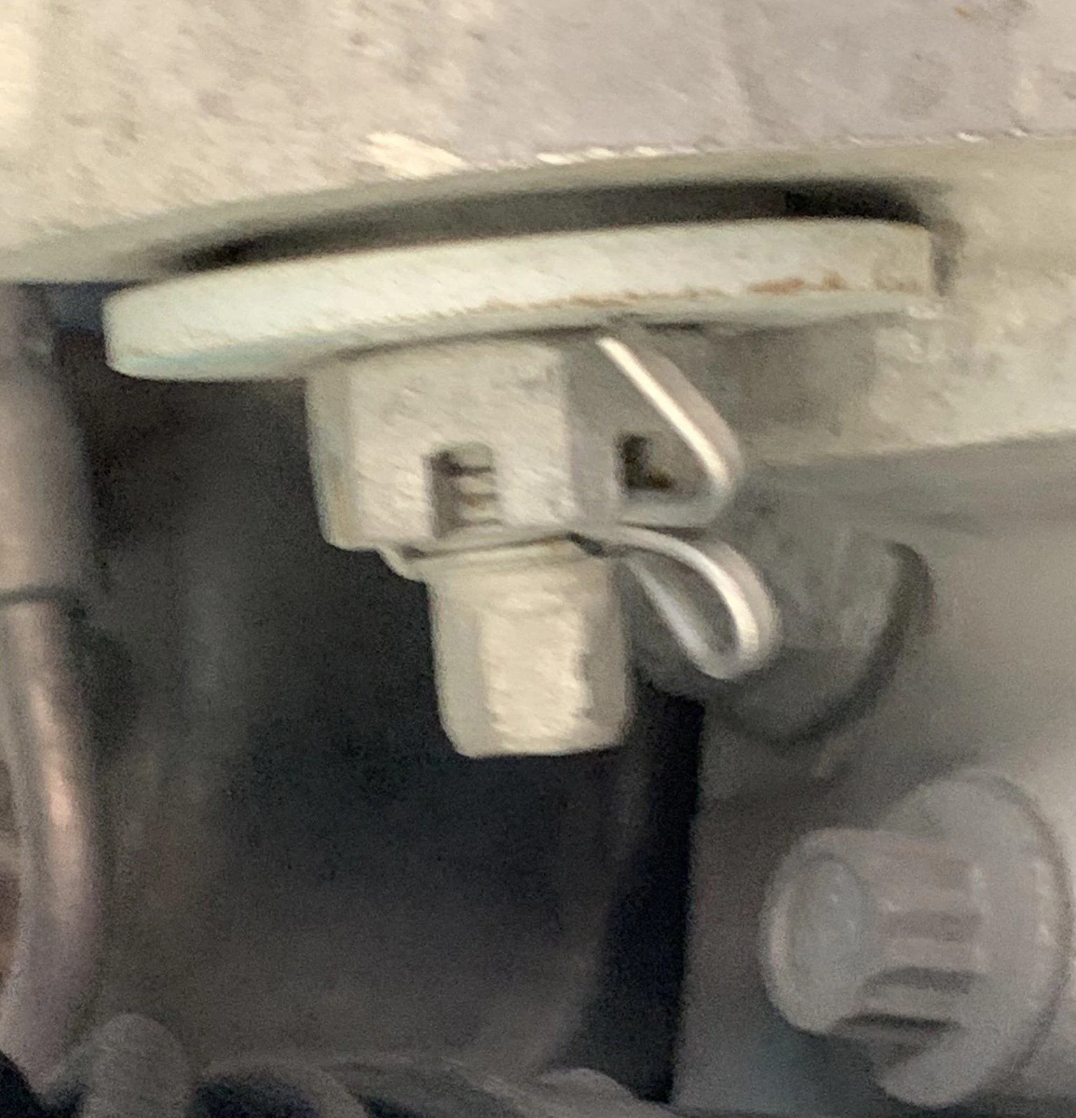

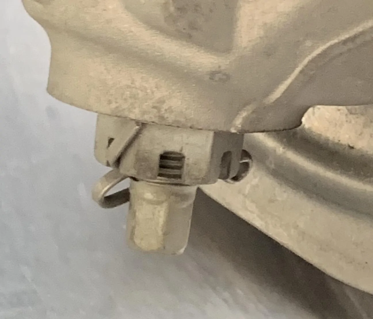

Californiajeeping,
Thanks for the info!
It seems the original factory ball joint cotter pins are still in place, so unlikely they did more than replace the steering stabilizer.
Jeep Wrangler JL Steering wheel wobble? 8389A0F2-925D-4B44-83CA-39B94B37342B
Jeep Wrangler JL Steering wheel wobble? 4079450D-474F-44BD-920E-D27928D83BCE
Jeep Wrangler JL Steering wheel wobble? FC572E73-1483-4711-9BF2-74A3DBBE32E2
Jeep Wrangler JL Steering wheel wobble? AA4B59A1-EB16-4D59-8939-A6591480E29E

There have been posts where people pulled the cotter pins and could remove the castle nuts with their fingers, no tools needed. Seriously loose. Other times, it wasn't that loose, but took several full turns to get it to the proper torque amount. Click here for the JL torque numbers.

Cali - just curious if you are experiencing the same issues with your Jeep? And thanks for being so involved with all these steering posts and continued efforts on all the useful information.
Yes, I had steering wheel wobble, not full on death wobble, but I did have to slow down for it to stop shaking. Found super loose ball joint nuts, semi-loose track bar bolts, drag link bolts, tie rod bolts. Wobble problem completely gone after torqued to spec. 2 dealerships had claimed they checked torque. They obviously didn't. I had read on one of the forums about checking the cotter pins to verify the dealer checked them or not. For many with steering wheel shimmy, wobble or death wobble it appears to be a combination of multiple issues vs just one such as, but not limited to loose steering and suspension components (which are sometimes causing steering stabilizers to go bad, beyond the known bad ones with the date codes if not caught in time), alignment (adjusting toe, adding caster via longer lower control arms), tires that need balancing (there might be a chance that the tires are balanced at 48 PSI at the factory, then drastically changing PSI to 32, 30 could cause a balance issue, not sure if I believe that one but worth getting them balanced in case) and dead spot in the steering box (either tighten or replace the steering box). And Mopar has a new (mid Feb 2019) JL track bar and new inner drag link, which might be helping as well.
