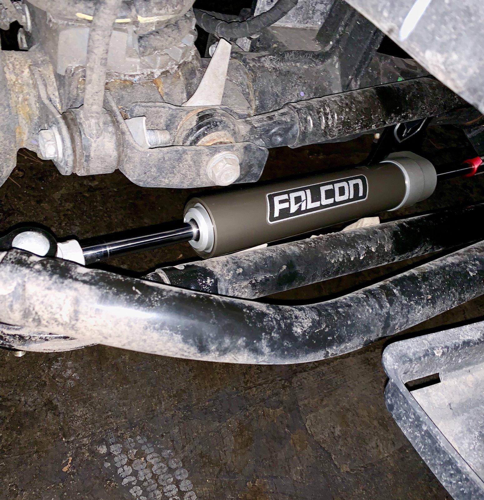

Tired of Death Wobble? Try a new Stabilizer shock this falcon 2.2 Adjustable is amazing. Factory one failed me at 4K miles, I could feel the road it was getting annoying fast. Totally worth the money if you feel like your shock is worn out especially with larger tires
Is your wobble issue still gone or has it come back?
