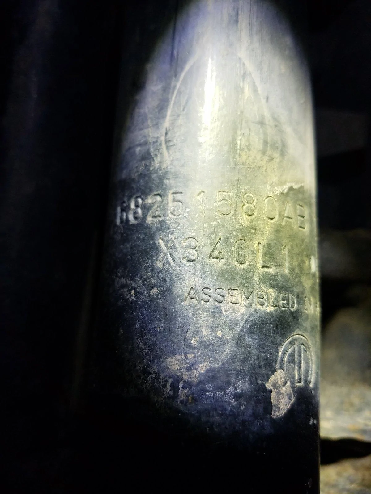

Hi everyone. A quick update. I sent an email to the dealer’s service manager explaining the wobble which developed over the weekend and sent him a picture of my steering stabilizer which has a date stamp of “151” which indicates it should be replaced. He didn’t even ask me to bring the Jeep in for inspection – just said he immediately ordered the new stabilizer (which is now on back order) and will replace on warranty when it’s in.
When was your Jeep built if you don't mind me asking?

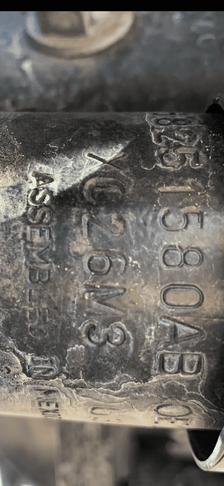

I’m having some issues the M3 on end is different than picture
Jeep Wrangler JL Steering wheel wobble? E2D3C625-6BC9-4220-B7D3-A67DE1B5E315
