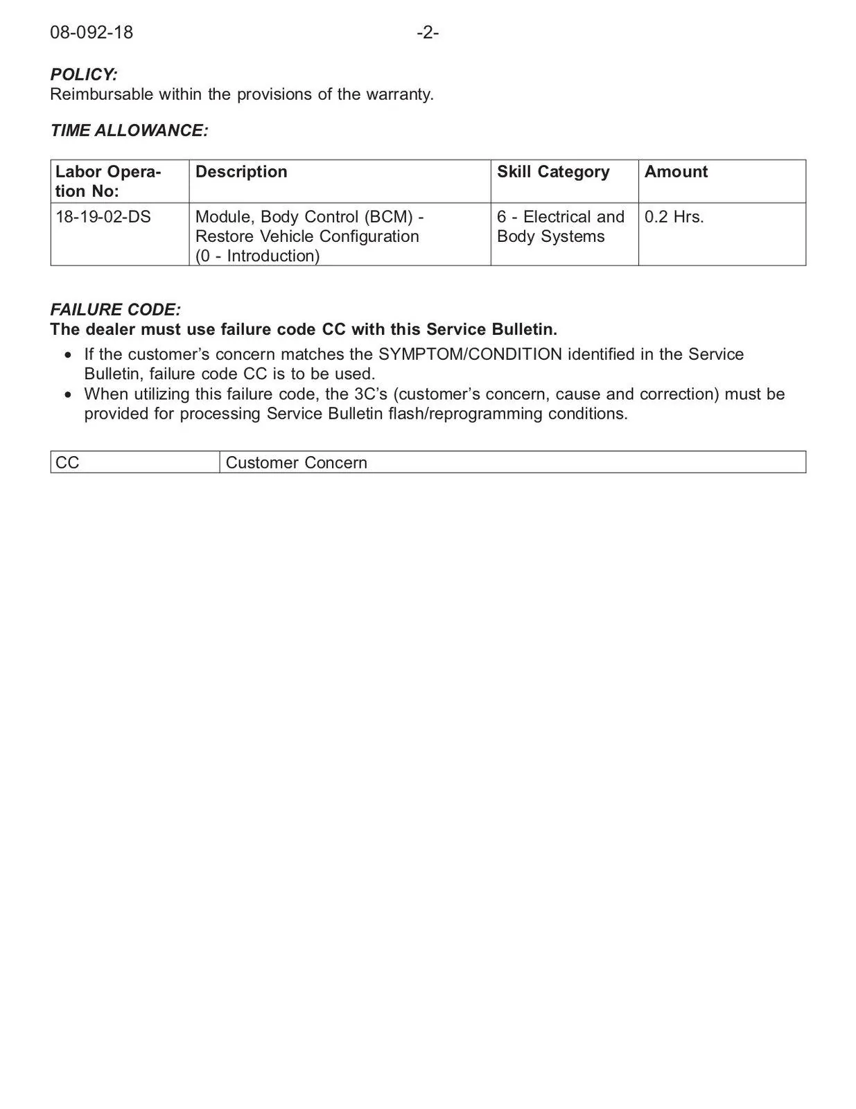

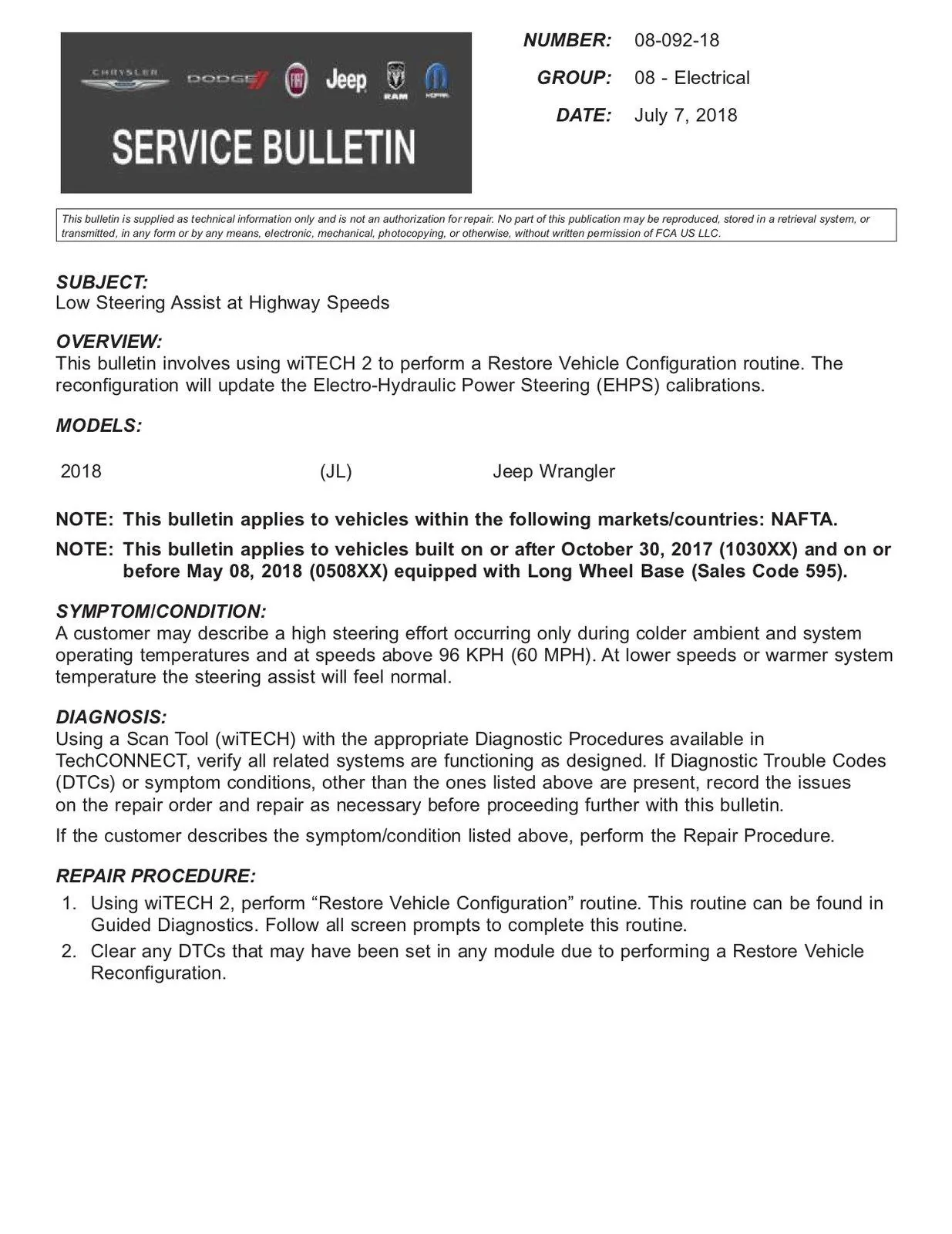

This TSB will fix it. Had mine done months ago and steering hasnt locked up since.
You're amazing. This started happening to me and My service center had no clue. I showed them this and they took care of it. Love this site and community.☮

To those who have had the TSB and still have lockups: whats your build date? Trying to see if this is only affecting certain builds. Id this is randomly affecting builds of all dates that'd suck.

Mine has been perfect since the TSB (3 months) and there has been some cold days. I honestly think there are two totally different issues out there.

It’s been over a week for mine and so far it’s good despite cold weather as well.
