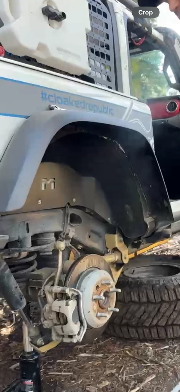

I had that problem on the Rubicon trail and a few other trails while in 4wd. My aux battery also died at the same some so I bypassed the aux battery and drove it home no problem, but it came back again on another trail. So, I then replaced the ABS sensor on that wheel and it hasn’t come back yet. 🤷‍♂️
