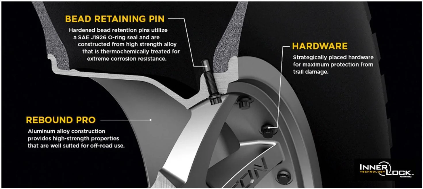

I developed a shimmy after a trip to Moab in the fall. I let it go until now, because I drive so little and just local most of the time. I knew it was at least in part, due to balance. It would start to vibrate pretty bad about 75mph.
These Mickey Thomp BB AT 37s were installed about late last spring. Probably 6-8k miles on them. I took it in to Discount/Americas Tire today and they balanced them. Took it for a run on the freeway and was able to find clear road for a 80+ mph burst and some bumps. No shimmy.
When I returned home from the test run, I found a white paint pen and marked a white dot on the sidewall aligned with the valvestem. I think, while running Golden Spike's Waterfall, my WFO send over the Waterfall obstacle, with squealing tires and at 12 psi, mounted on Icon Rebound Pro wheels, the tires rotated on the wheels. Their "Innerlock" system doesn't clamp the tire bead like the traditional beadlock ring system.
Jeep Wrangler JL Steering shimmy culprit? Icon Rebound Pro Innerlock
