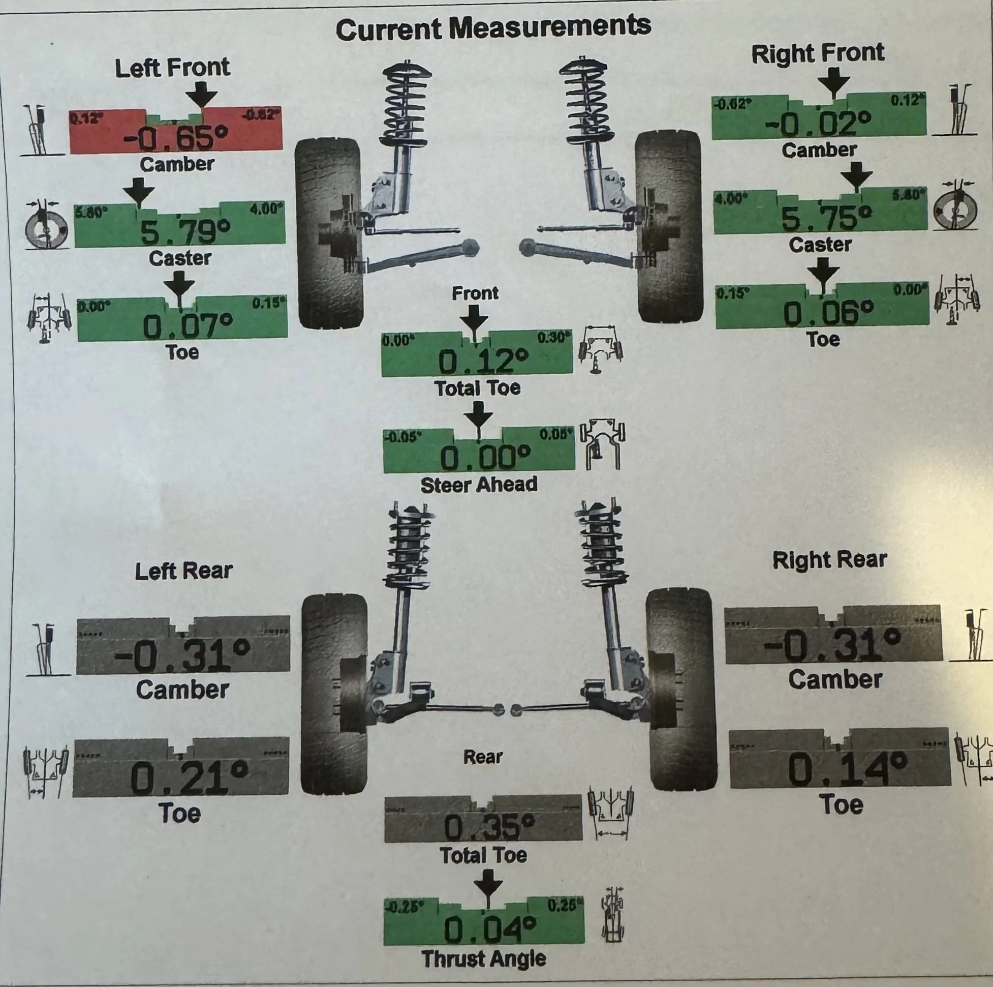

Update: it’s not the track bar. Also here’s my alignment specs

just to clarify again, i should have put it in the original post, i can go highway speeds just fine if the road is smooth, the wobble happens on uneven bumps and bridge connections where driver and passenger side hit separately. I've played with tire pressures and now with the new track bar it got an alignment (see above picture for specs), everything seemed to be pretty tight. I'm having the dealership is looking at it on Monday because they said they would take care of it since it had the issue before i bought it, so I'm just gonna let them spend their money on it.
