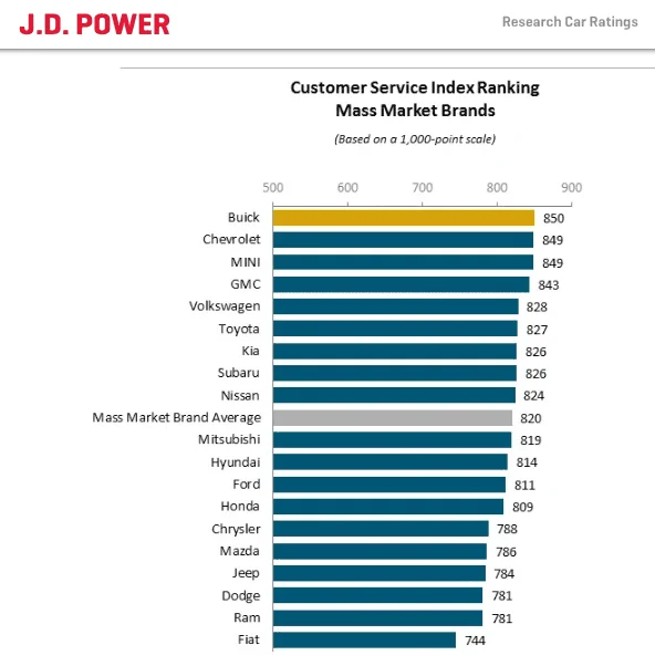

Jeep, Dodge, Ram, Fiat (FCA) rank last in customer satisfaction per the latest JD Powers survey 2018 - https://www.jdpower.com/business/press-releases/jd-power-2018-us-customer-service-index-study In case Jeep cares - @JeepCares
Jeep Wrangler JL Steering Feels Loose and or Wander Screen Shot 2019-07-13 at 10.10.56 AM
