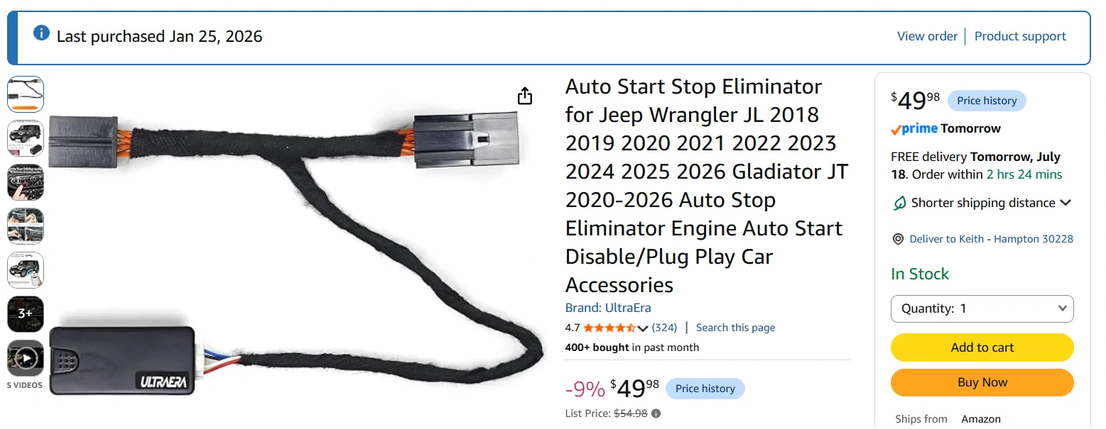

Leaves it in the last state, Off / stays off next start
Jeep Wrangler JL Start Stop Button 1784335282579-kr

I got the eliminator from one of the forum sponsors.
I would never go back.

I am using the Auto Stop/Start Eliminator and it works great.

A Tazer will keep the button in the last position it was in when the ignition was turned off. If it was off, it will stay off when you start up.
