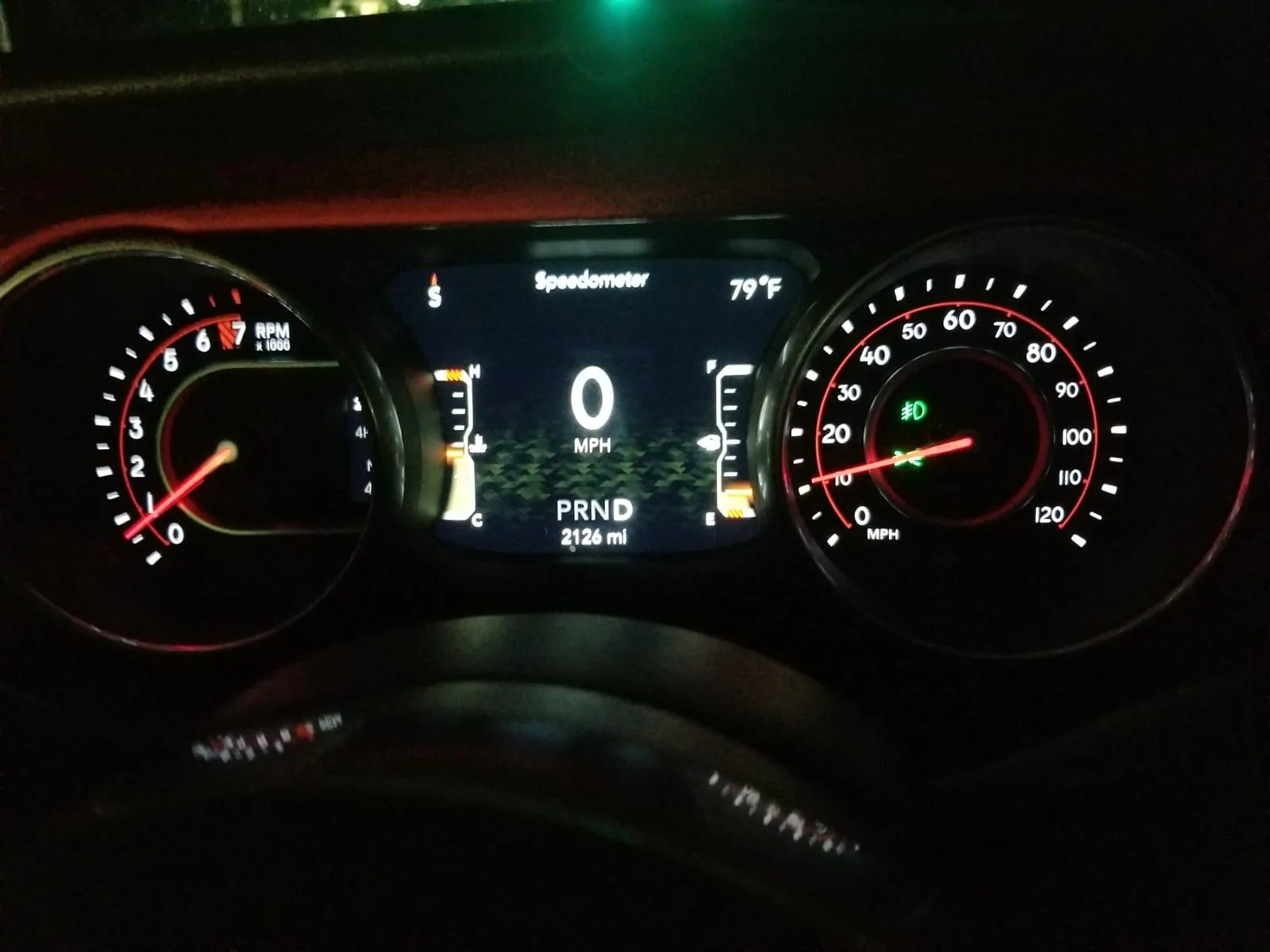

Agree. Crazy. Who do you believe?

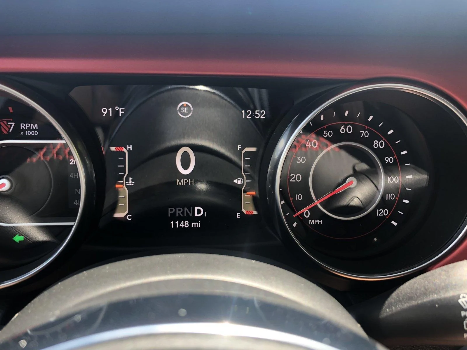

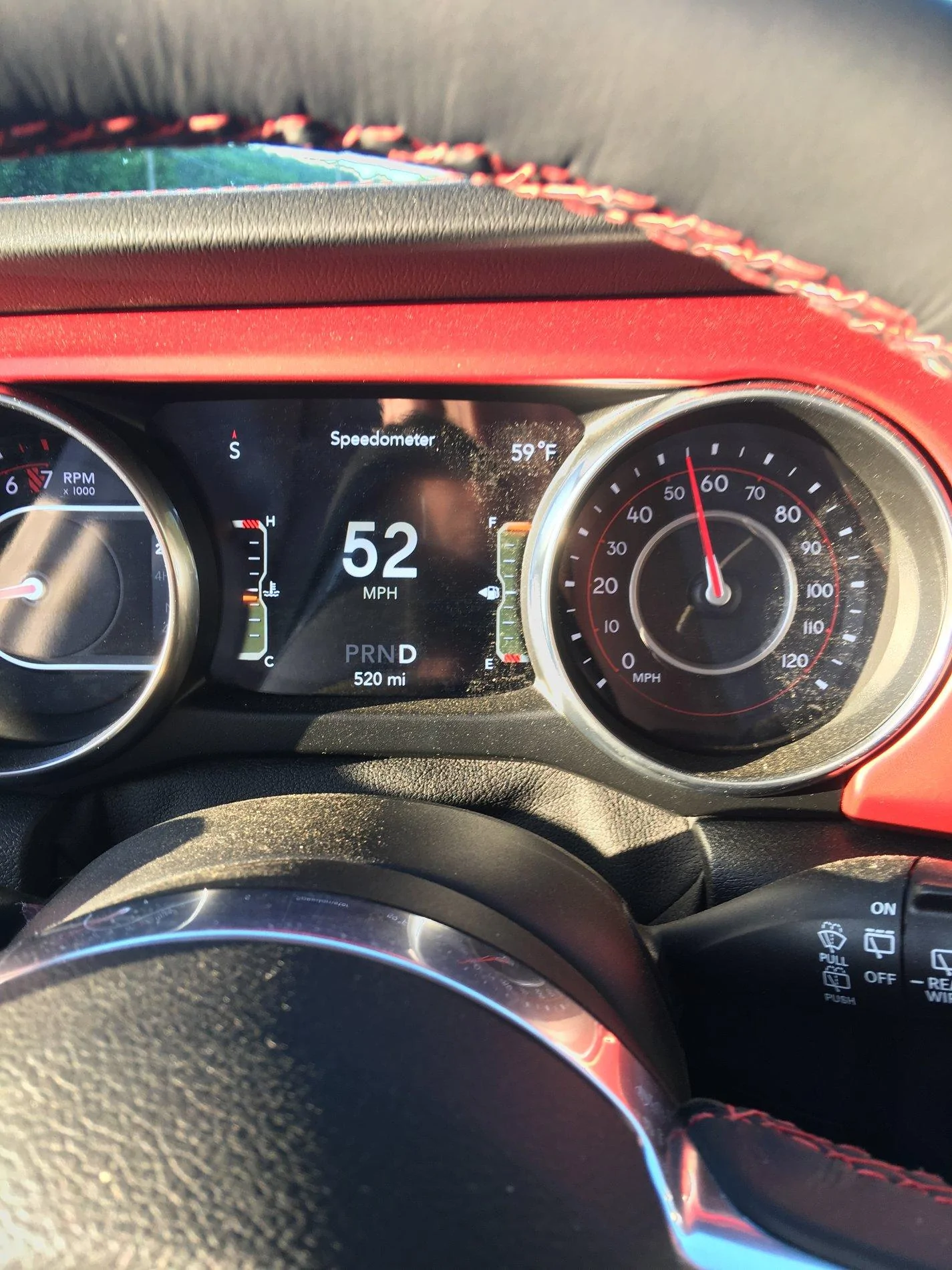

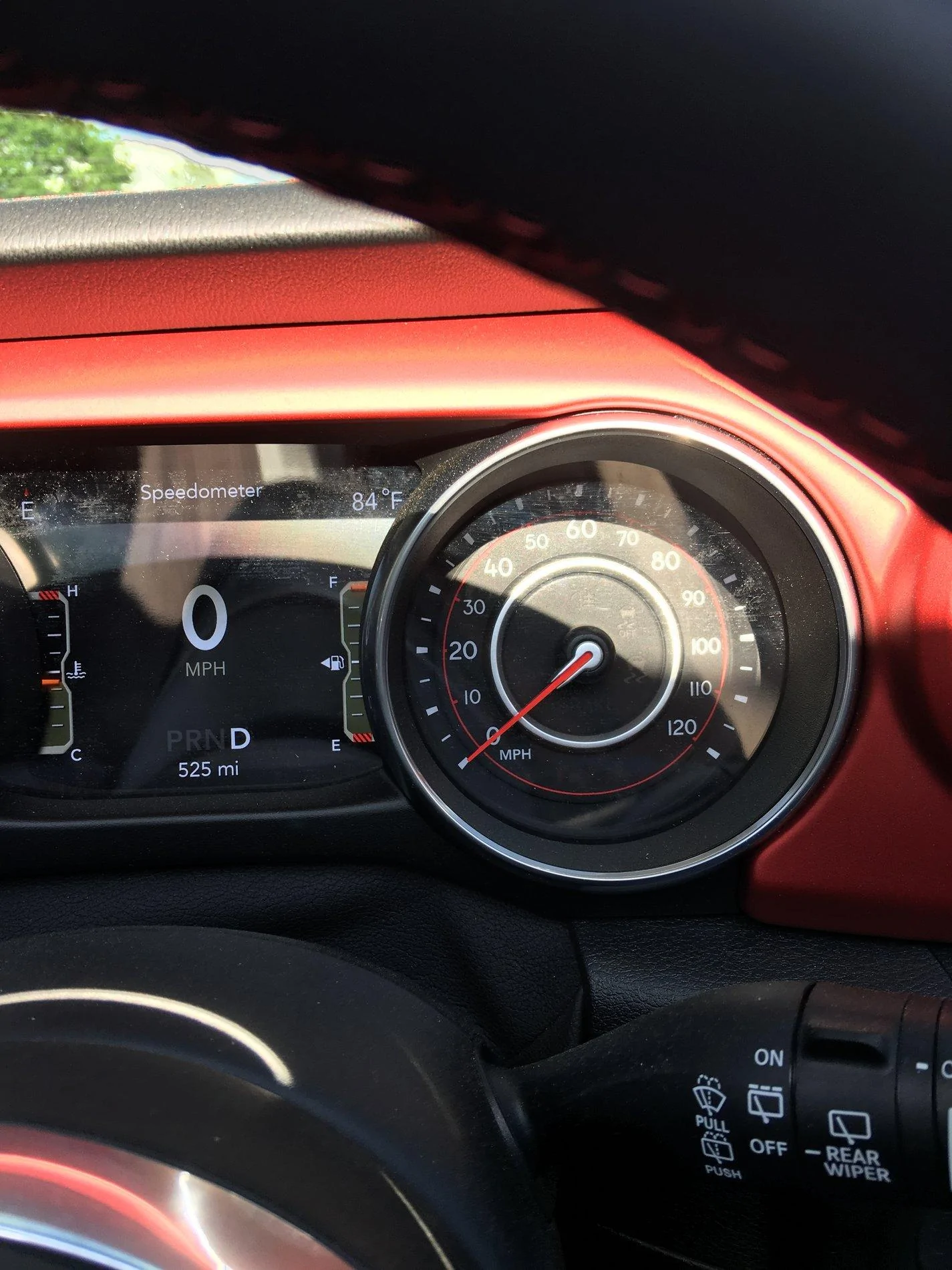

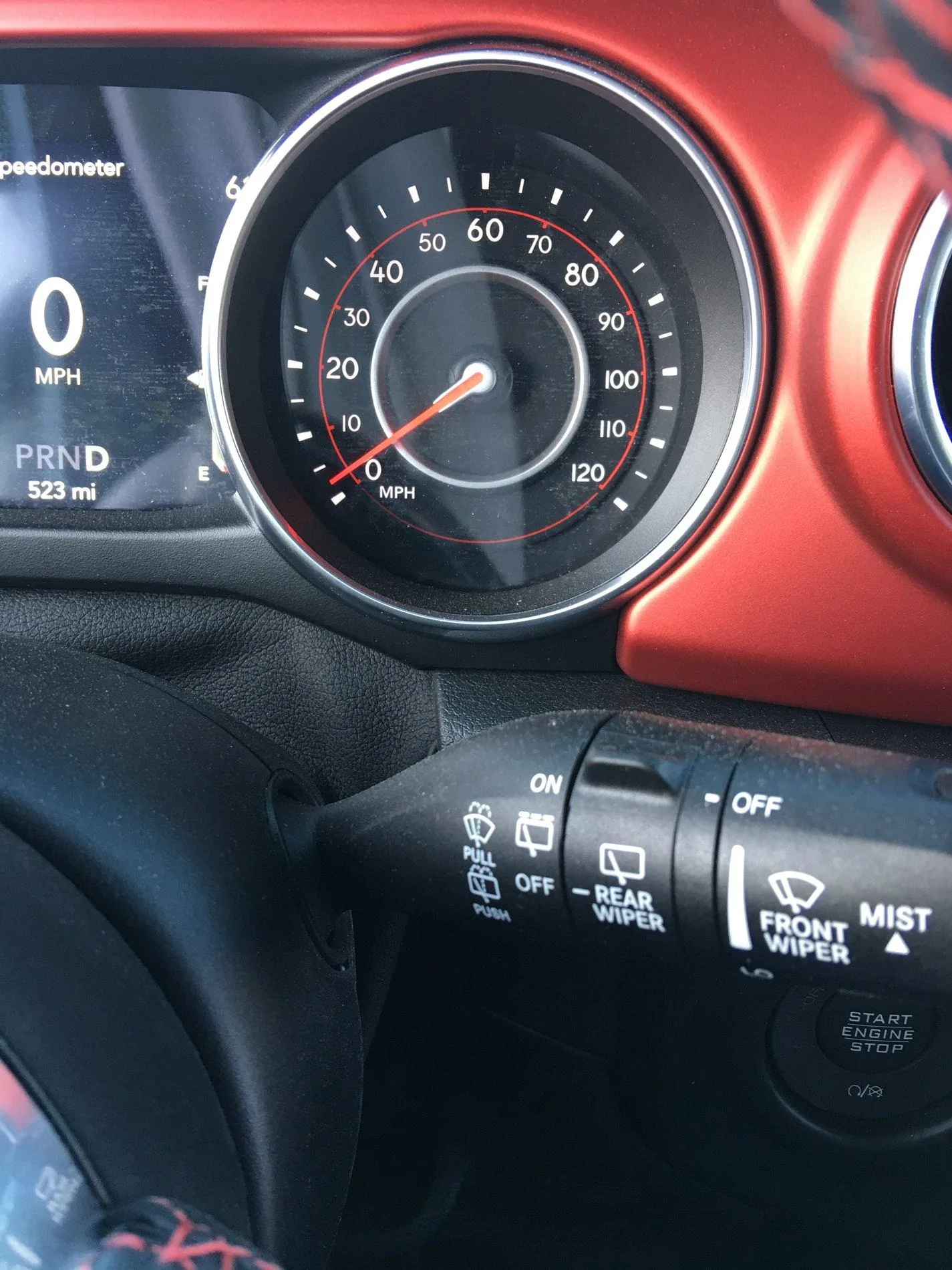

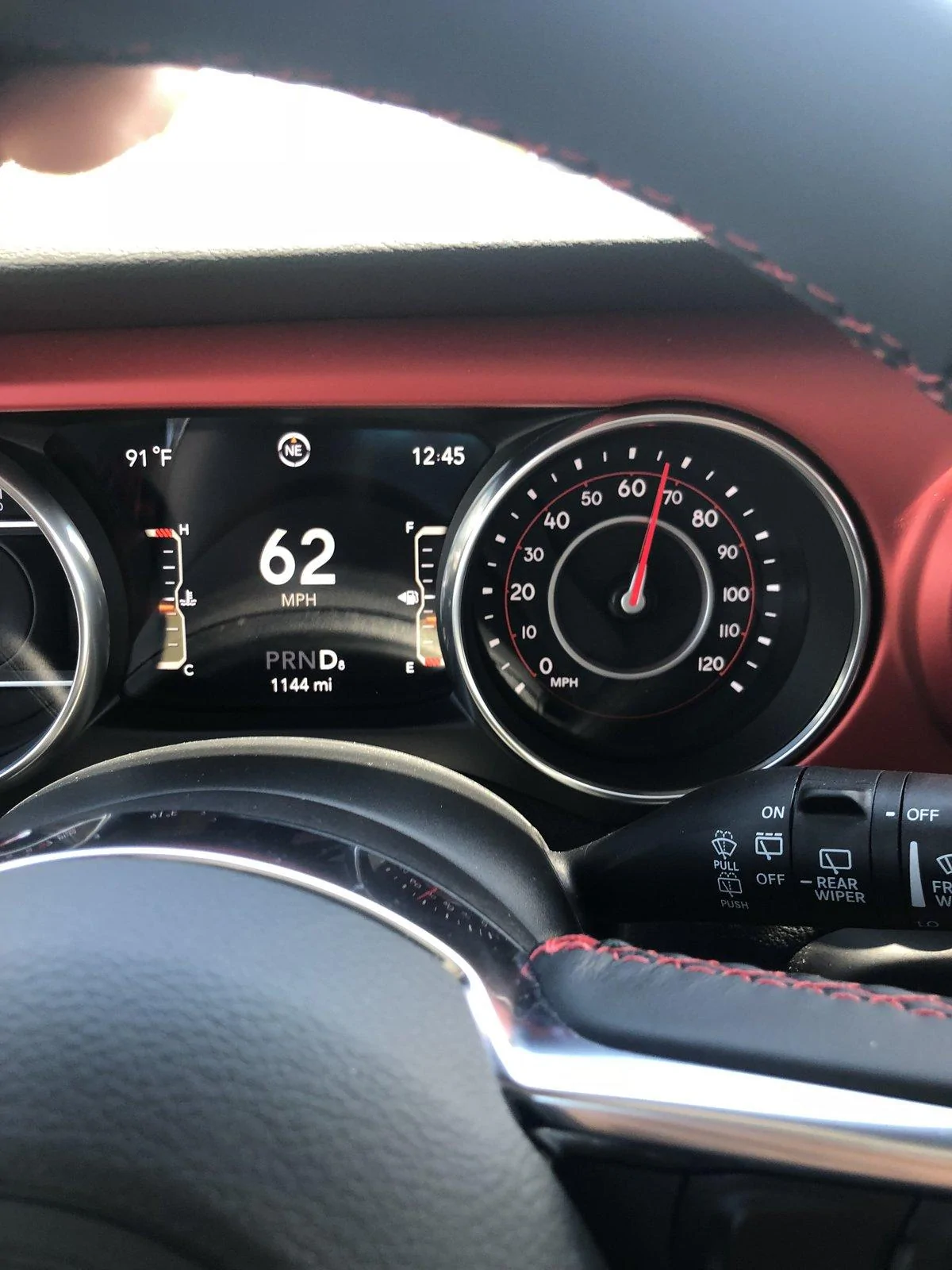

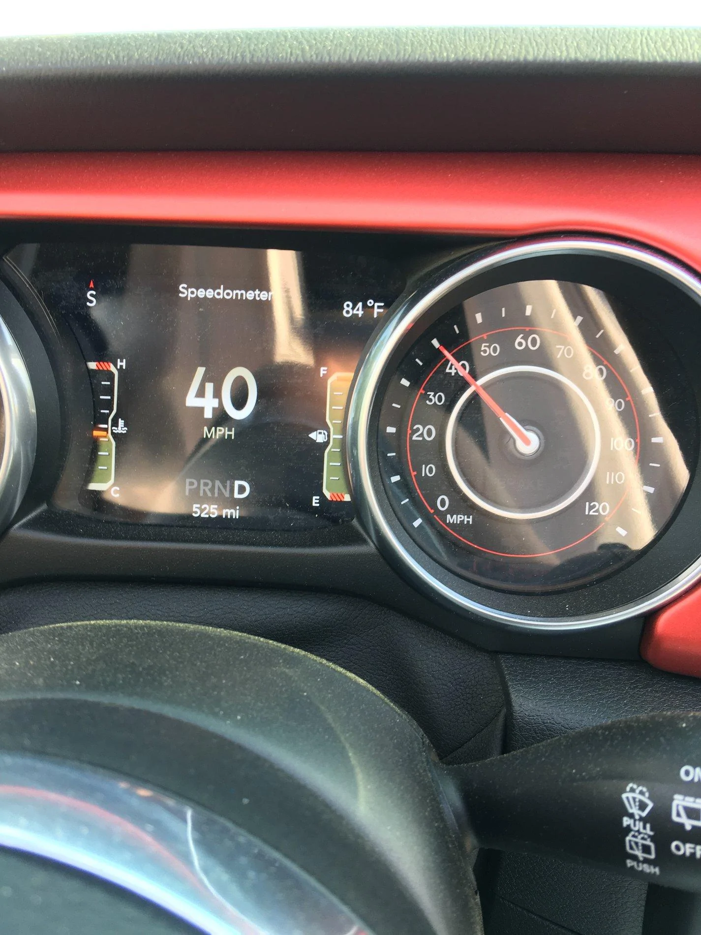

Noticed what seems to be a pattern on mine. To be candid, I usually only drive a few miles each way to work so I haven’t had a long drive to validate the scenario. However, it seems that mine is primarily off in the morning when I first drive (and it’s cooler?). Then in the later part of the day (warmer?) it seems to be spot on. I have seen this at least 3 times now and was finally able to document it. What you can see is when it’s off, the dial does not drop to zero and reads over by roughly the amount it’s above zero. When it’s accurate, it will read true zero at a stop. The timing may not be related and just coincidence, but I’m certain the zeroing piece is the key to it being off. Root cause of the zeroing issue???? See pics

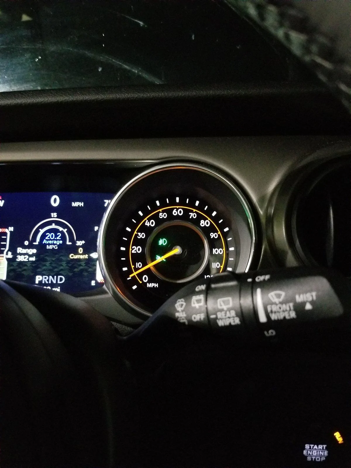

I have a Jeep JL Rubicon and just noticed it’s doing the exact same thing as described.
