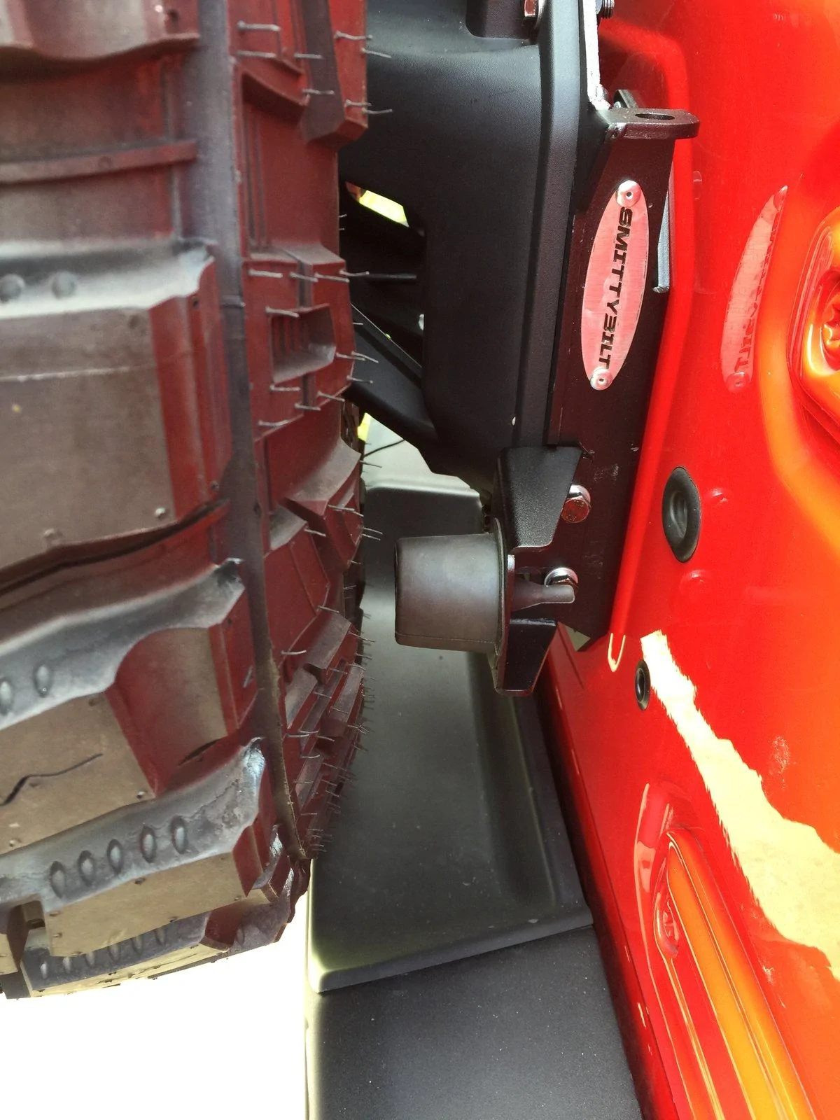

I need to get a for sale thread posted, but I have a SmittyBilt carrier for sale. I decided not to use it, no damage or anything like that - I’m just not using it.
PM me if interested, I’m in Ohio. I prefer local sale or buyer pays shipping.

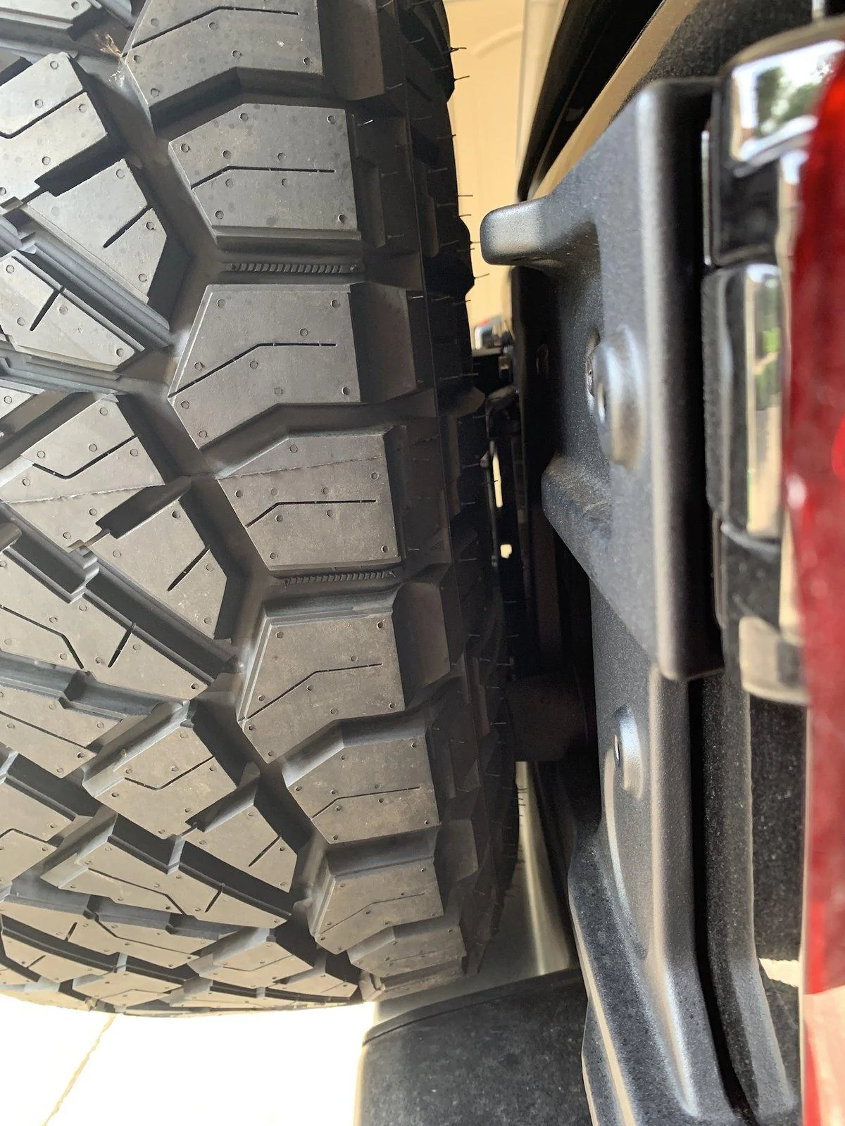

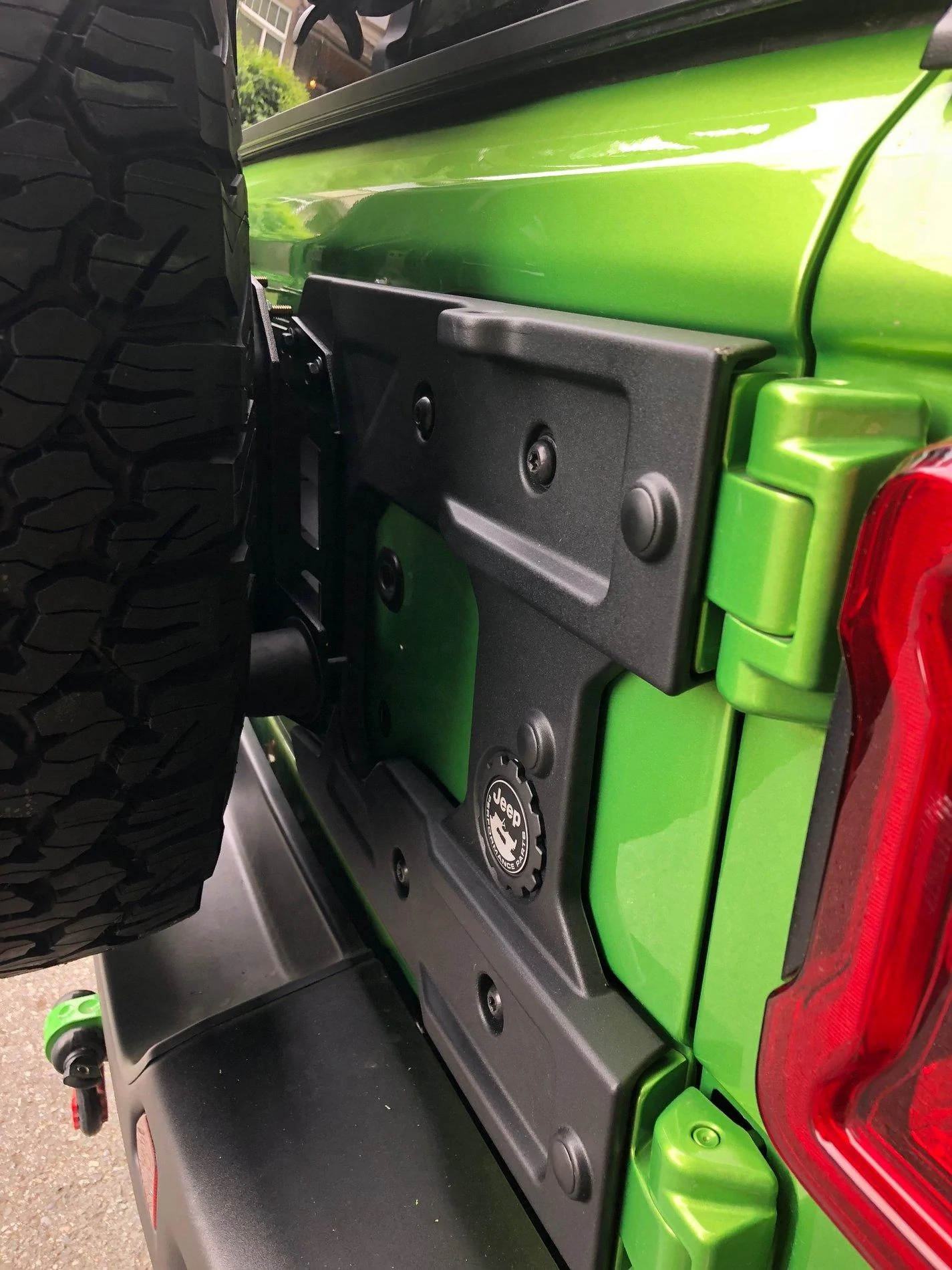

Ended up doing Mopar tailgate reinforcement + Smittybilt bracket. Photo's with stock 33" Rubicon tire still, 37's are coming. Smittybilt bracket fit with the Mopar tailgate reinforcement kit.
[UPDATE] After having the Smittybilt bracket with my 37's for 8 months, the Smittybilt bracket broke under the weight of the big 37's and I had to replace it. I replace it with the Mopar bracket, and while it seems like a totally overpriced rip-off, it worked much better. My 37" tire fit just exactly perfect, much tighter to the tailgate, and less movement... it was expensive, but it's better

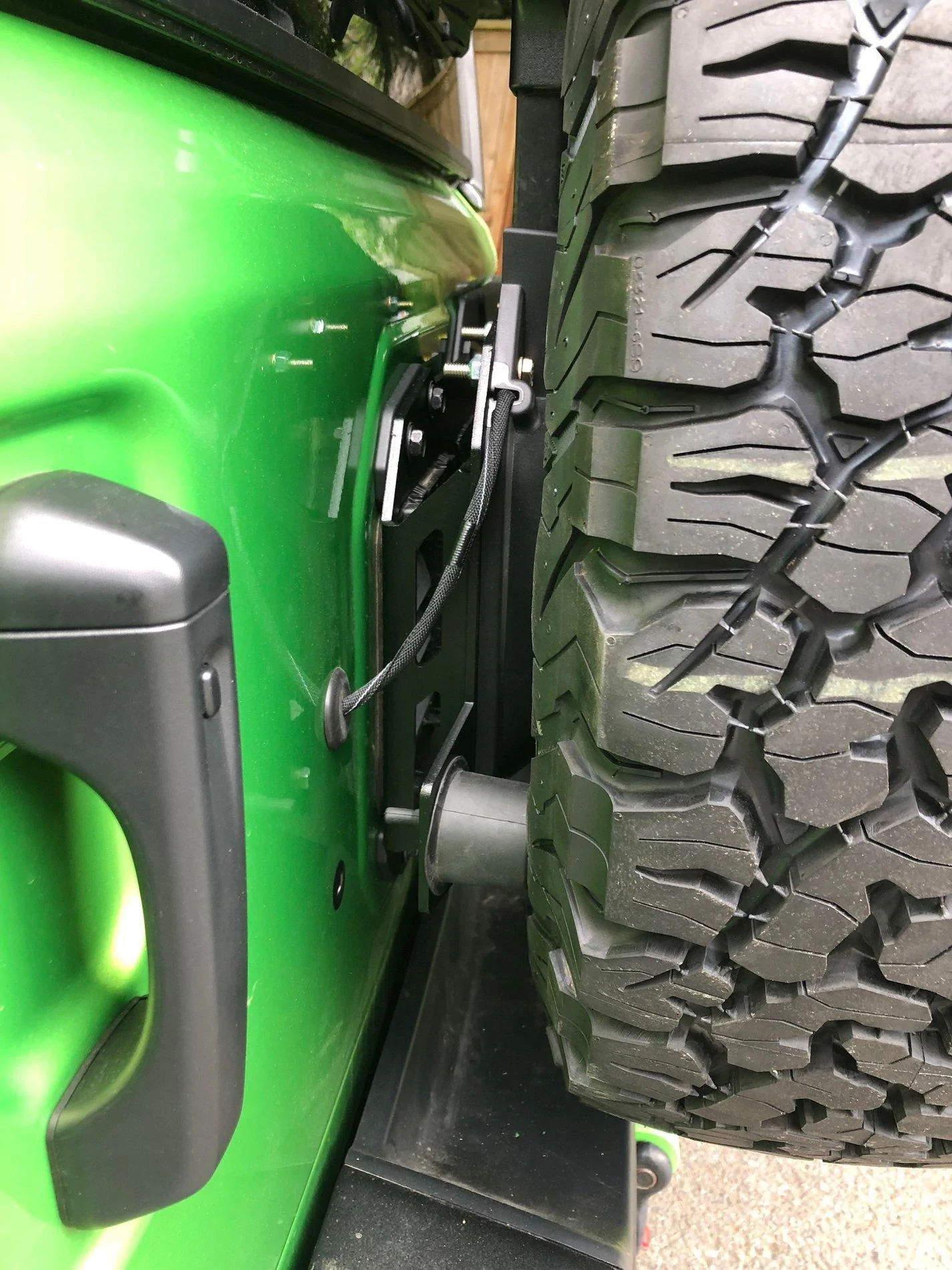

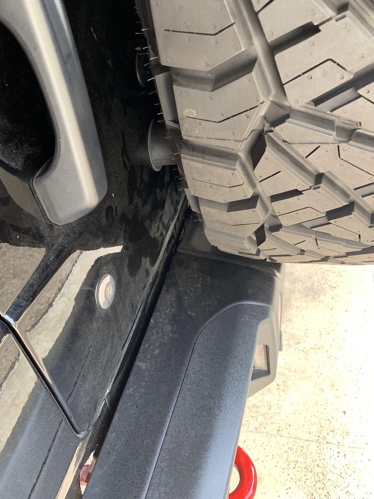

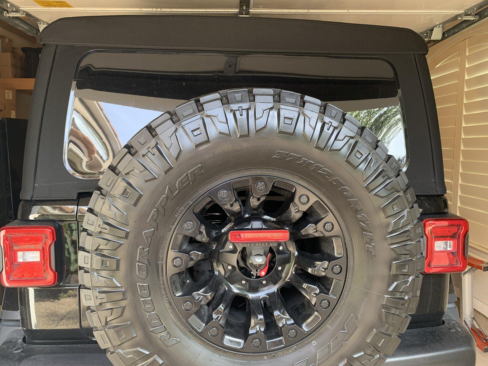

if you have sensors, look at the Teraflex HD tire mount. It combines relocation ento the mount itself and brings the tire much closer to the tailgate than any relocation bracket can. See attached pictures...
So this mounting is the Tereflex HD tire mount with the Mopar tailgate reinforcement? Looks like it, but wanted to make sure. Looks like a good choice for my needs, and I already have the Mopar reinforcement... so hard to tell which mounts and relocation brackets will work with the reinforcement already there.
Yes, that is exactly what it is. I have been extremely happy with it after being extremely disappointed by a few relocation brackets.
Awesome. Thank you! Looks like that will be our solution when we get 37s and some new wheels later this year.
