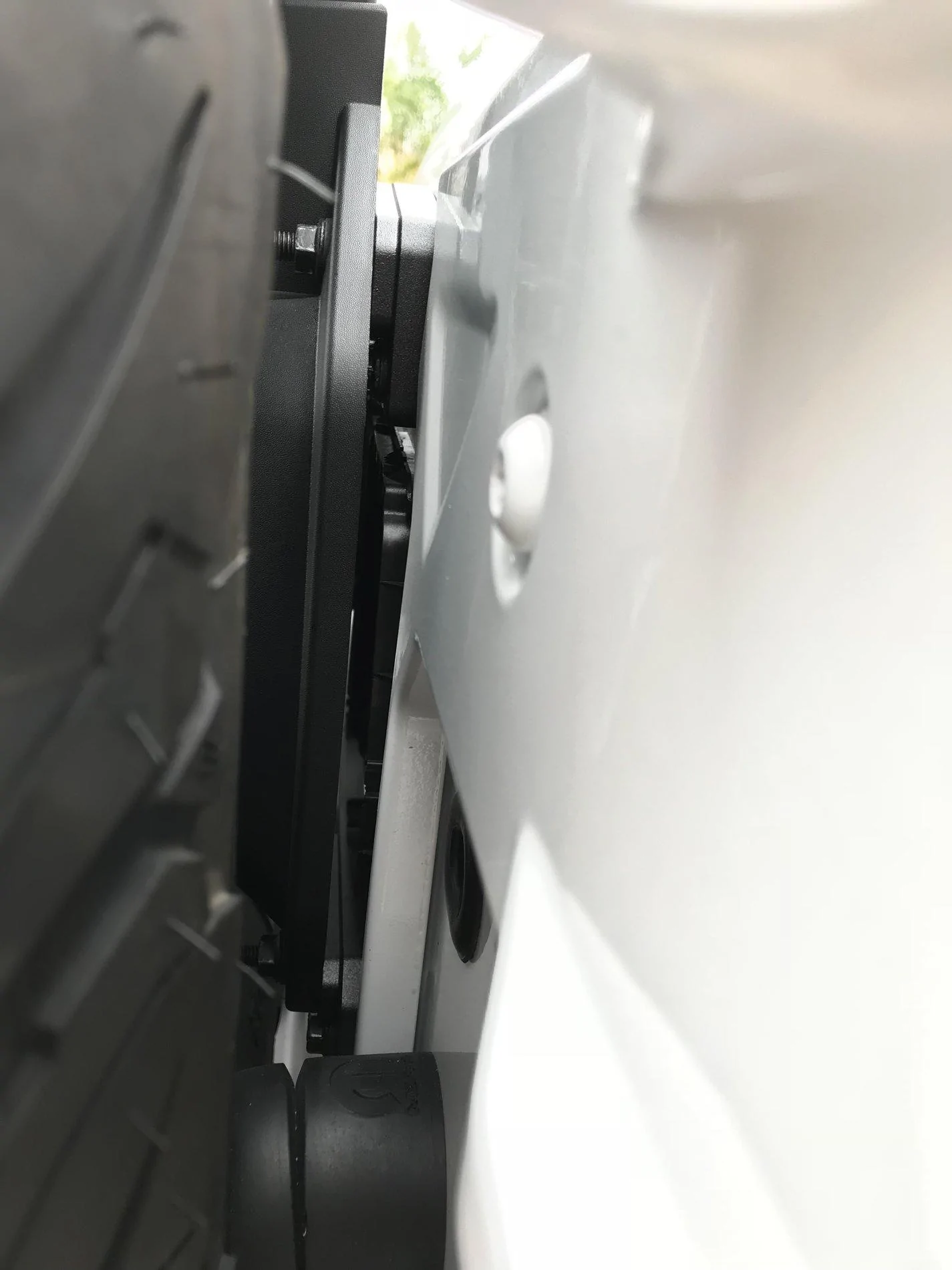

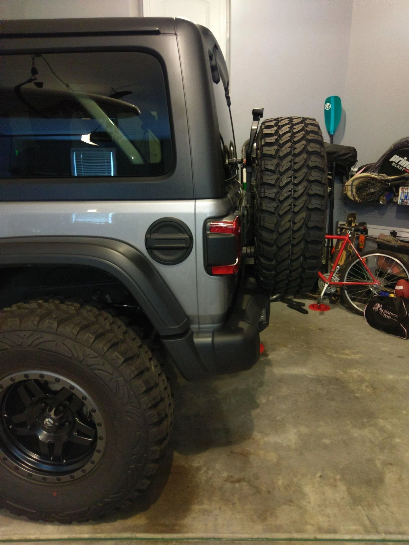

    Ended up doing Mopar tailgate reinforcement + Smittybilt bracket. Photo's with stock 33" Rubicon tire still, 37's are coming. Smittybilt bracket fit with the Mopar tailgate reinforcement kit.
    [UPDATE] After having the Smittybilt bracket with my 37's for 8 months, the Smittybilt bracket broke under the weight of the big 37's and I had to replace it. I replace it with the Mopar bracket, and while it seems like a totally overpriced rip-off, it worked much better. My 37" tire fit just exactly perfect, much tighter to the tailgate, and less movement... it was expensive, but it's better

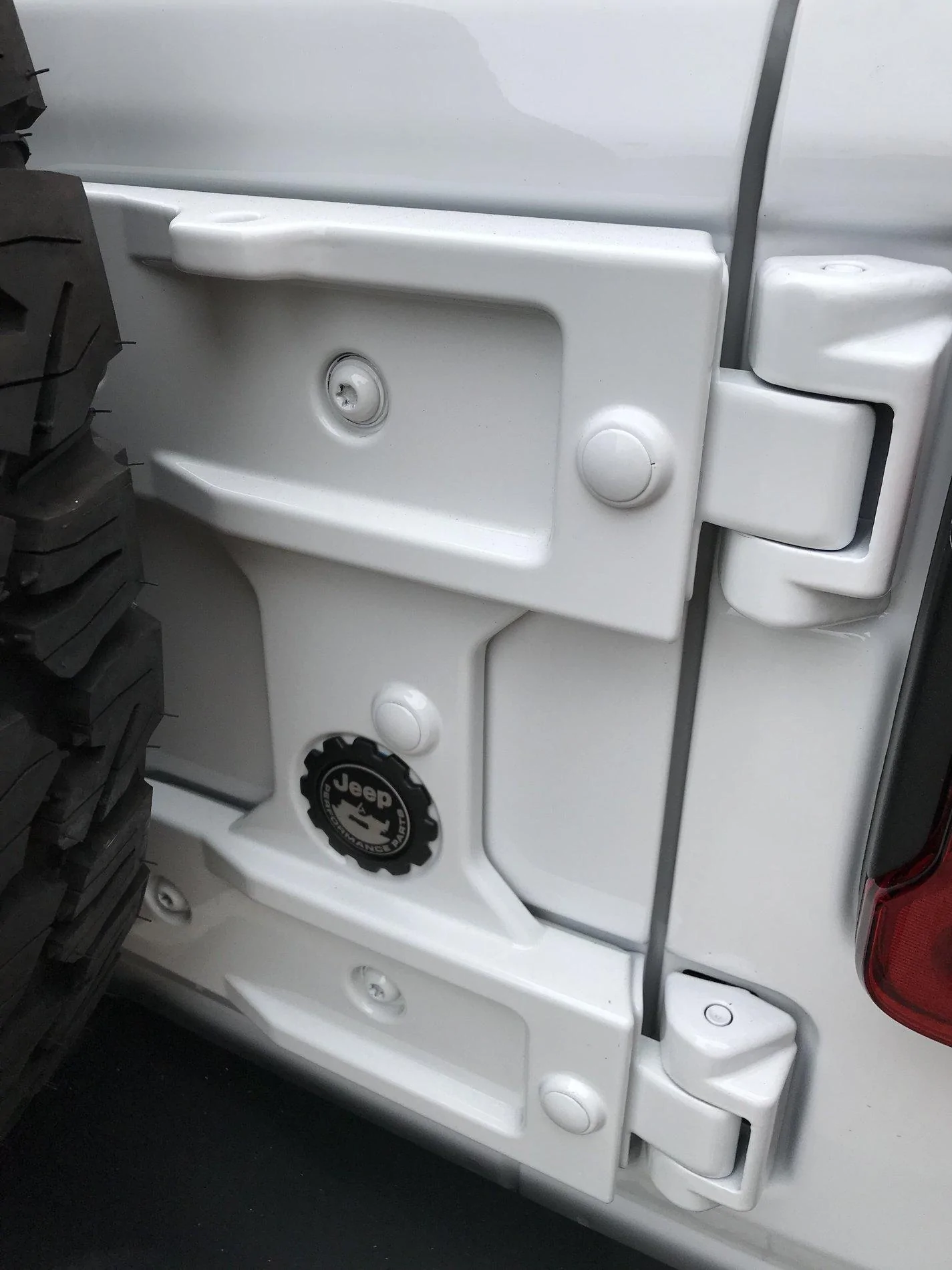

    hate to bring up an old thread but does the smittybilt bracket provide you with plugs for holes where the rubber isolaters went?

    Yes it does!
    FWIW, I kept the factory isolators in place to give added dampening between the bracket and the tailgate. The fit was perfect (snug against the isolators with slight compression).
    I then added aftermarket (larger) isolators into the bracket itself to dampen the tire.
    So, I did not use the plugs provided - but they’re definitely there.

    Of course it is always good to have the isolator. However i am referring to the Smittybuilt relocation kit has wings on the end where the isolator goes leaving 2 holes in the tailgate.
