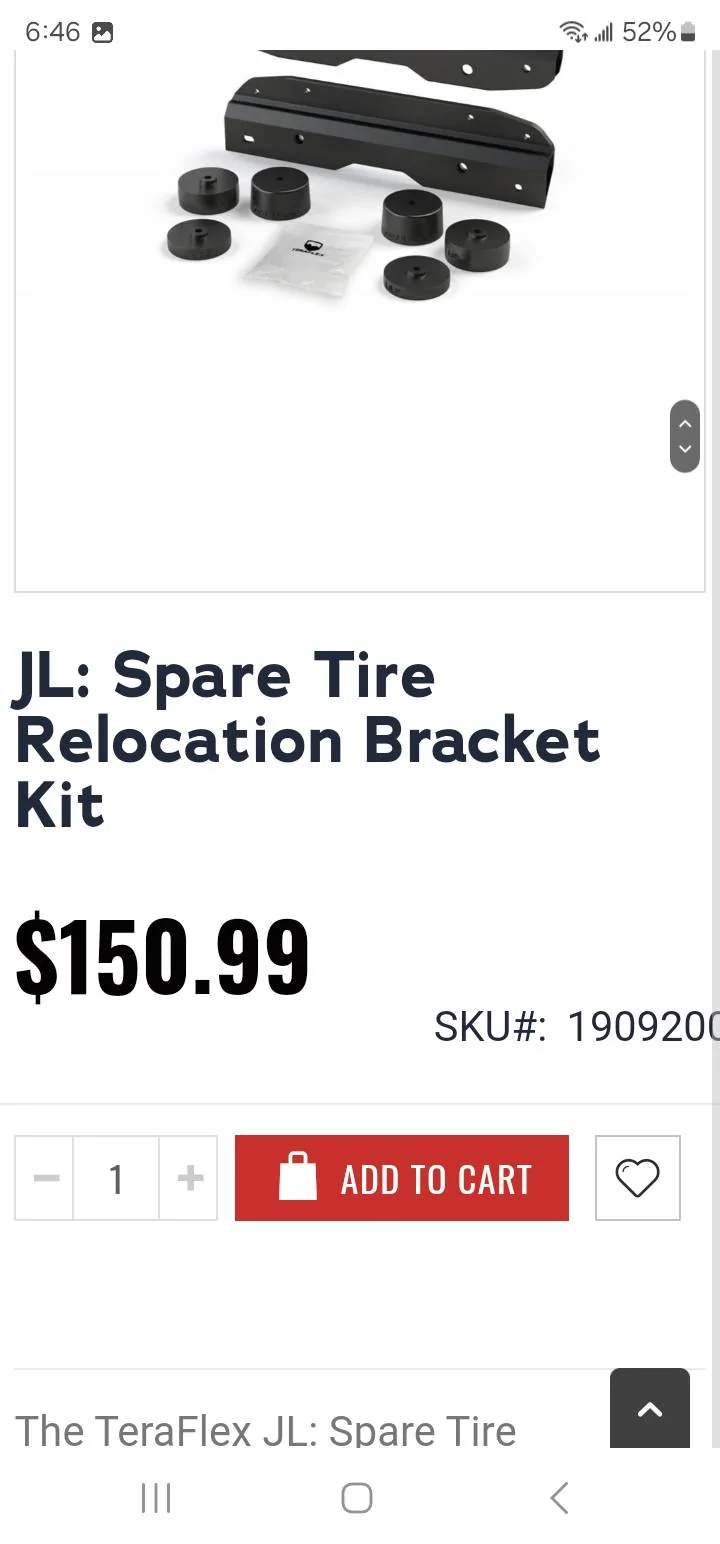

Is it this one?

Nope- 2” RC 13-15 lbs. Teraflex featherweight, easy install, I didn’t even unplug the wires per instructions. Just set the stock carrier on a trash can. Removed the ugly rear view blocking 3’rd brake light and used a PNP QT light ring…. The RC plate doesn’t include the snubber extension kit either.

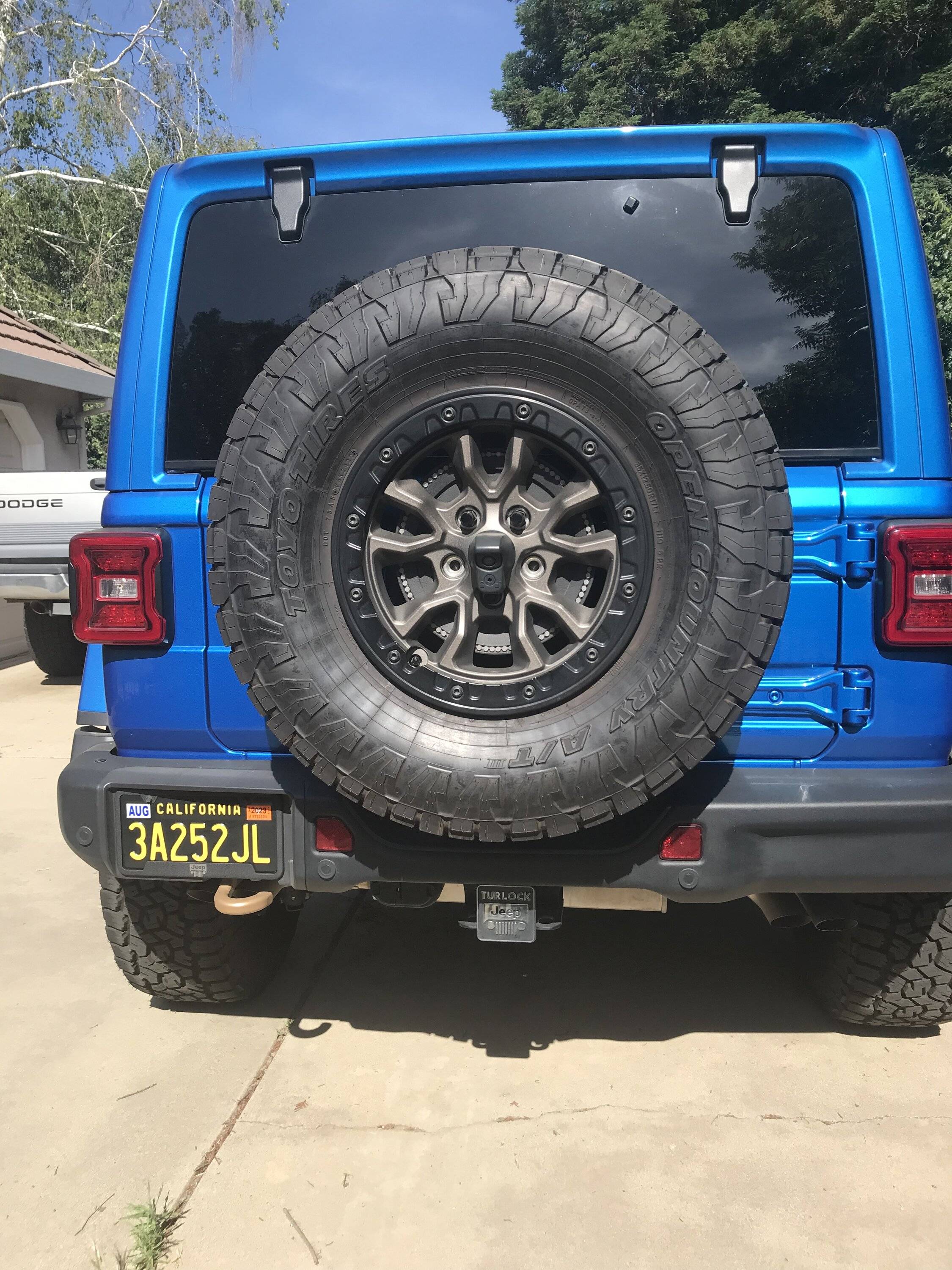

I'm thinking this is exactly what I need rather than the terraflex tire mount kit.
I'm on stock ko2 33s with 23lbs wheels. May go to 35s but that would be my limit.
My 17x8.5 wheels have a -1 offset so I'm just trying to get some adjustment for the offset since the spare is hanging off the back about an inch and a half farther out.
Can you get rid of the oem 3rd brake light with this kit? Need to relocate license plate to spare and was going to install ORO third brake light/license plate lite
Would make sense to have 4 rear lights.

If you are referring to the Teraflex bracket kit it will do the opposite of what you want. I am presently running it to lift my 35’s 2 in, the brackets also put the spare out 1.35 in. It works good with the stock 7.5”/44mm wheels, but if I go the 8.5”/1mm I’m considering the adjustable one will likely be needed to tuck the tire back to eliminate camera-sensor issues/false warnings per reports. The Teraflex adjustable comes with a center 3’rd brake light mount but not a license plate mount. With the brackets I use a QT PNP light ring.
