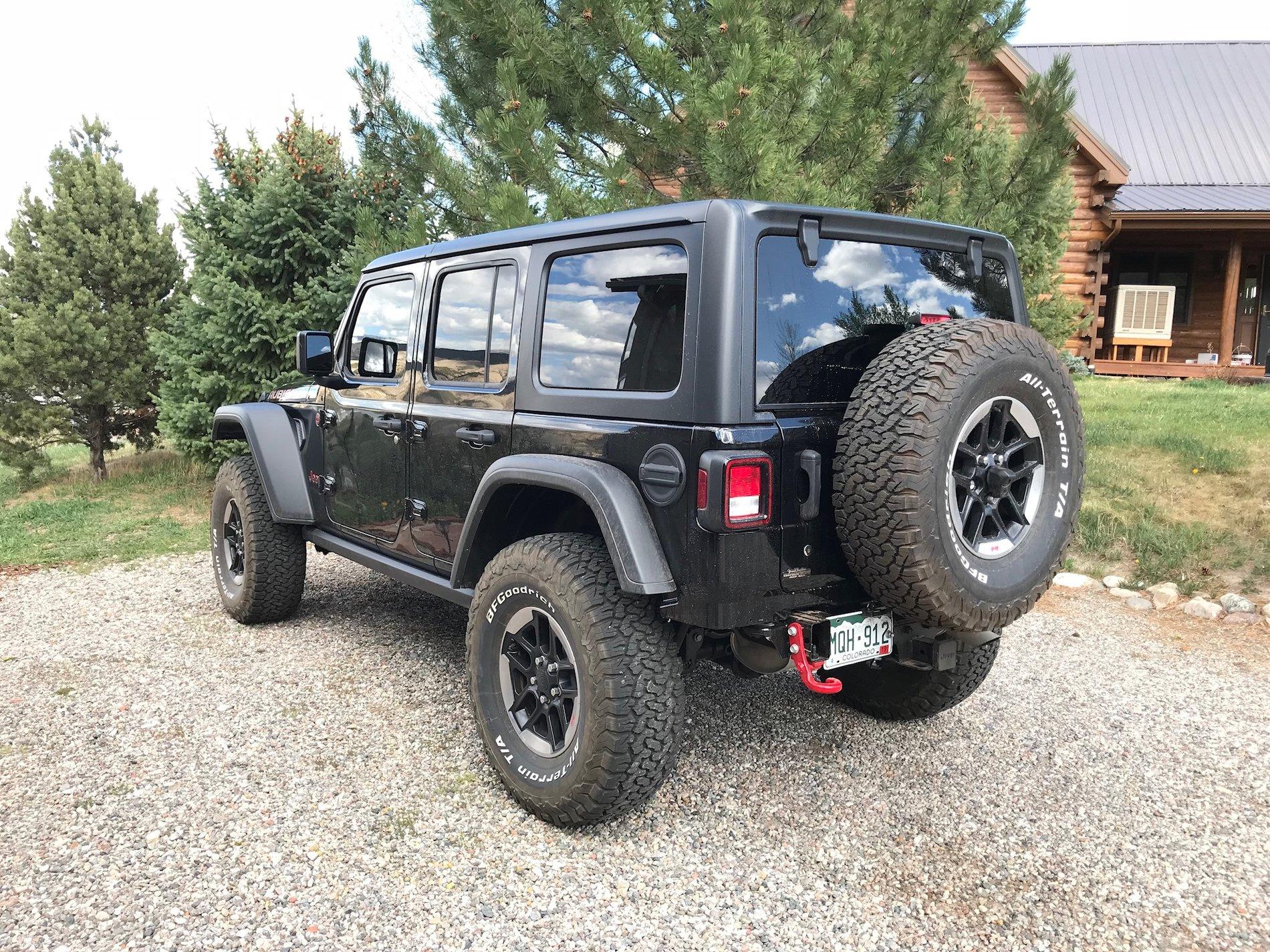

I run the RC with my 37and it’s great. By far the easiest to install and the least expensive.

Although the RC bracket is a great piece, I am running nothing now. The tailgate doesn’t need the reinforcement kit. It doesn’t even know the tire is on it. I also removed my rear bumper. It’s nice and tight and works great without anything.

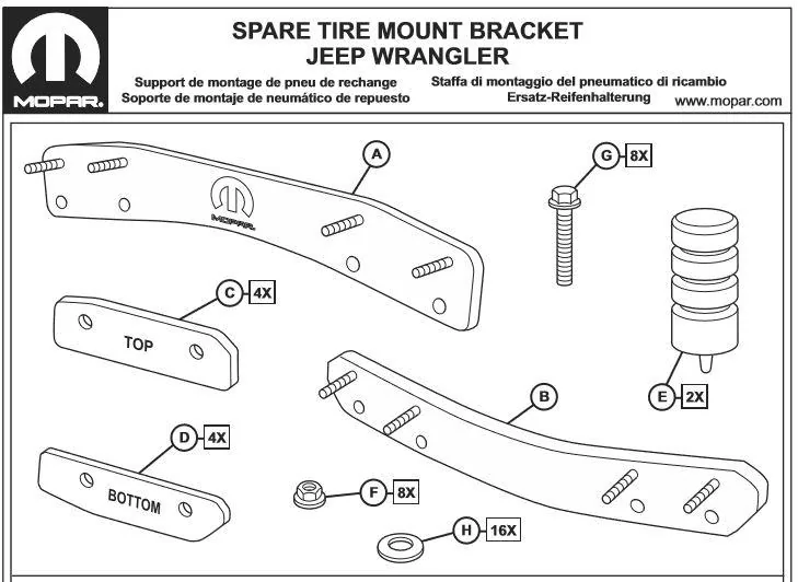

I found the install guide for the Mopar brackets, see below pic... they are just simple metal plates! This seems like INSANITY for what Mopar is charging for this. It also looks like the Mopar tailgate reinforcement kit won't work with any 3rd party spacer bracket :(

I found the install guide for the Mopar brackets, see below pic... they are just simple metal plates! This seems like INSANITY for what Mopar is charging for this. I love the Mopar tailgate reinforcement kit, but I think I would combine that with someone else's bracket.
I can't disagree, especially with the options available now. While I assume other carrier extensions would fit the Mopar reinforcement bracket, I can't confirm that's the case.
Having no other available options, and not knowing if the reinforcment bracket was proprietary, drove my decision.
