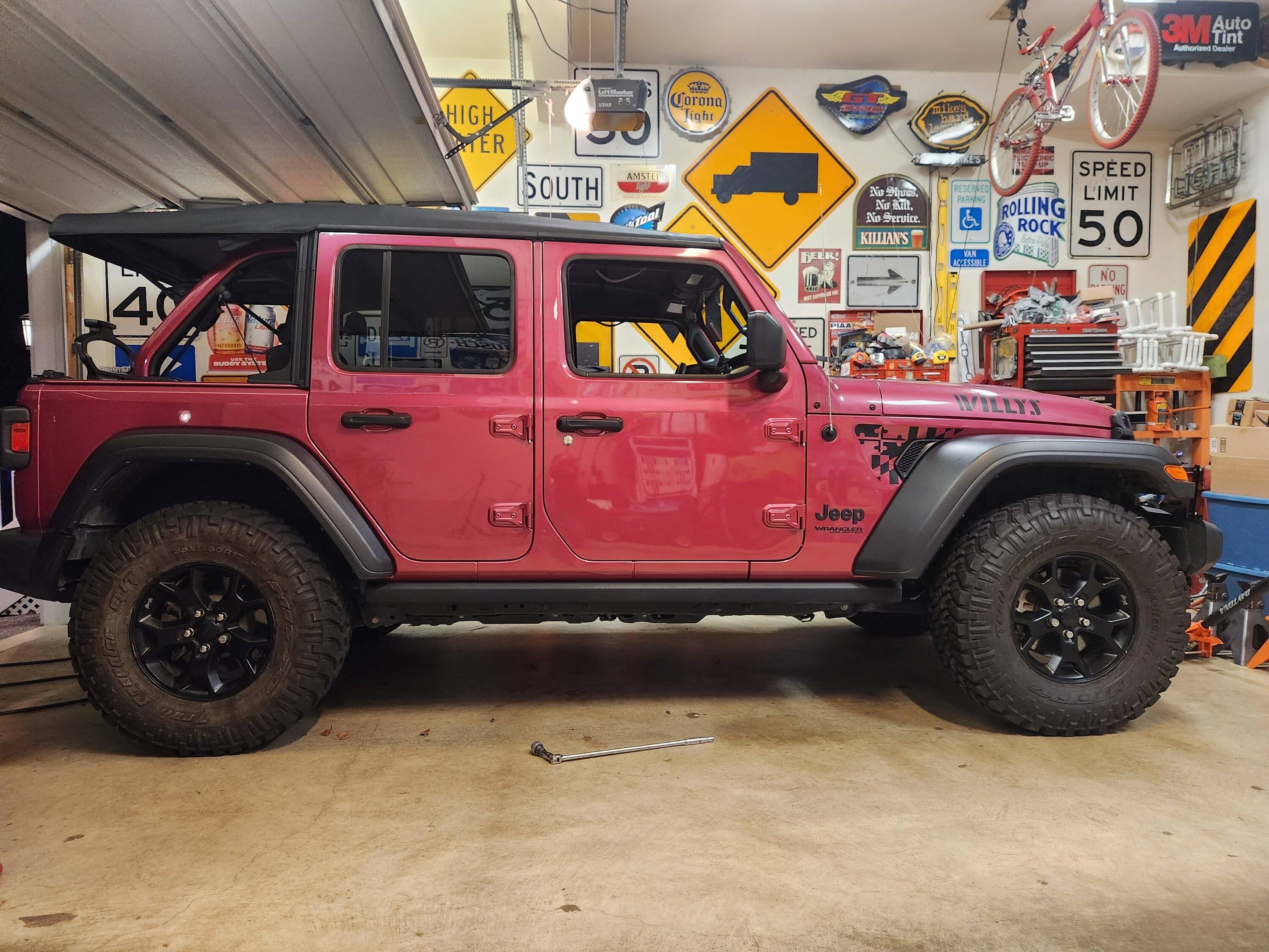

Looking to add ~2" spacer lift, but I also want to get rid of the rake. I will probably do AEV 2" or Rough Country 2.5" spacer lift. I was wondering if any of the .75" leveling kits go on the bottom of the spring, that way I could add the spacer lift and get rid of the rake in the front.
It's or a 21 Willys JLU. I have already added rubicon springs and 35" tires.

Great, thanks. Only reason I wasn't sure about the LCA is because I swapped to rubicon springs. Those gave me at least an inch of lift, so if I add the teraflex spacers, it would be a total of 3" of lift on the front. There's an obvious rake. Probably because the donor rubicon had a hard top so the rear springs are taller.
