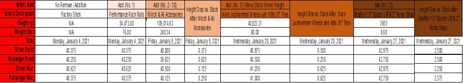

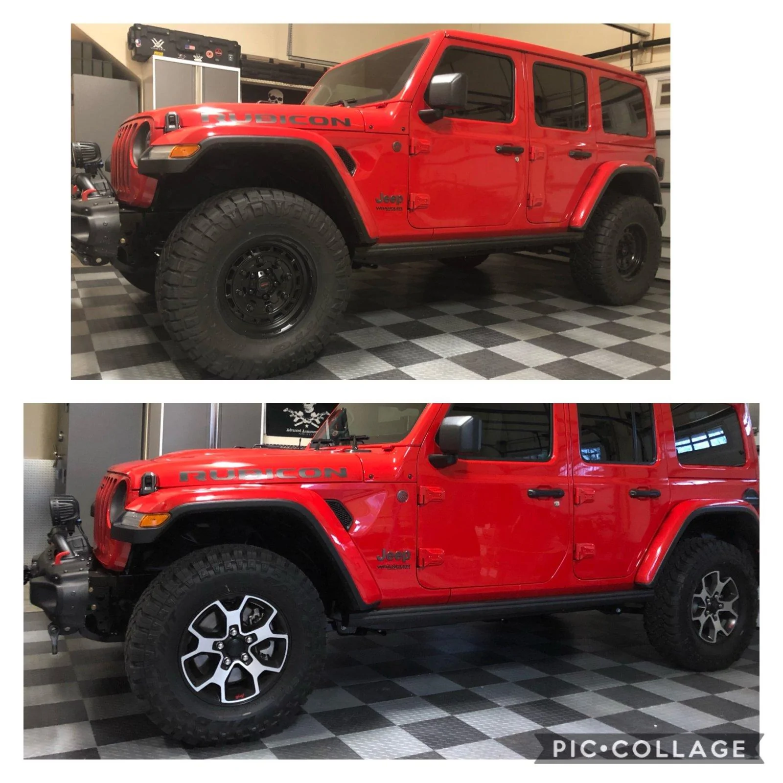

Installed Winch, Mopar Performance Rock Rails, Mapar Tail Gate Reinforcement, 35" Tires, Teraflex 1.5" Leveling Kit. Measured Height every step of the way.

Have the same Teraflex 1.5" leveling kit on my rig. Been on for 9 months and it is great. Are your wheels Black Rhinos with +30 Offset?

Warn Jackhammer Wheels with Zero Offset.

How is the ride did you need to do anything else to support the leveling kit?

Nice one. No geometry needed? Track bar, shock extensions, sway links? Looking for the same setup.

Looks great. What winch you go with? Steel or synthetic? I did the same setup but with an Arcus bumper and Warn EVO 10s. I can't remember my measurments at the moment but mine appears to still have a very slight rake if any.

Same as you, the EVO 10s.

Did you use the shock extension kit as well, or just the spacers and the bump stop extensions?

lt looks awesome. I am looking for the same kit since I lost 3/4" when I installed the bumper and winch. I was wondering where you were measuring the heights? looking at your data, after going from the OEM tires (32.7) to the nittos (34.76). That is 2 more inches of diameter and should give you 1 inch of lift but somehow you just gained one about 1/2". Also after the teraflex 1.5" you gained about 2.5 inches.
