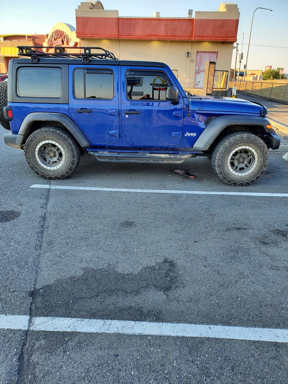

I also have the 2" AEV spacer lift on my sport. I have 315 k02's. Rides like it did previous to lift.

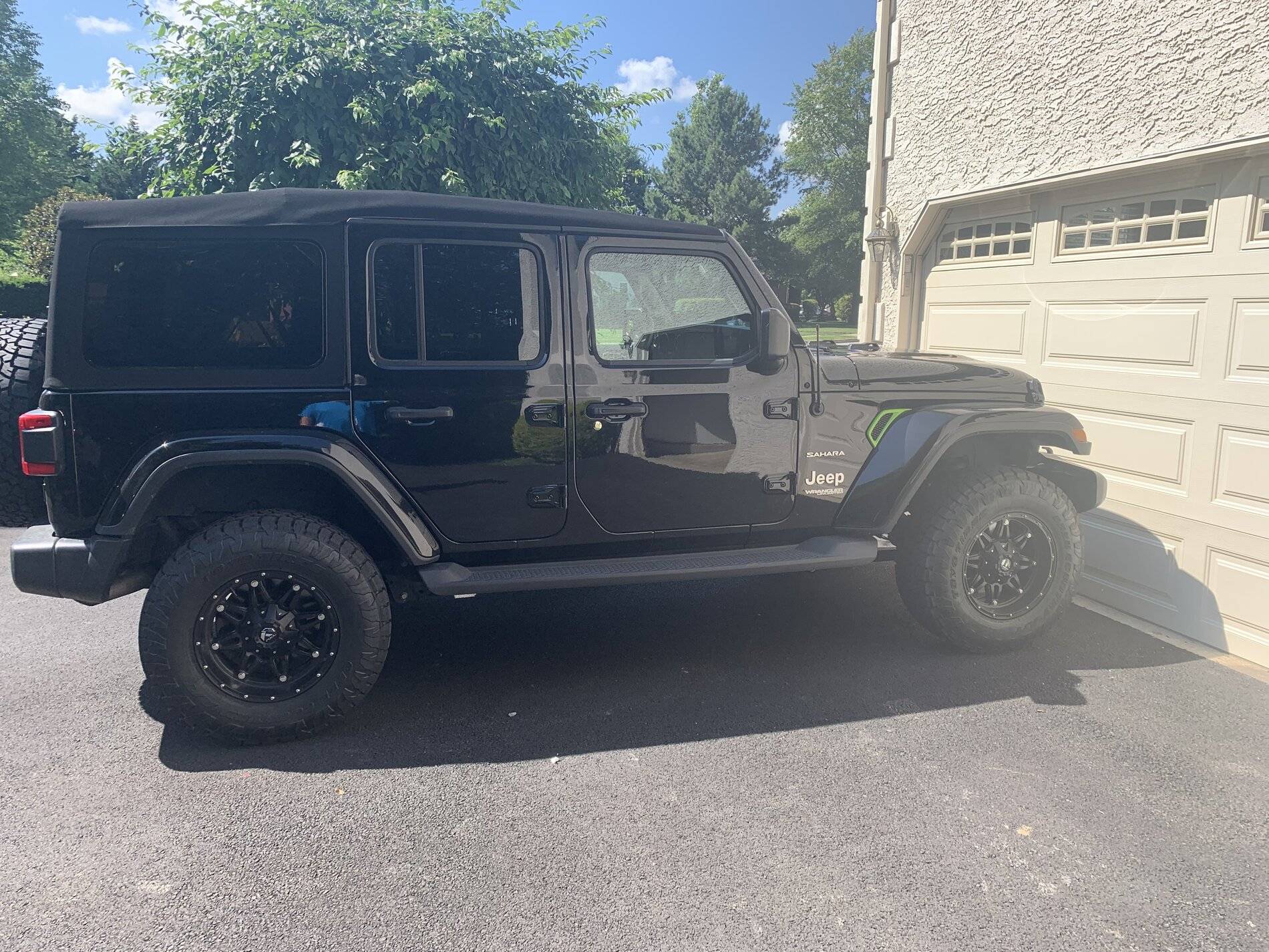

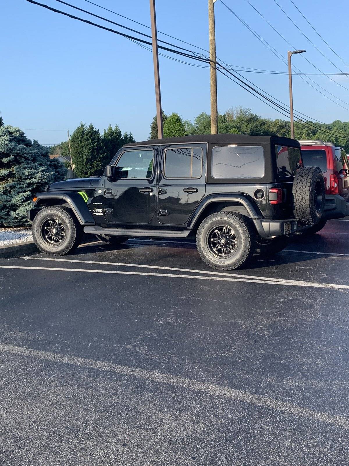

Just picked up the jeep. Caster was 4.1 before and after it was 4.0. I think .1 is within margin of error.
So essentially it came out about what it went in for.
Here is the before and after. Looks good with 33’s. Will look better in 3 years with 315’s.

Seems fine to me. No rubbing. Just got back from some light trails today. I was planning on 33's. But I got lucky and picked up this set with wheels for $500. Pretty happy with it.
