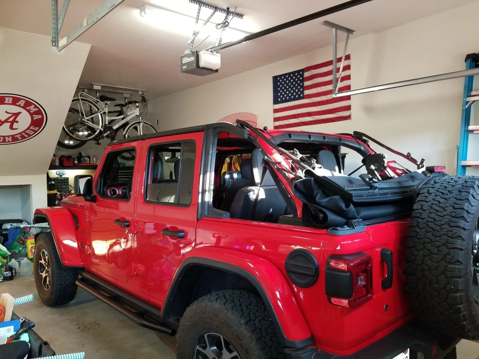

This is the "correct way" to run your soft top!
Looks like premium soft top is a totally different set of mechanics

What are the mechanics like on the standard soft top?
Isn’t that what your picture shows? Maybe I’m just seeing the difference from my 2dr if yours is premium.
