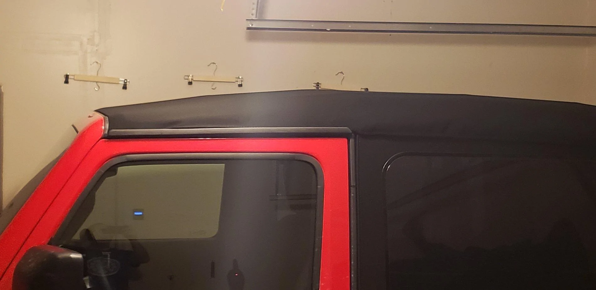

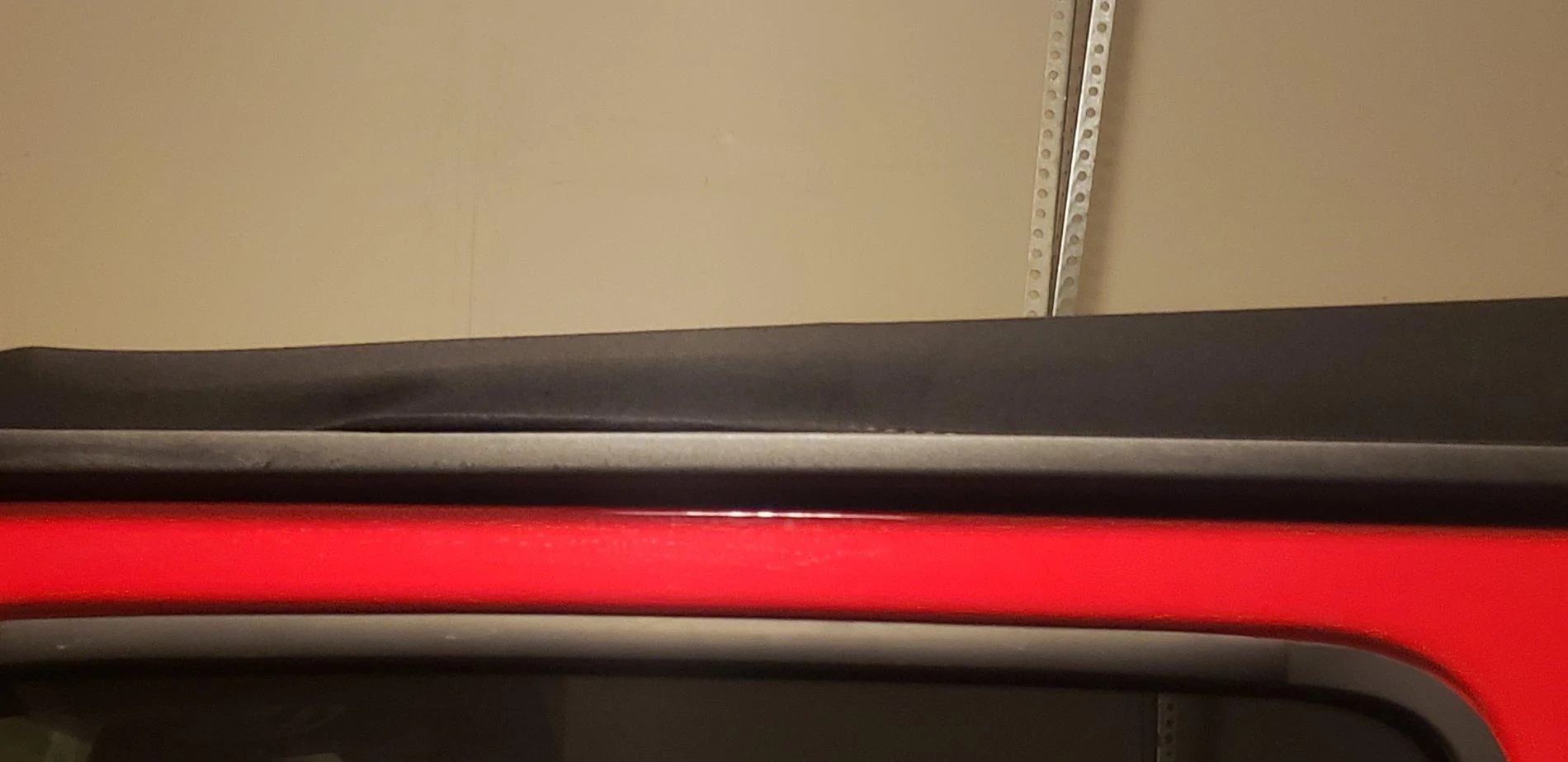

This is how mine looks after some time with the new tension. It just doesn't sit right or something.
Jeep Wrangler JL 2 door soft top issues 20190406_114050
Jeep Wrangler JL 2 door soft top issues 20190406_114042

Mine looks similar. Also one of the side windows is pretty distorted and the new tension made it worse also.
