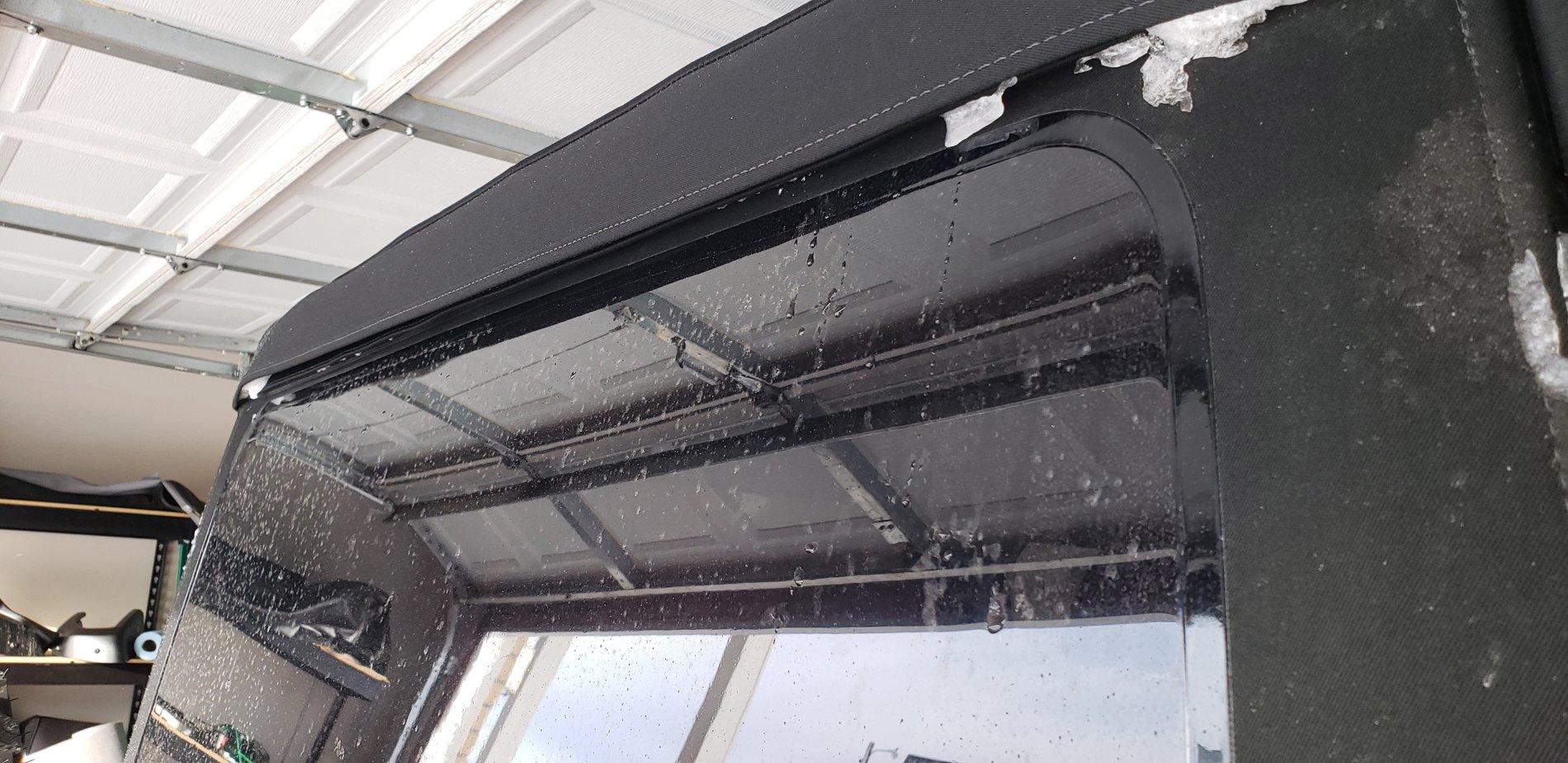

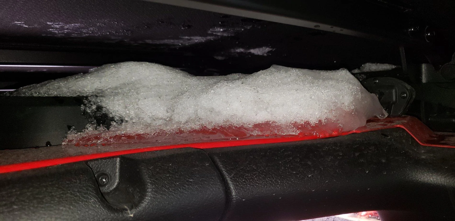

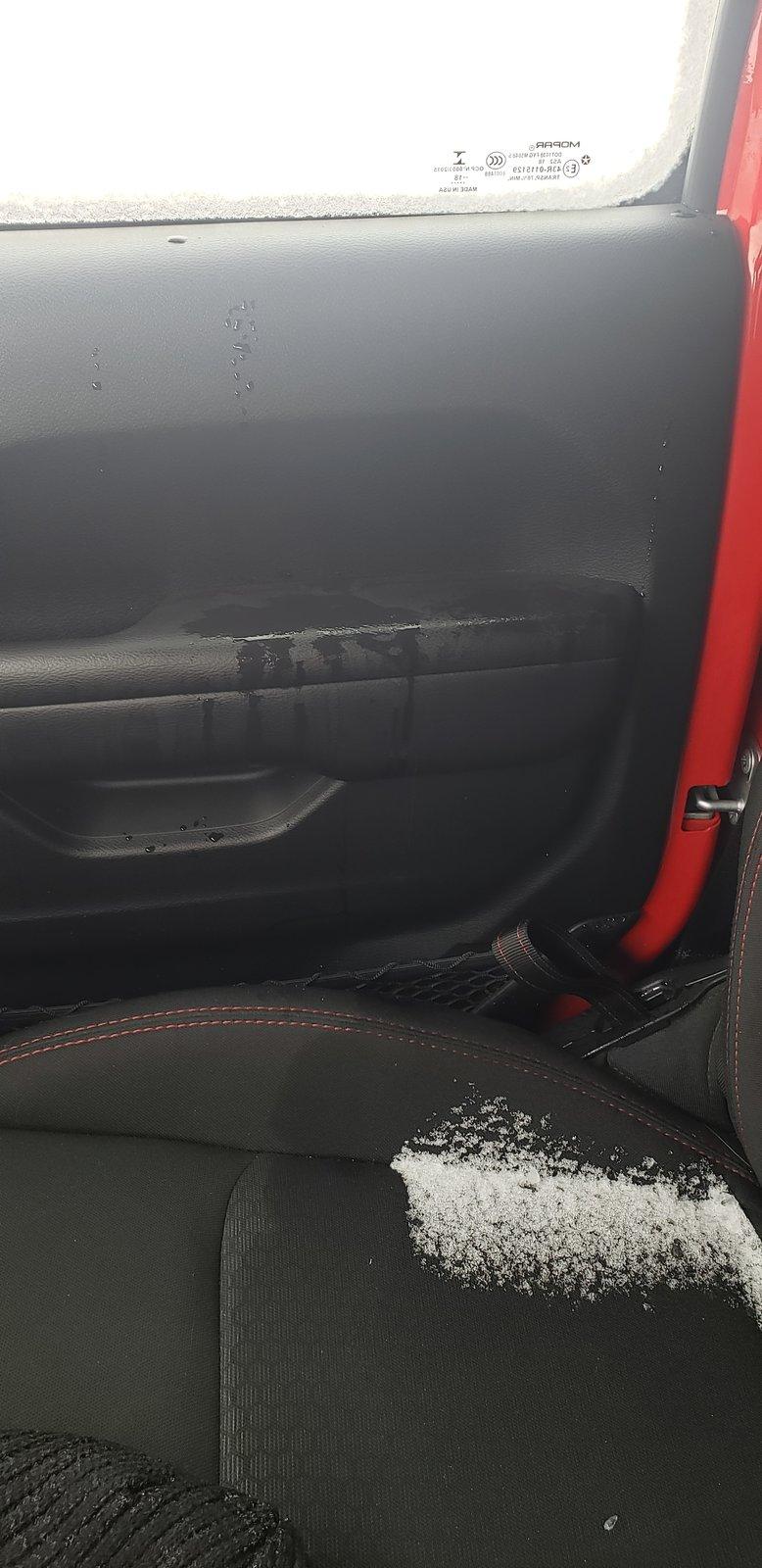

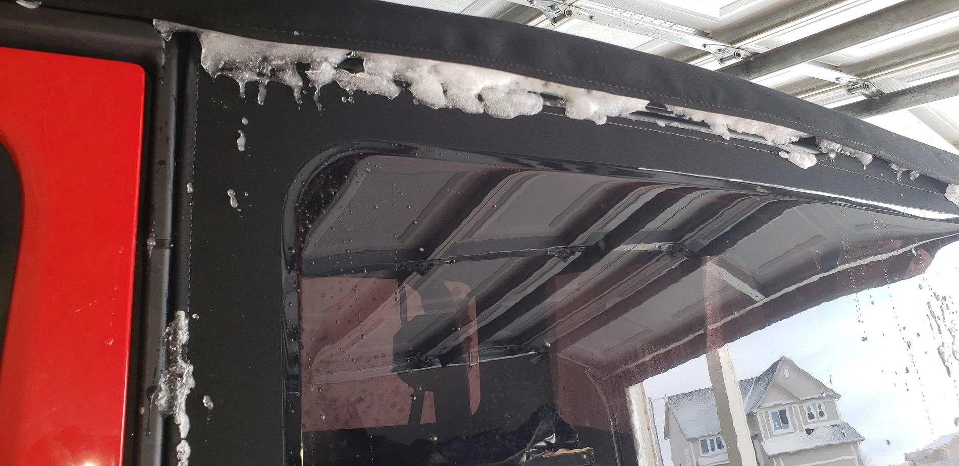

Welp, had a great test for the new top... Colorado Springs was hammered with a blizzard yesterday and the top did about the same as the original, worse in some aspects.
Snow got in and froze the top sides open. Snow got onto the roll bar and melted down the rollbar into both seats and on/in the center console. The side windows had a huge gap but the rear window didnt have it hardly at all.
