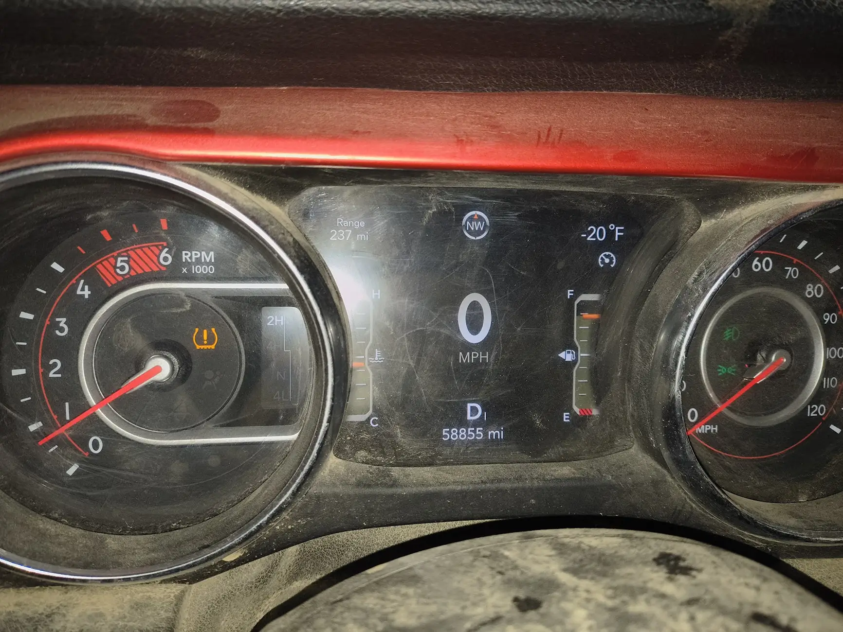

I will reply more fully once home from work. But, do you get a "water in fuel" symbol when trying to start? Do you let the glow plugs do their thing, before trying to start? Do you have the block heater? I had -20 before the wind (not sure if wind-chill actually has a bearing on starting), I will post a pic later, and she started right up. Chat later.

- I also religiously use Howes diesel treatment and/or other diesel treatments EVERY fill-up.
- Also using #1 or #2 diesel. Stopped using the bio-blend in the coldest months. Not sure if that has a bearing...just what I do.
It will crank but won't run for more than a few seconds.
So, it DOES run for a few seconds?
Not a battery issue then?
Leaning toward a jelling of the fuel in the fuel filter. Do you get this symbol when starting?
How long have you had her & have you changed the fuel filter yet?
