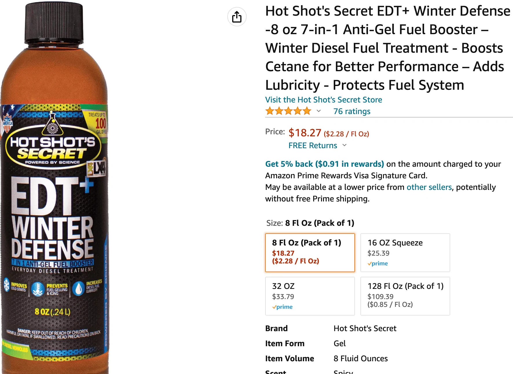

Realistically you should be good down to -10f the only thing I’d do is ensure your using local fuel. It may be mixed to not gel in lower temps.
This. Hot Shots sells a winter additive, grab a bottle or two and you’ll be good just in case.

I live in PA and we had one night where we got to single digits and a negative windchill. Jeep wouldn’t start… later that day as it got a bit warmer, it was fine.
For the rest of the winter, I used an antigel additive and didn’t have any issues. Of course, it never got that cold again either.
So as mentioned above, buy some Winter Defense or something similar to be safe.
