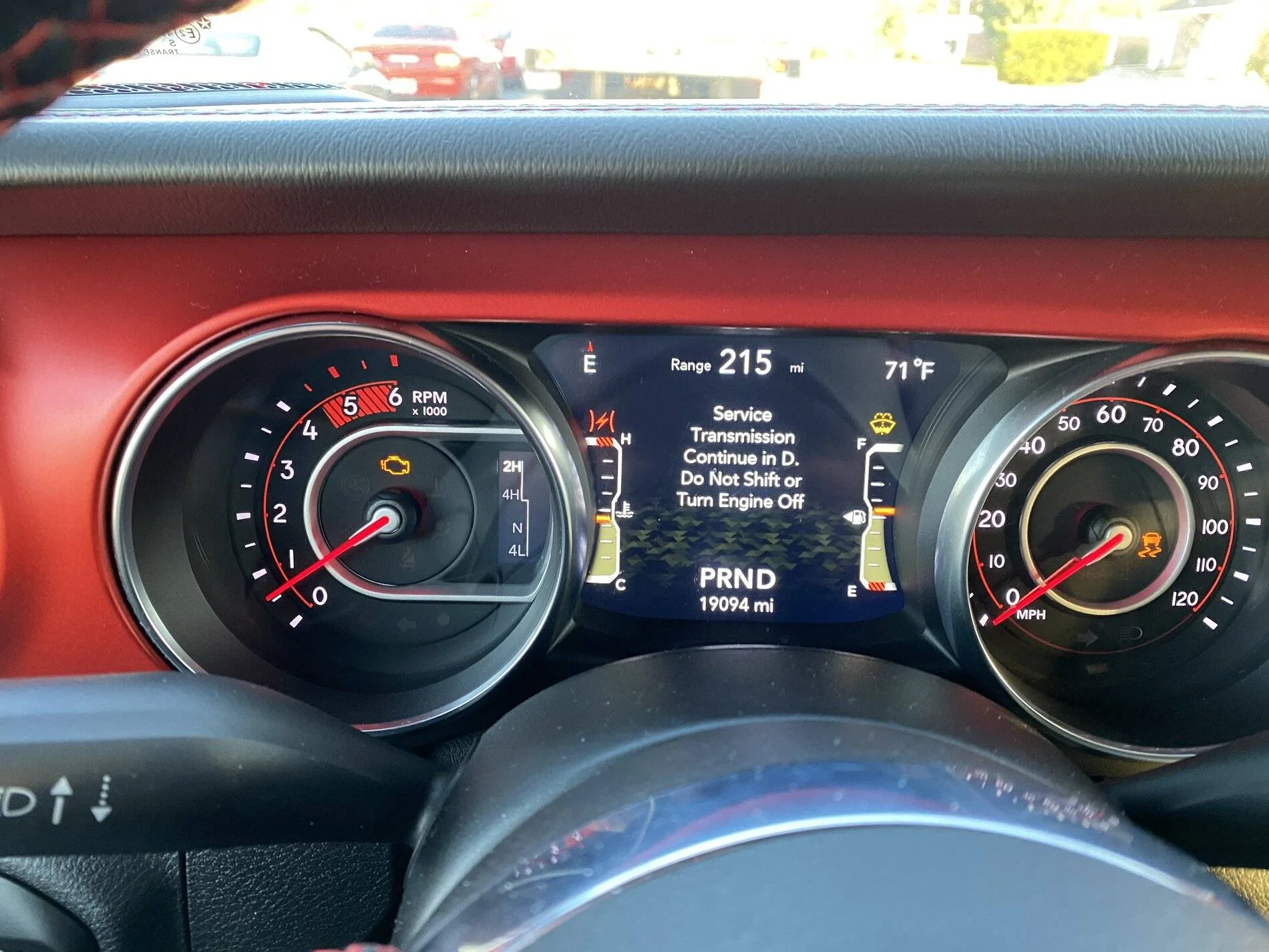

Coastalkid
Kevin
Oct 24, 2021
New Jersey
2021 Rubicon Unlimited Diesel
With the Engine warmed app 25miles, stopped at a light went to accelerate, 1st gear slipped pretty hard then this came up. Went into limp mode. No faster than 35mph. 19k miles trouble free???
