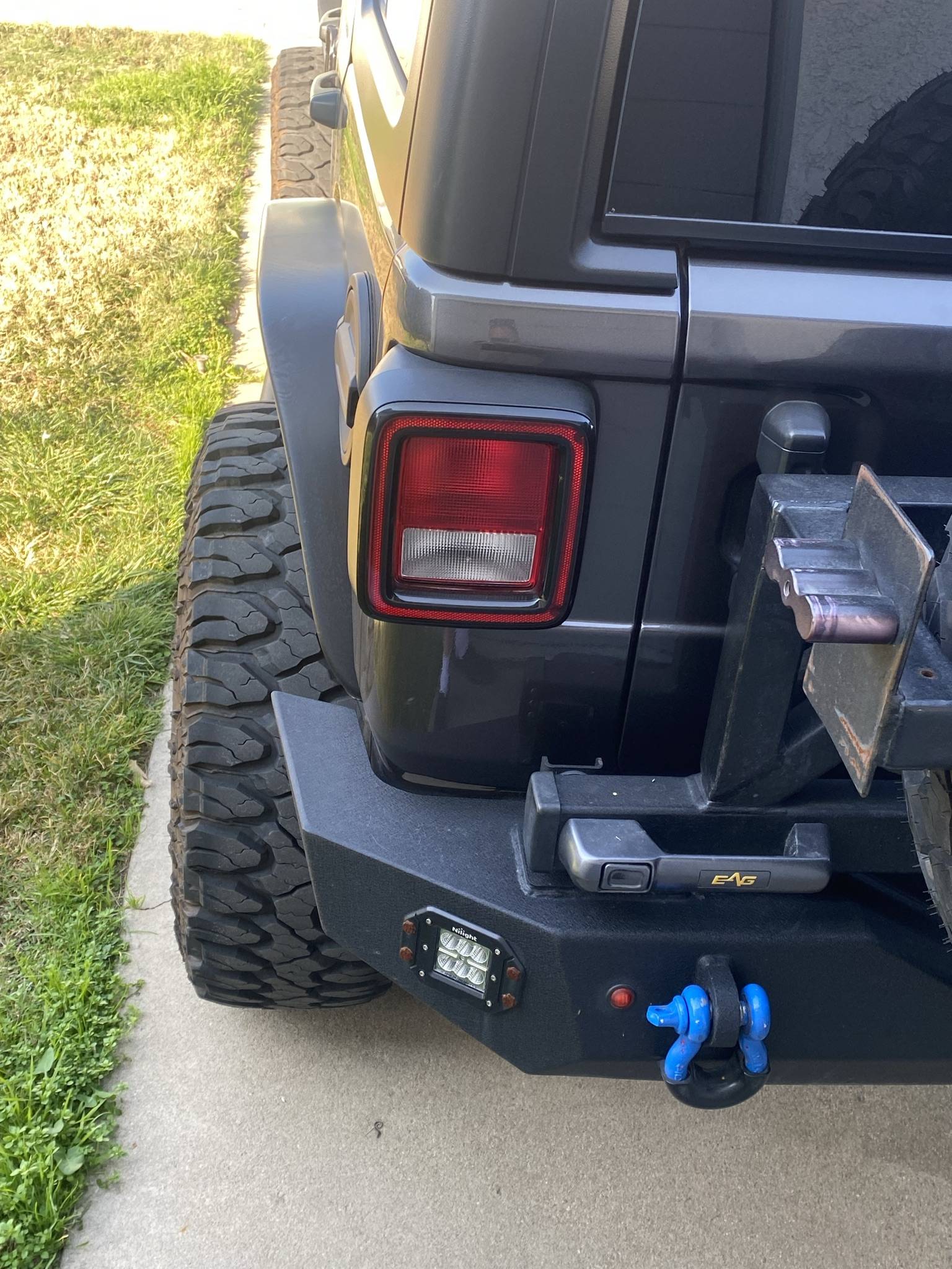

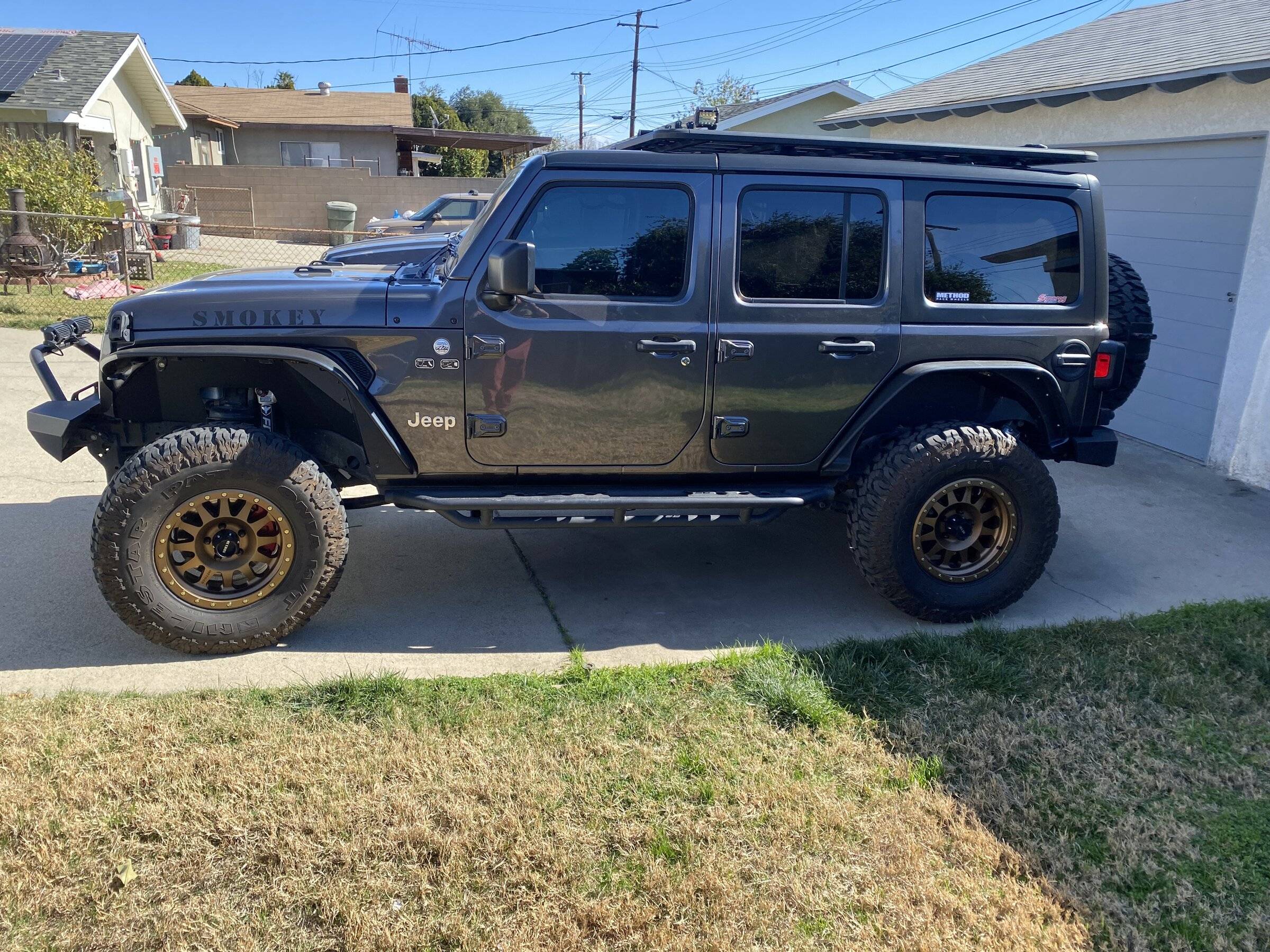

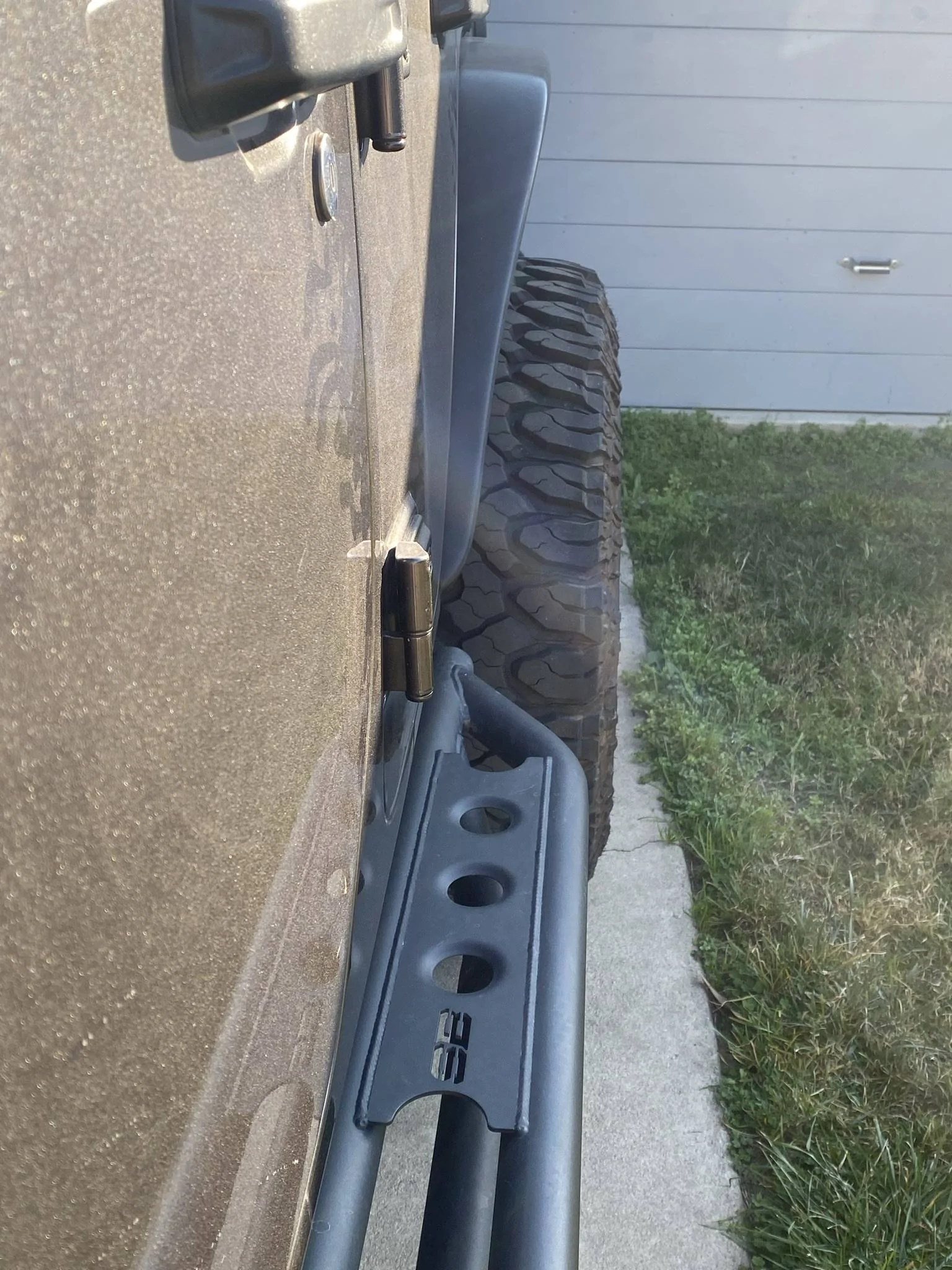

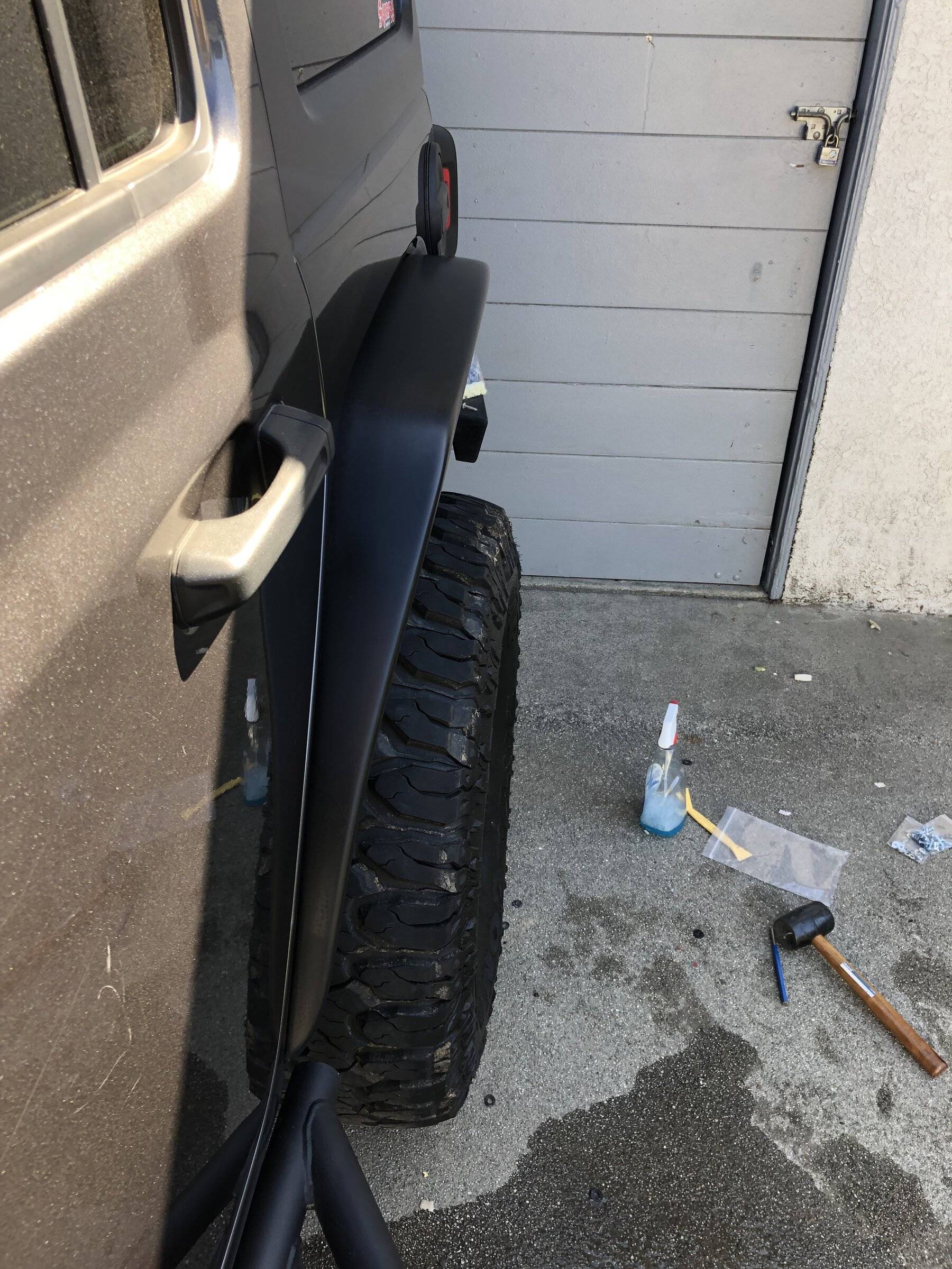

Here’s a front from the original install of the front fenders and a side shot of the rears tires are 315-70/r17

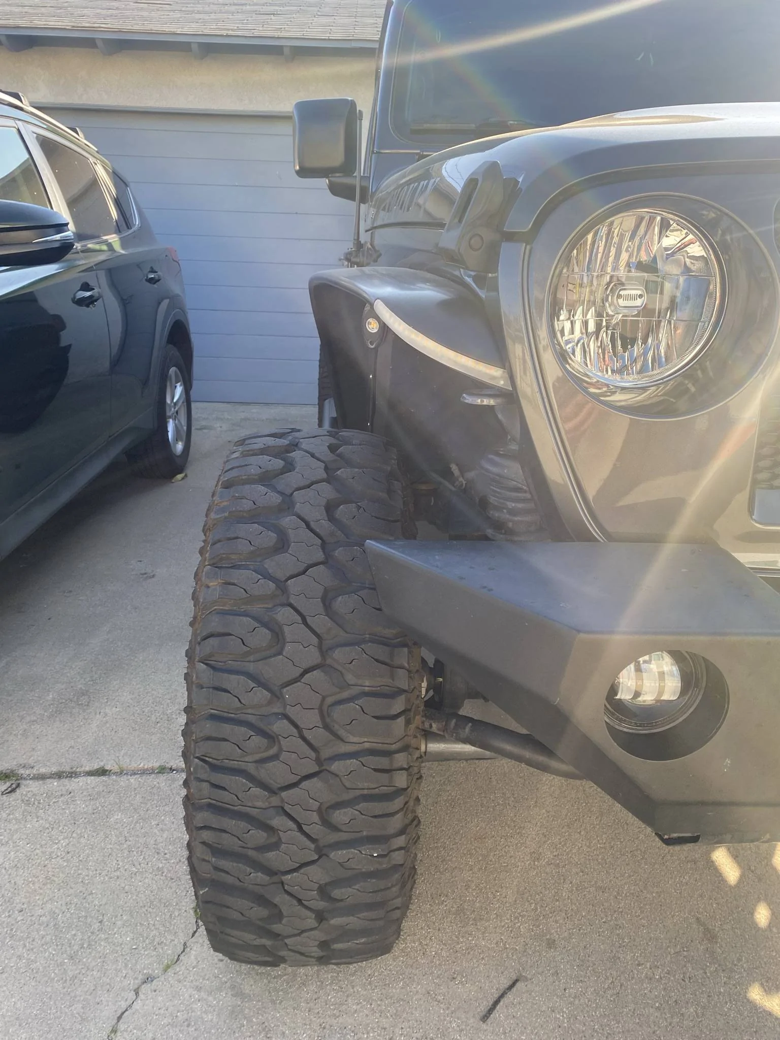

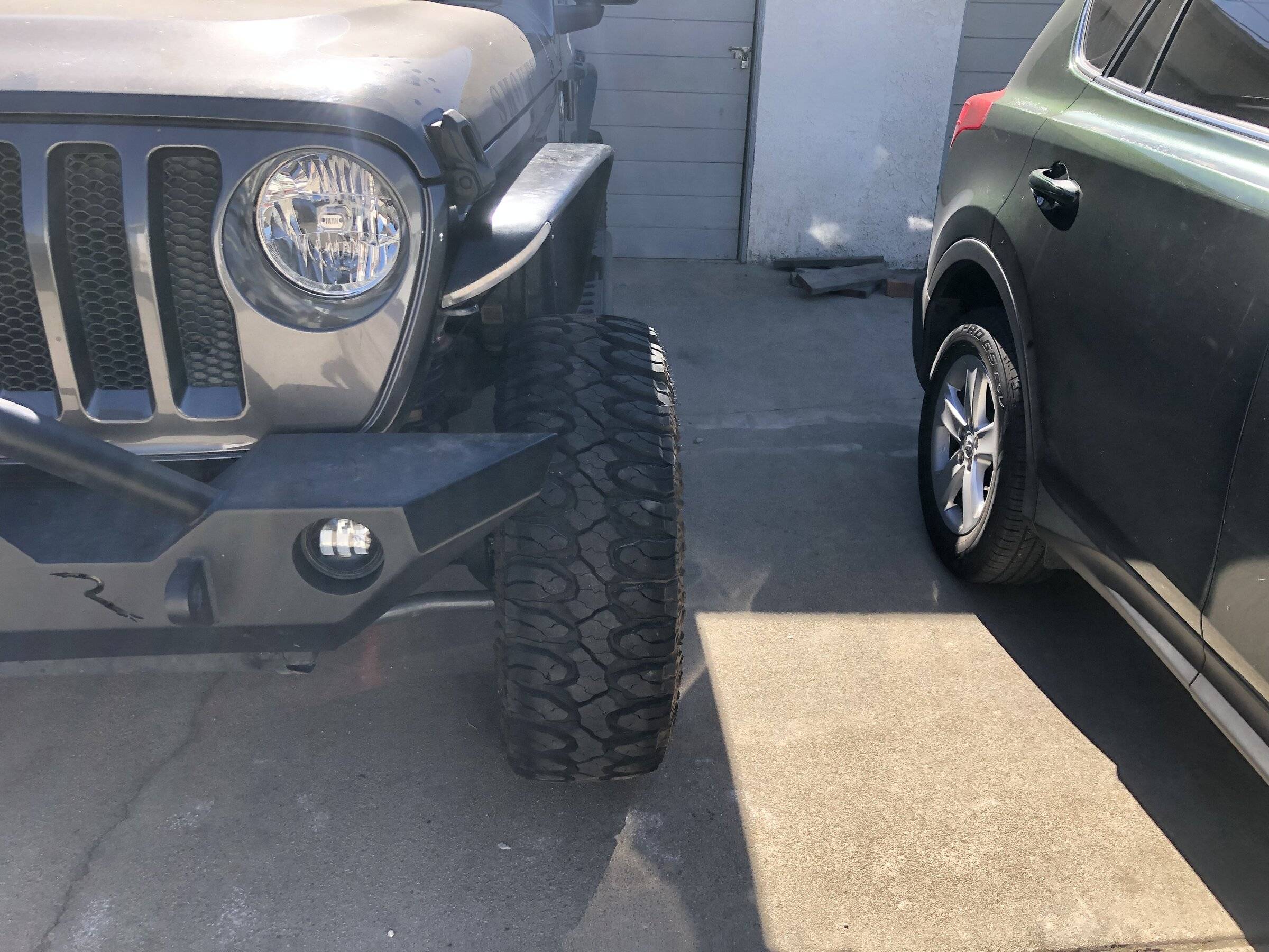

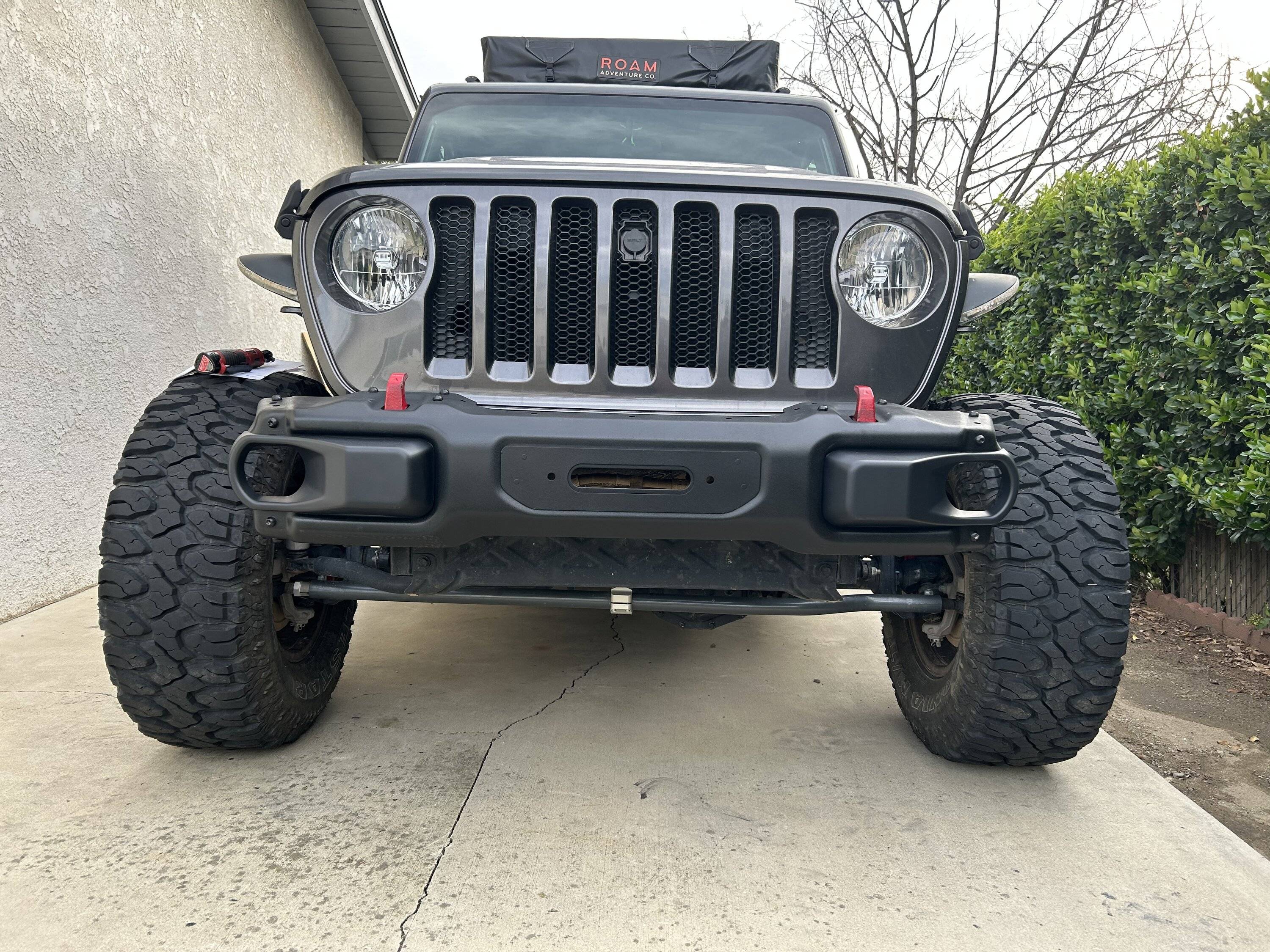

@4x4tographer here’s some pictures with the new wheel offset!

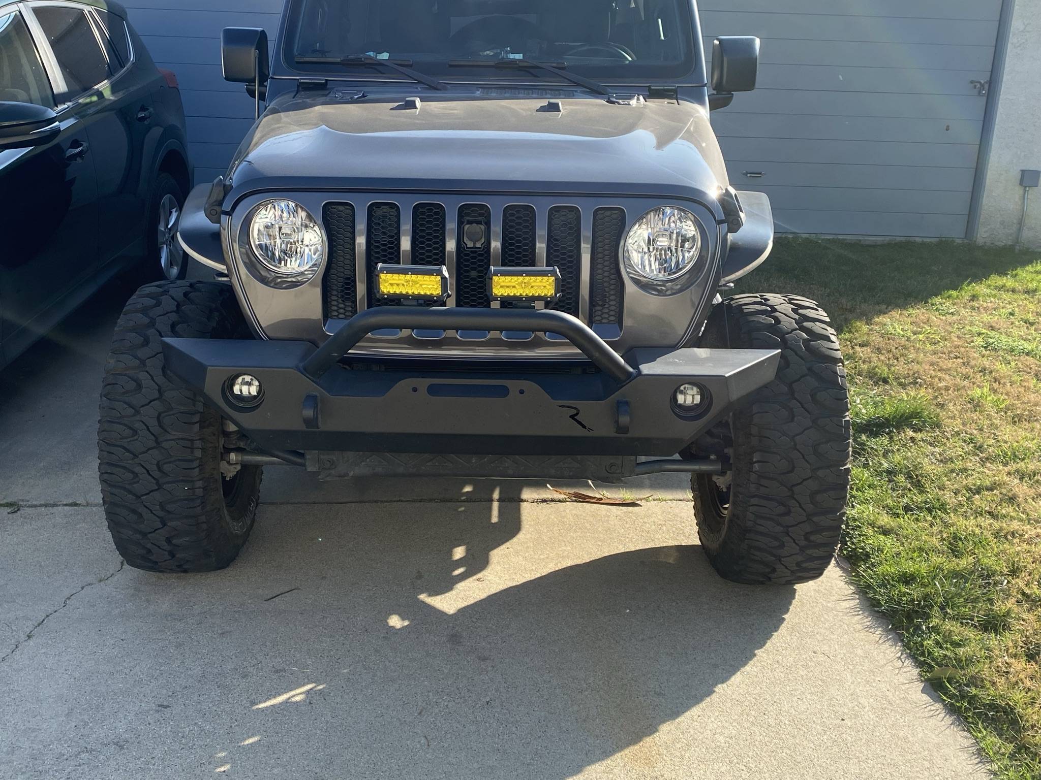

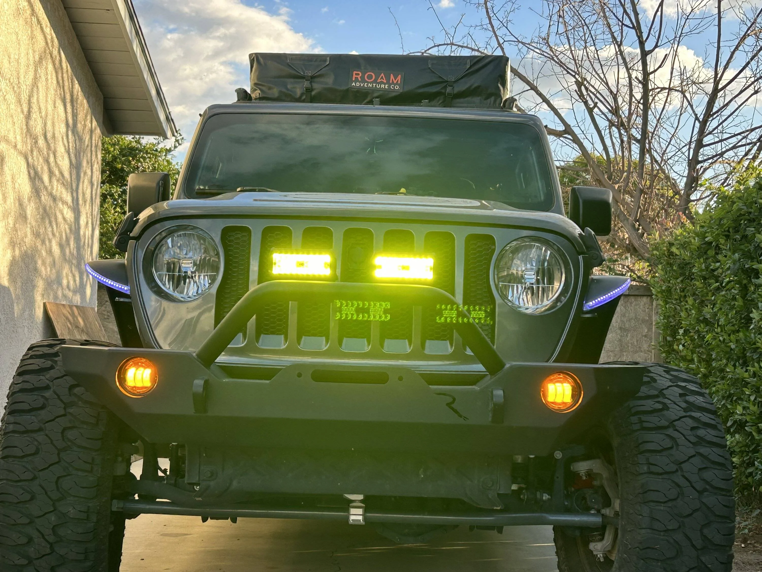

Update. Installed front Rubicon steel stubby bumper. Ordered new fog light bezels to replace the broken and scratched ones on the bumper now. I also have an American trail winch plate, and factory fog light wiring harness on order This should hold me off until I pull the trigger on some led fog lights. Before and after picks

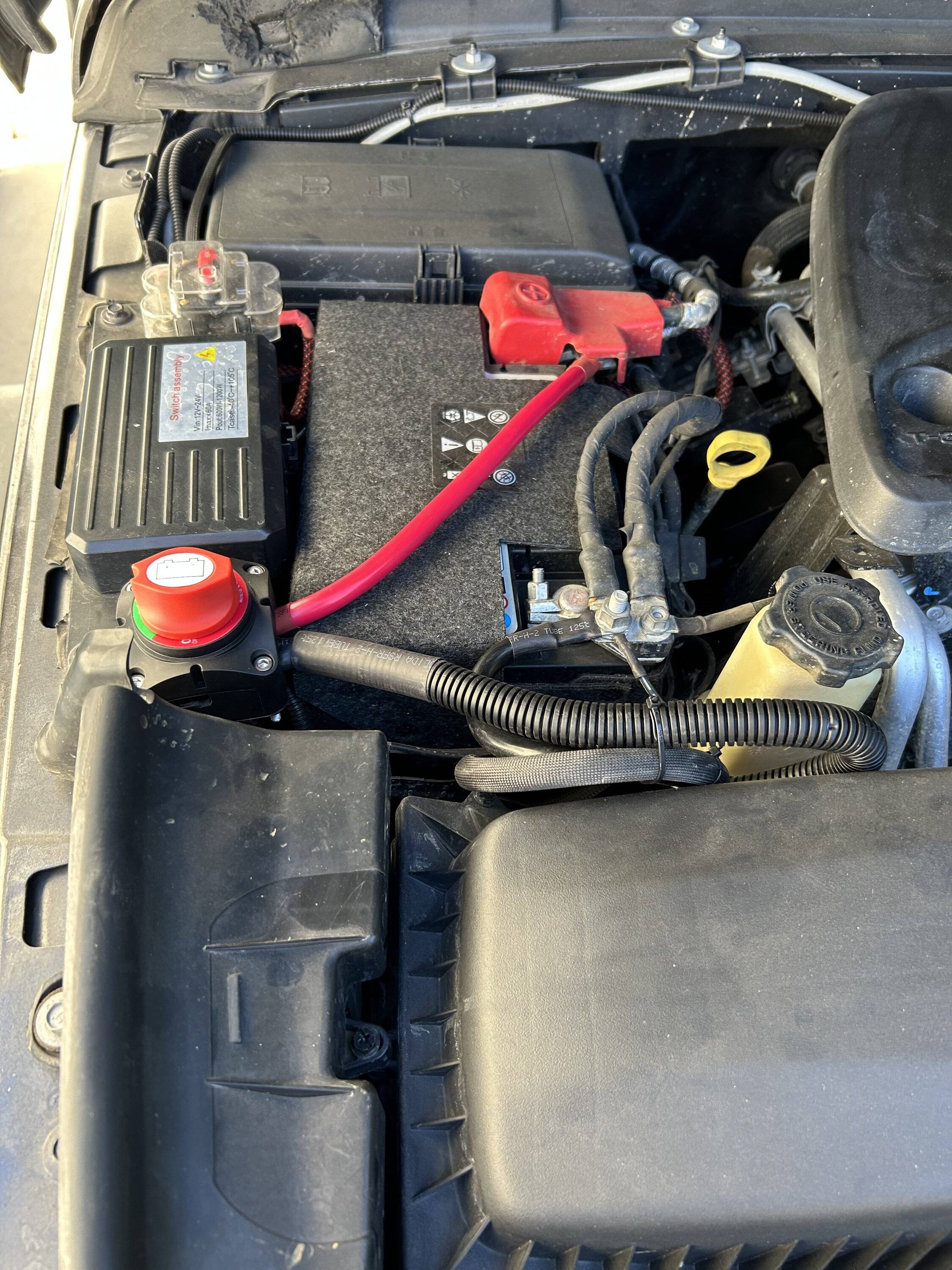

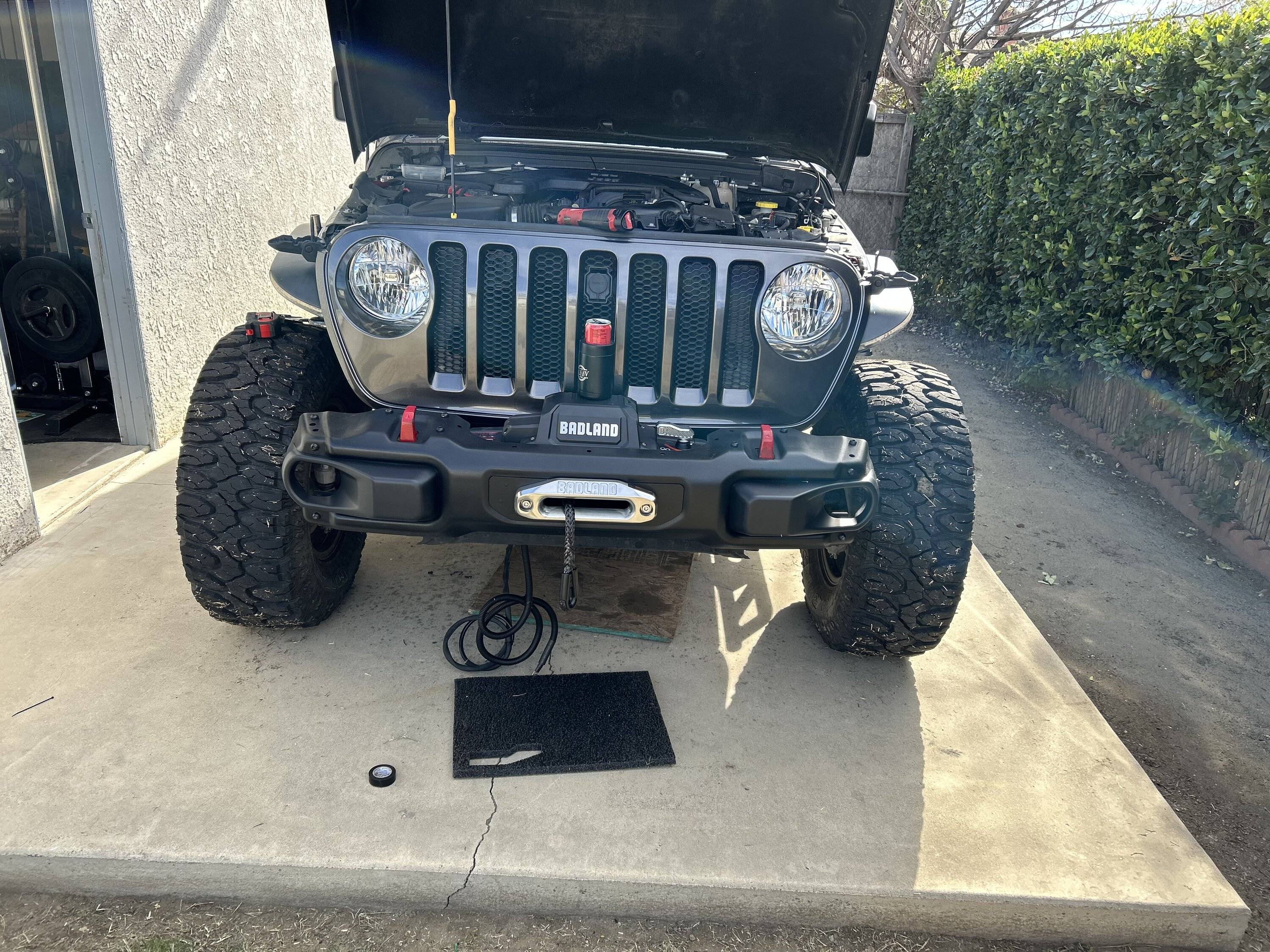

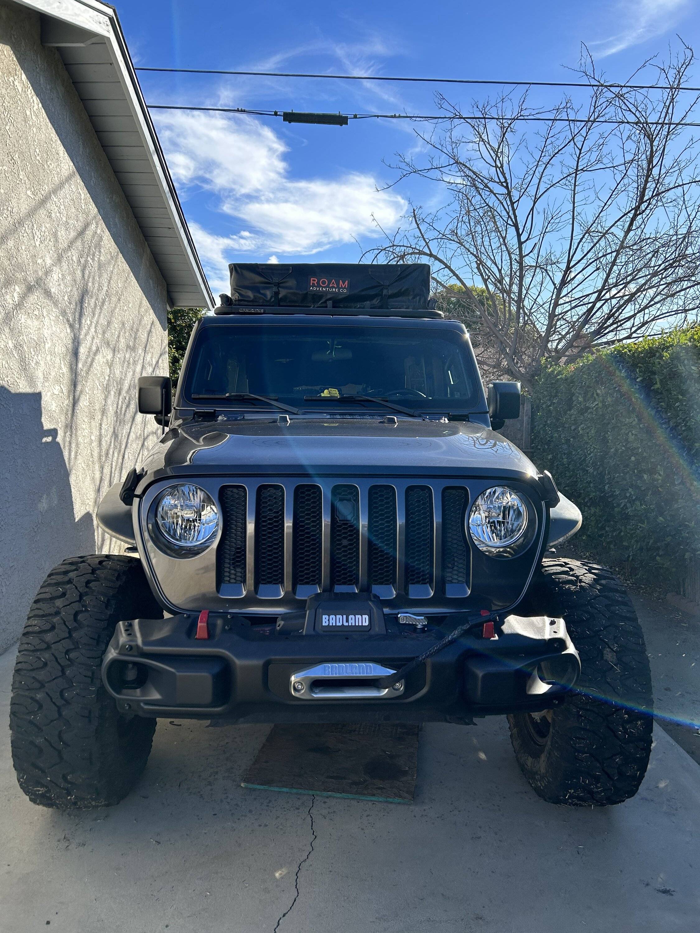

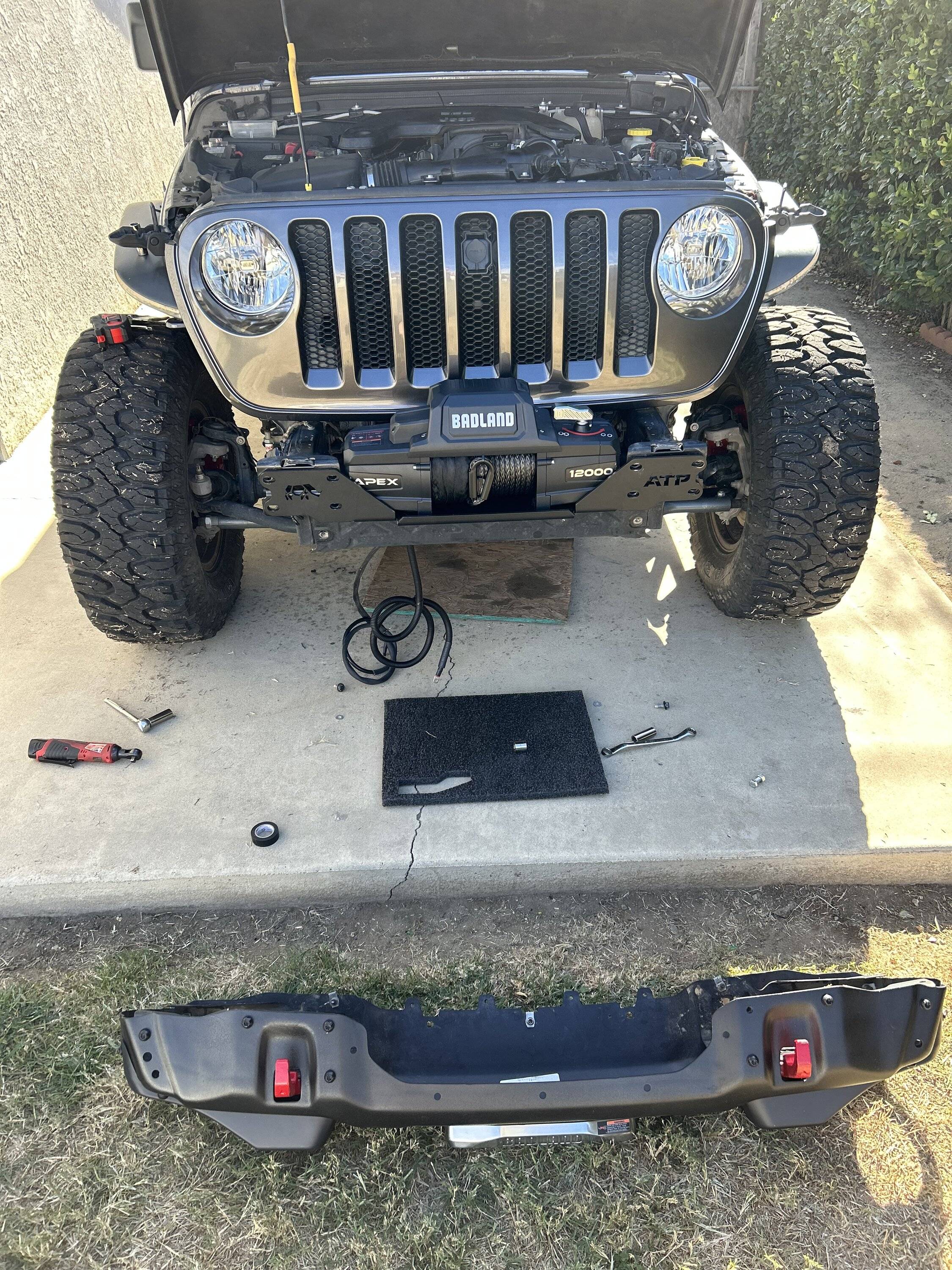

Installed the ATP winch plate when it came in. Today for Black Friday I picked up the Badlands Apex 12k winch and installed it. Fit pretty well. Was a little tight with the wiring but I got it to work pretty well. The Apex winch comes with everything needed for install except the winch plate. Even came with a power disconnect.
Jeep Wrangler JL SmokeyTheJLU Build Journal 200802A1-229F-490D-8E91-E2049424D997
Jeep Wrangler JL SmokeyTheJLU Build Journal D6C54AFE-337E-4F65-BE26-8063A21595F0
Jeep Wrangler JL SmokeyTheJLU Build Journal 3F3A1649-6900-431E-B12A-DF28A5DF4D07
Jeep Wrangler JL SmokeyTheJLU Build Journal C0C085F3-08C8-485E-BA3F-0B7E7FCF87BF
