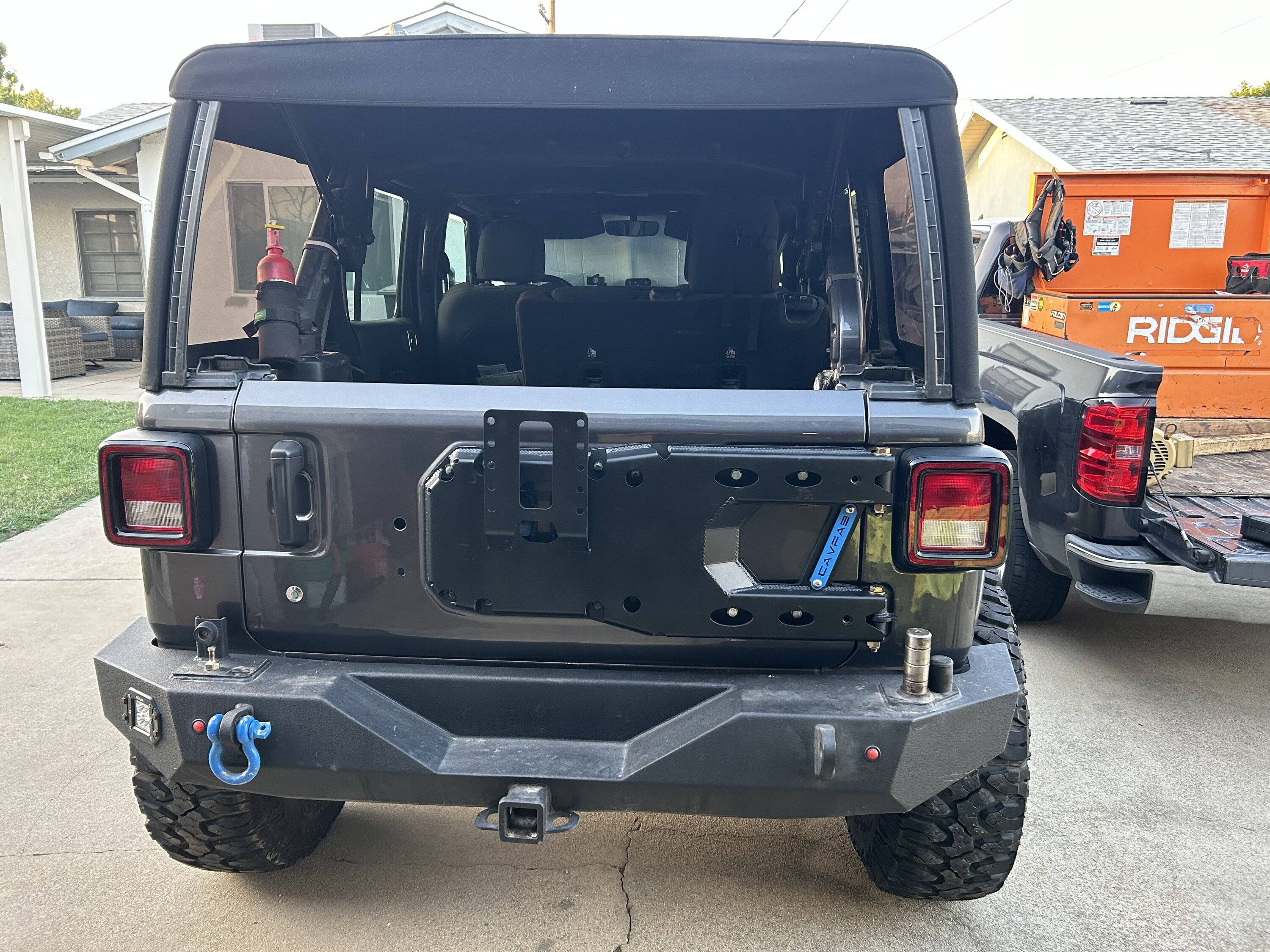

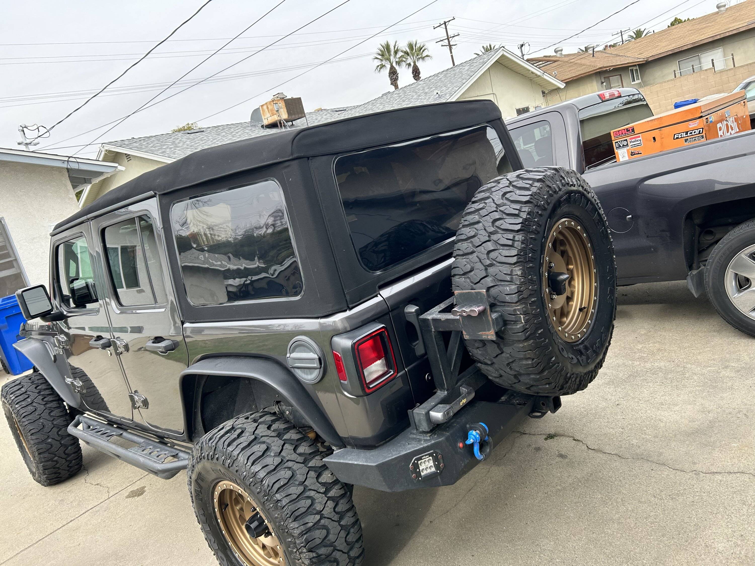

Smokey is now in summer mode. Picked up a premium soft top from another forum member. Basically brand new. Didn’t realize I was losing about and inch of lift with the hardtop, RTT, and rack system. It weighs in at over 200lbs. After removing those. Soft top was a easy install for sure. Can’t wait for some better weather to run safari mode

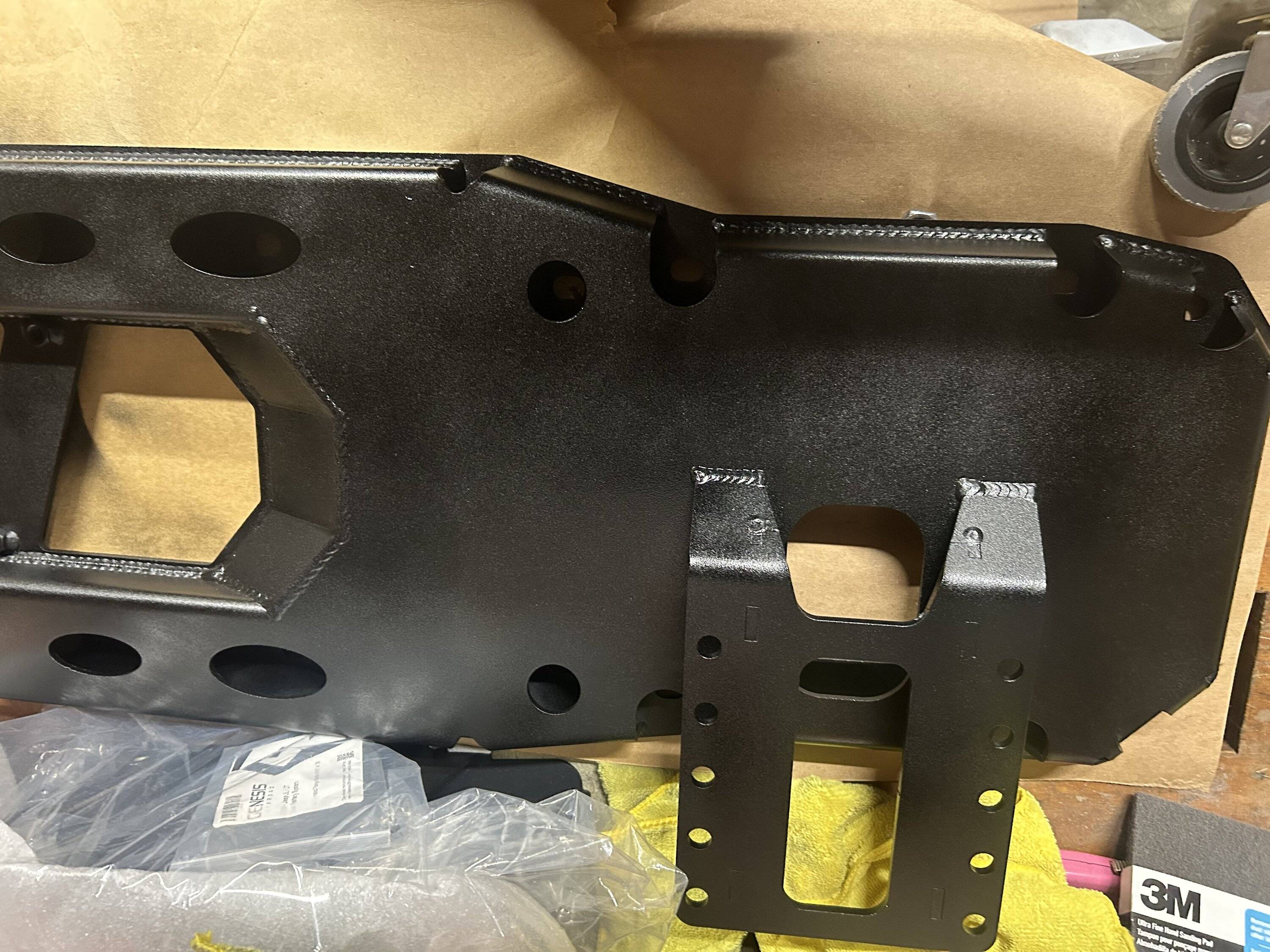

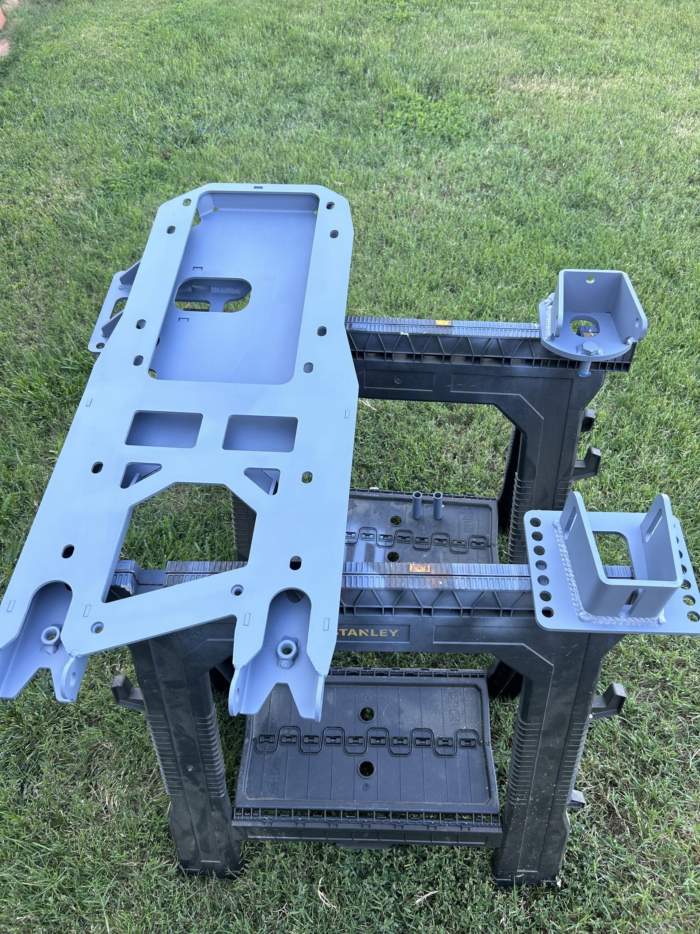

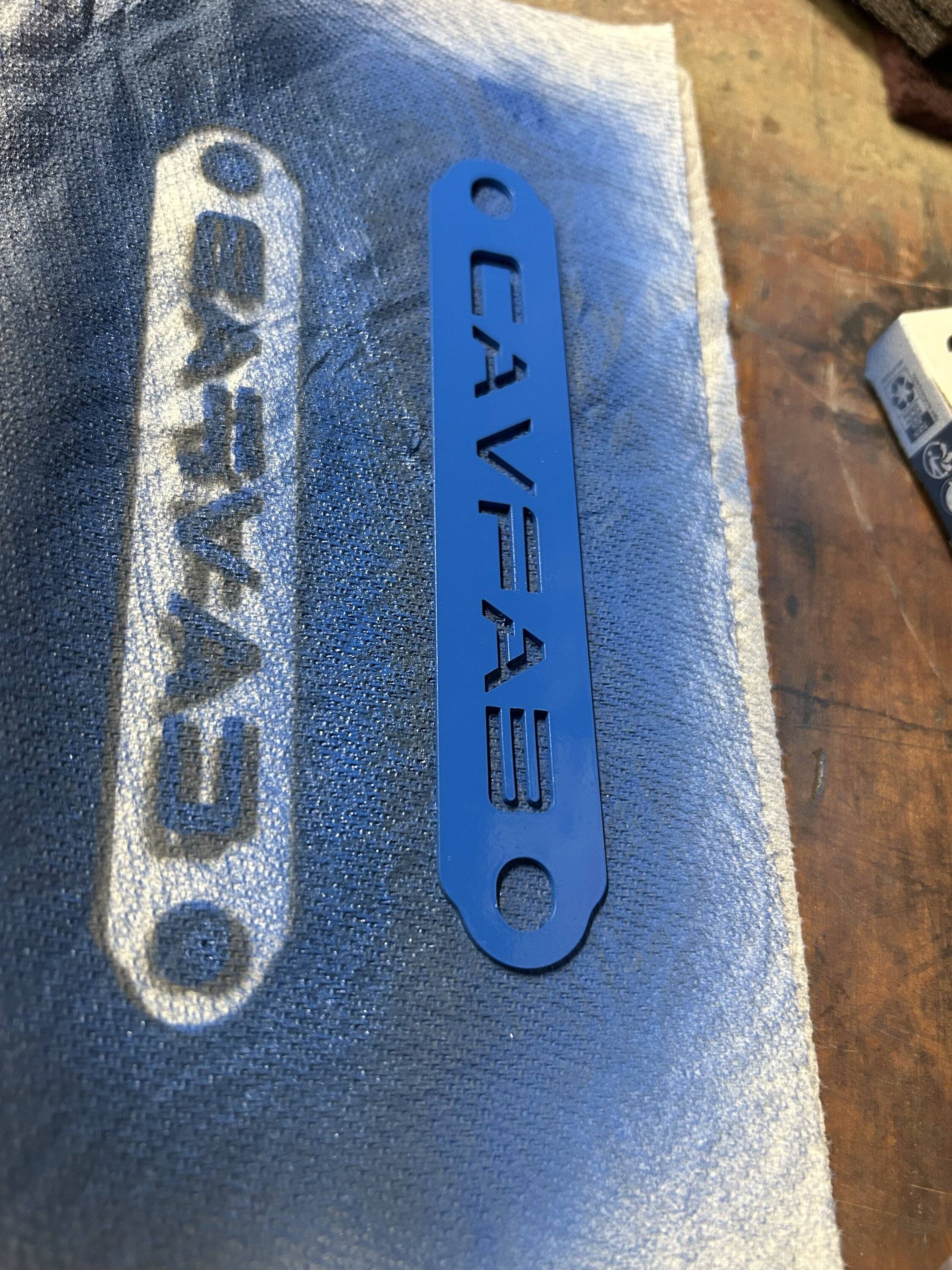

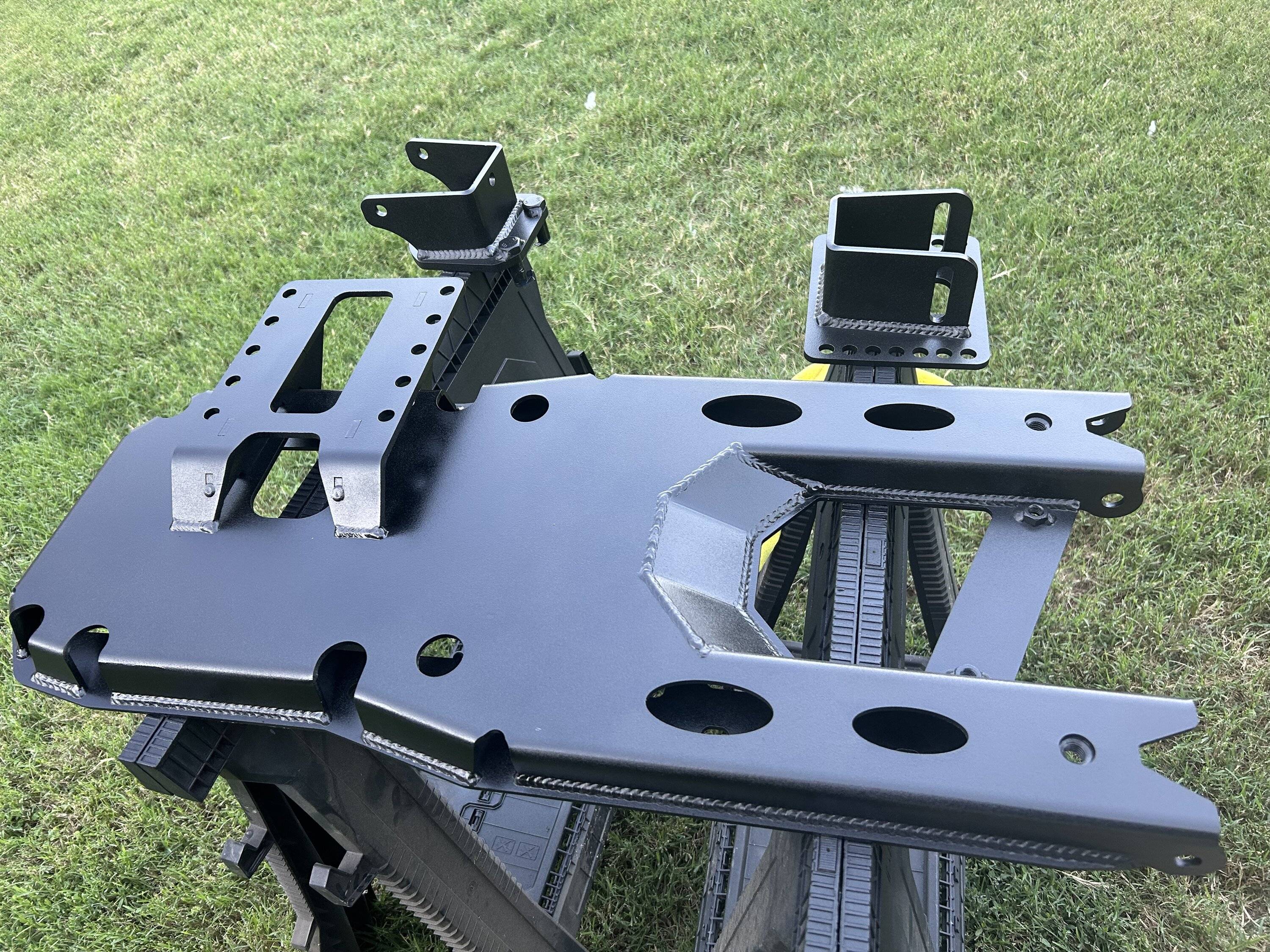

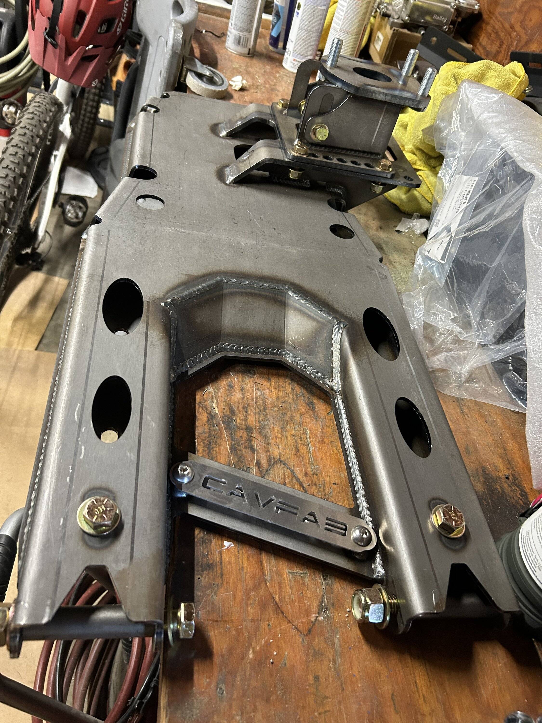

Cabfab tire carrier has been delivered and I have started the removal of the EAG tire carrier. Need to remove the bumper so I can trim off the carrier hinge, latch striker, and both bump stops. Hopefully in the next week or two I’ll get those off. For now I went ahead with priming and painting the new carrier. Just need to clear coat it and start the install process . Dang carrier is heavy duty! Here’s a few pictures of the process

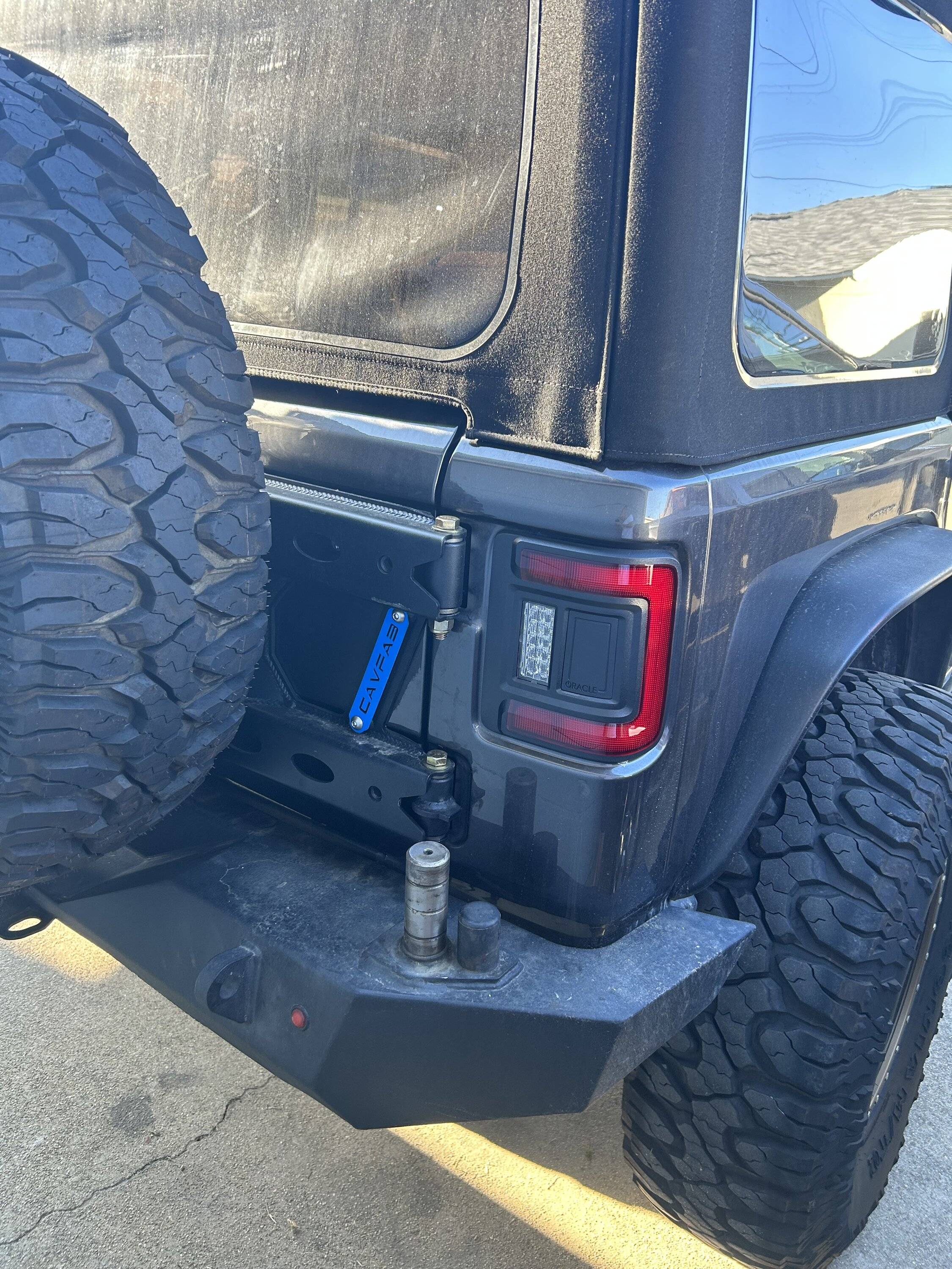

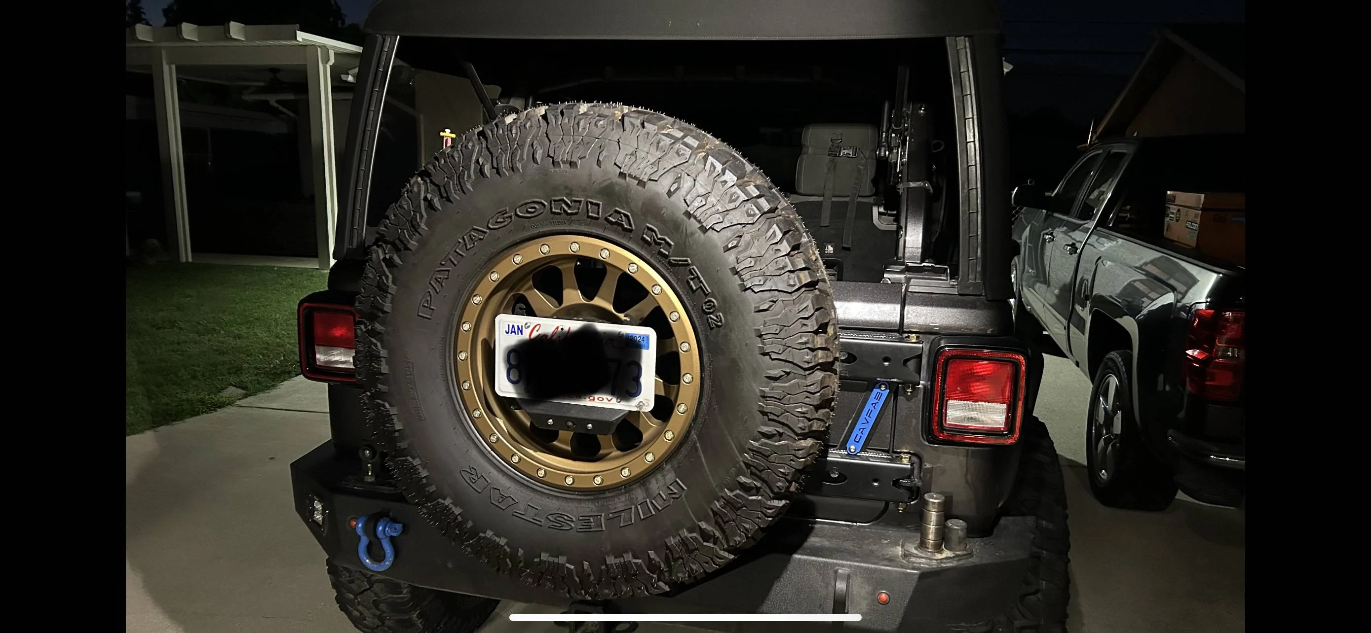

Managed to get the paint completed and clear coat on couple nights ago. Installed the tire carrier lastnight. Managed to get everything lined up pretty well with my 2 year old helping me lol. She’s a great helper when you need a third hand to run the electric ratchet to tighten the hinges in place.. really happy with the outcome. Just wish cavfab provided a couple shims for the hinges and maybe some instructions to browse through to help. All in all I’m happy with it so far.

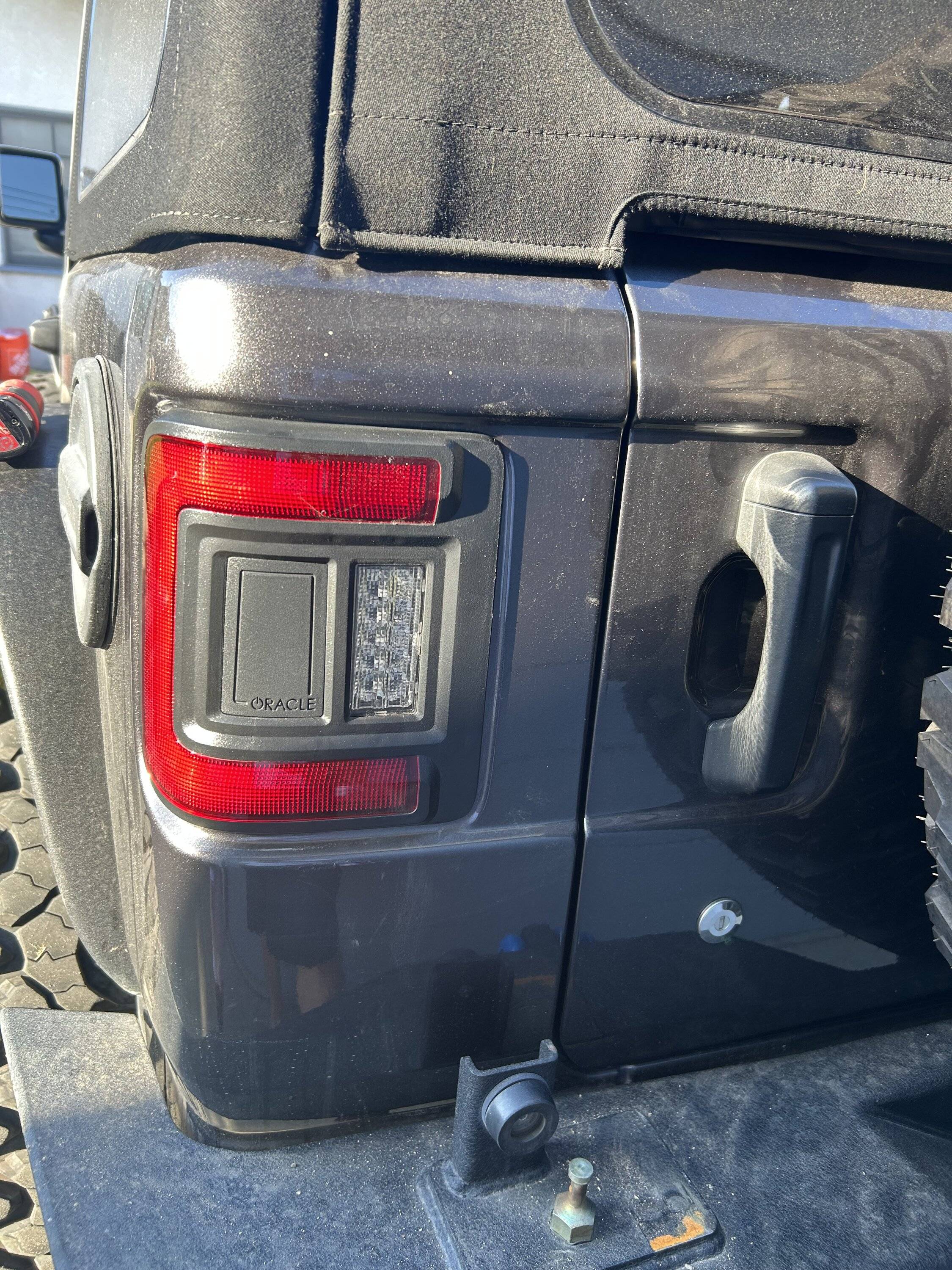

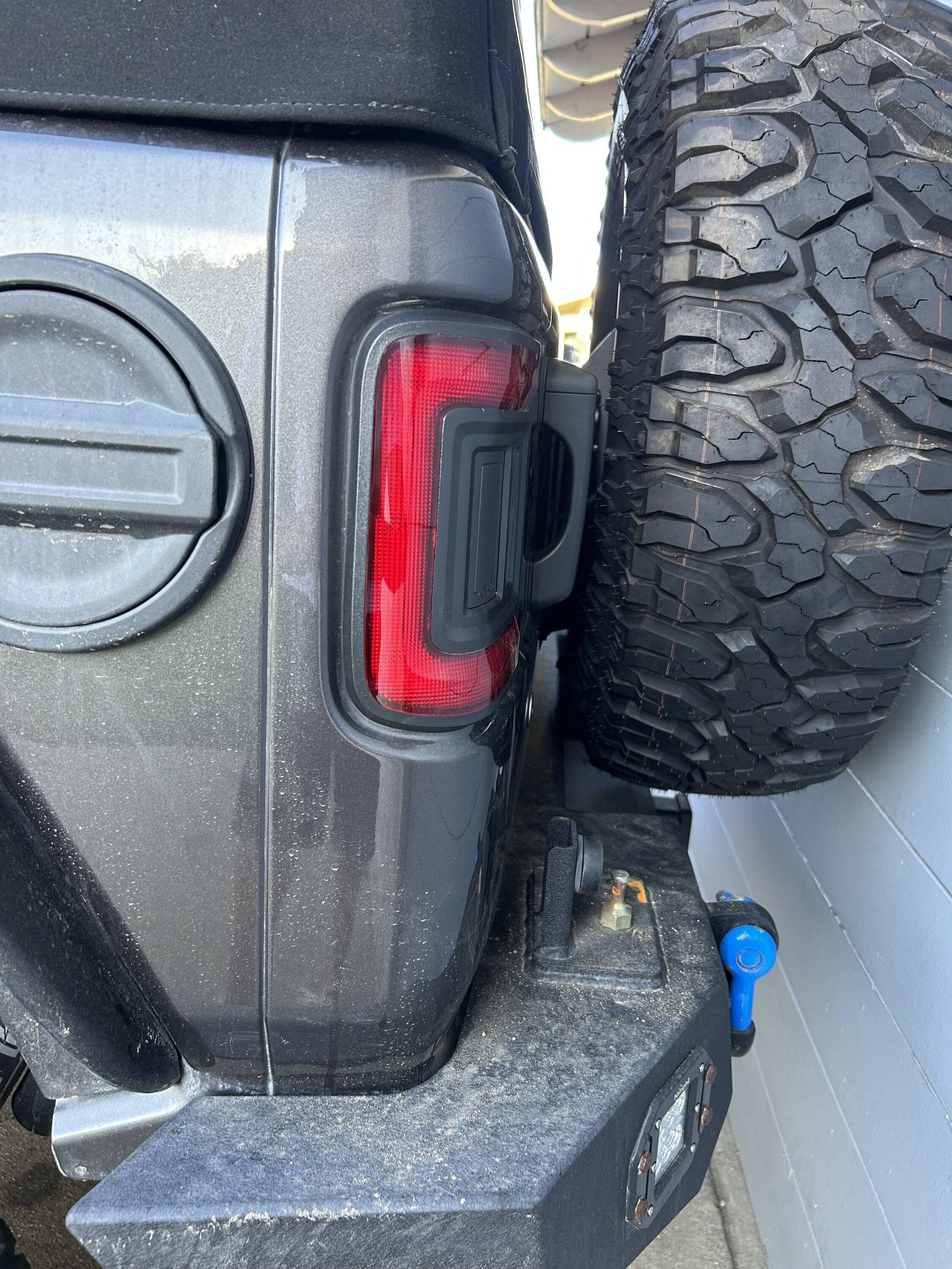

Ended up getting a few mins after ups showed up with the Oracle tail lights. Man what a great system they have designed! Highly recommend them. I was impressed that they had the resistor as part in the kit so you don’t have to do anything if you didn’t have the LED package. The bonus is they look great too

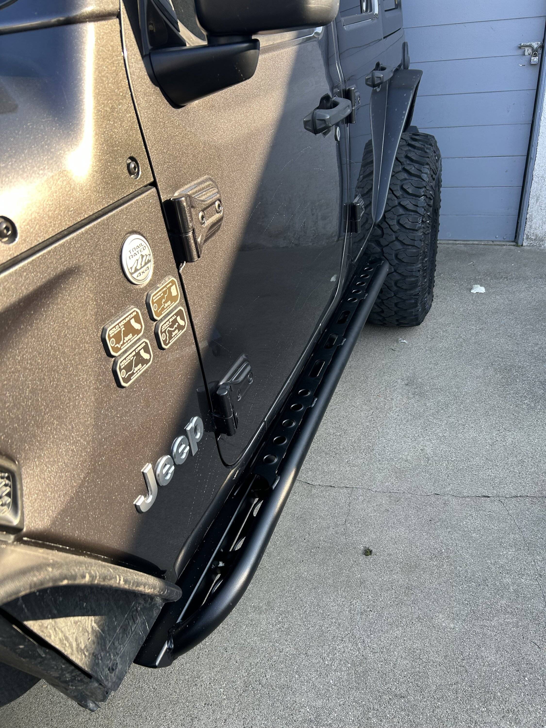

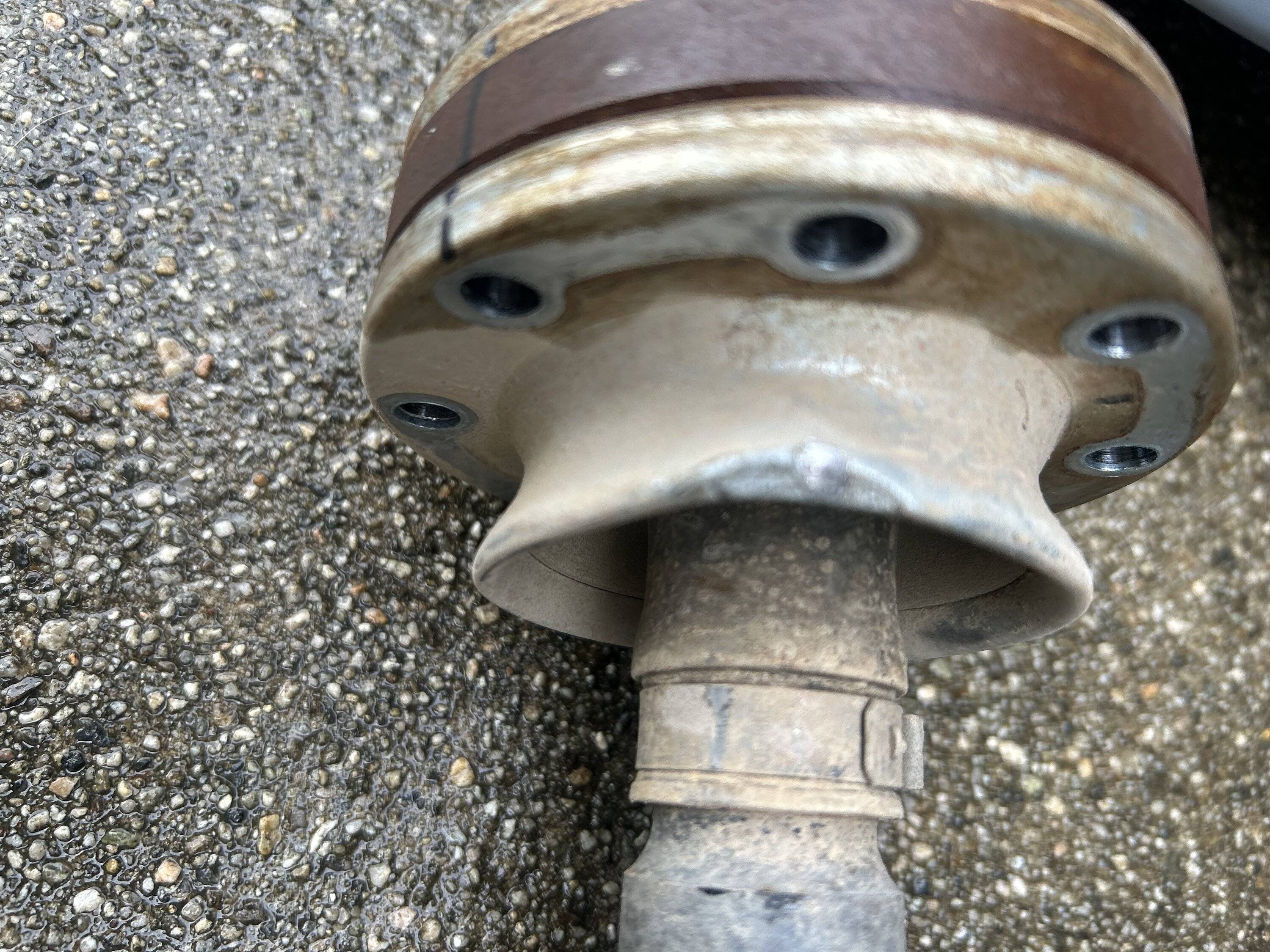

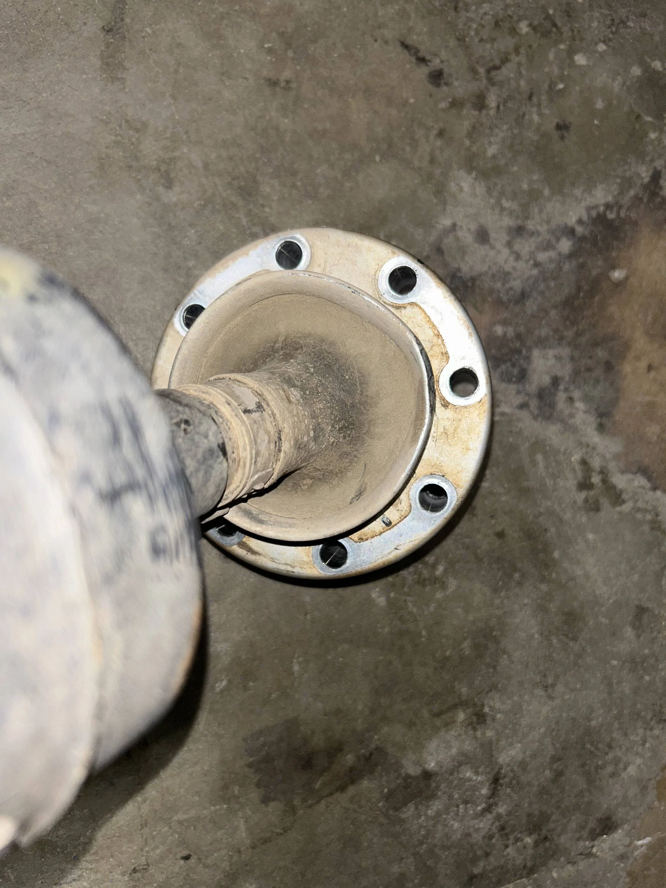

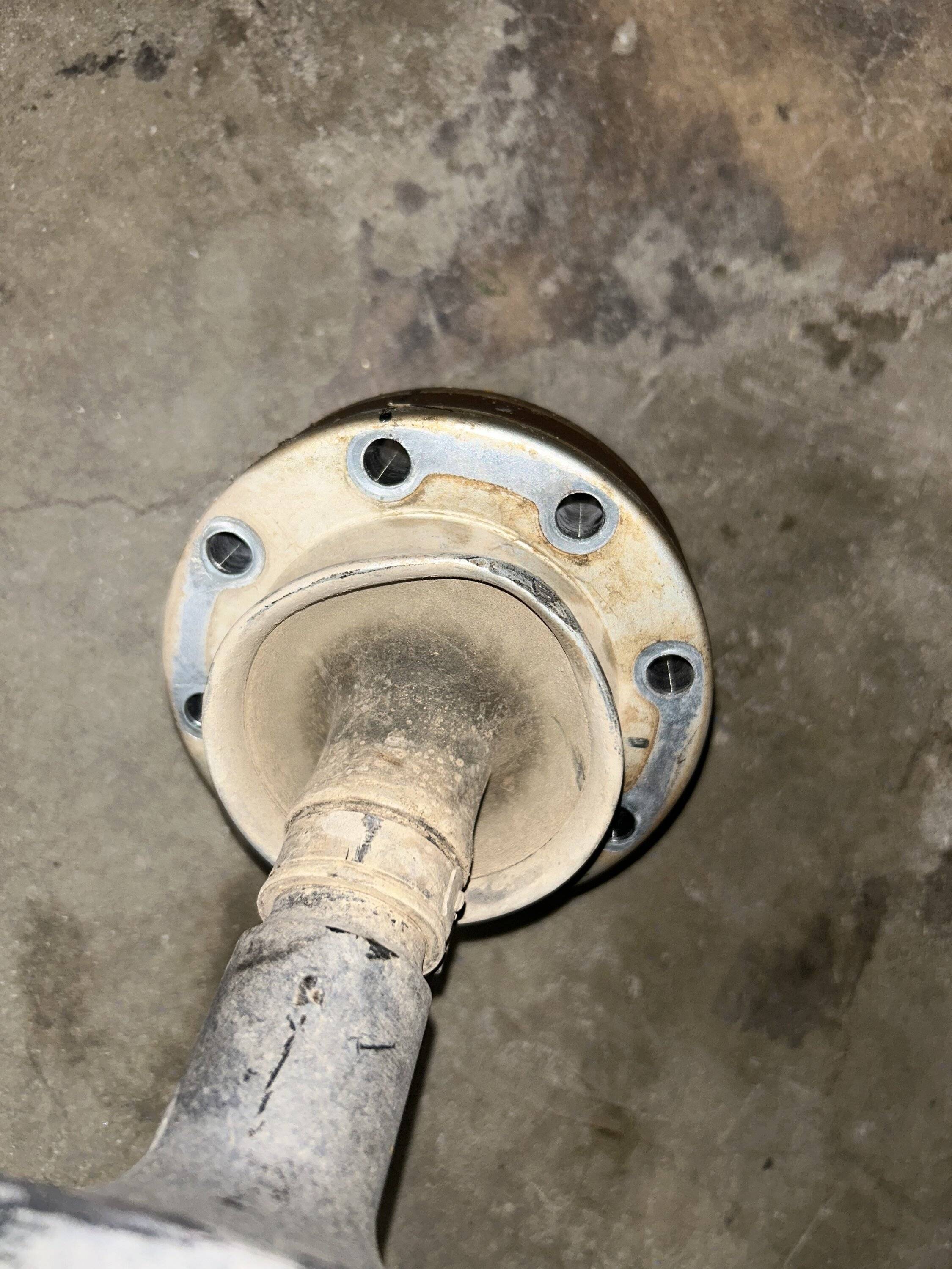

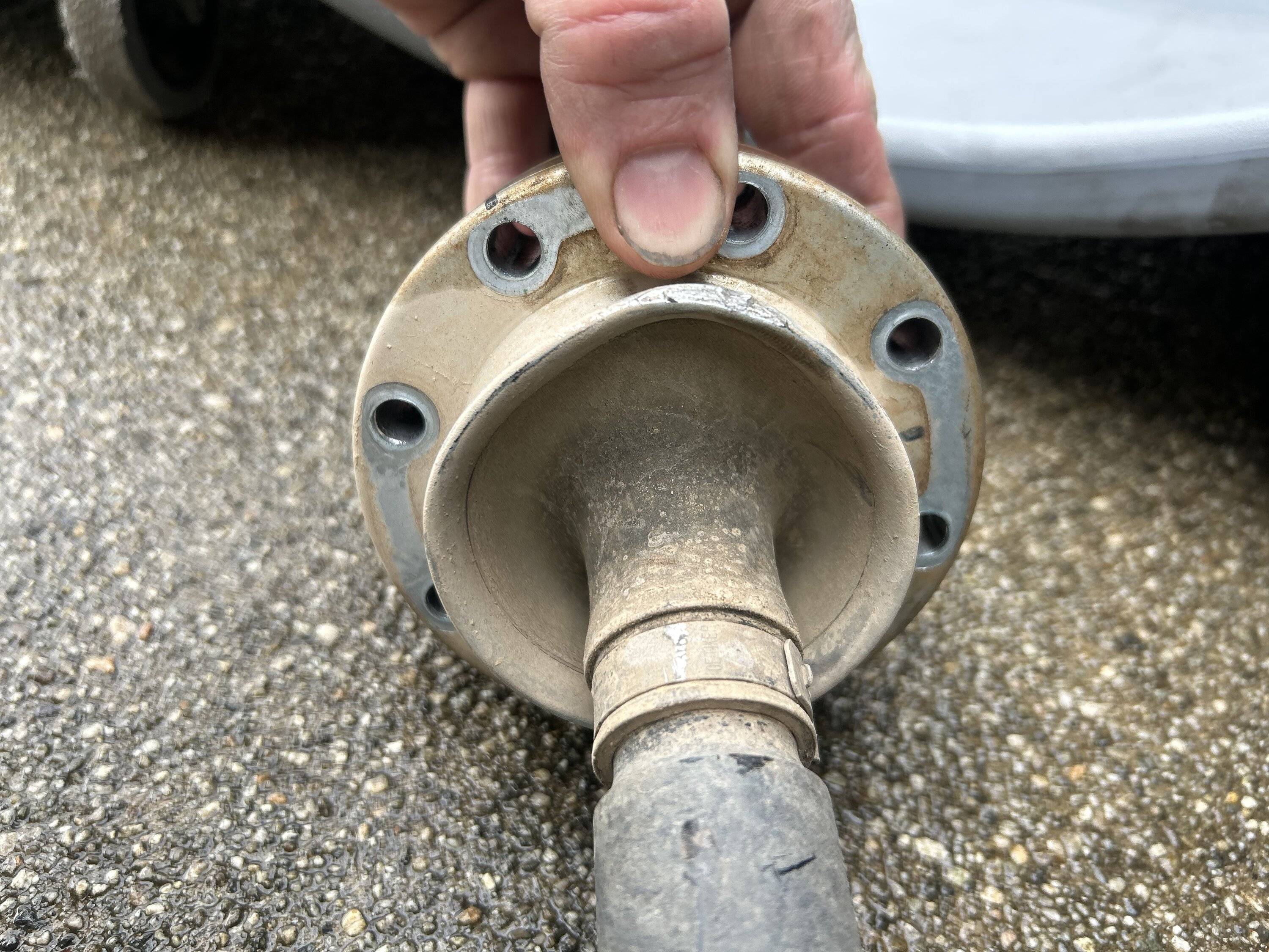

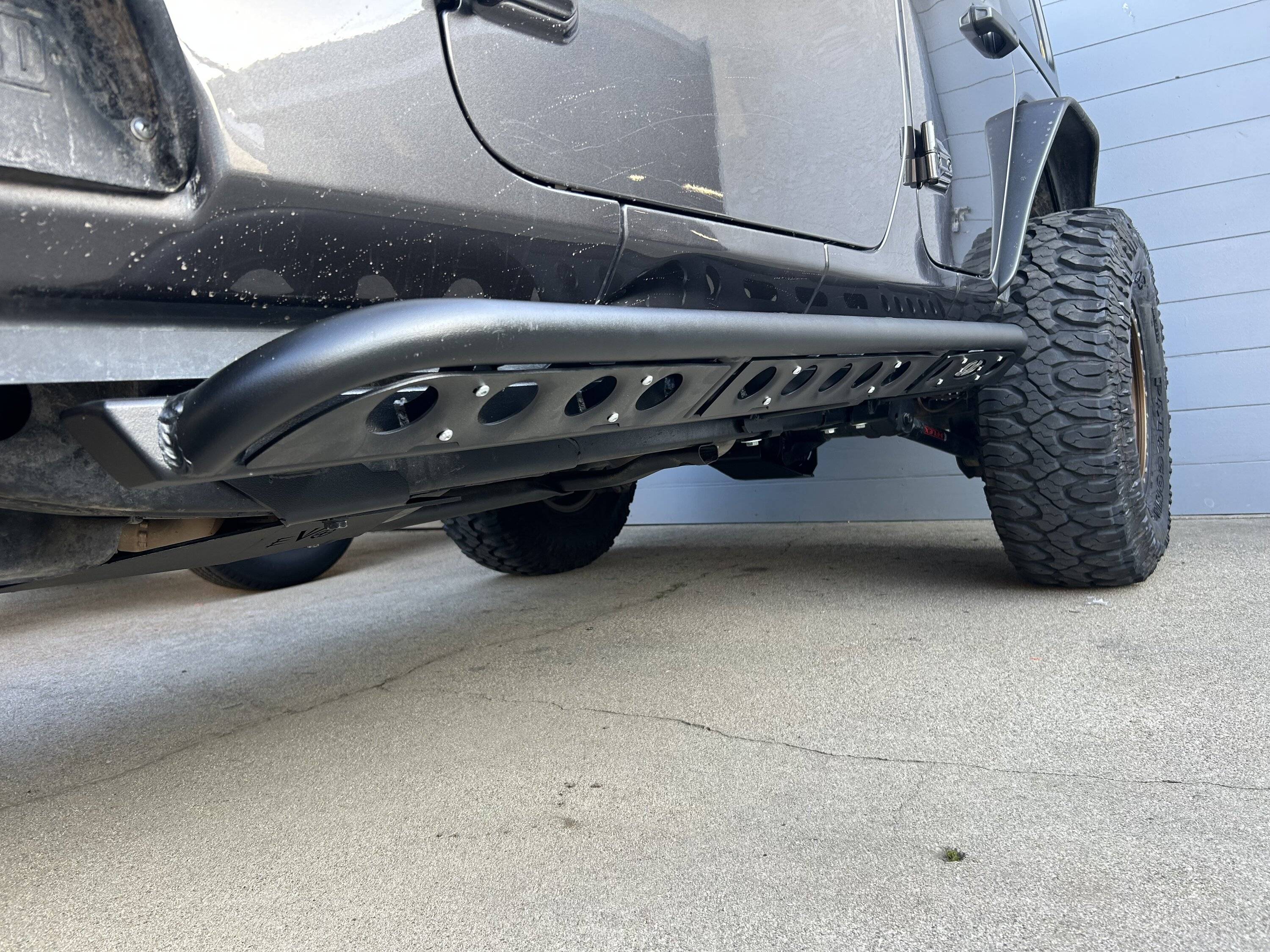

Added pictures of new rock sliders from LOD. New Drive Shaft due to dealer damaging it during recall for the clutch

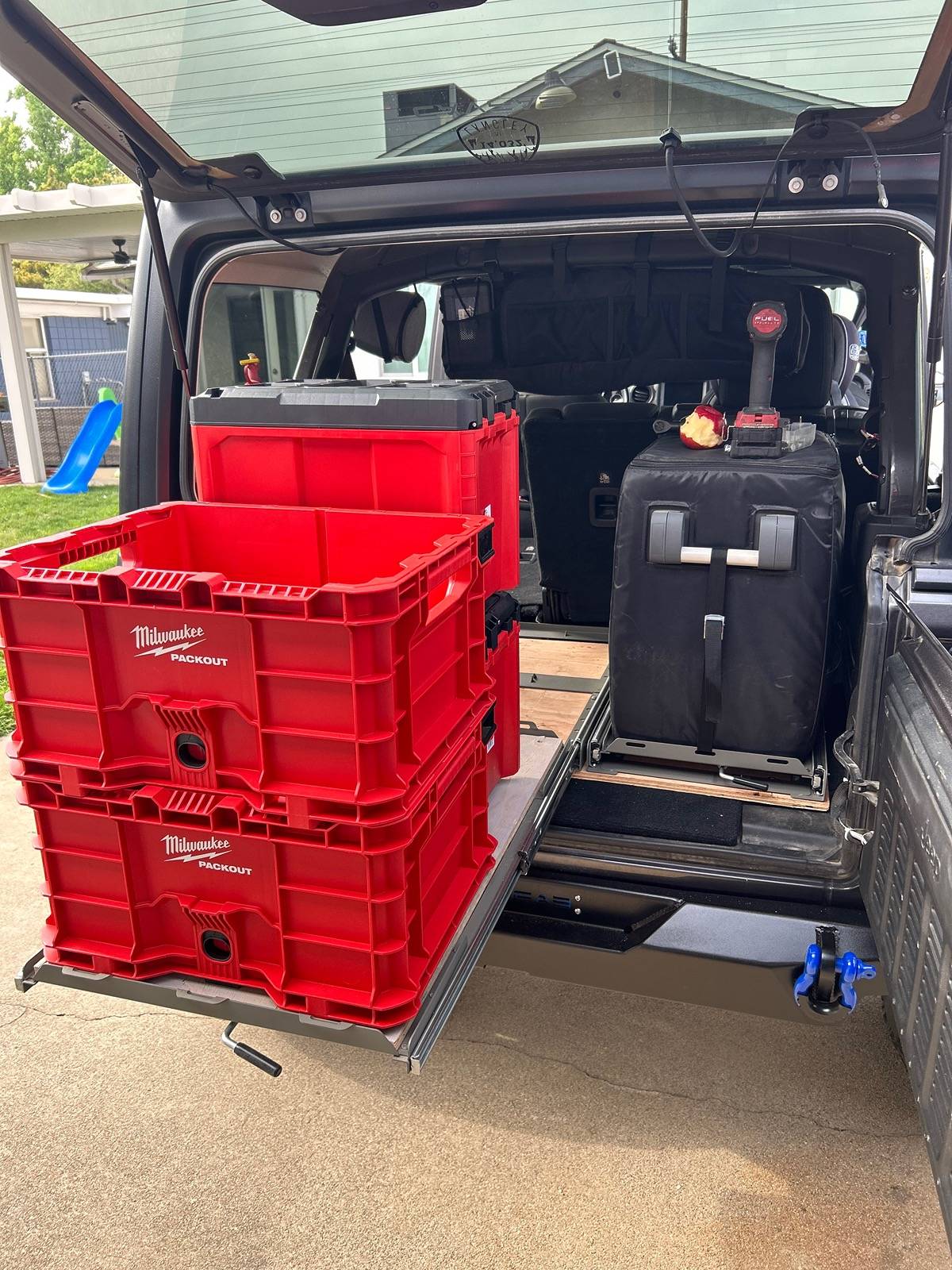

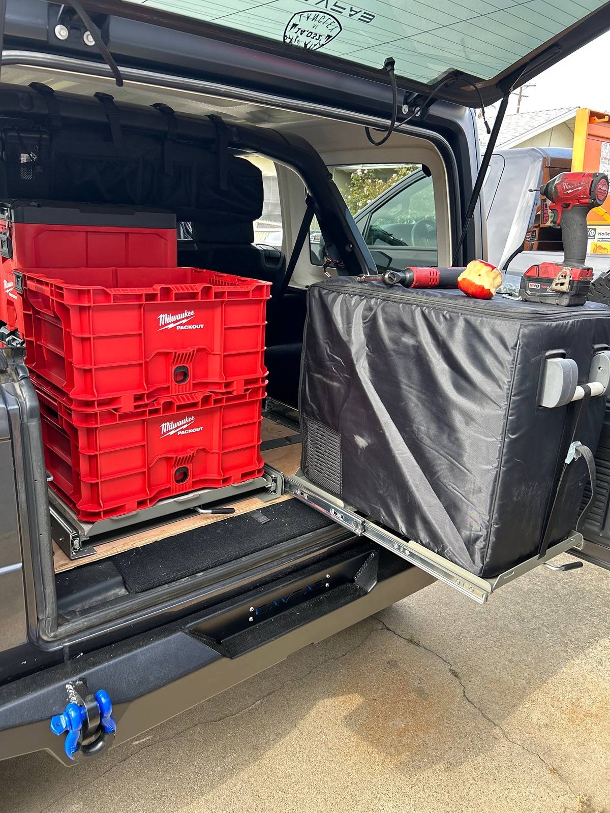

Finally added the iceco fridge slide and added a second one to hold gear and be able to get everything. Caught this idea from @ParadigmDawg

Did you add wooden platforms on the sliders? Are you just using cam straps to hold everything down. My fridge doesn't budge but my Milwaukee moves a little side to side when hitting rough stuff.
