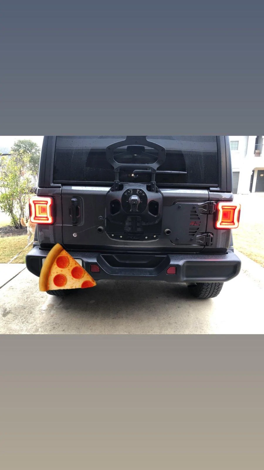

I have these same taillights! Installed them this weekend. though mine don’t do the chase thing (it’s only when it first comes on) the passenger side inner tunnel light is defective ?
Maybe the tail lights are just faulty??
Sucks because these are cool af and everything else works on them
That sucks, sorry you're having trouble with these too. They weren't the cheapest route either, that makes it even more disappointing. Should've just bought some $100 tails off ebay. At least then I would've expected some trouble for the price.
Can you return yours? Or are you "out of the window" too?
I just took the trailer wiring harness completely out of the loop. Connection is now stock taillight wiring harness connected directly to Skyline LED tails. If this doesn't work then I'm guessing the taillights must be faulty. Ill drive it around for a bit like this tomorrow and see what happens.
yea keep me updated!
But yes I’m returning them this week. I’m still in the the window. I was thinking the same thing about these tail lights, for their price I expect everything to work.. super disappointed
