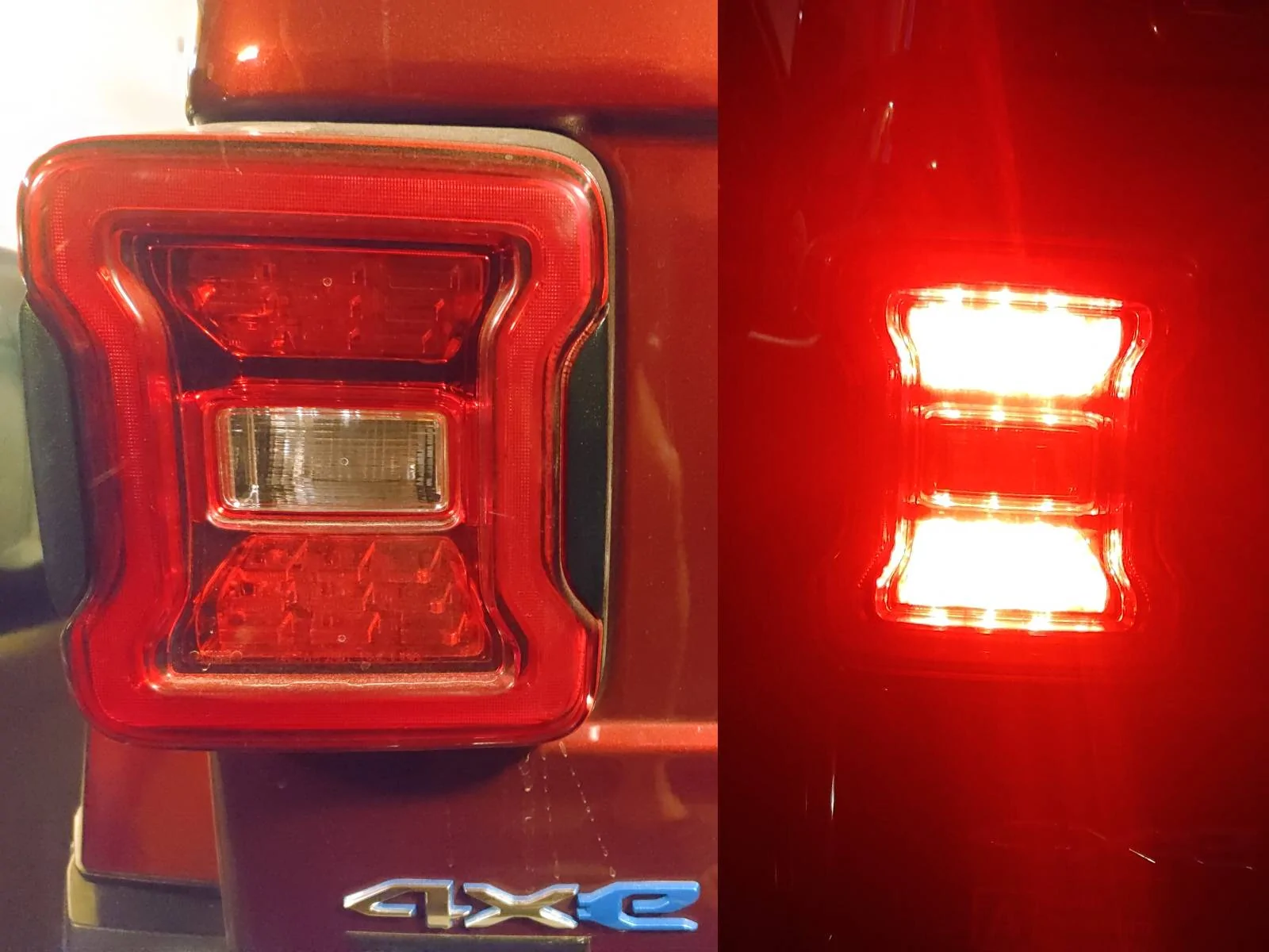

Finally, completed the rear lights conversion.
So, I haven't installed the pins to the BCM myself, asked a company which do audio installations to do that and to traverse wires to the rear lights. The task seems to be doable though, the BCM is on the right side of the passenger footwell, connectors are accessible.
One caveat is that it is unclear which one goes to the left and which to the right. The pins are:
  • C5/E pin 3
  • C6/F pin 42
And mine were routed incorrectly initially, had to rewire.
Pins for that connector were ordered here: aliexpress.com/item/32955538491.html

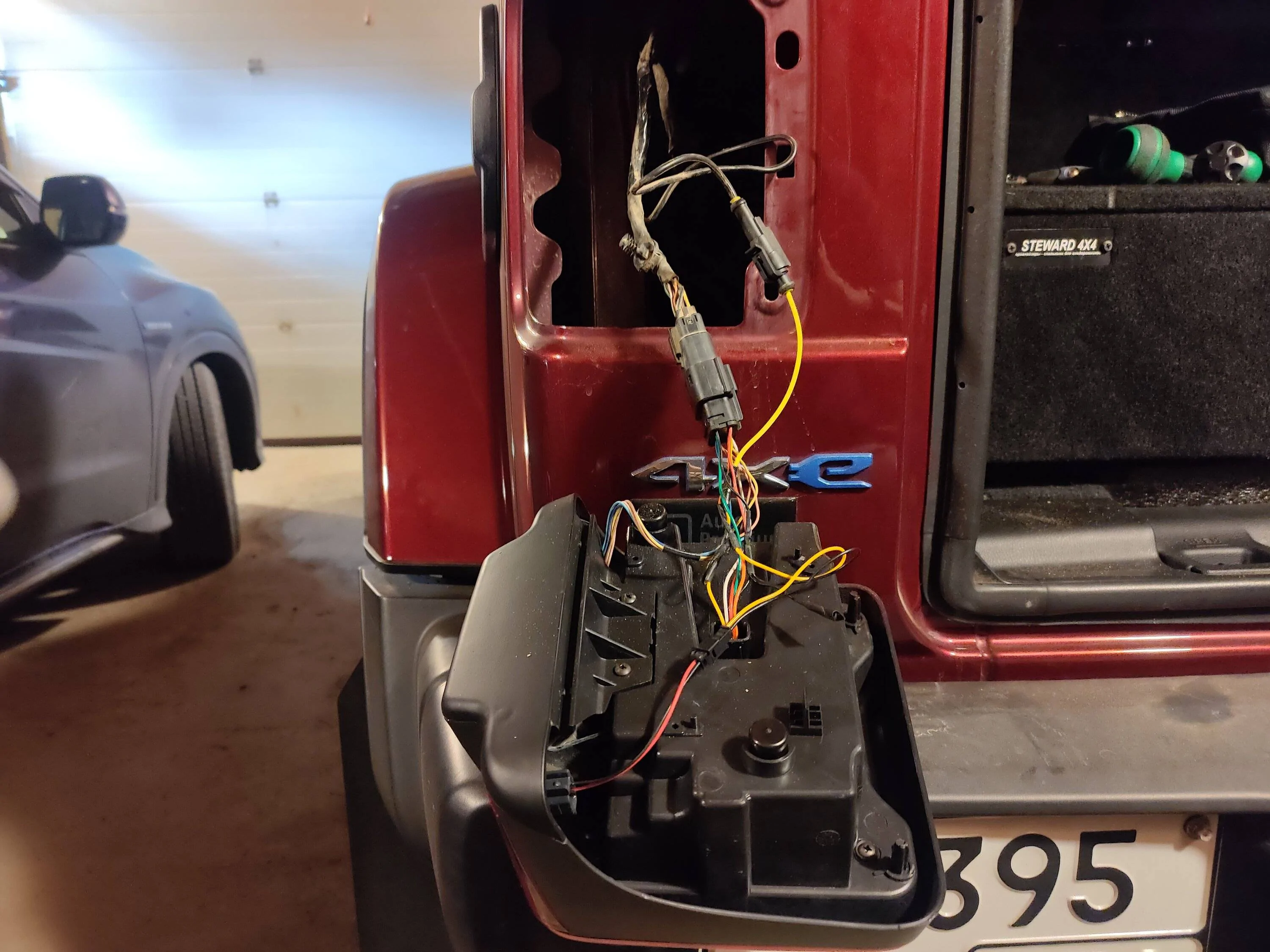

Jeep Wrangler JL Euro LED tail lights? P_20230902_111348

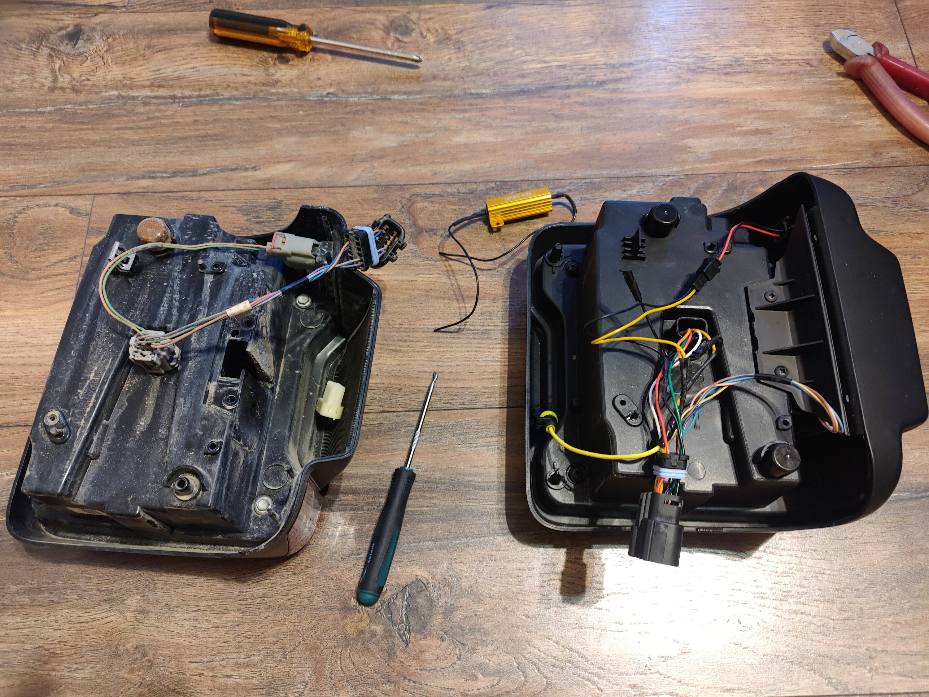

One thing I didn't realize initially is that pins (different type) also needed for the connectors at the rear. Haven't had those, so I just added a separate connector for this additional wire. Connect to the yellow wire on the light side.
Also re-pinned and re-mounted the blind spot sensors to the new light connector/housing (see video instruction in previous post). Pin removal/insertion is easy if you have this awl-like tool.
Jeep Wrangler JL Euro LED tail lights? P_20230903_091803
Jeep Wrangler JL Euro LED tail lights? P_20230903_092134

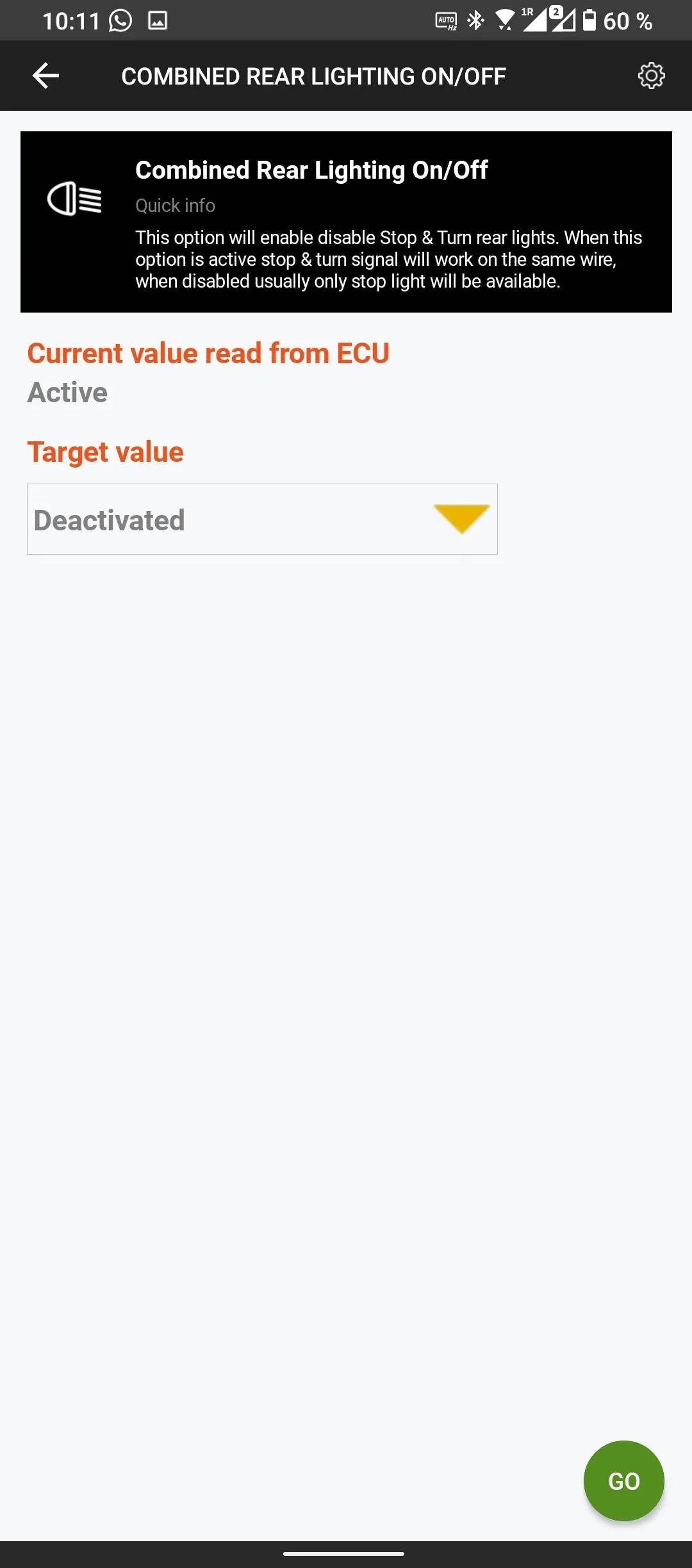

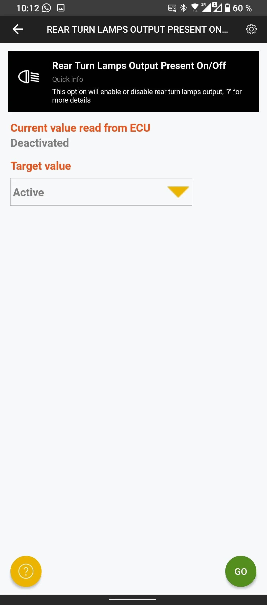

After everything is connected, it is just a matter of running JScan and changing two settings under 'Adaptations' / 'Lights Conversion US<->Euro':
  • Combined Rear Lighting to 'Deactivated'
  • Rear Turn Lamps Output Present to 'Active'
Jeep Wrangler JL Euro LED tail lights? Screenshot_20230903-101120360
Jeep Wrangler JL Euro LED tail lights? Screenshot_20230903-101225847
After that all worked as expected, except that I got 'Rear Turn Lights Out' warnings on the dash. Disabling 'Rear Left/Right Turn Lamp Diagnostic Present' didn't help (so I do not think it is necessary). What helped is erasing DTC codes with JScan.

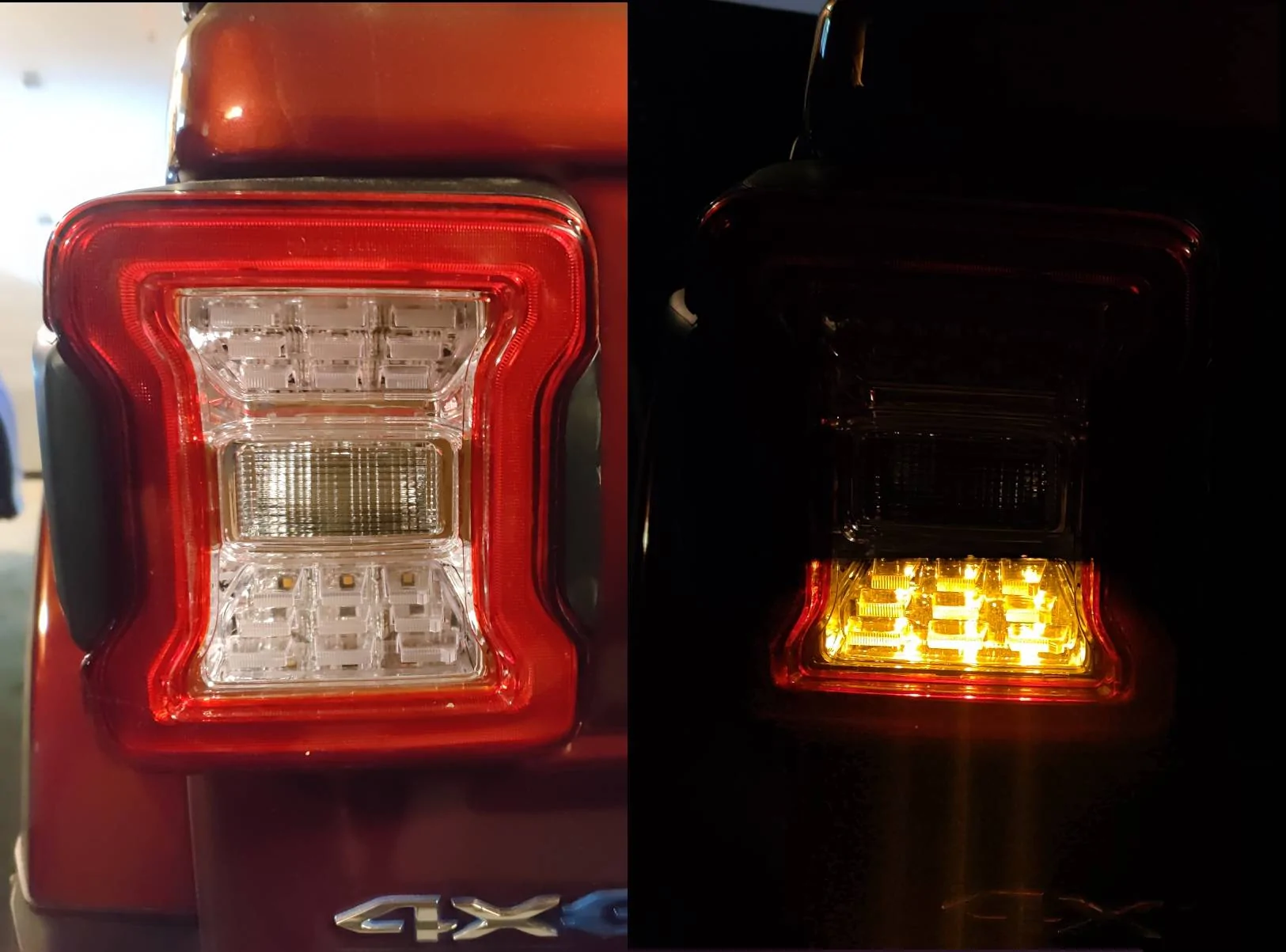

Jeep Wrangler JL Euro LED tail lights? Befor
Jeep Wrangler JL Euro LED tail lights? After

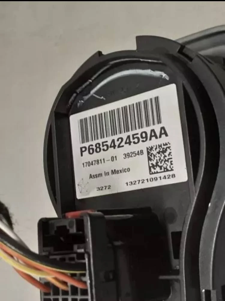

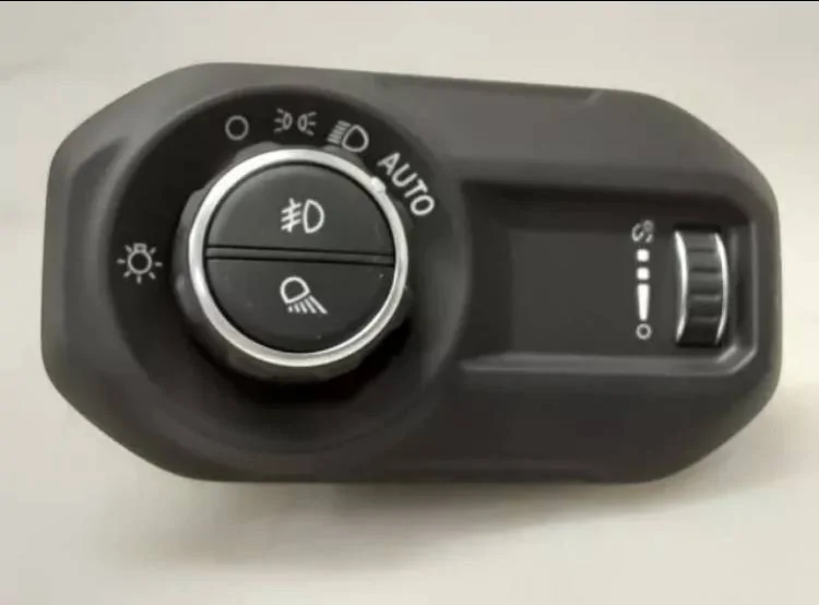

Did you replace your headlight switch with a dual front a rear fog version? Unfortunately I am having difficulty finding the correct part number? This gladiator switch is equivalent to my original, but with the rear fog switch included:
Jeep Wrangler JL Euro LED tail lights? IMG_3995
Jeep Wrangler JL Euro LED tail lights? IMG_3997
I’m assuming this will work but if you can share your part number for the switch you used it would be appreciated.
Many thanks!
