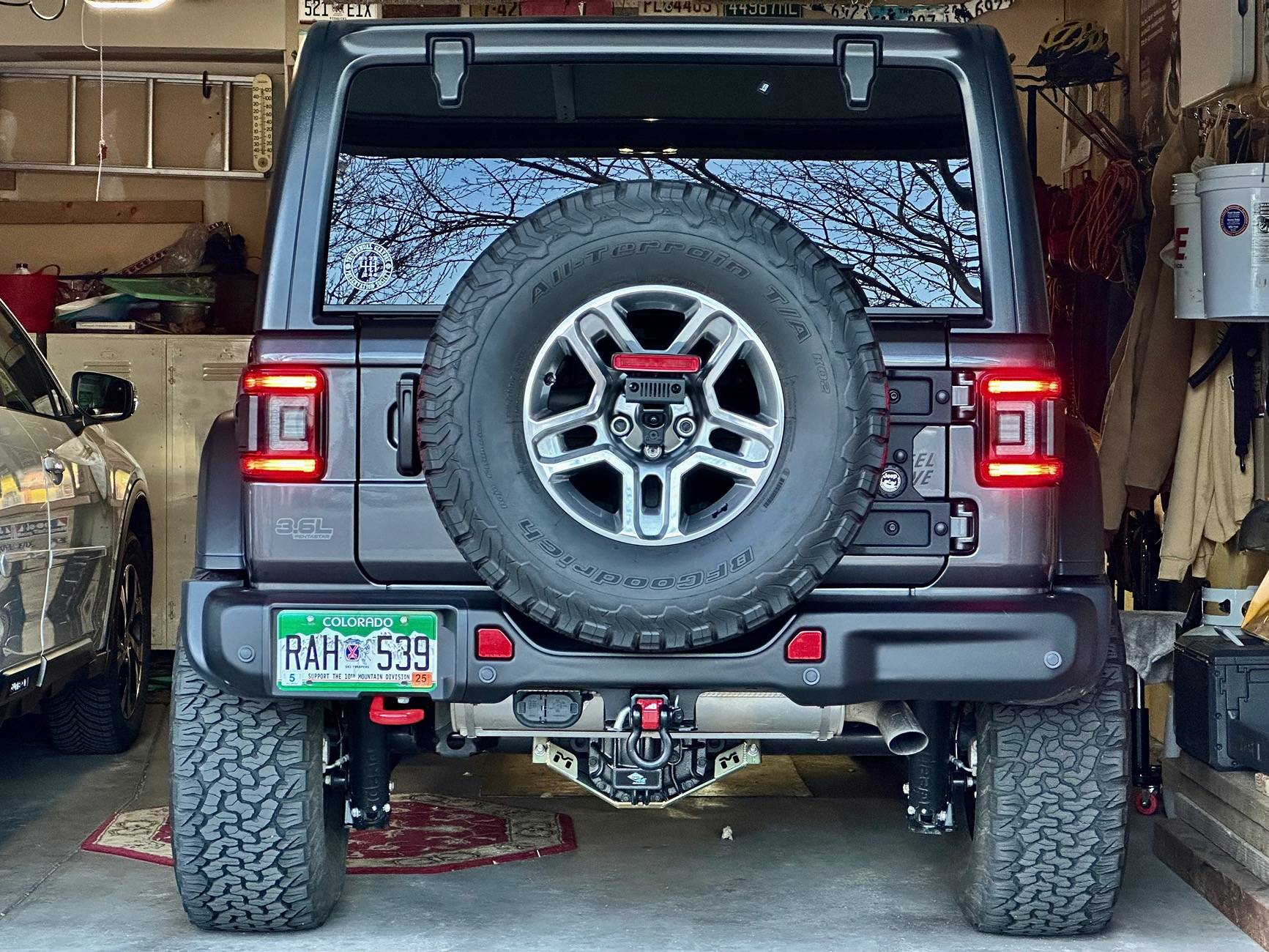

Installed the XB LED Tail Lights today.
TLDR: Extremely easy to install.
But as per usual I can't just leave well enough alone, so here's the over-explained version.

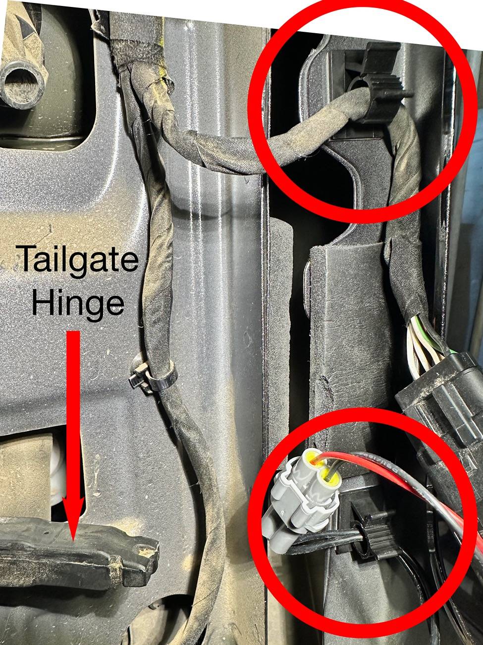

Because I'm going from factory halogen I needed the resistors/ballasts that shipped with the lights. The resistors attach to any metal (not aluminum) surface with a pretty strong magnet, also provided.
Driver side super easy, nothing noteworthy. The ballast was stuck to a flat, horizontal surface and the wires were zip tied together to (hopefully) avoid rattles and noises down the road. Also took the opportunity to pick up a couple new spring-loaded plastic screws. After several times wrenching on the old ones they were starting to round off. (Part number 6512356AA).
Jeep Wrangler JL Morimoto XB LED Tail Lights 1738800450262-r1

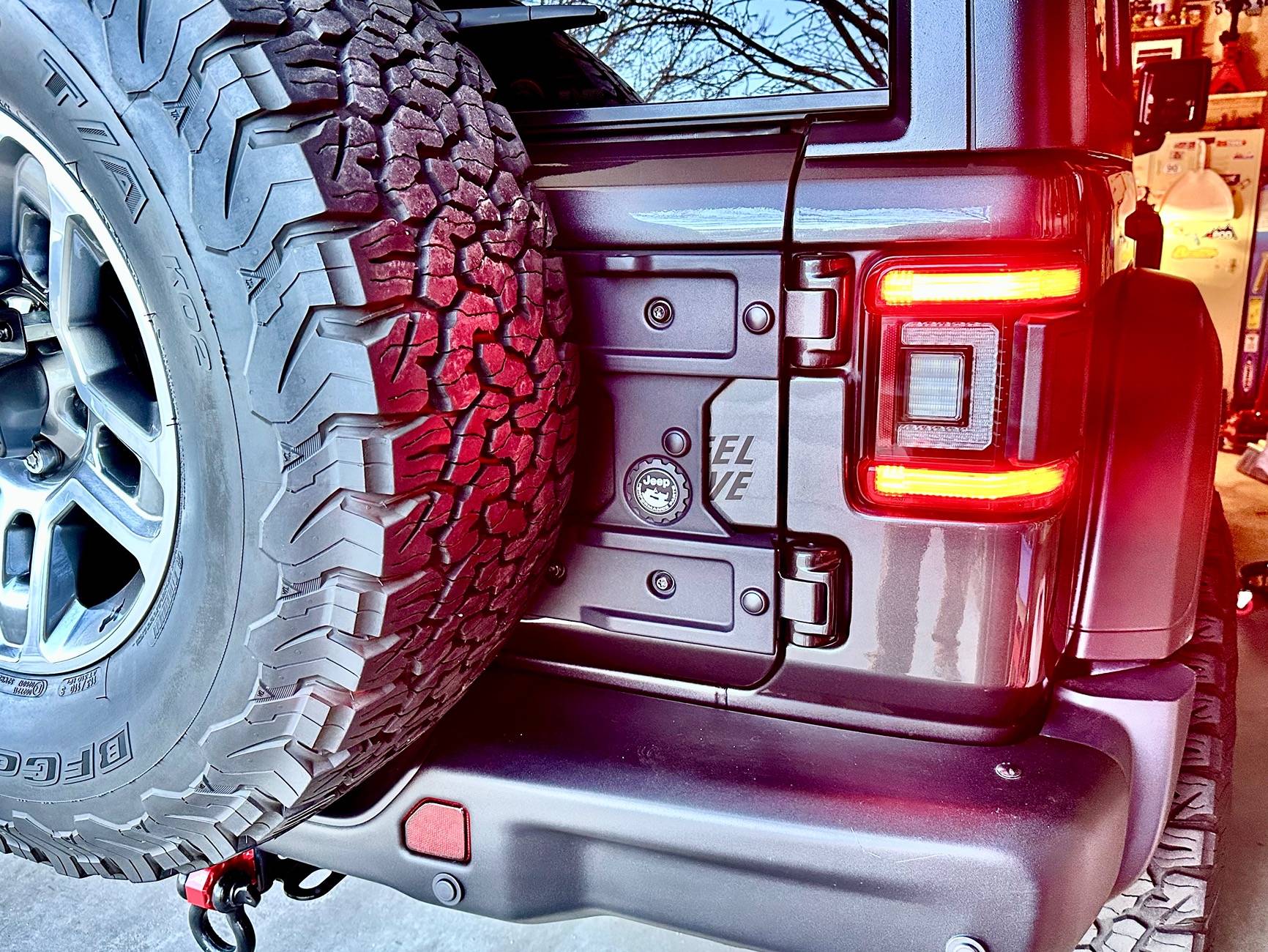

Passenger side was a little different. Because the tailgate hinge passes through the cavity the potential for wires getting caught up in it as it arcs through suggested re-routing the wires to avoid interference. If you're not running the resistors you probably don't need to worry about it.
A few projects ago I ordered these little adhesive-backed hooks off amazon. The hooks were used to route the wires along the outer edges of the cavity. On passenger side I stuck the blast as high against the back (vertical) wall of the vehicle as I could and routed the wire along the edge through the lower hook.
Jeep Wrangler JL Morimoto XB LED Tail Lights Passenger Side Mount
Initially I'd just stuck it to the bottom, but the wire running from the resistor up to the lights was colliding with the arc of the hinge when closing the door. After some trial and error everything was zip-tied together and buttoned up.
Years of dirt caused the old tail lights to slightly mar the clear coat so a little wax smoothed it out before buttoning everything up. Upon testing, everything worked perfectly; no errors on the dash.
Jeep Wrangler JL Morimoto XB LED Tail Lights IMG_5765
Overall I'm pleased. They look nice and are a fraction of the halogen's mass. I haven't used the backup's yet so no telling how bright they really are, but anything will be better than factory halogens. It will be interesting to see how well they hold up over time; water ingress, etc.

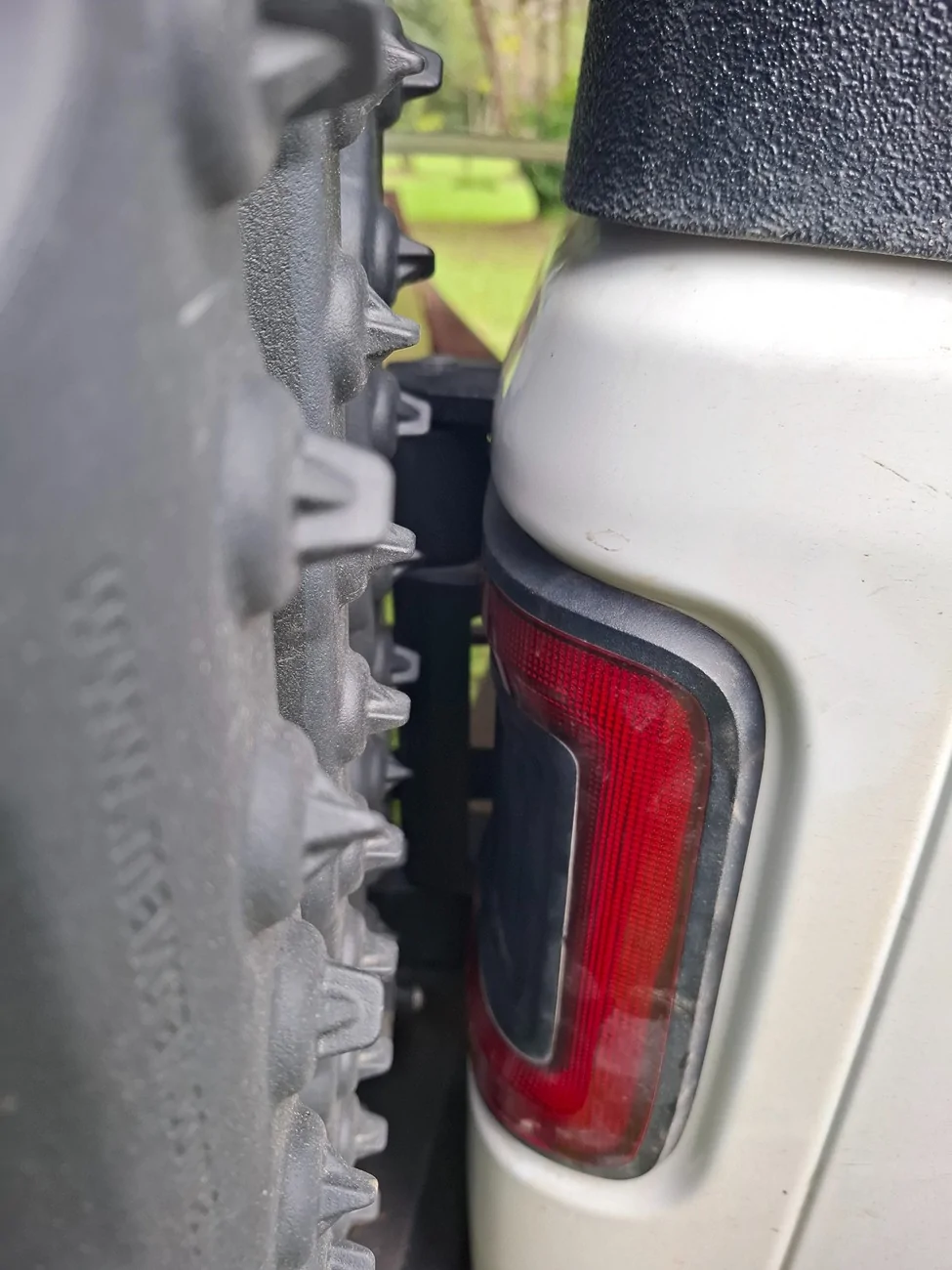

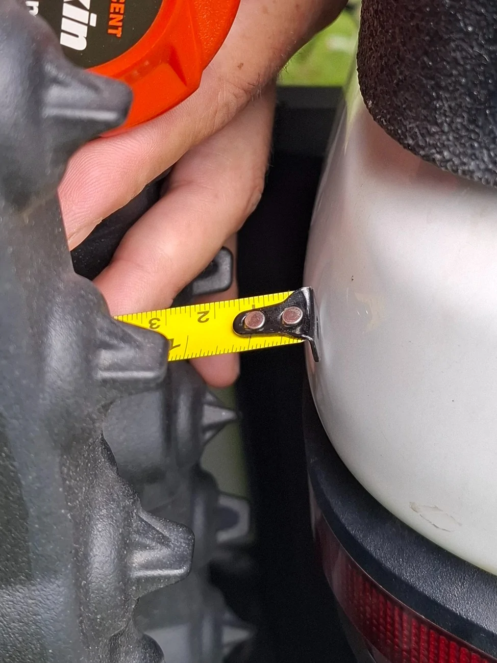

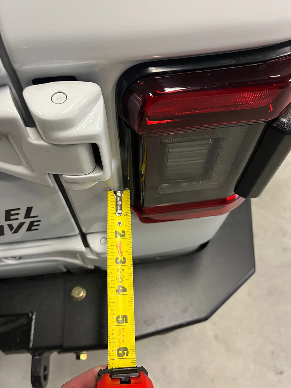

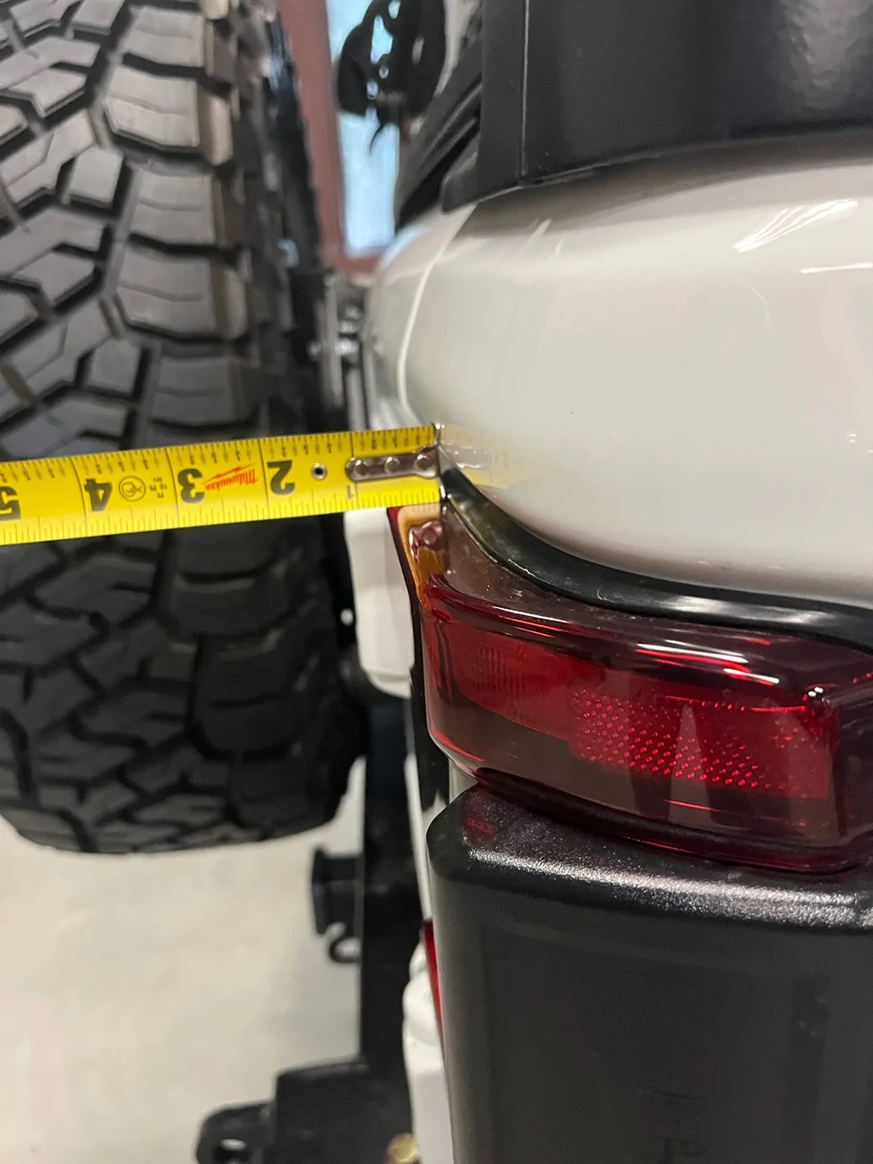

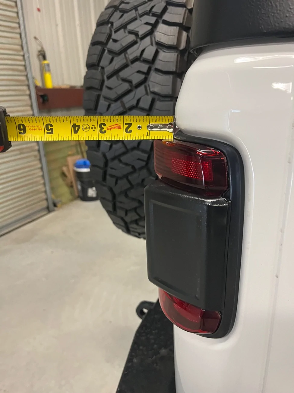

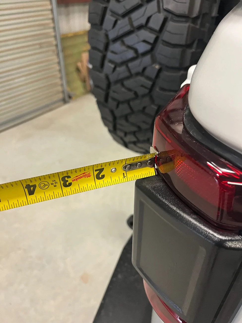

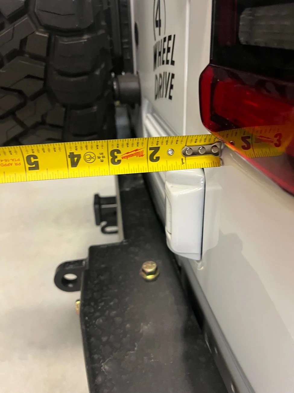

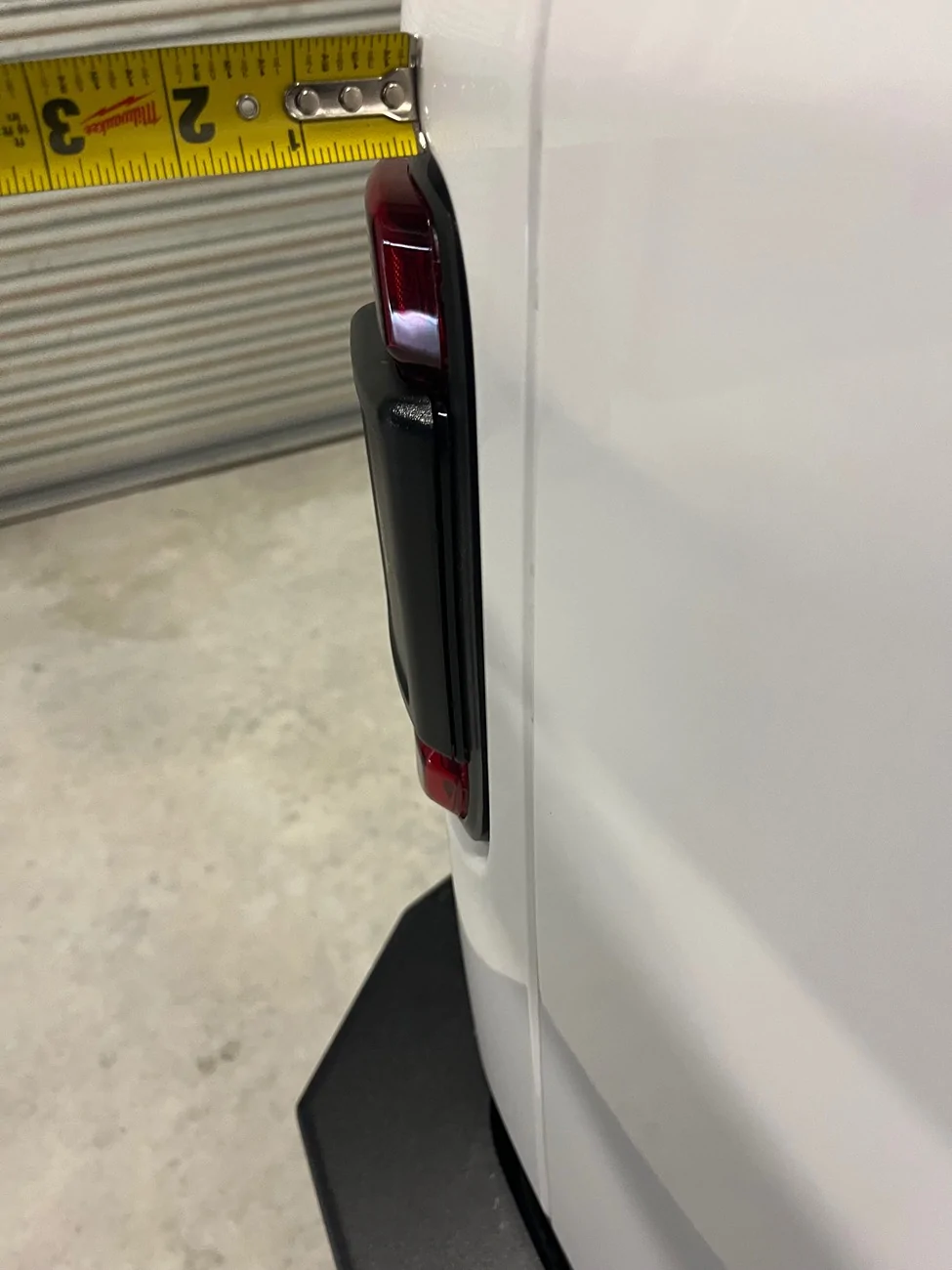

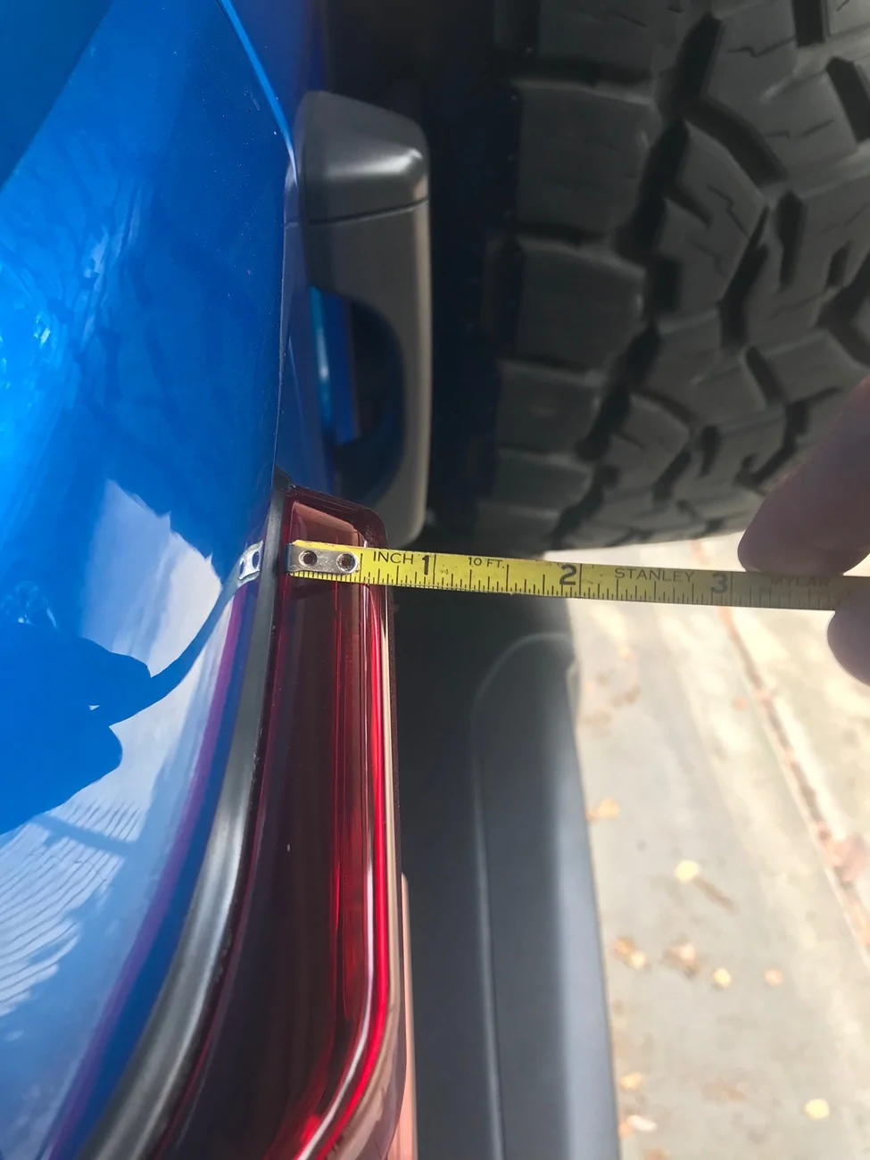

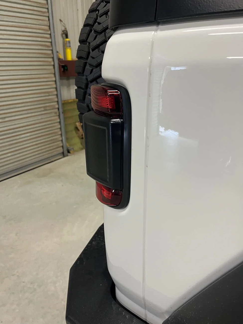

I'm hoping to ask someone who has installed these to take a measurement and possibly a photo. One of my Oracle tail lights has failed. I designed my maxtrax carrier to clear the lights when the tailgate is open and only have about 5/8" at the corner. From what I can tell, these Morimotos look like they will fit, but a can't find a profile photo to make sure. Appreciate the help!

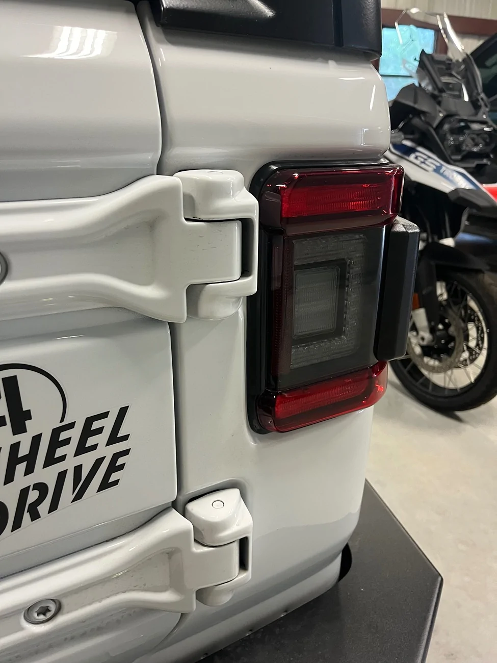

Jeep Wrangler JL Morimoto XB LED Tail Lights FFB896DD-1492-49FD-AA80-BE8B88C62DB7
they stink out less than the gate handle 👍
