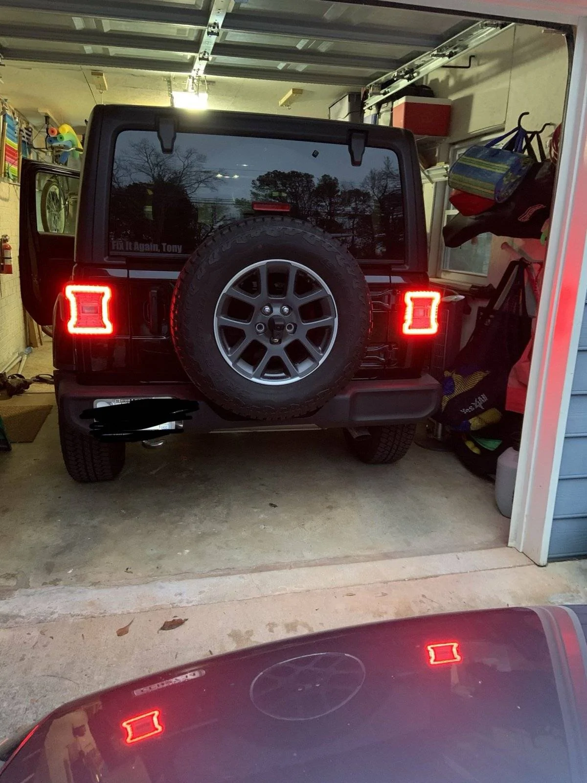

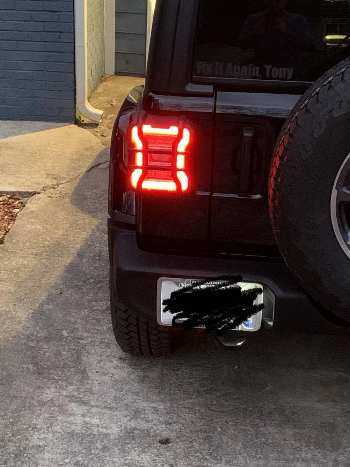

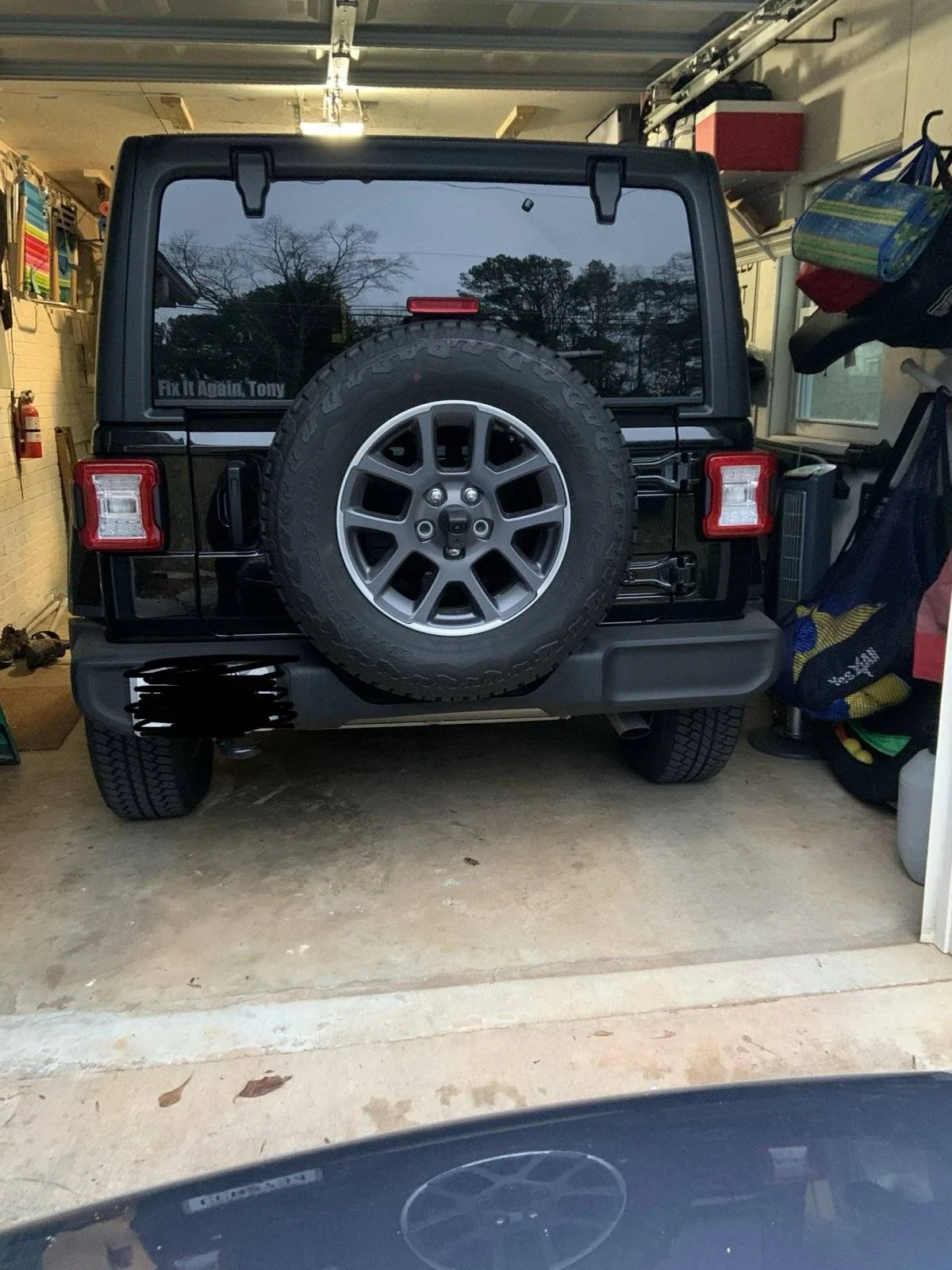

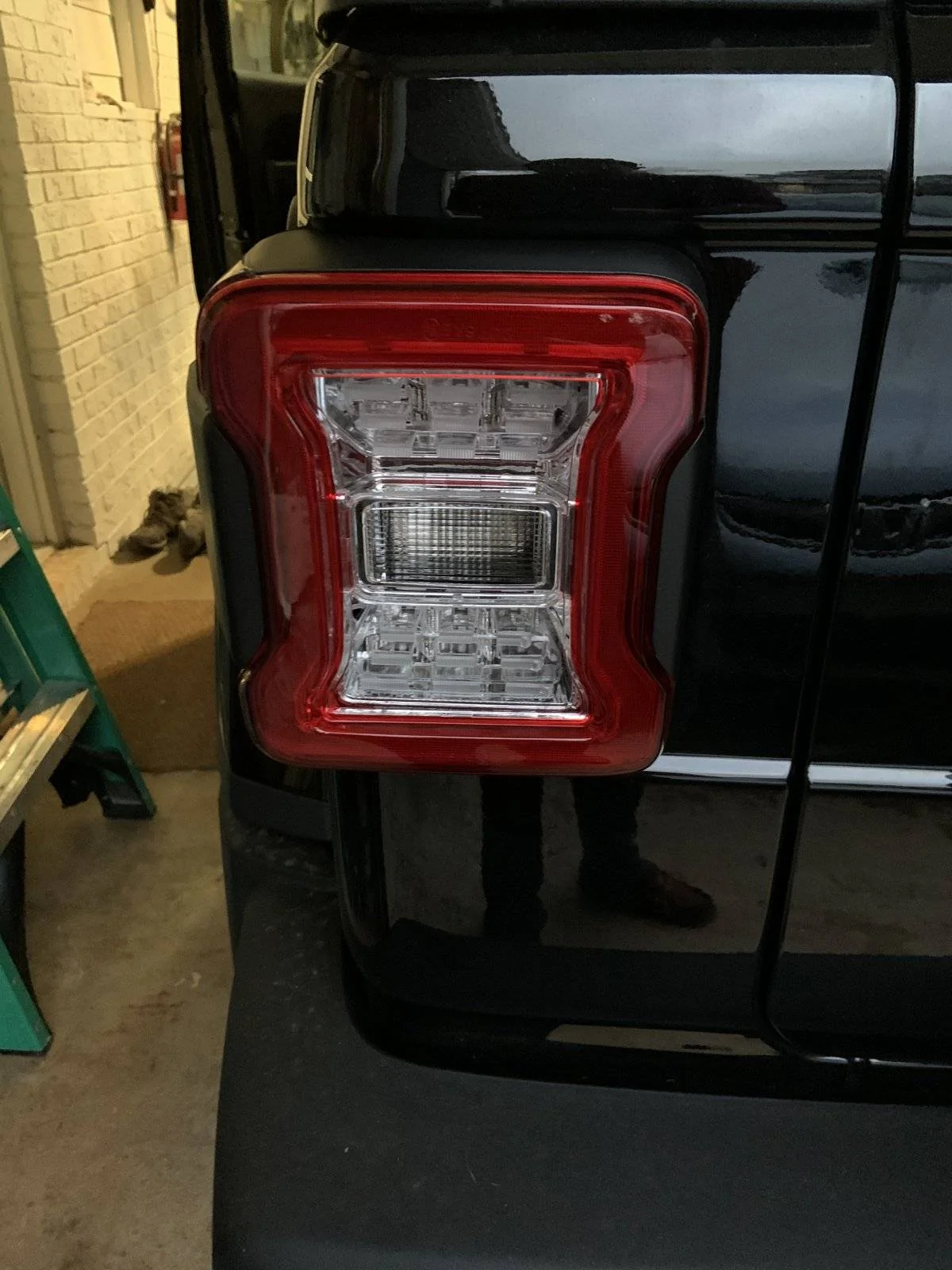

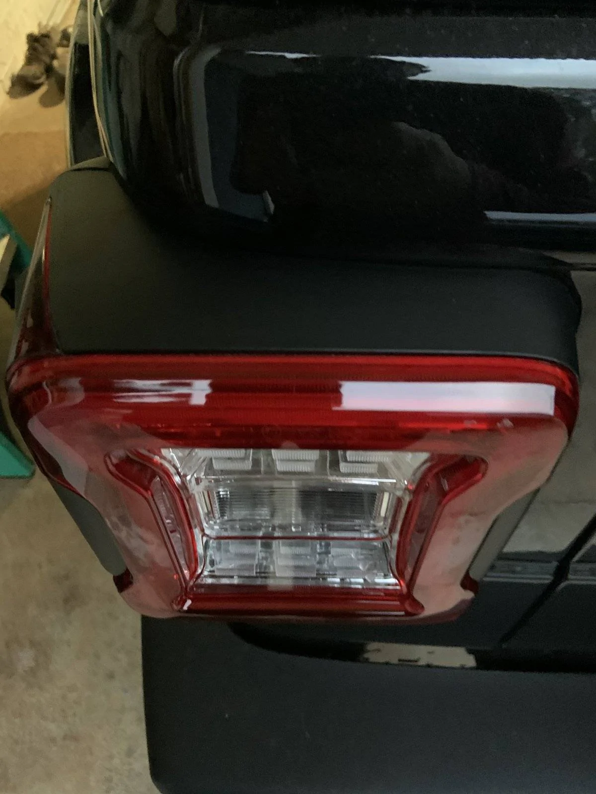

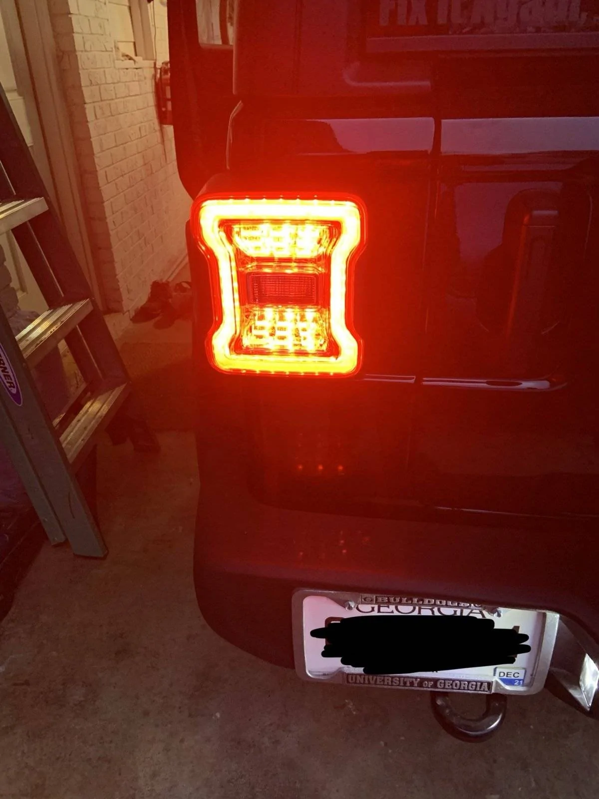

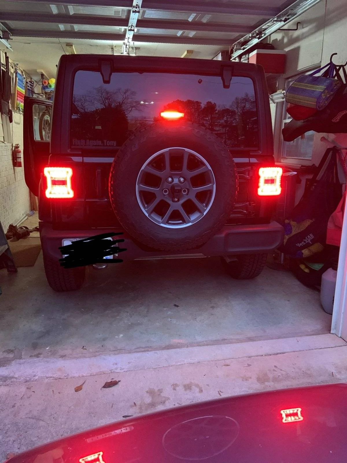

what do the turn signals look like ? These look very close to factory styling ??Got the Raxiom LED's installed. They are fantastic. Fit and finish perfect, and the housings are identical to the OEM Halogen housing. They work perfectly and installation was exactly per the video. I did cut one lug off of each resistor so they would fit flush in the mounting location. It goes without saying to use alcohol to clean the area before using the tape. It seems to be the good 3M stuff. You do not have to transfer the screw mount from the OEM housing. These are complete.
