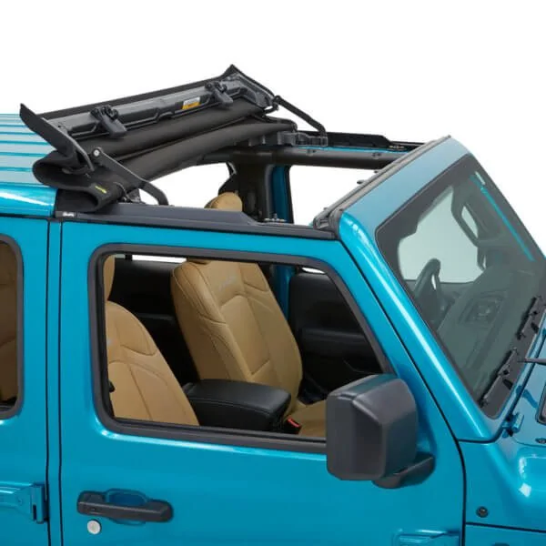

The Sunrider for Hardtop is an outstanding alternative to Sky One Touch. Yes, I realize it doesn’t open as far, but you can open and close it in about 7 seconds each direction. Gives a nice open-air feel.
And when you want the total hardtop experience, you just pop it out and reinsert the Freedom Panels. It’s the best of all worlds and will work with most any roof rack that works with Freedom Panels (which is many of them).

John, @John VonJeep the Sunrider by Bestop is an awesome product and suggestion on your part, I think.
That said, I'm not sure that all racks, even ones when Freedom top openings exist, allow it to fully open. For example, Bestop's rack (no surprise) does:
https://www.bestop.com/products/gra...eep-2018-2023-wrangler-jl-4-door/?sku=4147101

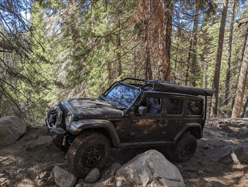

Something like this from Adventure Rack Systems? Note that their tubes are 2" and are significantly beefier than the 1.5" stuff that Gobi uses.
Jeep Wrangler JL Sky one touch with rack 1706753276049
That was on the Rubicon Trail.

..and to further Tom's point, it's not just weight of the objects you wish to place on top but, their shape.
To point, stick a surfboard on a rack, say, which nobody denies is on the lighter side of things in weight you could stick on top, secure it down well, and take the vehicle at significant speeds and expect the board's tendency to want to lift in the wind to apply torsional forces to rain gutter based rack systems.
I'm not suggesting that a rain gutter based rack like Bestop's with its significant number of attachment points can't handle that, but a two cross rail system might be put under strain.
Contrast that with an Adventure Rack System, as highlighted prior, and if you had the super human strength, you could practically lift your Wrangler up over your head, upsidedown, by grabbing on to that rack it's so sturdy.

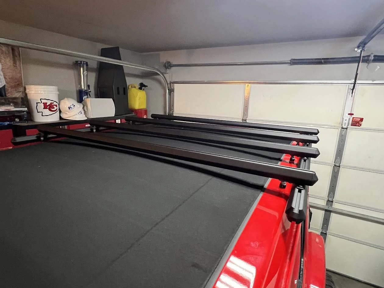

In order to put an awning and hub tent on my roof, I got the below, which works very well. I take it all when out of camping season and hang it in my garage.
Thule Wingbar Evo 150 (60”), Black https://a.co/d/3b1KkS9
Thule Rapid Gutter Foot Pack https://a.co/d/8w9xqvx
The aero bars make a little more noise, but not bad. Sky top never seemed affected by the bars.
