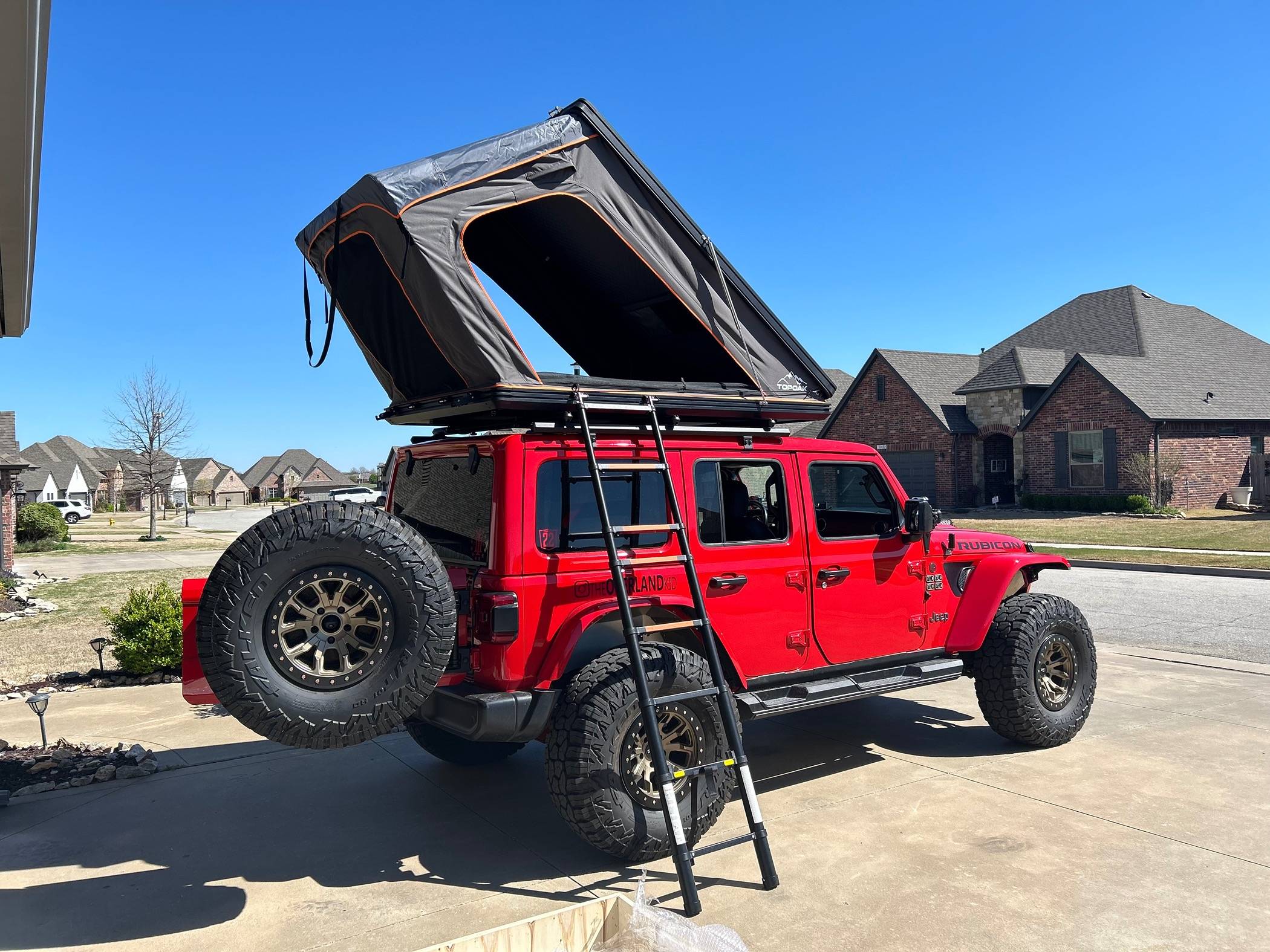

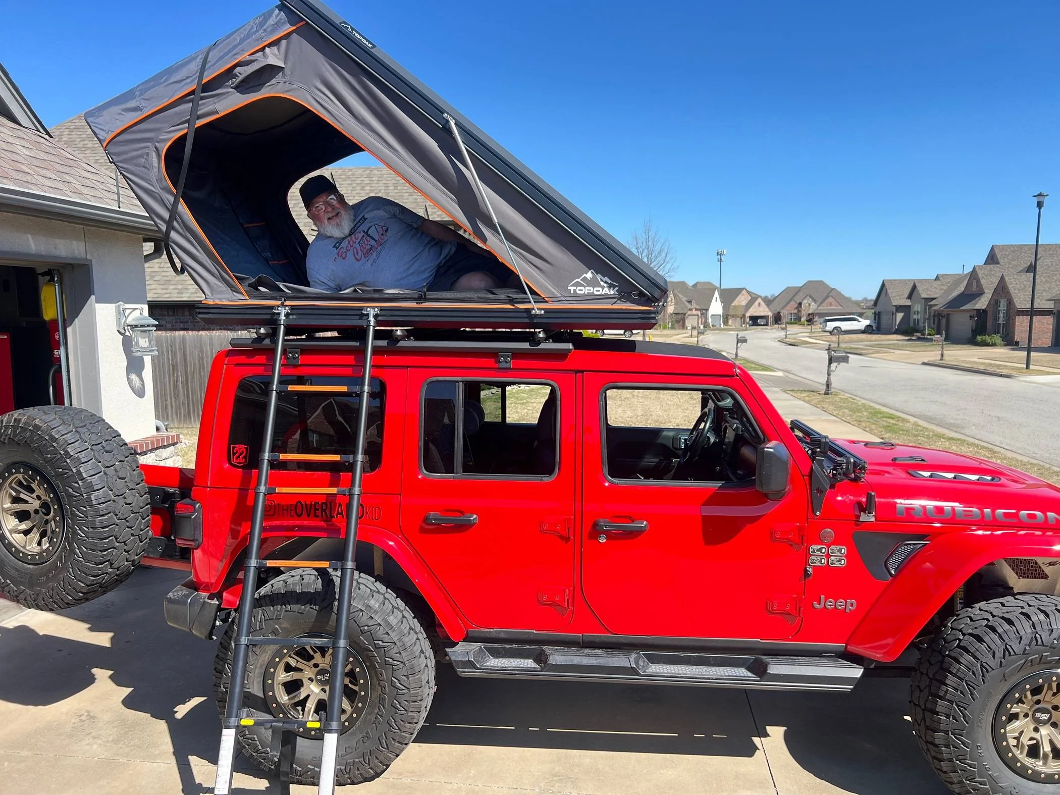

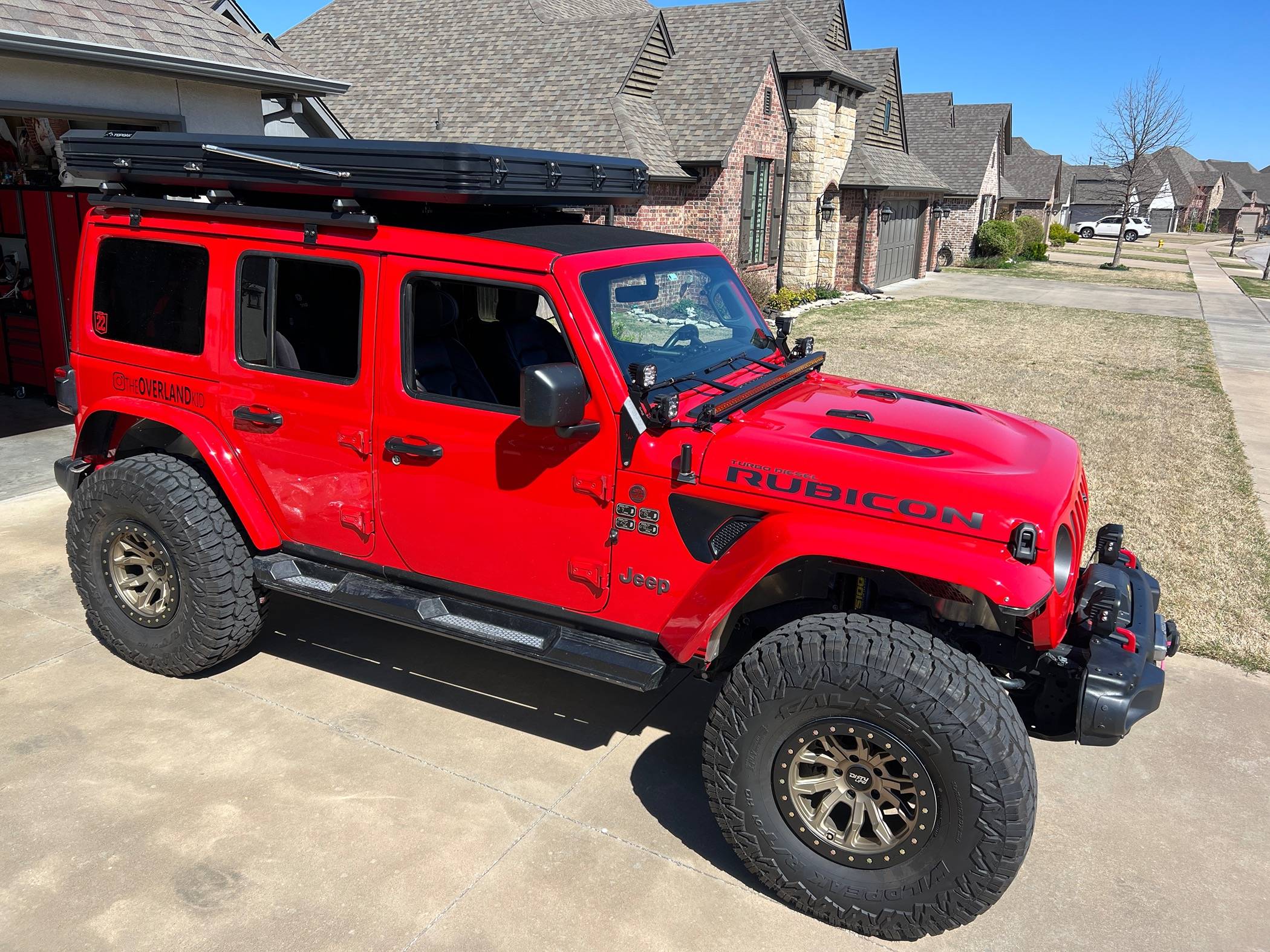

WELL WE DID IT!!! Proved it to be true, We have added an RTT with the DEEZEE roof rack and its SOLID on the sky one touch.
NO YOU CANT OPEN THE TOP ( NO I DONT CARE, I PULLED THE FUSE )
When the time comes to remove the RTT i'll reclaim my roof and that is super good with me. I tested as close to max static weight as i could. I put my butt up there 275, then had my dad get up there 330. so we had 575LB's of static weight not including the 165 for the RTT so 670lbs!!! not even indentations in the feet of the rack and the gutter mounts holding perfectly.
I did some hard core overlanding and slept in it last night in the driveway. its super solid, no creeks and cracks, no fear or feelings of instability. Time will tell but im not disappointed.
Here's some of the photos we shot. I'll be doing a big review video since I purchased two of these, two deezee roof racks and one is on a hard top the other on this SOT.
This is my Pops chilling on top of the SOT roof with my new TOPOAK TENT! Hes 6'2" 330lbs (REVIEW INBOUND FOR THIS TENT )

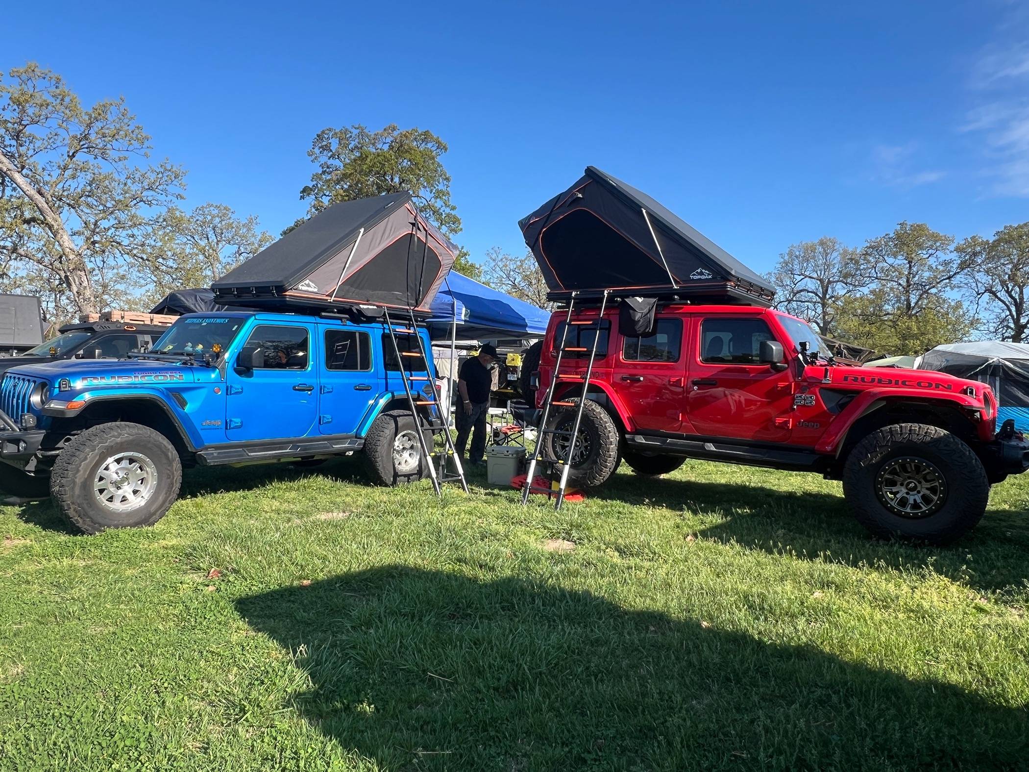

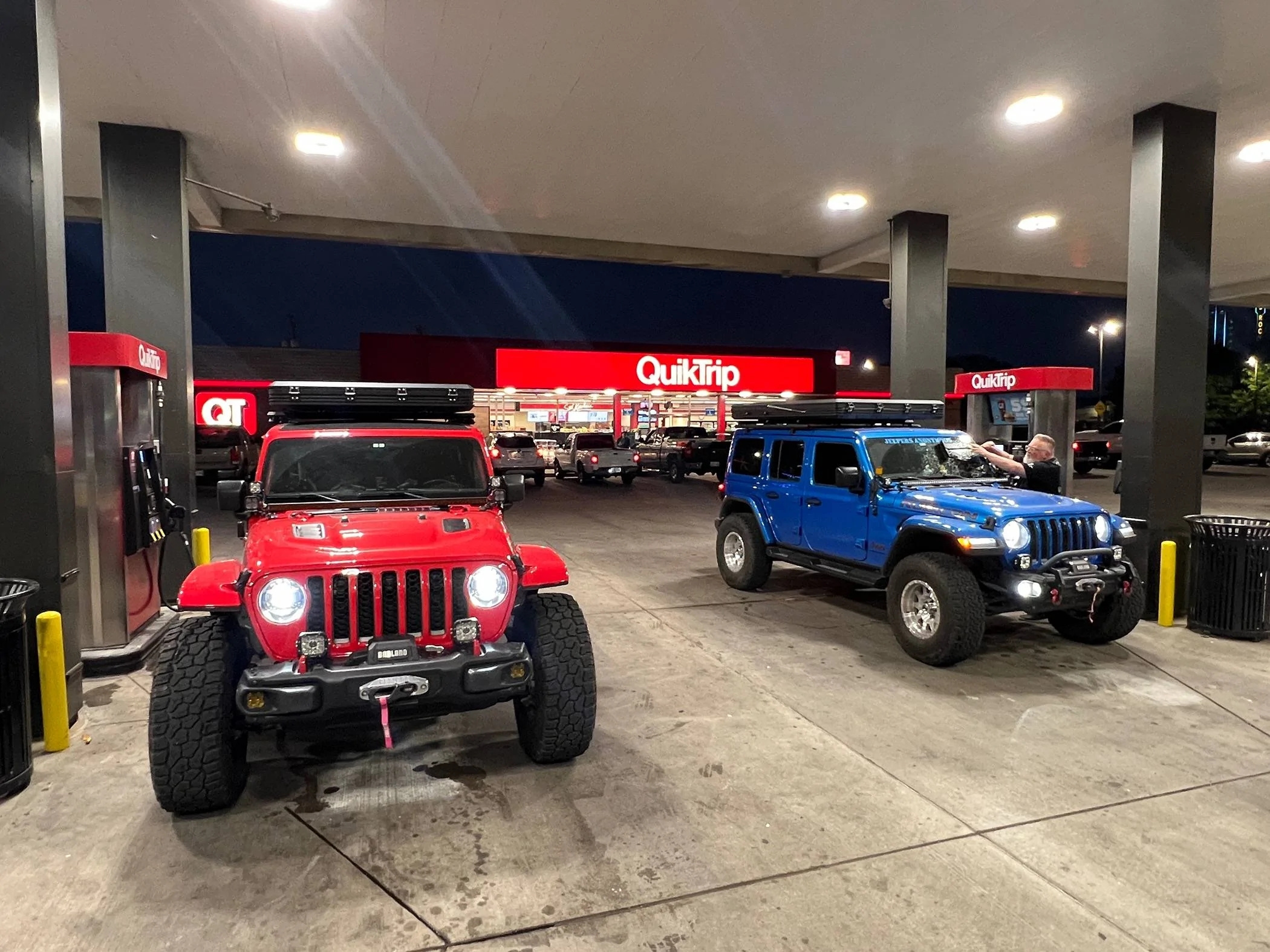

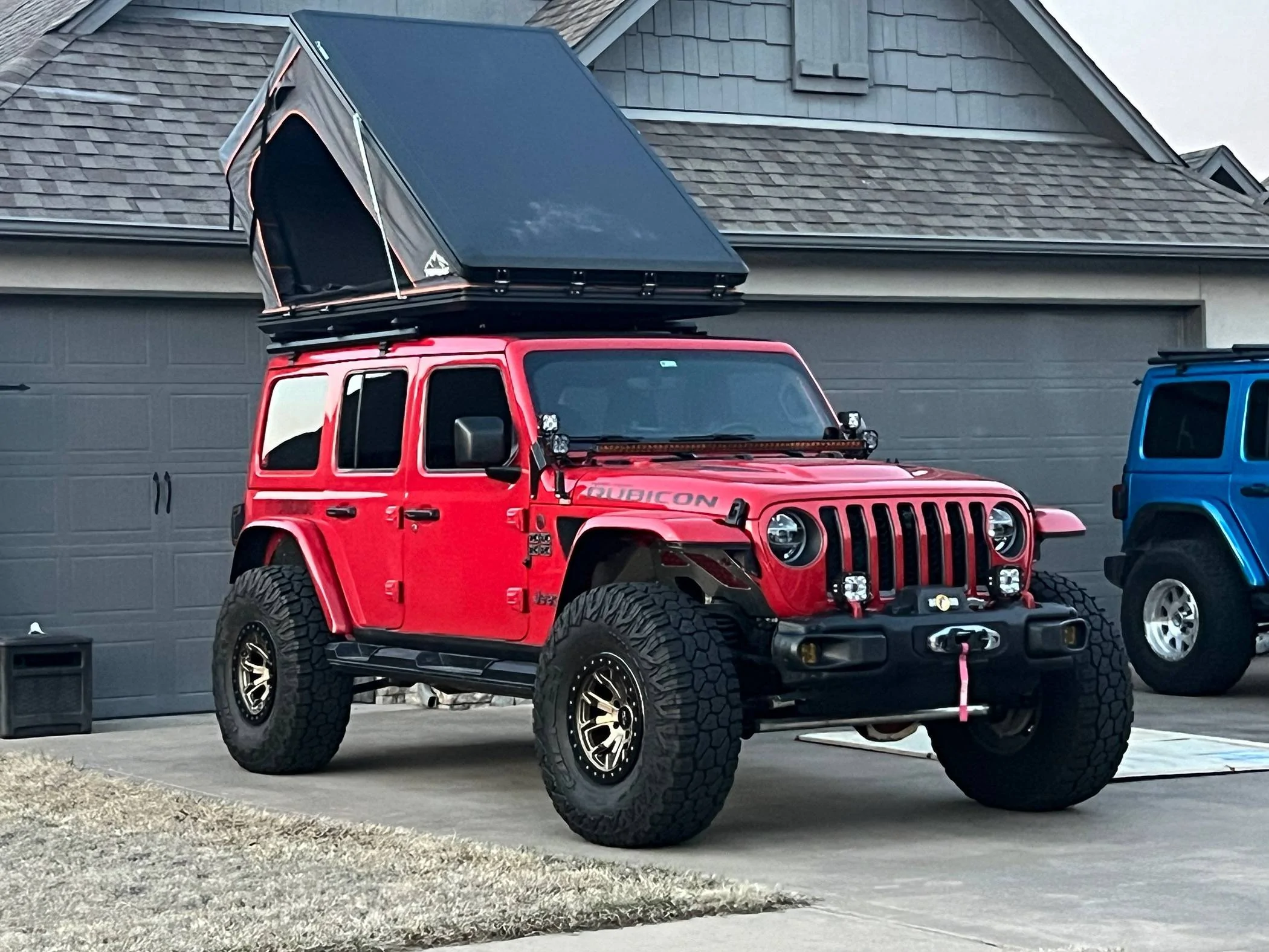

500mi roadtrip. Both running Deezee racks. One on SOT one on hardtop both performed extremely well. For the person that wants to take their tent off and on frequently this isn’t a bad option. I don’t know that I would go full rock smashing with it but your average overlanding it’s perfect. 9 nights so far in this and it’s solid.
i will be going to an adventure rack for the Jeep in the next few weeks. I want to be able to still do the harder obstacles without worrying about the rack
this will work for 80% of folks though!
