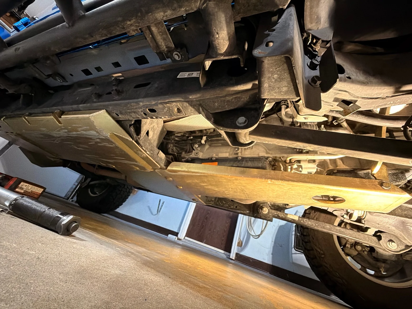

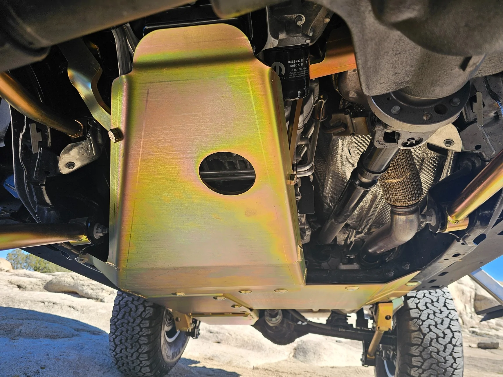

I'm a fan of Metalcloak skids. I installed them on my 392 three years ago and they have taken a real beating with nothing but scrapes in the finish. The gold zinc coating inhibits rust, and even after scratching them on rocks they don't rust. This year I installed another set of Metalcloak skids on a new 2-door Rubicon. They fit like a glove and I'm sure they will be bulletproof. I noticed an actual improvement in handling and suspension from the skids. I think that extra weight hanging on the bottom of the frame made it feel more stable in turns. I have the same Metalcloak Black shocks that several people have commented about their Metalcloak Black shocks being too stiff. That is because they are set up for a Jeep with lots of steel, including bumpers, rocksliders, skids, and other armor. My 2-door had also felt a little stiff, but after adding the Metalcloak skids it has started feeling just right. So chalk me up as one of the people that say steel skid plates improved the way their Jeep drives.
It is interesting though, that at the same time I was getting ready to install the Metalcloak skids on my 2-door we had purchased a Jeep Compass with the Trail Hawk package. That package includes "off road skid plates". I had just been underneath my 2-door Rubicon, and stock skids were almost non-existent. Just a couple of bars and a small square skid under the transfer case, and that's it. I looked under the Compass to see what they called "off road skids" and was surprised. The entire belly of the Compass Trail Hawk is skid plated. From just behind the front bumper to just in front of the back bumper, and from rocker panel to rocker panel, the whole thing is skid plated. I think Jeep got mixed up on which model was their off road Jeep. I don't know why they don't put better skid plates on their real off road Jeep, but they don't.
Here are the Metalcloak skids on my 2-door.
Jeep Wrangler JL Skid Plate Upgrade 2-door Undercloak
