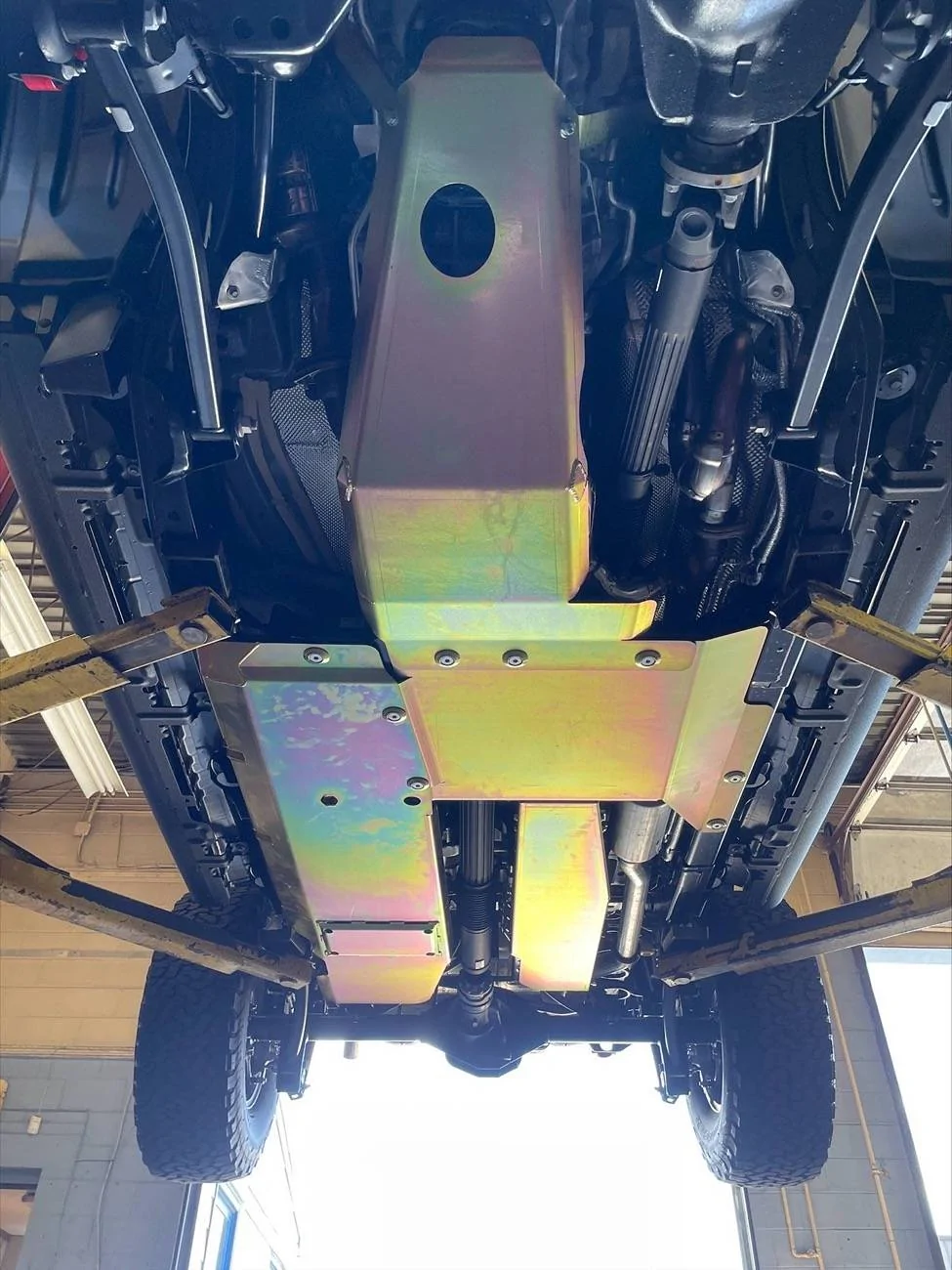

Just picked up the Jeep from the shop. The skids look pretty beefy but time will tell. First offroad trip is this weekend, 2 days out on the rocks. Only time they will look this pretty lol.
Jeep Wrangler JL Skid plate 20240724_183021

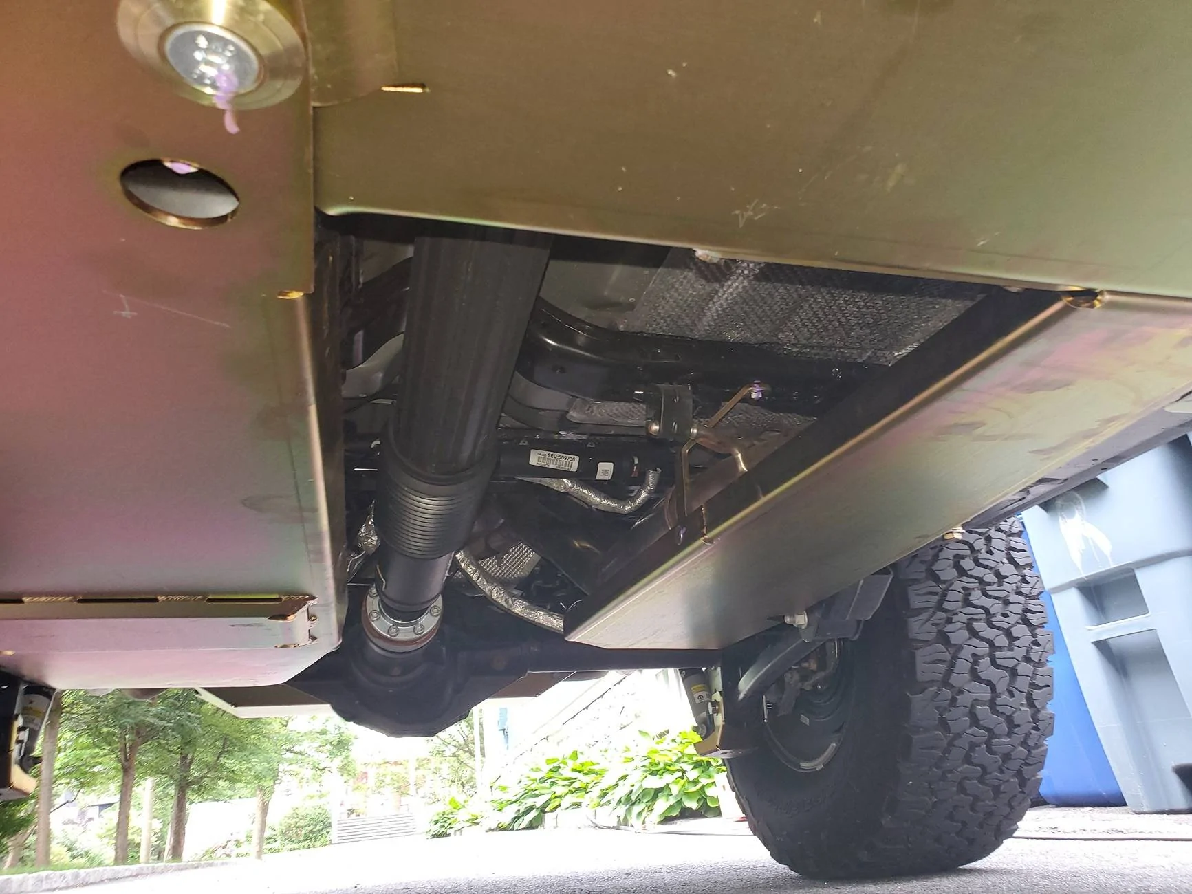

Exhaust crossover section looks pretty well build with good coverage
Jeep Wrangler JL Skid plate 20240724_182953

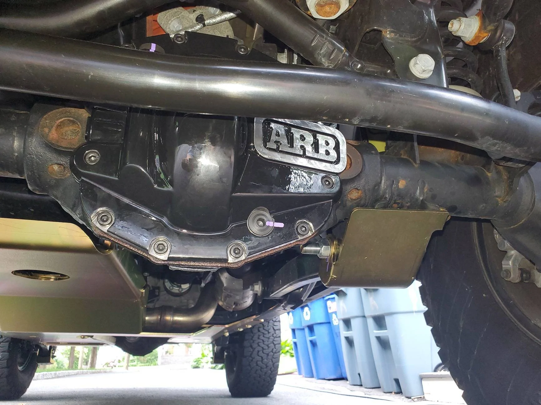

Rounded it off with LCA skids and ARB diff covers
Jeep Wrangler JL Skid plate 20240724_182901
The thing in the last pic with ARB stamped, what is it? The guy at the Jeep shop told me the stock one is very prone to rupture and it should be replaced, is that correct? Also, until your post, I didn’t think about skid plates, doesn’t the X come with enough skid plates?

That's theARB front diff cover:
https://store.arbusa.com/differential-cover-dana-m210-0750011b/
The stock stamp steel diff covers can peel back like a can of tuna if you get the housing wedged on a rock.
ARB covers are made out of thick iron and will resist damage. Plus helps with axle housing integrity.

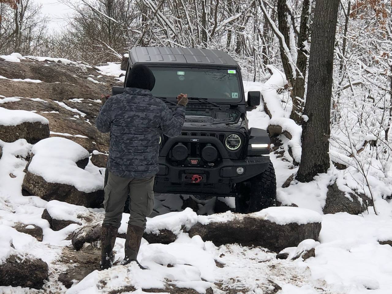

As to whether or not you need skids, that's entirely up to where you will take your Jeep.
For me, I do some pretty decent trails and want the extra protection.
Trails like these (this is my with my 2021 JLUR):
Jeep Wrangler JL Skid plate 20230722_145201

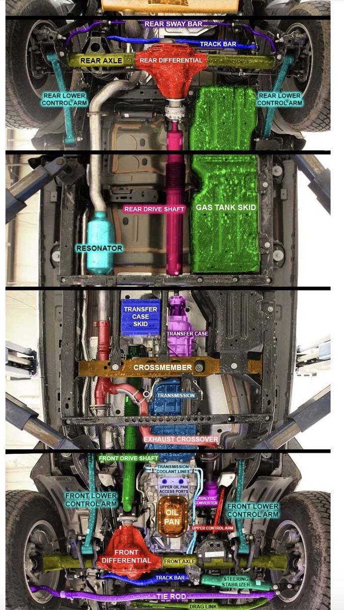

Typical aftermarket skid plate coverage to compare to the minimal lightweight factory skids
Jeep Wrangler JL Skid plate IMG_1470
