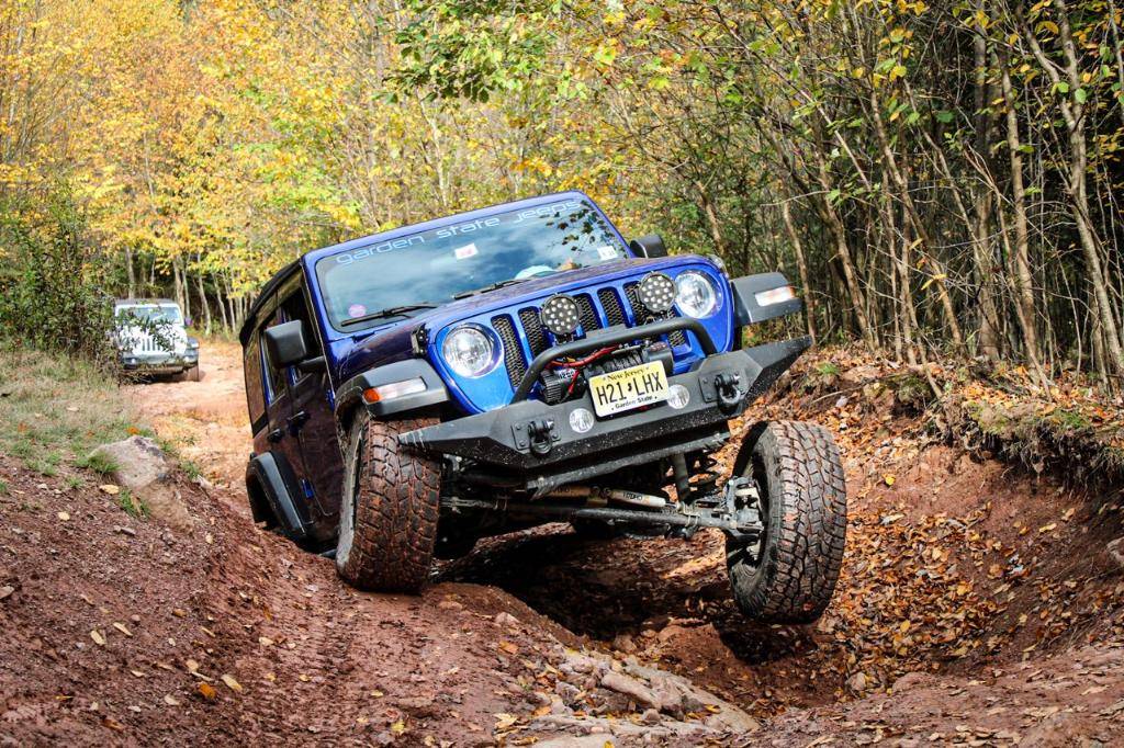

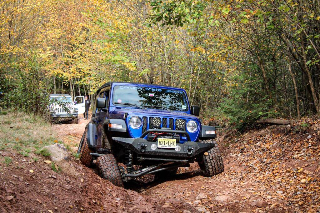

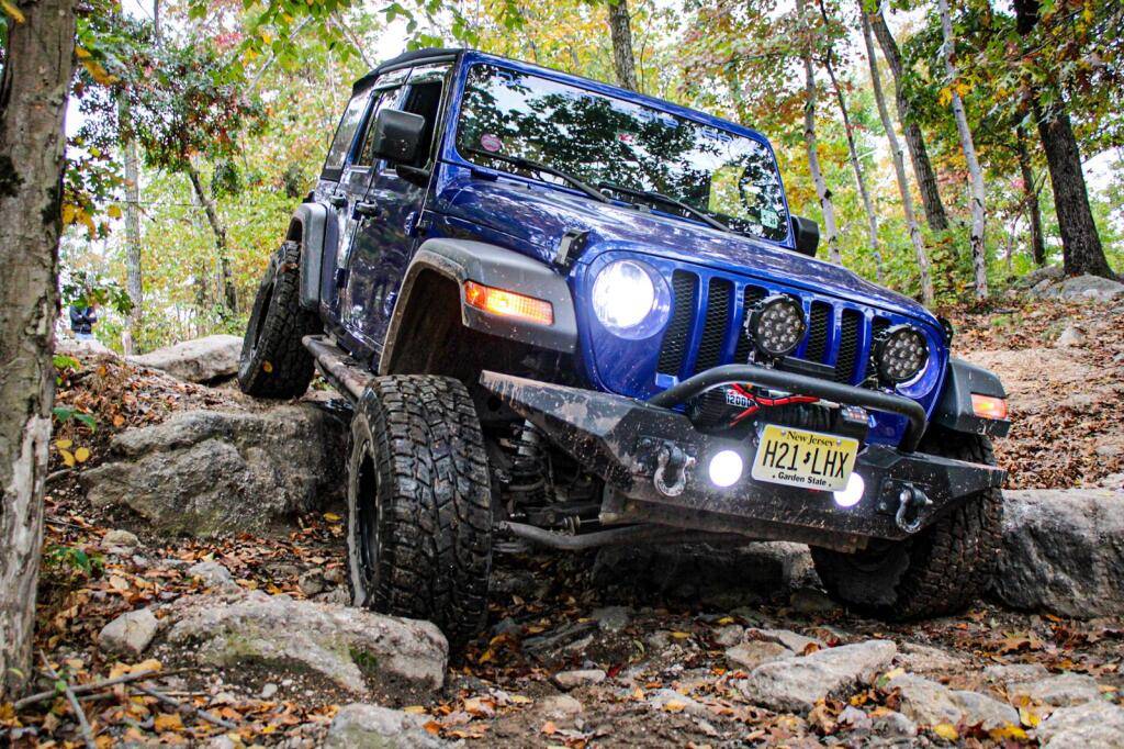

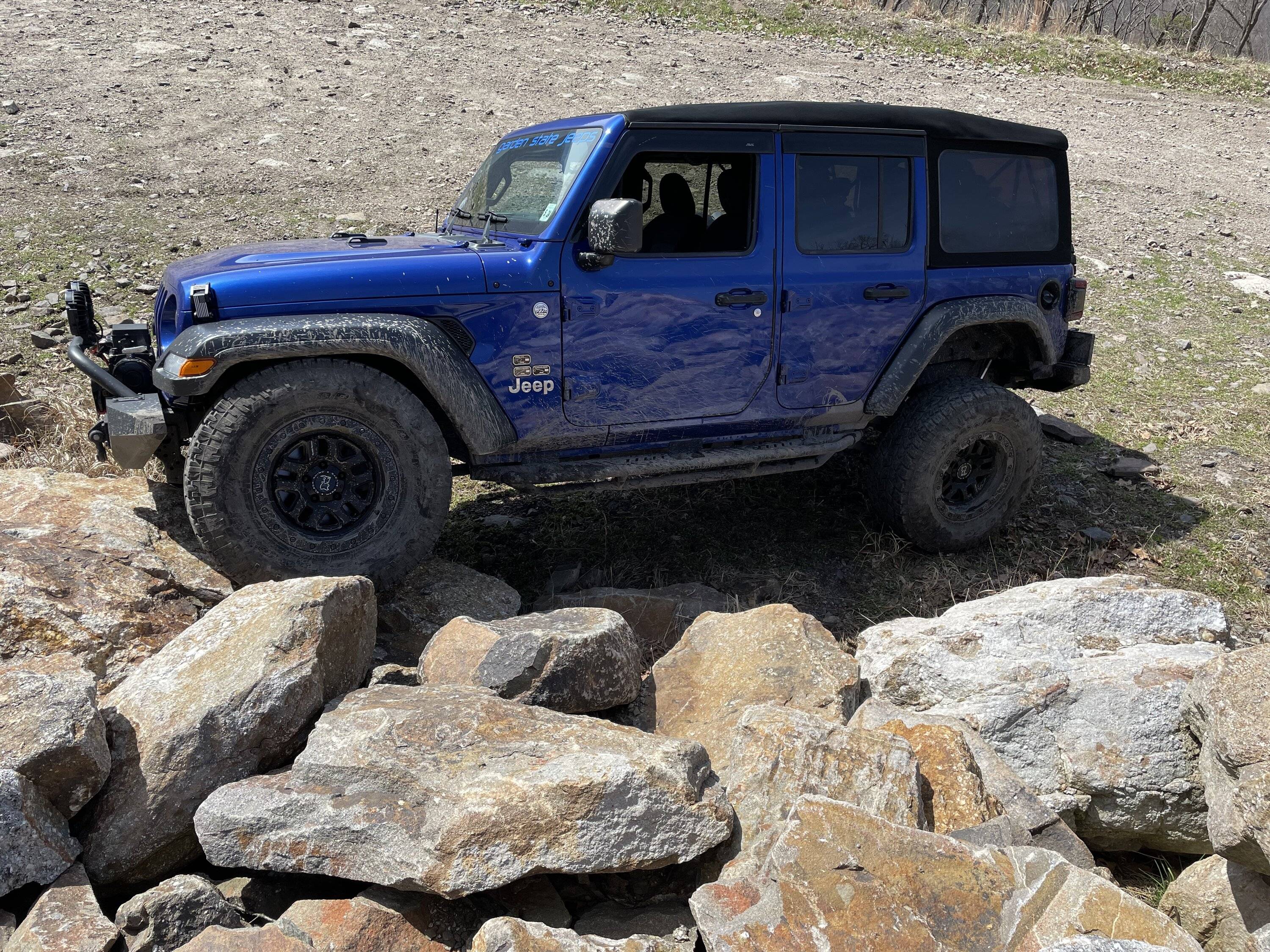

I’ll play devils advocate. I run 35’s on my 19 sport s on the stock 3.45 gears with the 3.6L. I still hit all 8 gears under 72 mph which to me wasn’t enough to warrant a regear because stock tires I never saw 8th above 75mph. I do rock crawling but nothing extreme mostly blues and a light black every once in awhile. Just made a trip from NJ to OBX and averaged 19.5 mpg. I just pulled a couple vehicles out this morning stuck on the beaches here in OBX and 2 guys that had trucks told me they were surprised I could pull out a Yukon and a Explorer with no issues. I run a hikeit throttle controller as well and honestly in my opinion I see minimal difference or at least not enough to justify a regear. I have 45k miles on my rig and still love driving it everyday.
