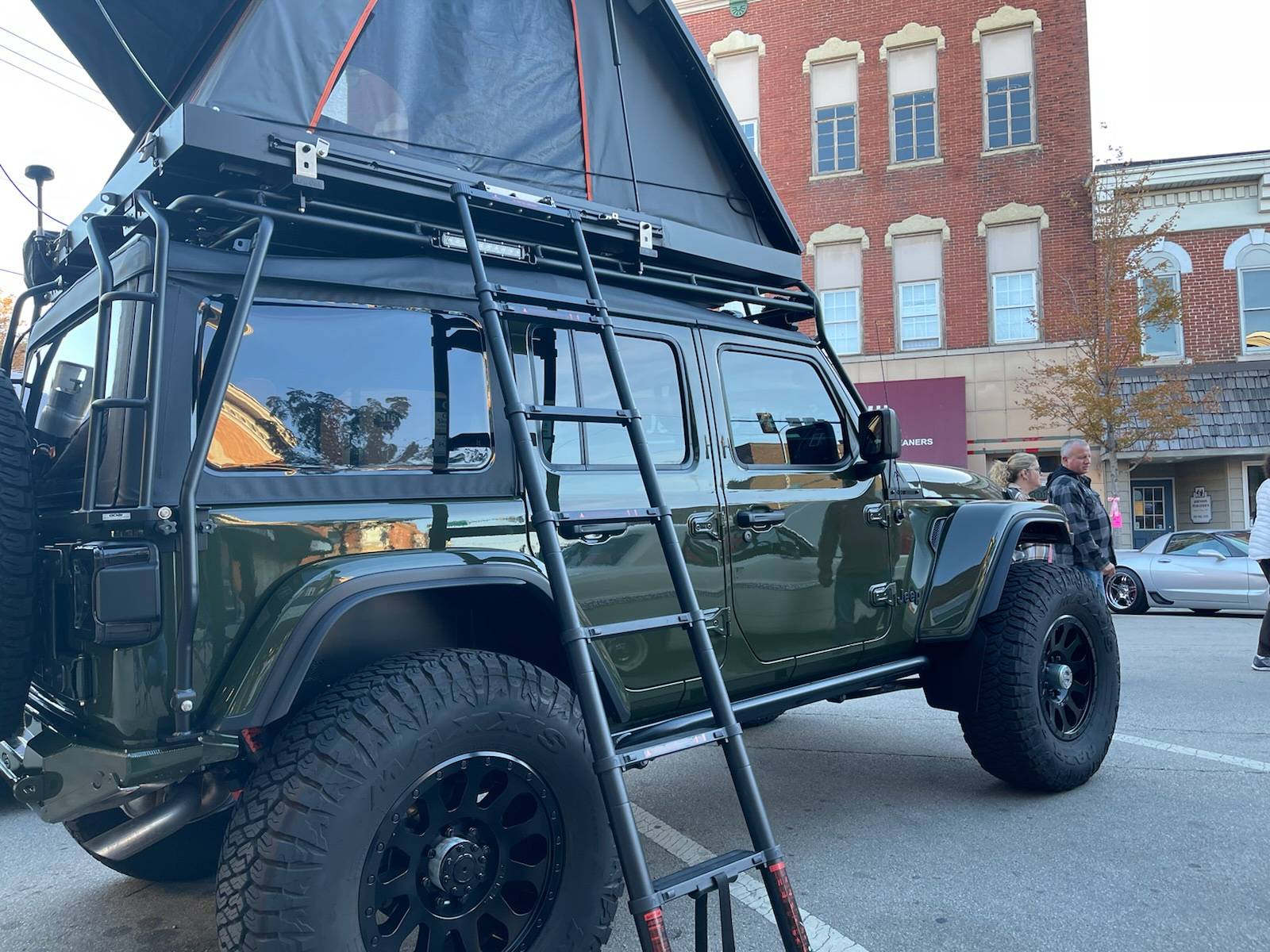

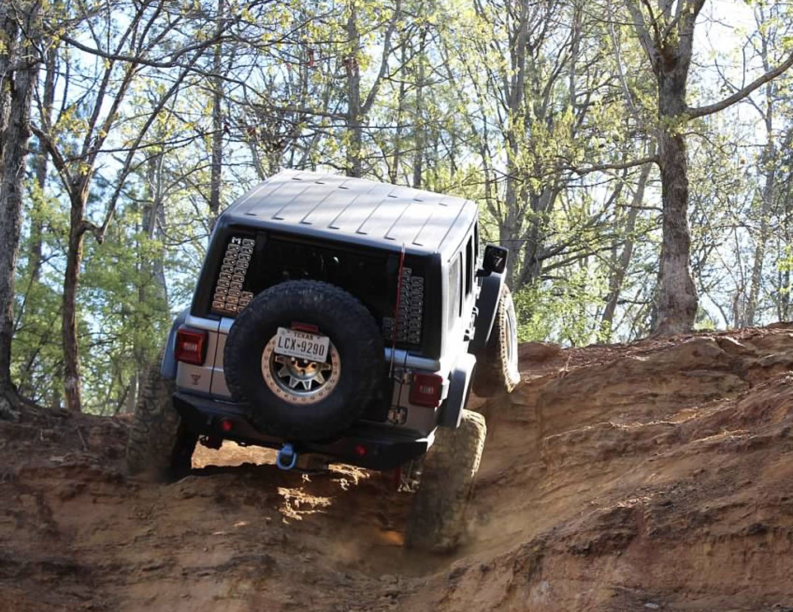

Mike,
You could also go Teraflex RT4 long arm. I went with the RT4 long arm with no shocks or track bars. RockJock has great track bars. I chose Fox Factory series 2.5 DSC Remote Res shocks. I have been running this for three years. I utilize it for both off highway trails and overlanding.

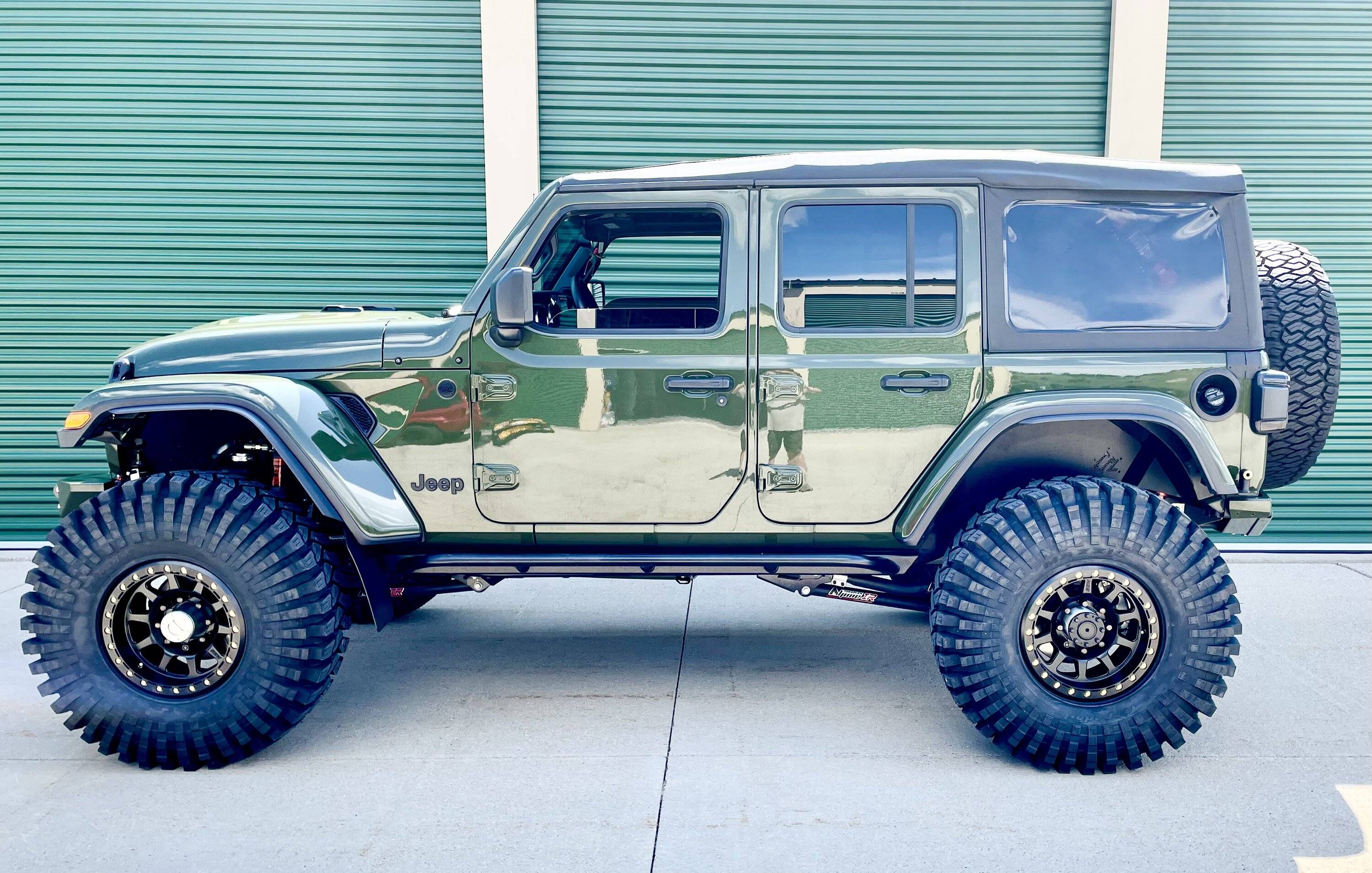

Just went from MC 3.5 short to MC long arm. No other updates other than long arms and skids to accommodate. So on road I am noticing little to no change.. First real off-road test later this month.
Image long is no big change until you get into 4+ inches of lift.
No change in the amount of flex. Shock limited. Should flex with less strain but not real noticeable from drivers seat.
