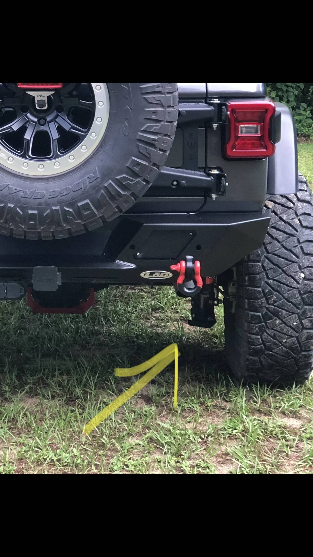

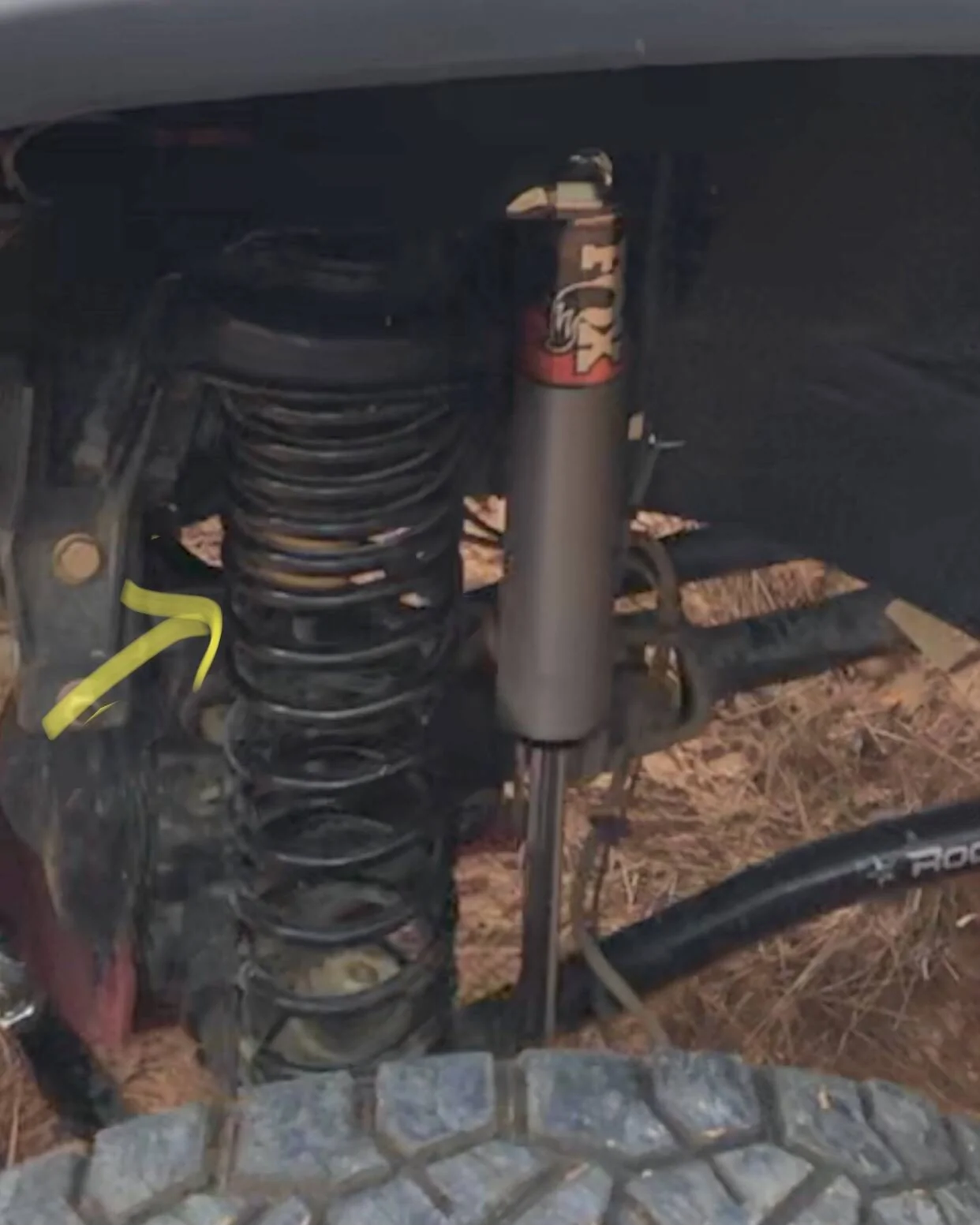

Not sure where you’re getting your information from, but I’m running RK long arms and they’re 12” longer than stock, I think MC is an inch or two longer yet, but no where near as much ground clearance….

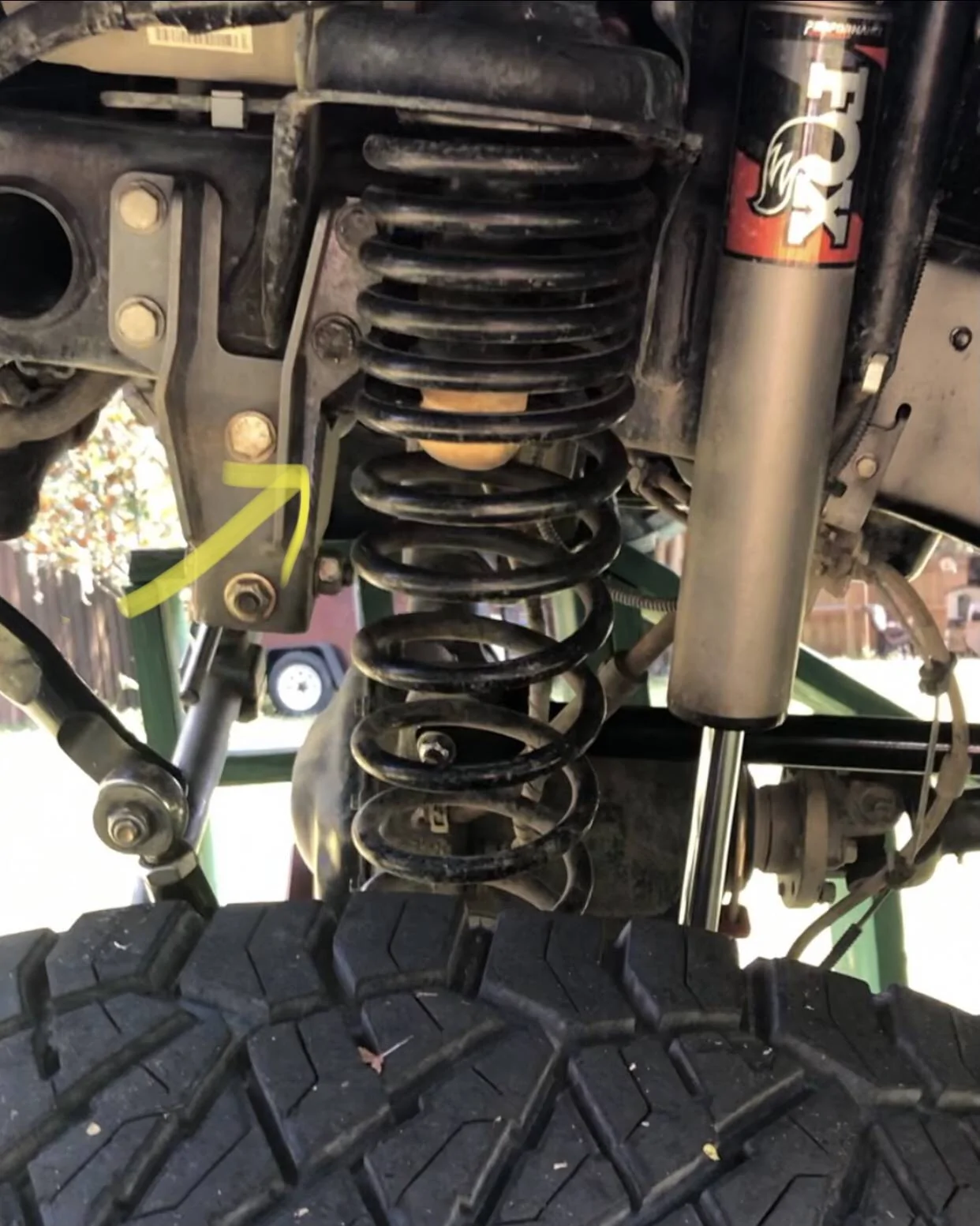

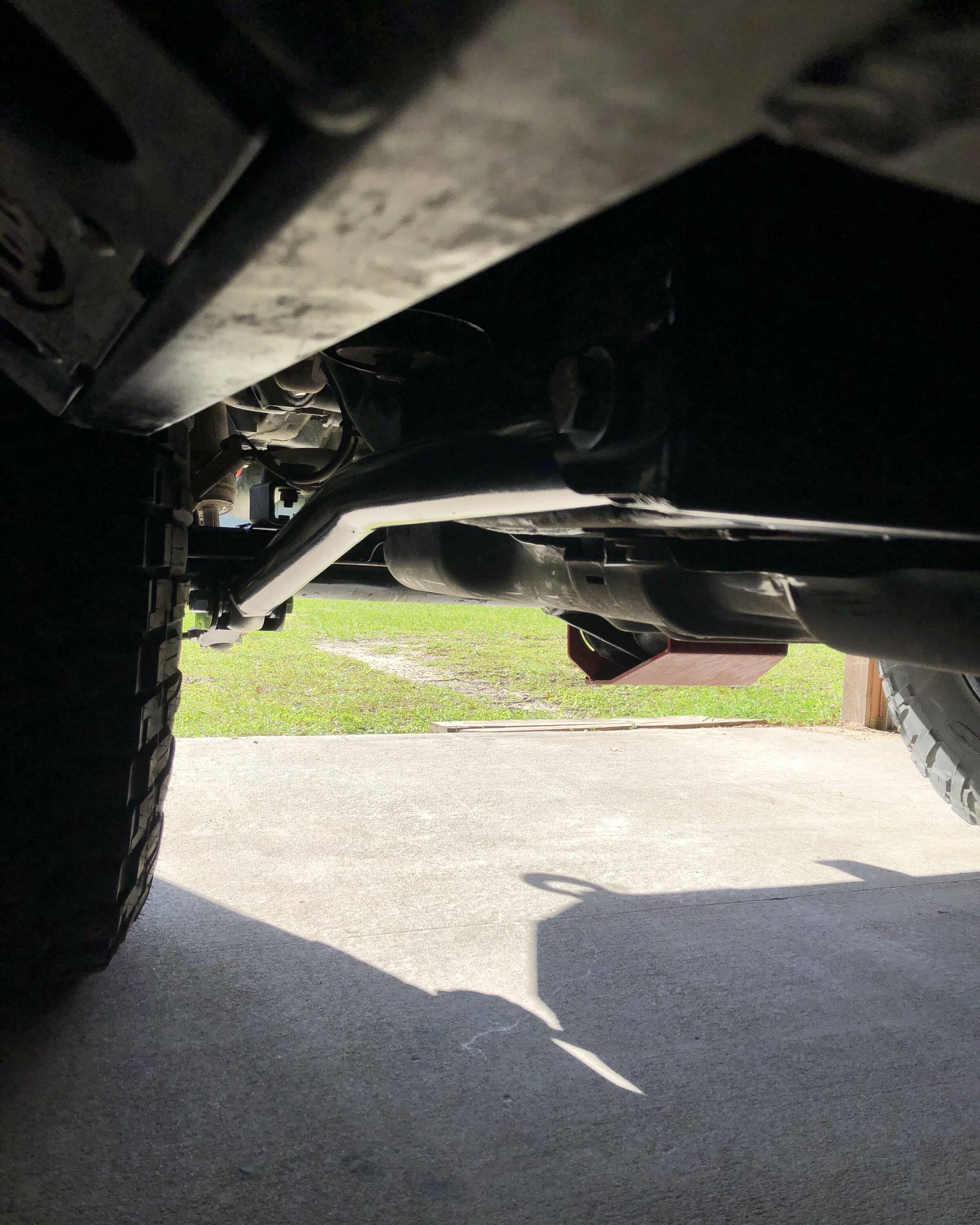

The angle is significantly better as is the ground clearance the way these bars are made….here’s a rough illustration of before and after…..On my rig, a JLUR, the long arms made a significant difference in on road handling and ease of off-roading…..
Jeep Wrangler JL Short Arms to Long Arms IMG_9728
Jeep Wrangler JL Short Arms to Long Arms IMG_9729

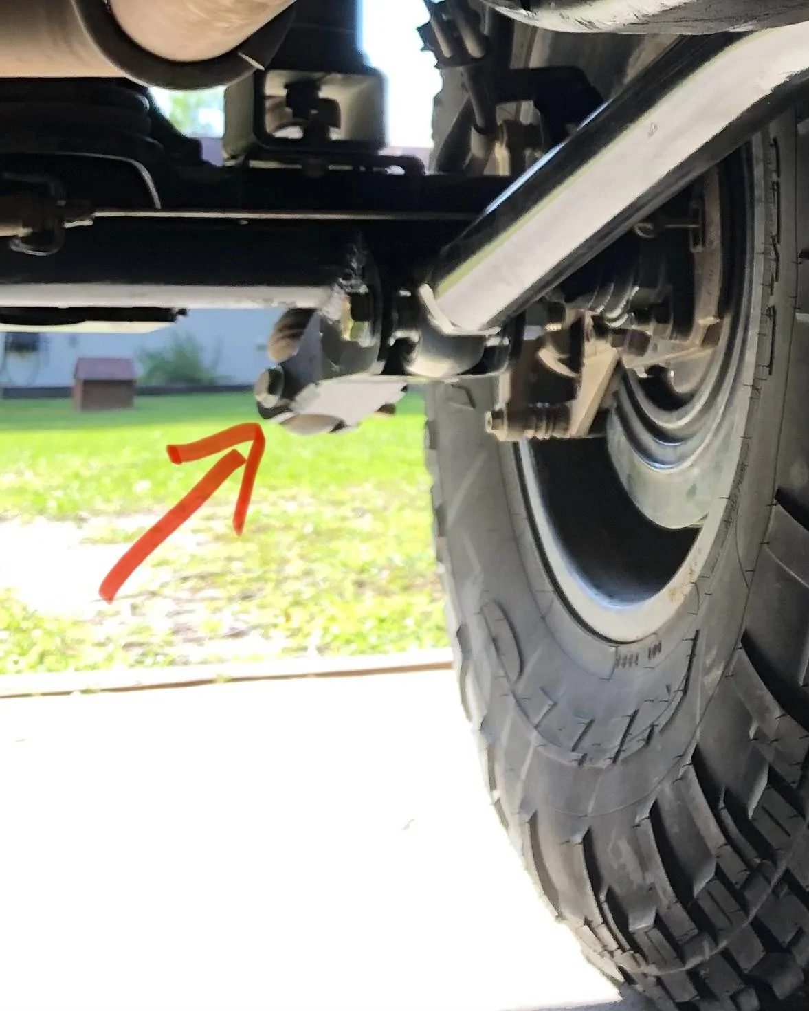

Here’s an example of how the axle isn’t pulled back, or pulled forward in the rear…… this cleaned up some rubbing I had on the front driveshaft hitting the exhaust at full droop, and the rear diff skid was contacting the gas tank..also there’s no more rear steer over obstacles……see the white jounce bump…..

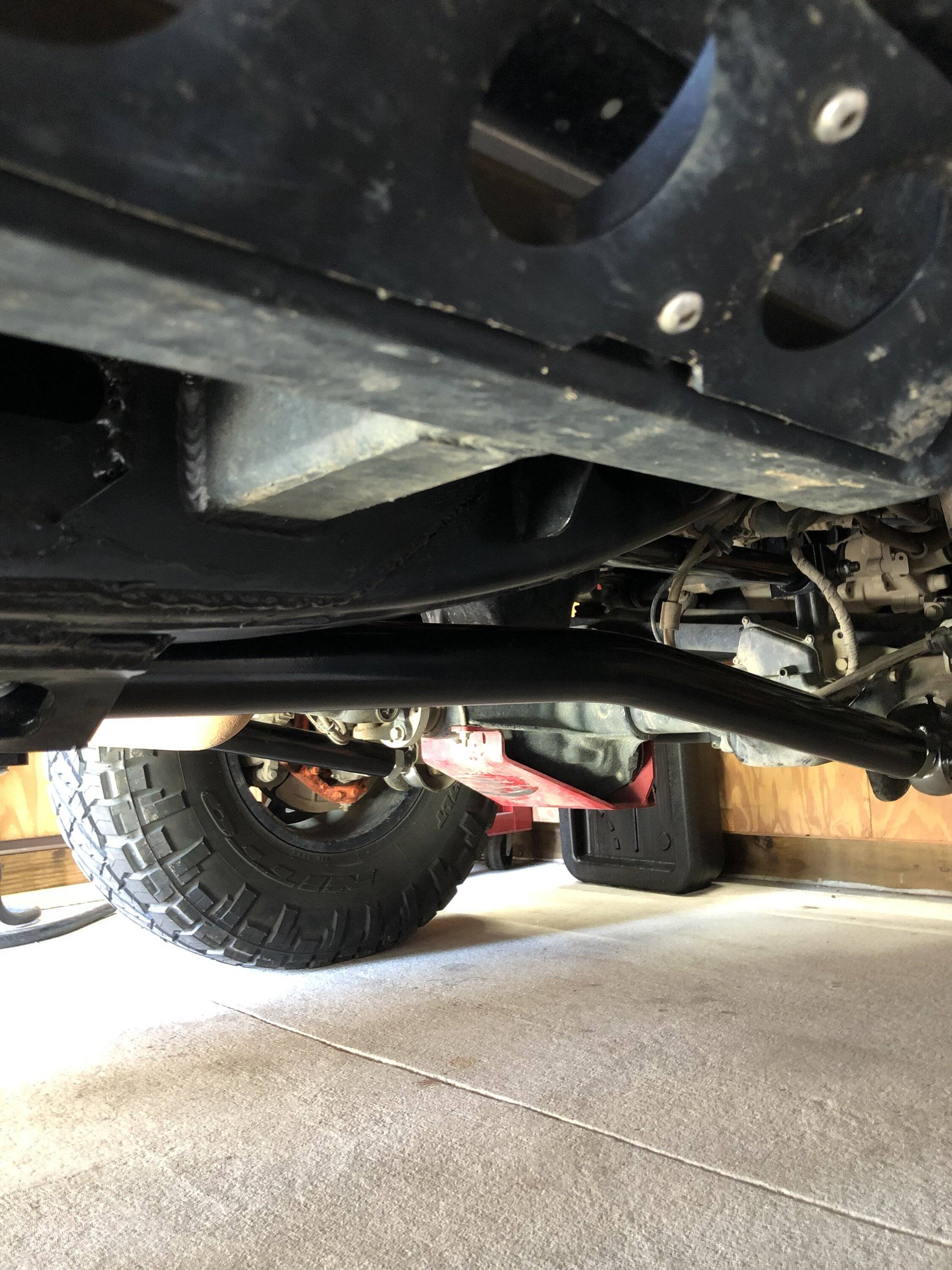

I gained 3.5” of ground clearance on the rear shock/control arm bracket as well…I actually never realized how low those brackets were…..

Here’s a shot of underneath….
Jeep Wrangler JL Short Arms to Long Arms IMG_6621
Jeep Wrangler JL Short Arms to Long Arms IMG_6620
The 3 link rear, really helped with the ground clearance, and ease of articulation…….
