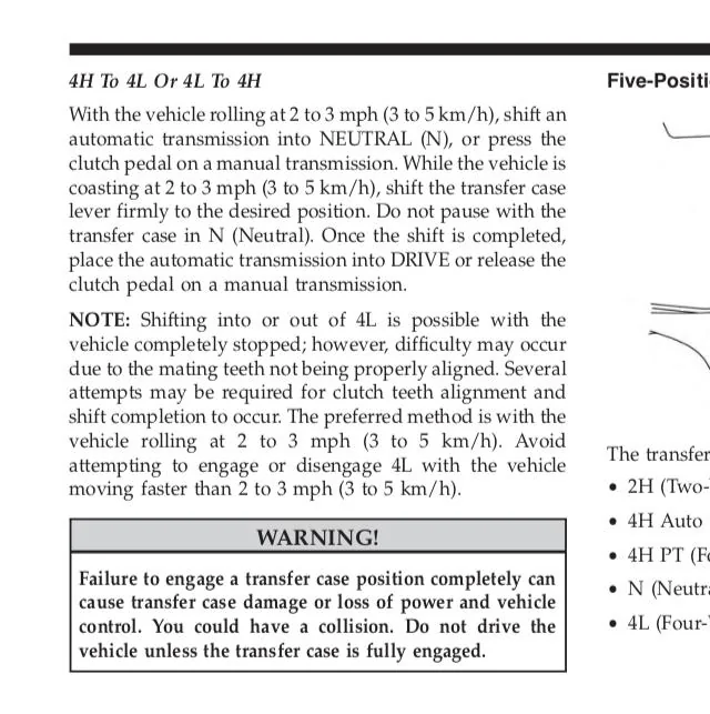

The owner’s manual does recommend the tranny be in neutral before shifting from 4H to 4L and not to pause in N while shifting the transfer case. Probably not necessary either.
Jeep Wrangler JL Shifting into 4WD AC328177-F98F-4137-A50F-20DF8D9E9501
mgroeger
Feb 1, 2018
162
6,221
9,299
Southern UT
2021 JLUR 2.0T
That is correct but the guy wasn't talking about that. He was talking about going into 4H and that you should not be moving and in neutral which is total crap, you can do it up to 45MPH.
Going from 4H to 4L is a TOTALLY different ball game as you can see from the manual.
